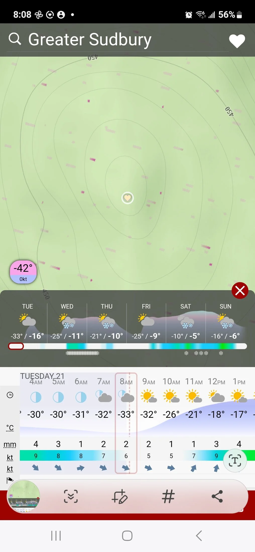

The hill I'm skiing today registered-42C overnight. I'm letting it warm up a bit, and will prepare a few items just in case.
