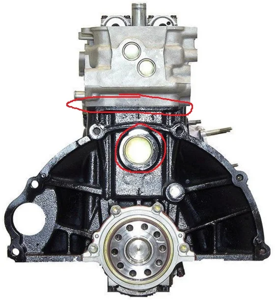

The freeze plugs on the back of the head? Can't see why you need to pull the trans to check them.
The freeze plugs face the firewall. Pulling the transmission is only marginally helpful. You can get them out without removing anything, it's getting them back in that's the problem. They really need to be inserted square to the bore and driven in that way. That's not possible with the engine in place. You can get them in, but there's no guarantee they won't leak.

Thanks for the replies. They are much more thorough than I expected. I'll confirm with the shop that it's not the water hose on the firewall, or the Pesky Heater Hose under the intake, or from the rear heater pipes/hoses above the transmission bell housing. After that based on the current shop's recommendation, I think I might invest in getting my LC to a land cruiser-specific shop. There are some in my area but they are a bit further away. I don't think the shop it's currently at knows all the intricacies of these engines. I'm worried that they might remove the engine and transmission to do the required job and miss other important things. Wasting the opportunity. I appreciate the help.
I spoke with the shop and pointed out the areas mentioned above. They'll update me tomorrow. I highlighted that the freeze plugs should be visible without removing the transmission. However, they insisted on doing so. On a positive note, they provided clearer reasons this time. They noticed coolant dripping from the transmission bell housing and, upon pressure testing, found coolant emanating from the rear of the cylinder head. Moreover, they observed significant rust upon removing the radiator cap. Here are some pictures. I wasn't able to upload the video they sent me but it wasn't that clear. Seemed like water from the pressure test leaking from under the car.
If they found coolant leaking from the rear of the head, the leak isn't a freeze plug; the head doesn't have them. You should plan on replacing the headgasket.

There are two possible sources of coolant on the back of the engine. Between the cylinder head/block (leaking head gasket) or a 'freeze plug' inside the transmission bellhousing area of the block.
If it is emanating from the back of the head, that's above the 'freeze plug' and it's running down around and dripping off the bottom of the transmission bellhousing, NOT leaking from the 'freeze plug'. Either way, pulling the transmission isn't going to solve the issue. If the cylinder head is leaking, you need to pull the head, not the trans. If any freeze plug in the block is leaking coolant because it's rusted out, then ALL of them should be replaced, not just the rear one. To do that, you'd want to pull the engine to do it right (there is also one in the front under the timing chain, and down both sides of the block). Another possibility is the 'pesky heater hose'. You can see the outlet pipe that attaches a coolant hose on the lower left side of the head in the picture. If that hose is cracked it could be spraying onto the back / side of the engine around the same area. That's all pretty hard to see up in there.

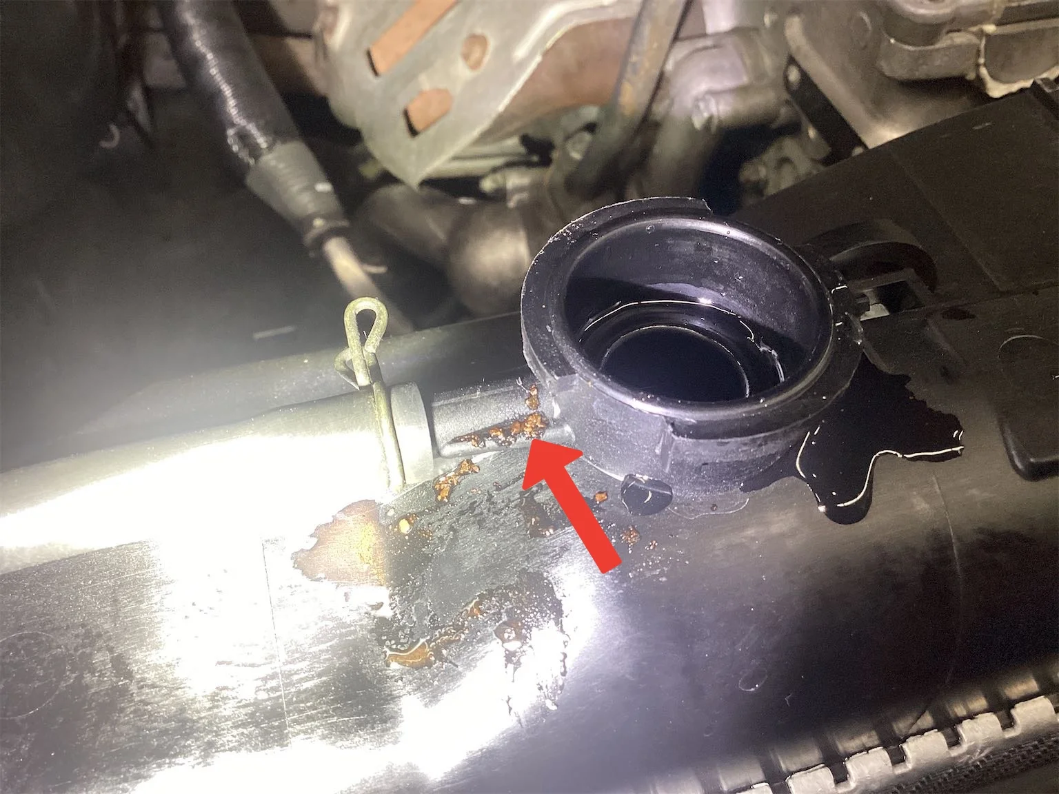

Hey everyone, here's the update on my coolant leak issue:
The lead technician, who specializes in cruisers, took some time off so it took a while to get a second inspection done. They've since inspected the vehicle and confirmed the leak isn't from the rear of the cylinder head or the PHH. I've decided to have a shop(still shopping around) remove the engine and transmission to address the leak. However, I'm torn between focusing on preventive maintenance (PM) or proceeding with a head job. Many suggest going for the head job, but I've heard it's possible to do this while the engine is still in the vehicle. If that's true, I'm considering postponing the head job and focusing on PM tasks, like the ones Malleus mentioned. Given my budget constraints, I'm leaning towards addressing issues that specifically require the engine and transmission to be removed. I'd appreciate any advice on the best approach.
