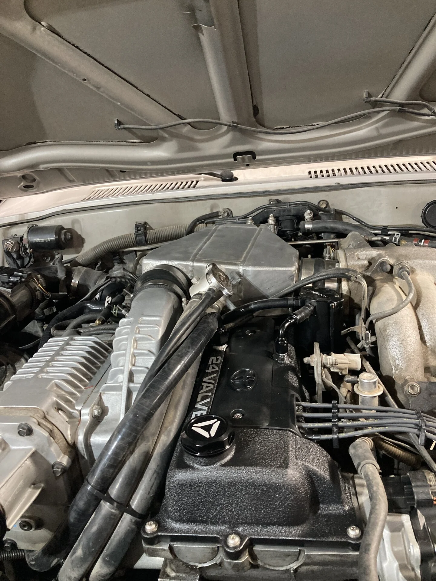

I just revamped my engine bay last weekend. Been running a KK Moon cheapie catch can. Finally swapped to AN fittings w/ it vs the PCV valve. Put two check valves in instead(so I’m not accidentally pressurizing the crankcase somehow). 6AN on the old PCV side and 10AN on the breather. Made a little bracket that it sits on and the hose keeps it in place. Need either a 1/2” or 5/8” for the other one now but it’s much better than it was.
Did new plugs, wires, coil and distributor as well.

Can you learn me what an AN fitting is? And any links or photos of the check valves? Does the in-line check valve serve the same function as the pcvs?
