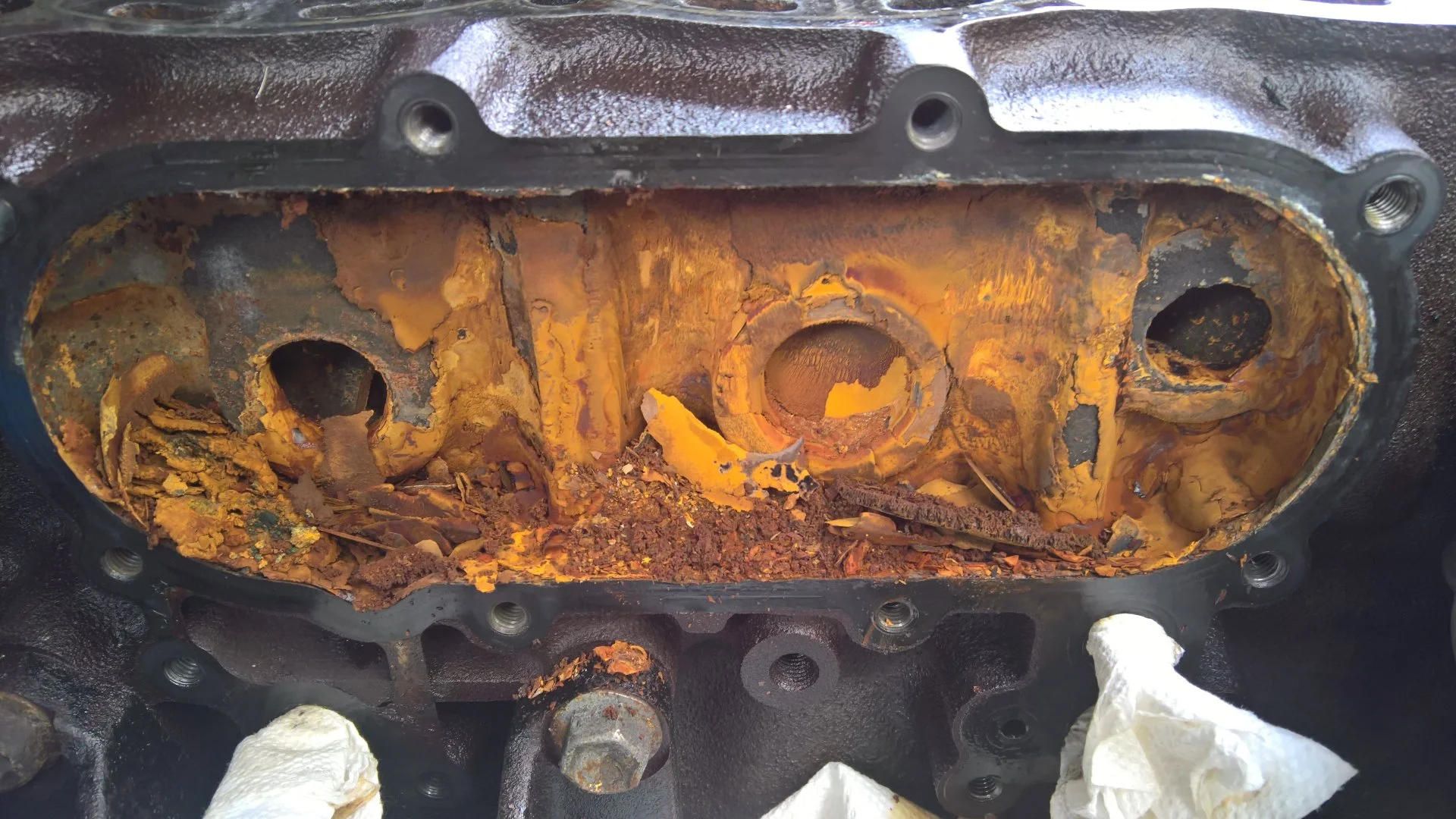

Below are some photos of what I found, the PO apparently had dumped in (more than one bottle??) of head.gasket/block sealer (undisclosed during the sale). He was running just water so it was mixed with rust.
If I can find it I'll post up photos of the smaller water bypass pipes that were blocked by the sealer when it flaked off the internal surfaces of the cooling system. This may have been the result of me trying to clean the system before I had it apart but my guess is sooner or later it could have happened by itself.

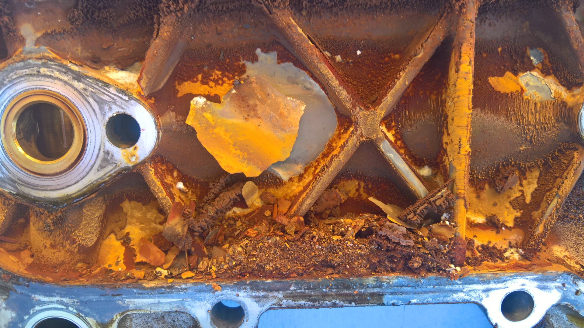

I don't have a good photo but the bottom of the water jacket (block) was full of large flakes of the hardened sodium silicate that had dropped to the bottom.

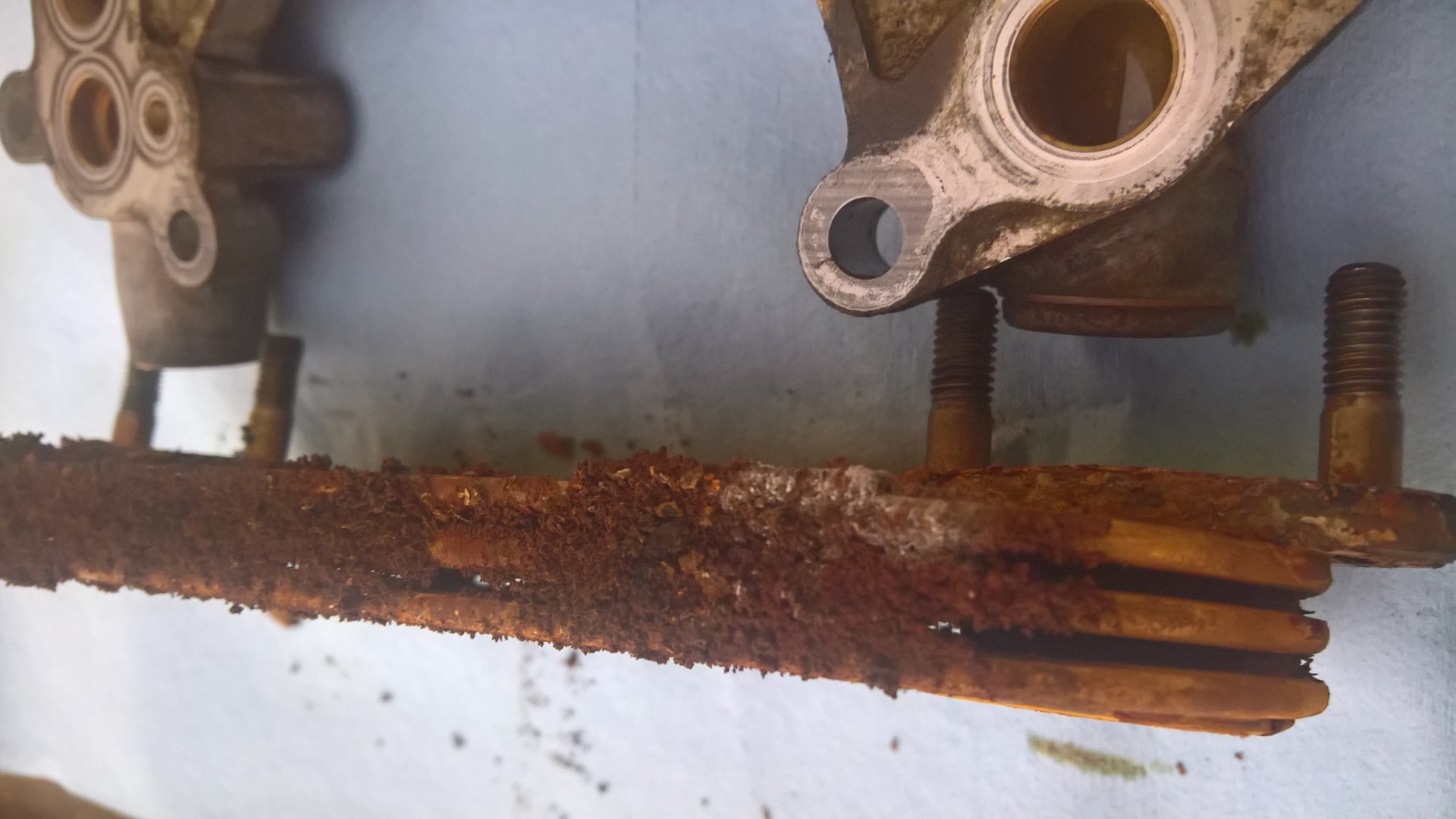

This clearly shows how the sealer built up a thick coating on the internal surface of the oil cooler cover which then began to flake off.

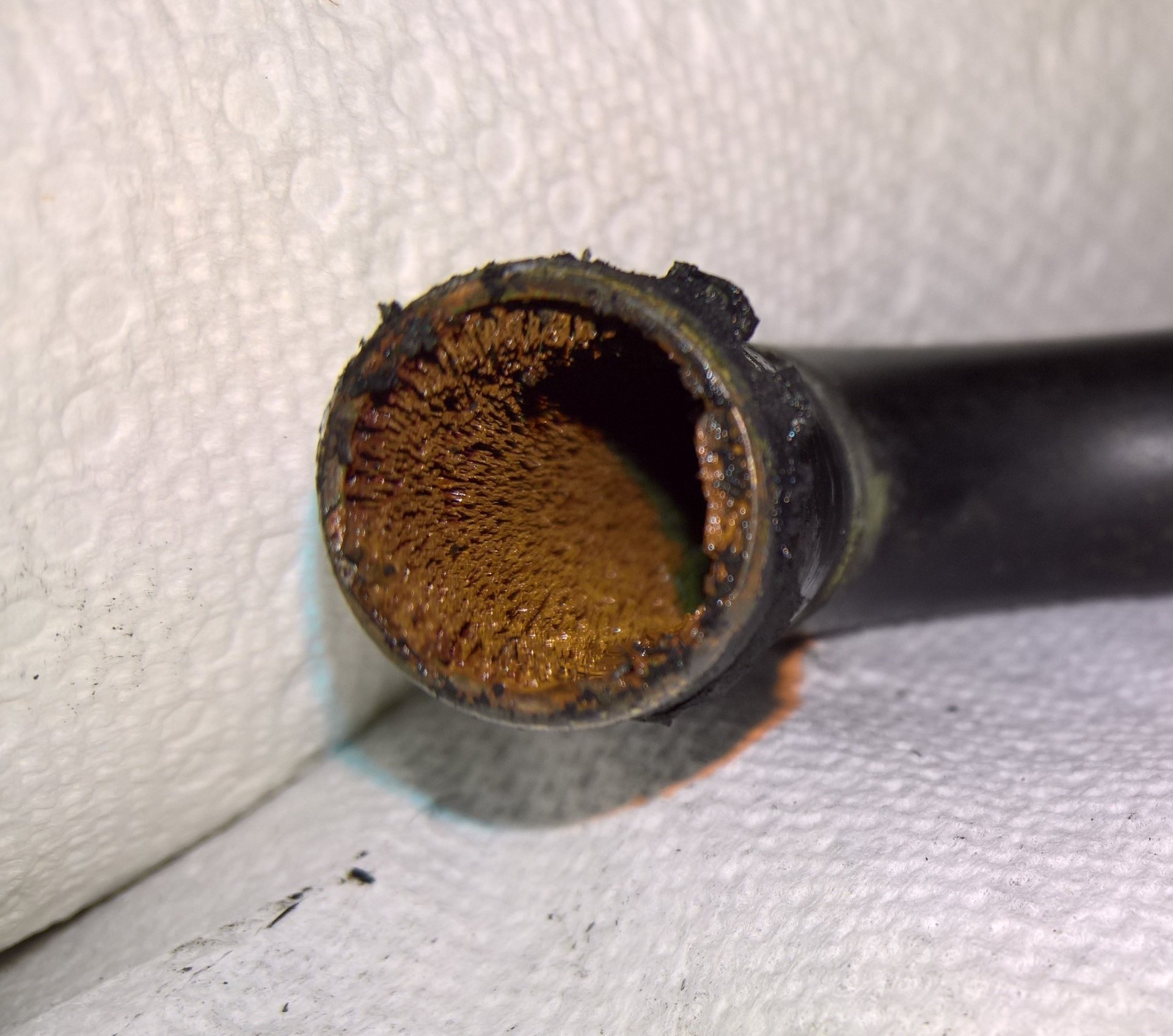

This next one shows the inside of the U pipe up near the heat control valve.
All the hoses and pipes were similar. Click twice to see the build-up, looks like zillions of tiny stalactites:

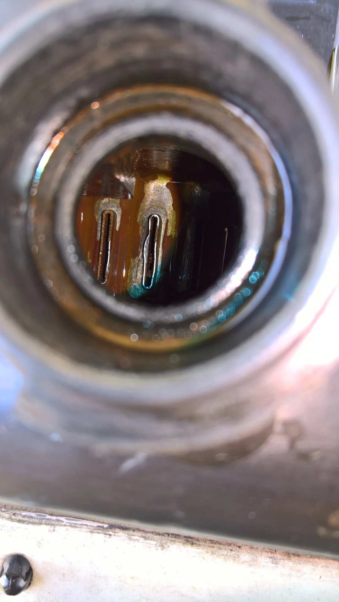

If you double click on this photo looking into the radiator and look closely you can just barely see that it's not just rust, there is a thick coating tightly adhered to the inside surface of the radiator. This is after multiple (6+) attempts to clean it out using a few different types of cooling system cleaners including Thermocure. They barely touched it.

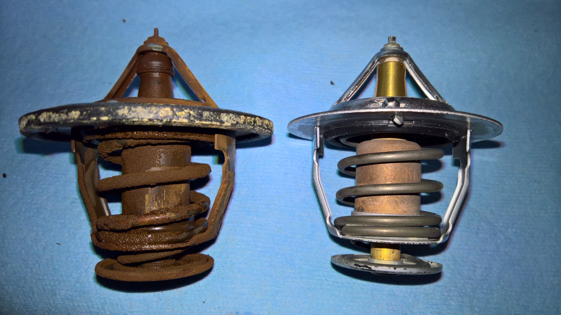

This one compares two used Thermostats: one which came out of a clean system and the other out of the same engine as above that had block sealers added along with a poorly maintained cooling system. Most of what is stuck to the Thermostat however is the sealer, it crumbled when touched.
Again, double click and look closely keeping in mind this is after multiple
attempts to flush the system; with various cleaners (about 6 IIRC). They may have weakend the attachment of the sodium silicate but didn't remove/dissolve it.
----- Neglected system with sealer -------- Clean system without sealer ------
If you double click on this photo looking into the radiator and look closely you can just barely see that it's not just rust, there is a slightly off-white/orangish coating adhered to the inside surface of the radiator. This is after multiple attempts to clean it out using a few different types of cooling system cleaners incluiding Thermocure. They barely touched it.
