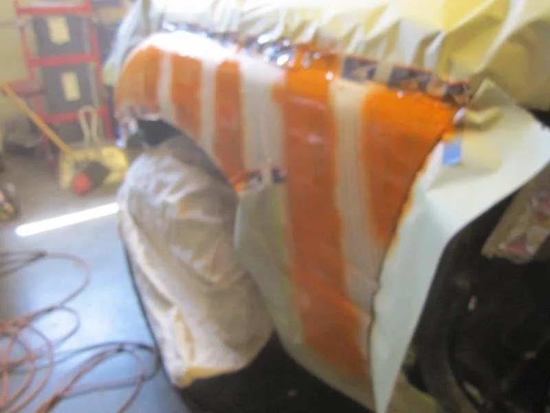

Found some pics of the kids designing and laying out the short time paint scheme.
The hood, "FF" is for Foo Fighting.

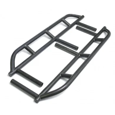

Next on the list was sliders. I saw the great work that trail gear does and decided that the value they give you for the product cannot be beat.
Unfortunately, they don't make one for the 80 series. The pictures I found show about 2 to 3" of extra straight tube on each end of the inner tube. I measured and decided that the extra cab taco length of 74" less some cutting could get me to where I wanted to be.
Well, they came via UPS and looked awesome, unfortunately, the outer pipe went all the way to the end. I could only make up about 2" and at minimum I needed 4".
So here is what I did to make the slider work.
I cut out 3.5" from one end of the slider (basically all the flat section on the outer band past the reinforcement. On the opposite side I used the plasma to cut out the side that is cut to fit around the inner pipe. Cutting basically in the middle of the weld. Worked awesome.
Then bent a 1.5od DOM .120 wall pipe to match the existing bend, then cut out plug weld holes. Slid the outer pipe around the inner pipe.... slight adjustment and done.
TIG welded them on and here is what it looks like.
I did cut off the end of the front side too, shortened it and made it angle a little too.
