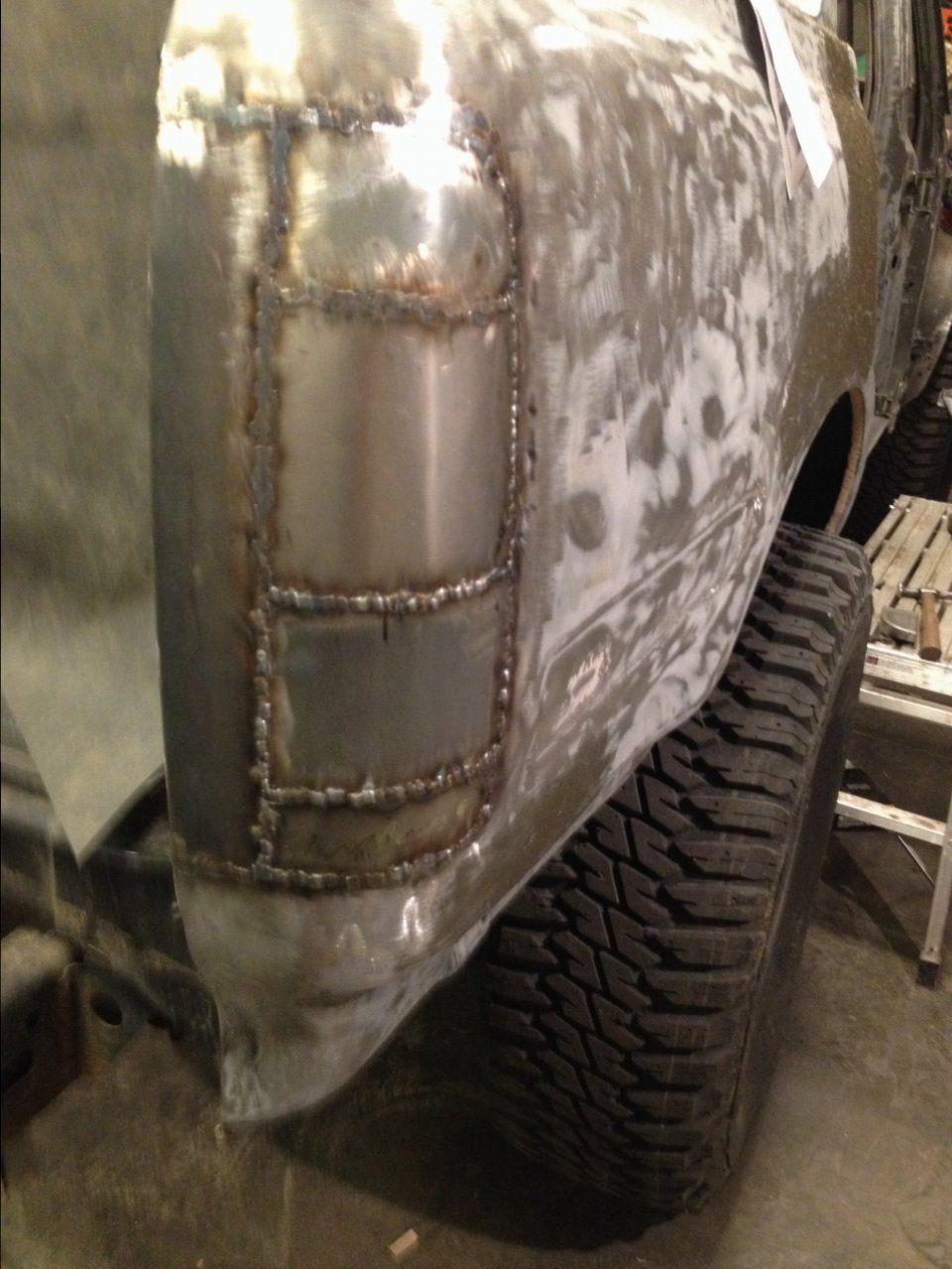

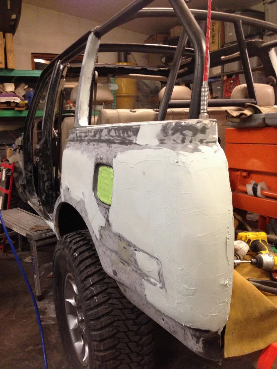

Here is the start of the taillight delete. Use some 12 gauge sheet stock for the corner. Cut the strip to fit. When ahead and cut the bottom of the existing taillight housing out so to avoid the shelf for water and the related rust.

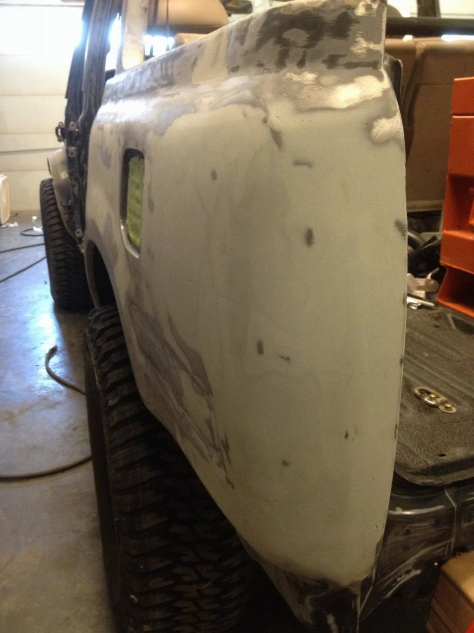

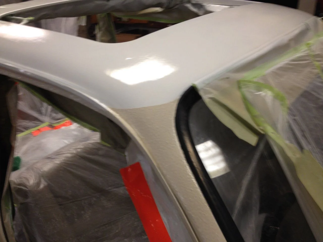

Here is the metalwork and first coat bondo

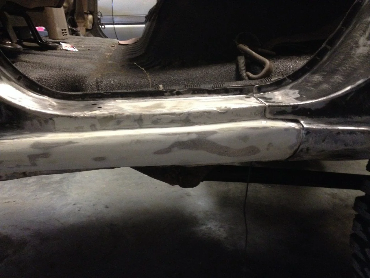

More work -Mostly lightweight bondo. Coulple sections I started with cats hair.--

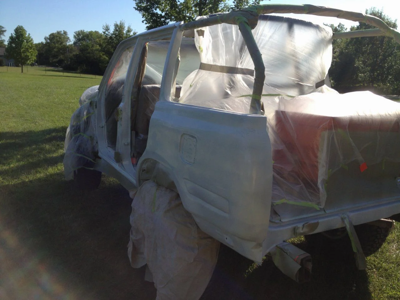

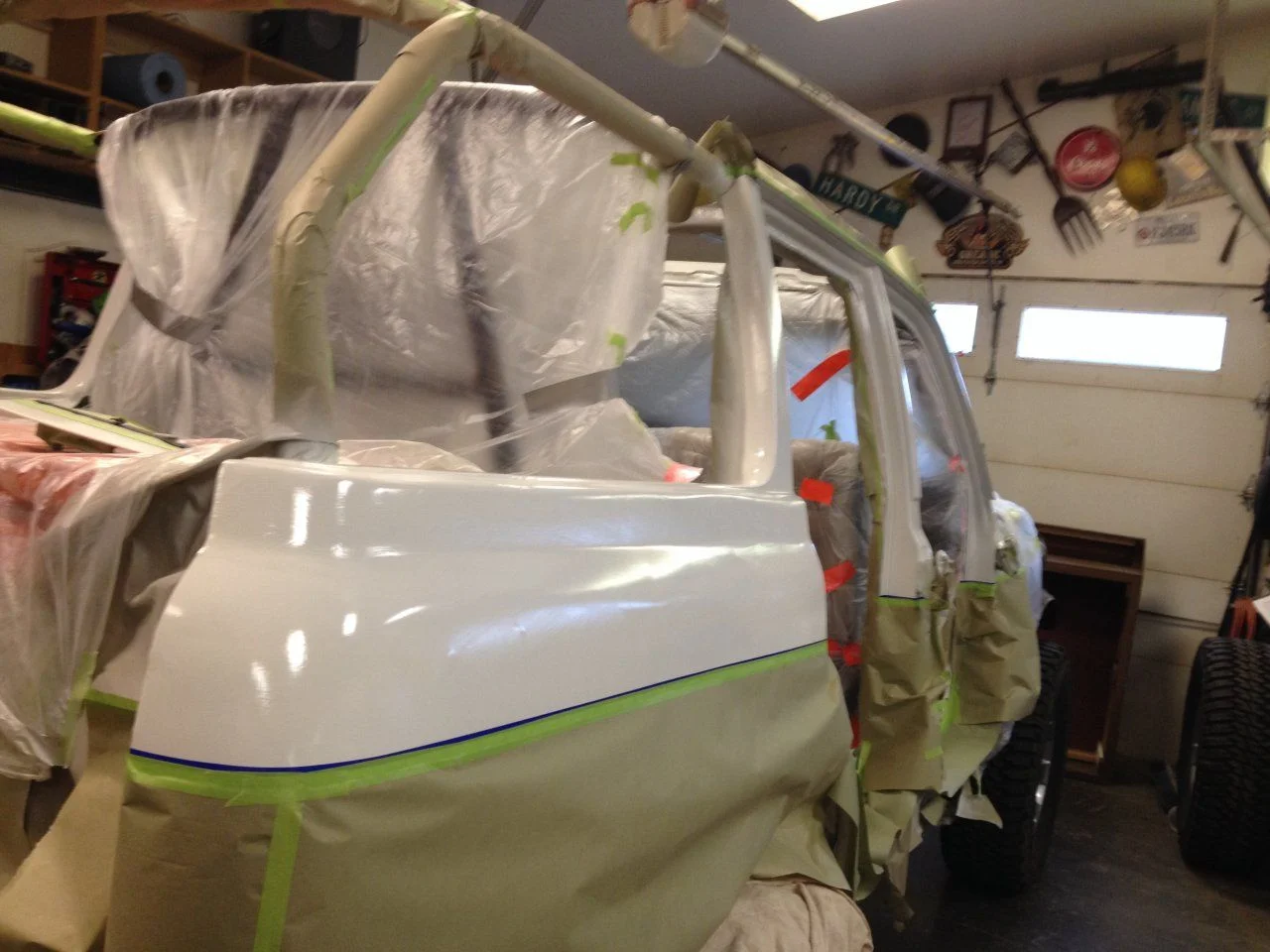

Rolled the car out in the yard, and blew some epoxy yesterday. Two good coats. Was going to do a third, as I mixed up the material, but when I went out the bugs were coming out for the evening, so decided to pass.

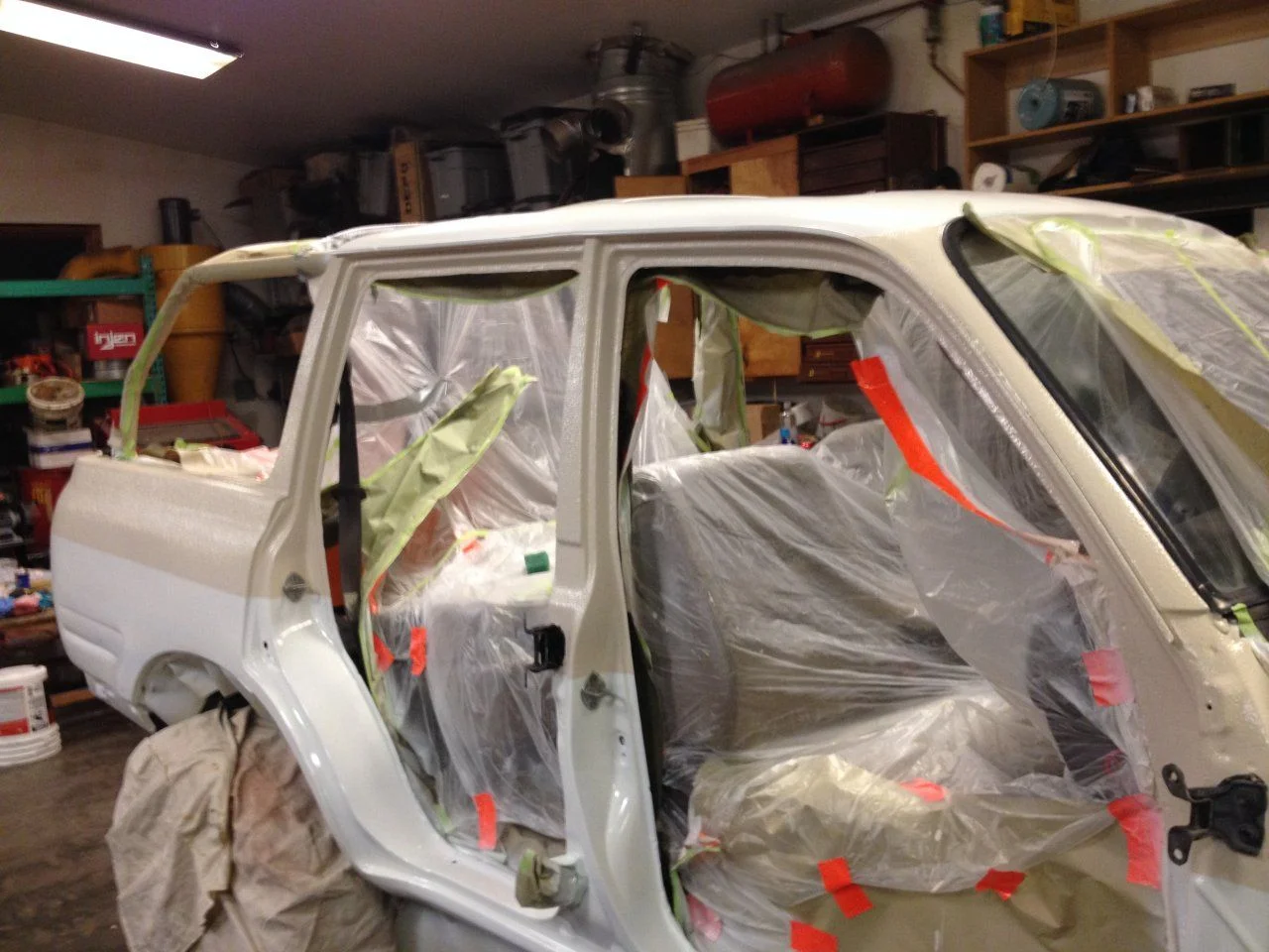

Talk about a pain to tape off!! Two people two hours to tape everything off!!

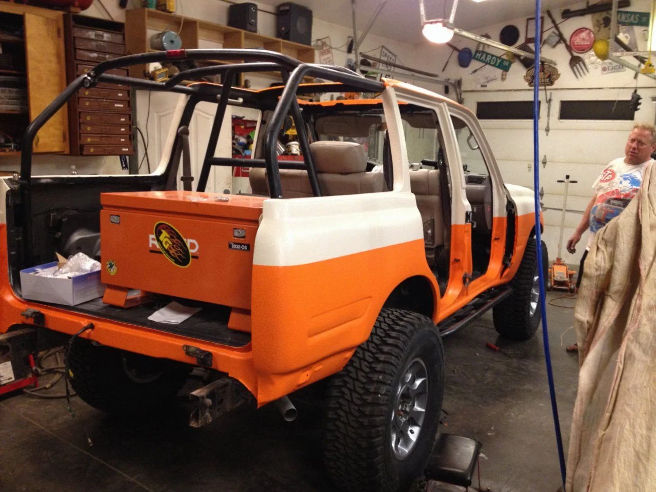

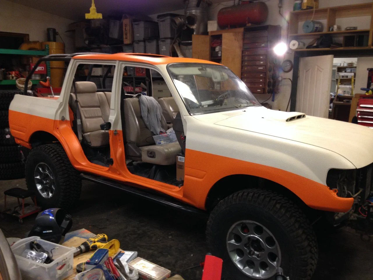

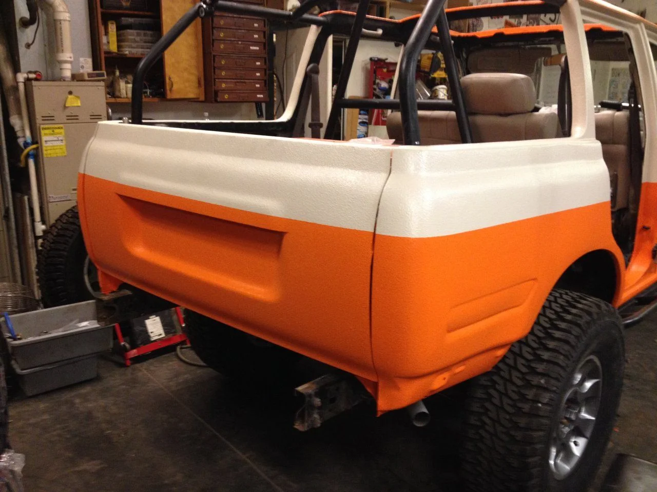

So, finally getting to painting the final color. Monstaliner painted. The white is my version of cyrus white. 25% of killer beej and 75% of white colorant. The orange is apocalypse Orange.
We did the lighter color first in the mid range area. Rolled everything, with lots of brush and foam work in the jams.
Then came the Orange paint.
Not extremely happy with the sprayed sections, which were the white color on the loose parts, hood, fender, tailgate; however, it will all work out in the end.

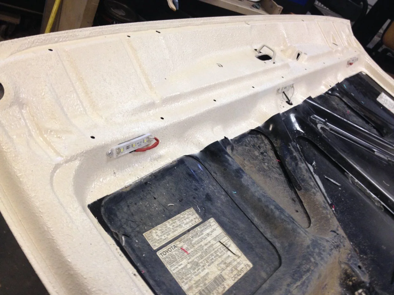

Before we installed the hood, cut out the liner and added LED lights while fishing the wires in the structure.
Here is my inspiration...
Source on those under hood lights please and thank-you!
Cool so you just throw 12v at them and that's it then, no resisters or buck pucks to deal with?
I put a 15 amp fuse line to the switch; however, yes, just 12v power and your done.
