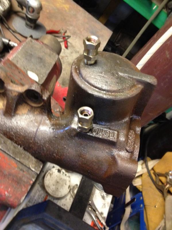

Time to work on the Hydro assist....

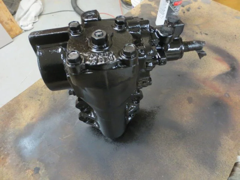

Pics of the box cleaning up and the resevoir.
Pictures are out of order, but cleaned up box, ported and wire brushed/painted it up.
I had previously expanded the reservoir, but forgot the baffle, so added that.. and my SCREAM ghost face.

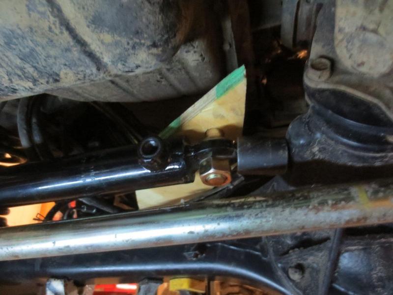

mocking up where the Ram will go
your coming off the axle not the diff correct? thus the big piece of wood on top to mock up your mount? Cause diff is cast i think and the studs probably aren't rated for side load.. Looking good..
Yes, this is just mocked up. Have to make a big mount off of the axle.

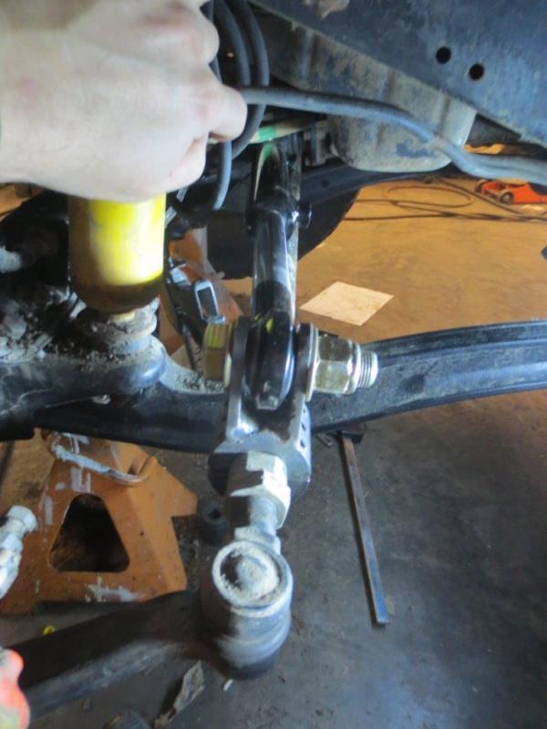

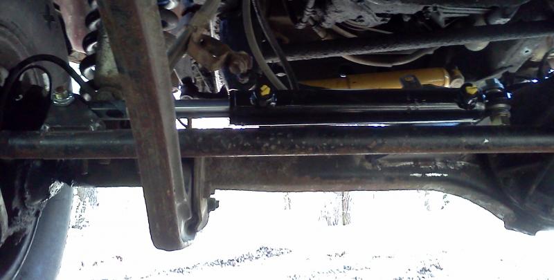

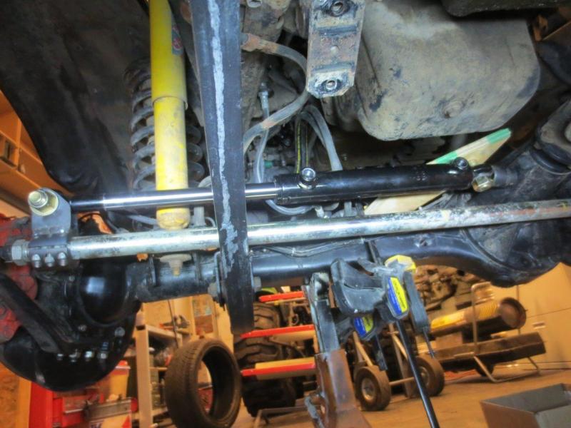

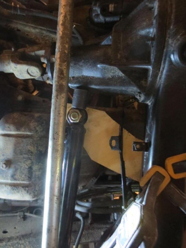

more pics of the hydro assist work.
