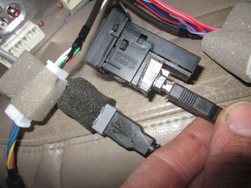

So cool thing about this radio is that it is HD, wireless voice, bluetooth, IPOD connectivity, USB, Sat Ready.
Here is more detail about the radio install.
https://forum.ih8mud.com/80-series-...hu-t1819-hu-install-lc-radio.html#post8189547

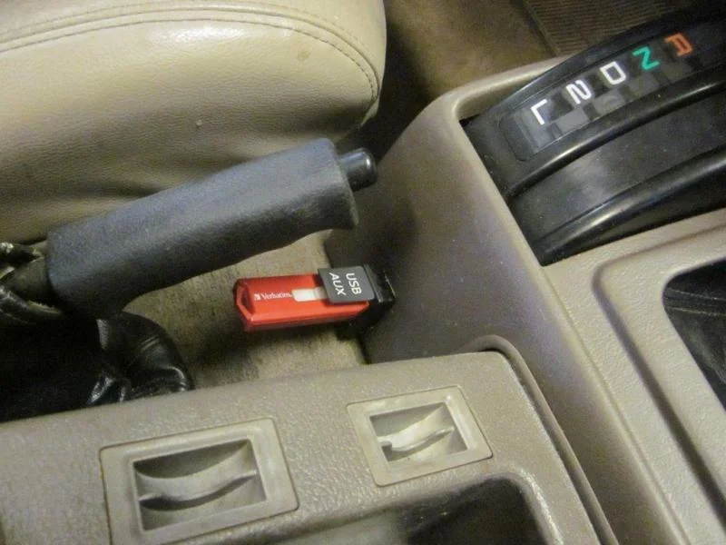

Here is the finished pictures of the radio install. I located the data port down by the e-brake.

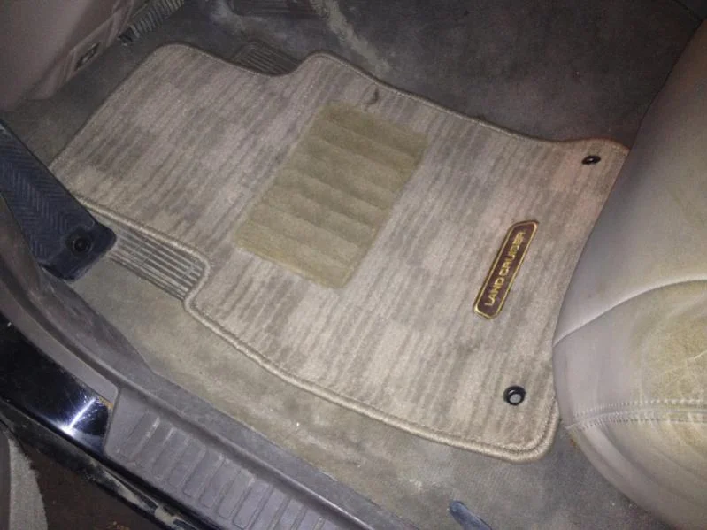

Check out the new floor mats courtesy Of our friends in the great White North. Insert "oh Canada" song here
:confused: I got OEM floor mats from CDan - no need to go to Canada :meh:
These are from a 79 series truck imported from the Gulf of Oman.
I know, no big deal, but nothing you can find at your local dealer.....

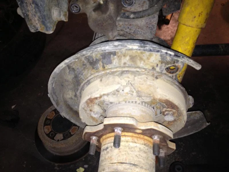

Got 100 miles on her on short test drives. Abs is freaking out, so need to figure out what is wrong there. Figure that I will pull the sensors out, clean them up and try again.
I did have to bleed the brakes out since I replaced the front calipers. Strange thing is that I always bleed the corner furthest from the master, then work to the driver front.... Well if I did that, the brake pedal had the worst feel, meaning the brakes did not engage until the pedal was low. So I did it backwards and it was best foot feel.
Does this mean anything??
My abs was freaking out with manual front hubs, locked them and no more problems, didn't see manuals on yours though. Bled my brakes same way, PS side first then DS. I used the HF vacuum bleeder because I was working alone.

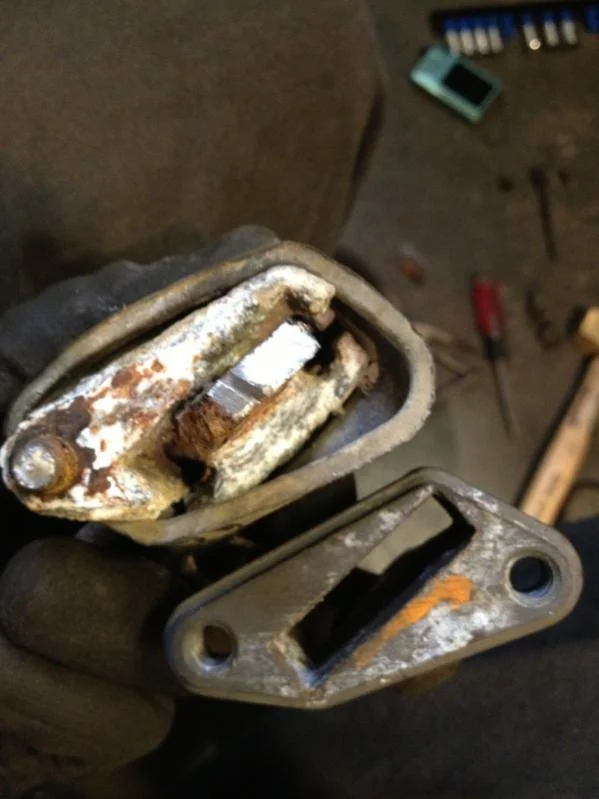

So, I took the junkyard axle and stole all the ebrake hardware off it, including shoes that looked new. Here is a picture of the old and new ebrake part. WOW.
