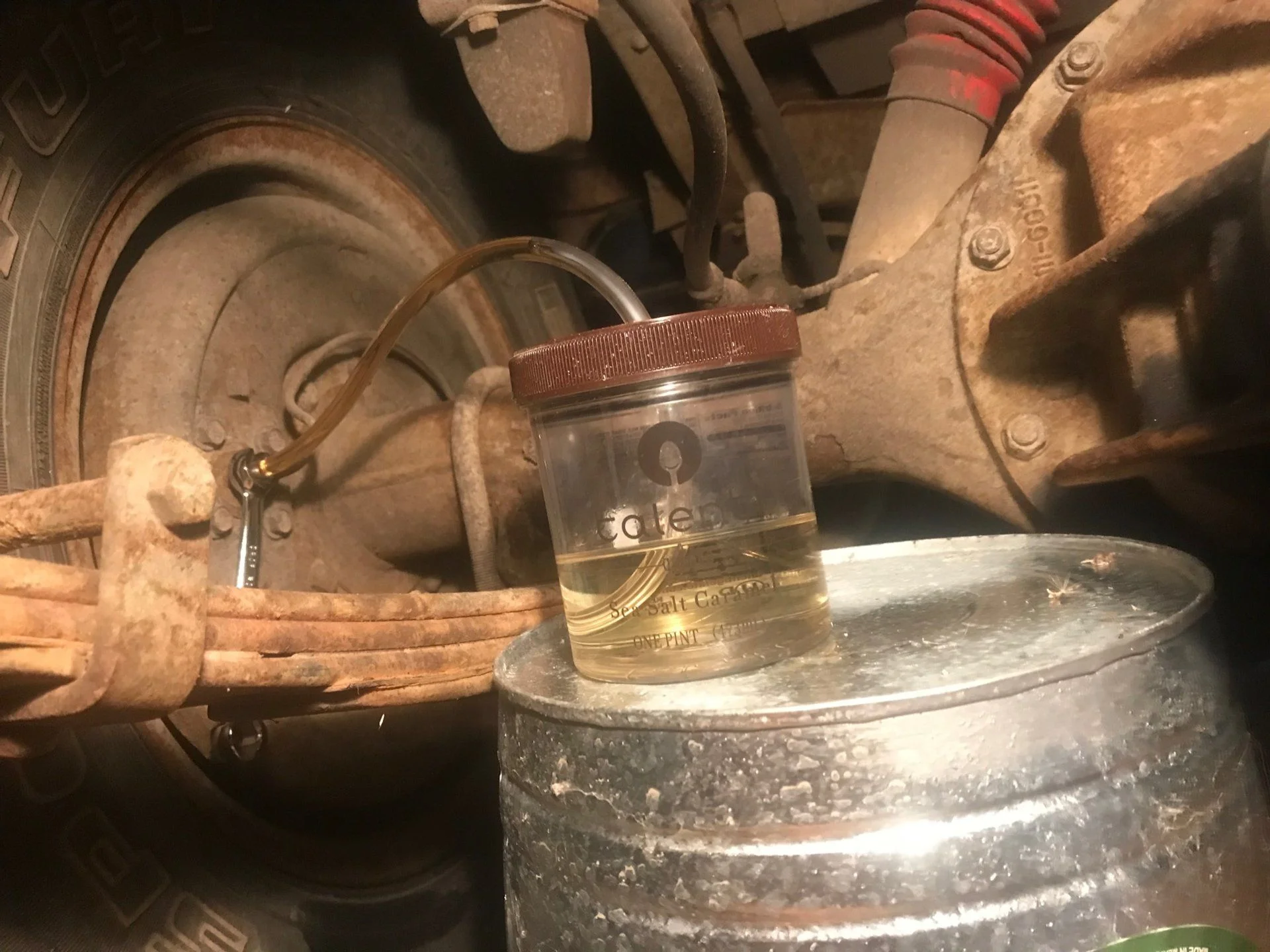

About 12” of tubing that fits on the nipple. Feed the tubing into a mason jar that sits on the leaf springs. Make sure the tubing bends above the level of the bleeder, this way you can depress the brake pedal yourself and come back around to tighten off the bleeder without introducing air. Only down side is you can’t see the fluid coming out to check for bubbles.

How do you keep the brake/clutch pedal down to tighten the nipple?

You don’t. The idea is that any air will be trapped in the high part of the tubing, so you can release the brake pedal without sucking air back into the system. It’s the same principal @pb4ugo is describing, albeit less elegant ;)

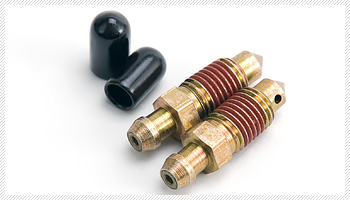

I just use speedi-bleeders. Simple one-person deal.

Speed bleeders, tubing and a jar. I would have some trouble getting a hard pedal before the speed bleeders (if I was by myself), I think a little air would get drawn back in if I opened the bleeder too much. It seemed more problematic on the rear drums. I tried to get my Sheppard to assist but depressing and holding the pedal is just one thing he won’t do. Once I installed the speed bleeders it solved the problem, no problems doing the job by myself now.

I love/hate speed bleeders. When they work they’re the bomb, but I’ve a high failure rate. Now I keep a few spares on hand.
