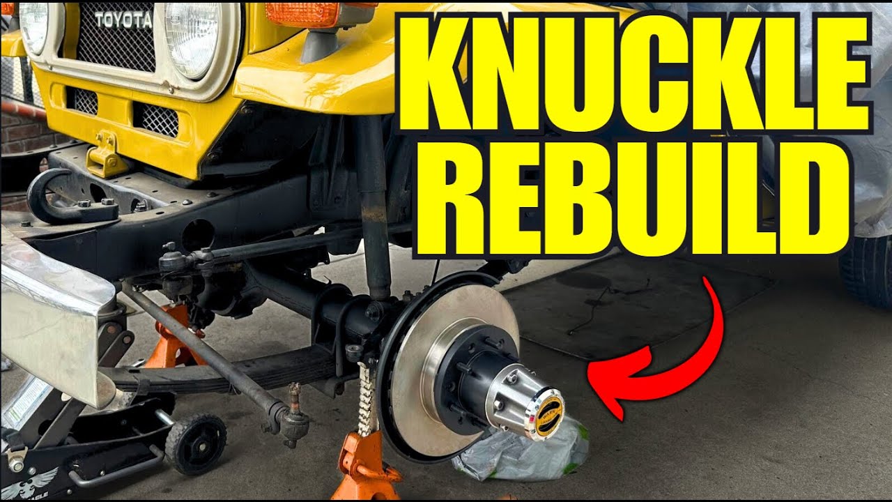

Well i was going to get started on a long overdue front knuckle rebuild. What am i missing here? Shouldn't there be a thrust washer that goes behind the spindle nut? All I have is the locking nut, locking nut washer and the spindle nut. Someone has been in there before. The locking nut and spindle nut were assaulted with a chisel. This is a 1972 FJ40 with the barrel style warn lock-o-matic hubs. Thanks for any insight.
Missing a lot. There should be that thrust washer but shouldn’t there also be another of those threaded nuts and a star shaped retainer that goes between them and gets bent over to keep them locked in place…?
I believe the locking nut with the small allen head screws takes the place of the second locking nut and the need to have the star retainer? But I would think I still need the thrust washer. That's why I am here, hopefully someone has seen this before. I have no idea and my manual does not even show the locking nut with the allen head screws. This is a March of 72 40. Could the dealer removed something when they installed the warn barrel hubs?
Yes, there should be a thrust washer. The washer with the holes and the spanner locknut with the set screws are a Warn thing.
I thought as much, when the only allen key that would fit was a standard not metric size. Any idea where to get the correct sized thrust washer. Everywhere I look I only see ones for 1975 and up? Will a 1975 washer fit a 1972?
IDK, Cruiser outfitters? I have no idea if they interchange. I know disc brake frt ends used a larger nut than drums. Maybe put a "wanted ad" in the classified section. Someone might forward one to you.
