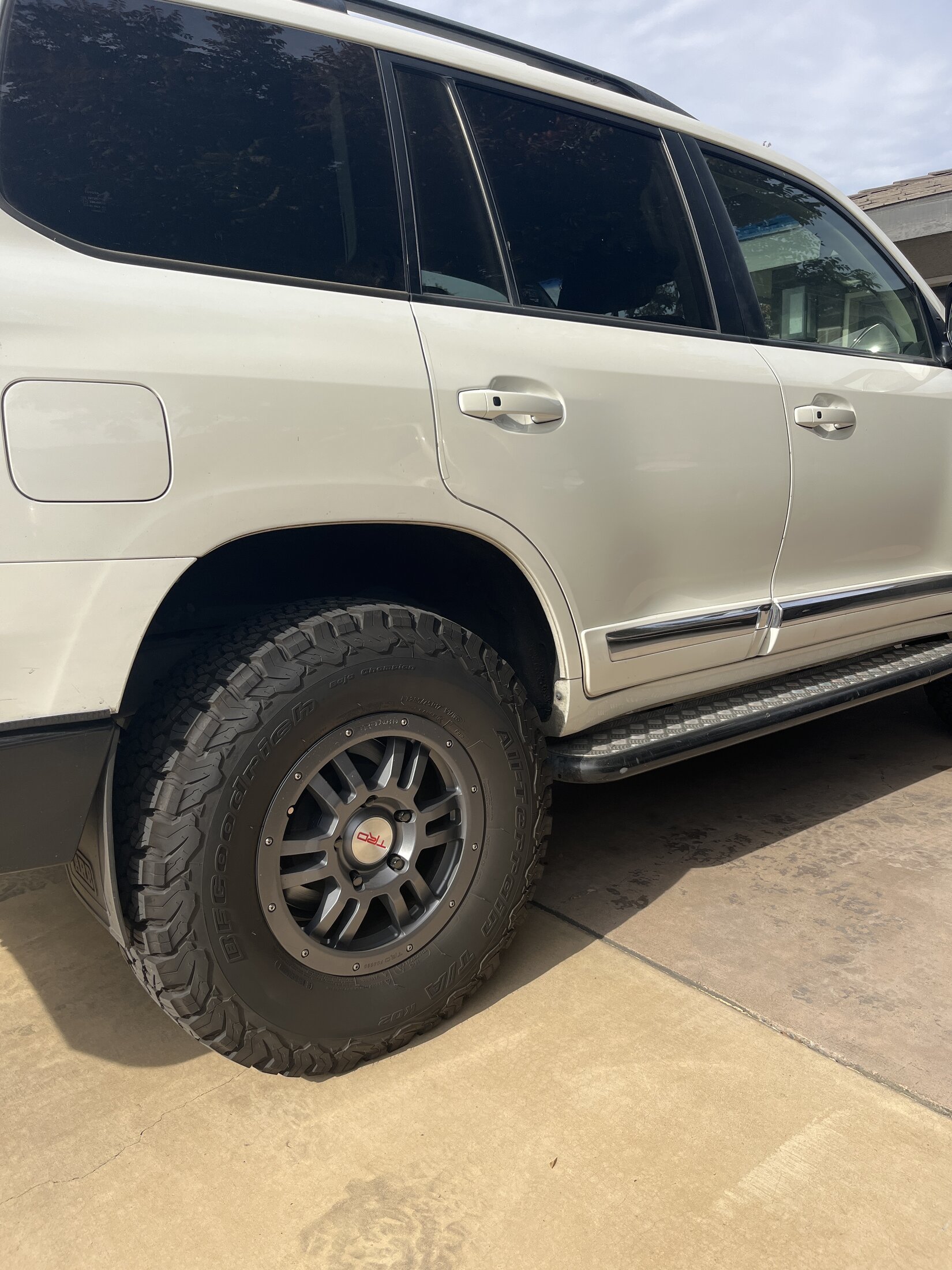

Finally got the Rock Warriors on with new BFG 285/75
