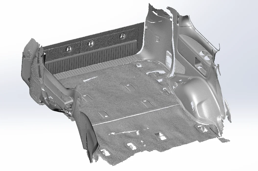

I wanted to ask if anyone here has solidworks compatible models of the 200 series, particularly the interior. I'm starting to CAD up a set of drawers and having this for a base would be really helpful if its out there!
I scanned the back interior of my LX to design a sleeping platform. If I can find the file, I can send it to you.
Would that match an 07 200? it certainly looks the same. Thanks if you can get it. what did you use to scan? I'd love to get my hands on the tool, its a good result!

It is a large file so I'll put it up onto my drive and send you a link to download. ~3GB

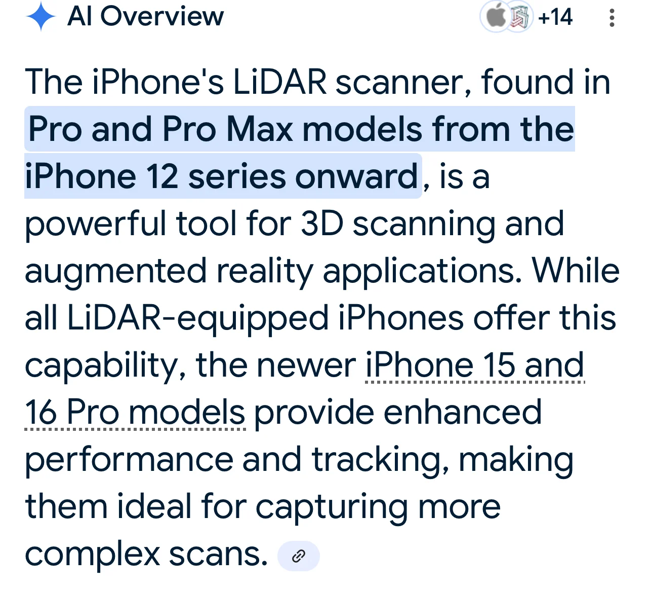

Do you have a newer iphone by chance?
It has a built in lidar, and the scan apps have come leaps and bounds the last couple years.
We were messing with it for 3d printing, scan a widget with the scan app, put file into Fusion 360, and print. It wasnt perfect, but it was impressively good. This was about 1.5 years ago.
Nowadays, ill bet its more accurate and advanced.
Just an idea to look into

Yeah. Good call and I should look into that.
I tried the apps for newer Samsung phones like polycam and it was awful. I ended up going with a revopoint miraco and its been great. Scanning in general as a decent learning curve to get perfect scans the first time. Modeling off those scans is a whole other ball game.
