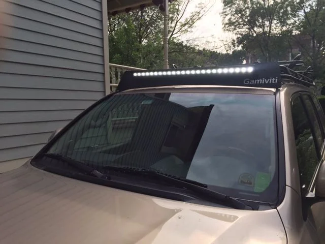

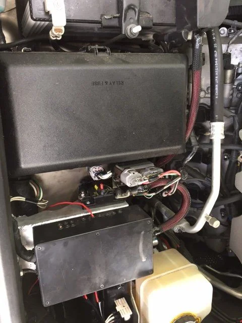

Finally got around to wiring up my front light bar and rear camp lights. I had a buddy who fabricated a mount of out a sheet of 3/16" aluminum he had (total overkill, but I think he just wanted to weld something). I promptly mangled his nice fab job by hacking out a portion so that the factory wiring harness and trunk release would route under it ok. I then mounted a Blue Sea fuse box inside a weather-resistant plastic box on it, which I drilled and grommeted (is that a word?) holes for future circuits. I didn't have any good blanks so for the moment I just used a small piece of wire to plug the unused holes. (
Biggest PITA was getting the wiring harness for the lights through the firewall. On the plus side, I'm pretty pleased with the Air On Board switches (though they seem very bright)

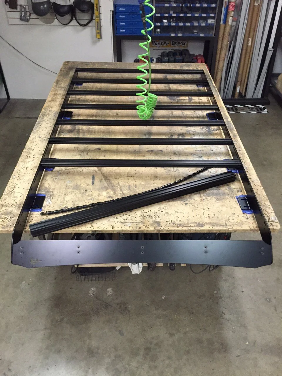

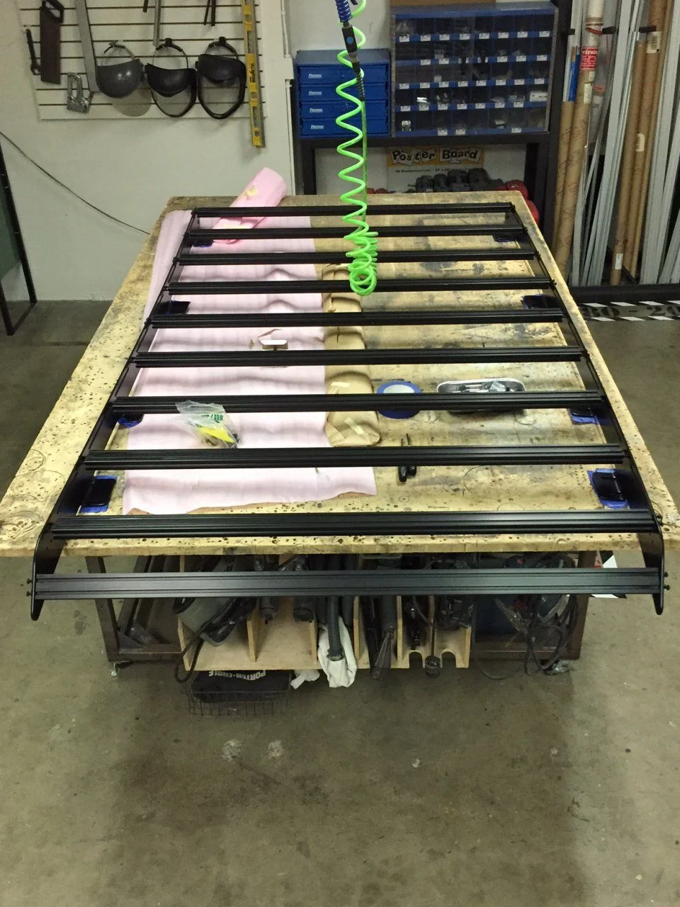

Got the roof rack pieces back from powder today WOOHOO! Ended up going with 20% gloss black to match the wheels, sliders (and now license plate frame):D I've assembled it without the two laterals above the sunroof for now...
ARB Compressor installed, THULE crossbars installed and factory crossbars removed. If anyone wants 2 factory crossbars, pay for shipping and they're yours. (claimed) Installed ARB 2500 awning using LABRAK brackets (LabRak Awming Mounts. Thule Yakima Inno Rhino). I'm waiting to mount the RTT to adjust the awning front/rear to match. I also have a Safari snorkel in my garage waiting to be installed.
