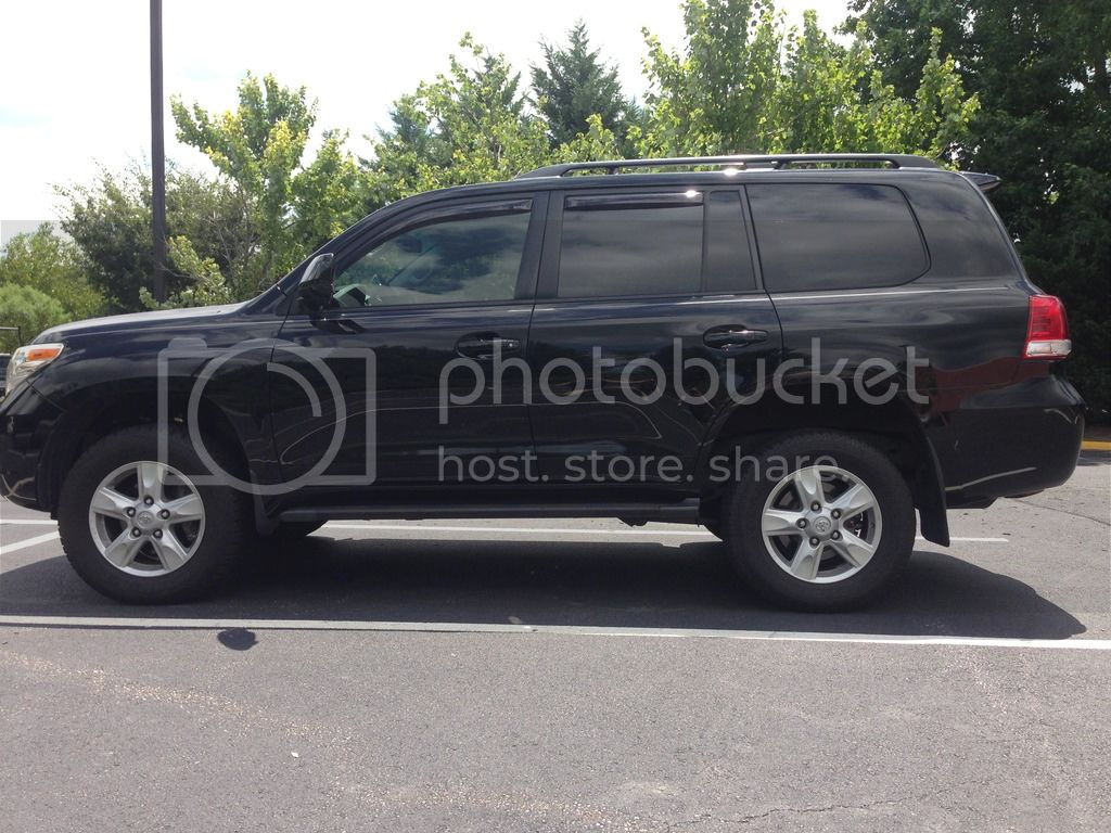

Got the BP-51 kit installed by a local shop! 2722 Springs in the back. SPC UCAs. Everything else is stock. KO2's on order.
Only drove home, so not much to report. So far, it just feels different, and sits slightly higher. I like the rake.
I need to get under there and see what they set the bound/rebound settings at.
(Front)
(back)
(Front)
(back)
That rake looks pretty extreme for an SUV. Honestly from the picture is seems you have bad front shocks.
Really? Both? They called me to make sure I was OK with the rake. It looks similar to others based on forum pics. Maybe its just the angle of that pic? I'll get another pic up.
They did adjust the preload for stock if that makes a difference?
How much thread can you see at top of shock? Can't tell in your front close up. Also is that driver or passenger side?

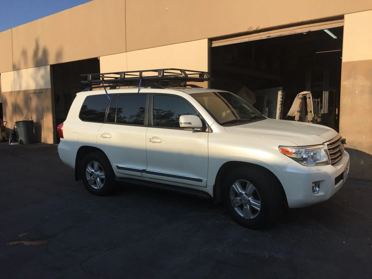

I leave for a nice long vacation in the morning, including the 200 meet in CO. On the drive home from work the shop called letting me know my ARB rack had arrived. After some quick deliberation I detoured down to the shop to see weight/bulk wise if I could DIY this eve by myself so I could use the rack on this trip. Not the brightest thing I've done, but other then the frustration caused by dropping the little "L" plates over and over it was a success. Just over 3 hours to remove the factory rack and install the fit kit and ARB rack. Now I have some more storage space as well as the first external mod. :)
And the ratchet straps were just to get it home from the shop.
It certainly could be the angle of the pic. What's the measurement height from bottom of hub to bottom fender front and back? It should not be more than 1" difference in my opinion. My SUV is exactly 1" lower in the front. Once I get BP-51 it will be level since I don't tow anything.
Can you take a couple of pics of the completed job :-)
Its ~1.5 inch higher in the back.
2722s for the rear are for a constant load. Do you have plans for drawers, towing, etc?
Driver's side....i see thread below the collar. As in, the collar is at the top. Looks like it is all the way up.
I have about 3/4" thread at top.
I have 22's in the back as well, which I have no issues with and rides great. Stock back there currently.
