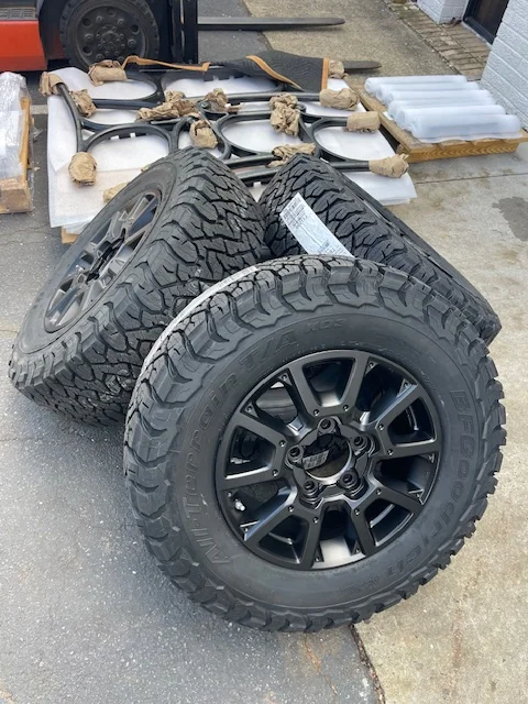

Picked these up from a week at NVcoatings in Chantilly Va today. They're standard Tundra takeoffs, but media blasted and powder coated satin black..
I have DBA rotors to install this weekend, fresh pads, and new kicks. I went with 275/70r18 BFG KO3s.
Not sure where I'll use the toyota logo (I have a '15 LX570), but they were kind enough to blast the DIY white powder coat off of it that I did about 15 years ago for one of my 4runners and match it with that same satin black.

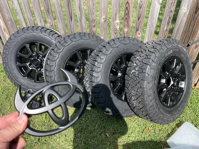

Looks great.. might want to verify your lugs fit into their spots on these before you get excited to go install. I've found that PC is thick enough to cause issues with tight clearances like that if it isn't masked. I had some wheels for a previous vehicle powdered and both the lug holes and center bore turned into major inconveniences.
Torque also needs to be checked a few times as the powder coating compresses with use.

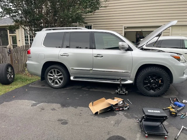

Here's the mid install comparison. I did spacers, rotors, pads, new wheels all around today, but this was the only pic I took. Now to address rubbing and work on blacking out s***.
Edit: Ha, looking at this pic, I'm messy af. I have stuff all over the place, but whatever.... it all went back to the right spot.
I’m surprised you’re getting rubbing. I thought this was a pretty common size for the 570.
How big of a spacer? Where are they rubbing?
I have the same size tire. I had a 1.25” spacer at all four corners because it looked cool, but I didn’t care for the scrub radius…especially on trails. Anyway, they’ll rub without moving the front of the wheel well liner forward. I also had to remove the front mud flaps. Looks great. Congratulations
1.25" spacer, rubbed on the mudflap when in full turn. Some people will cut that, I just removed it and put the screws back

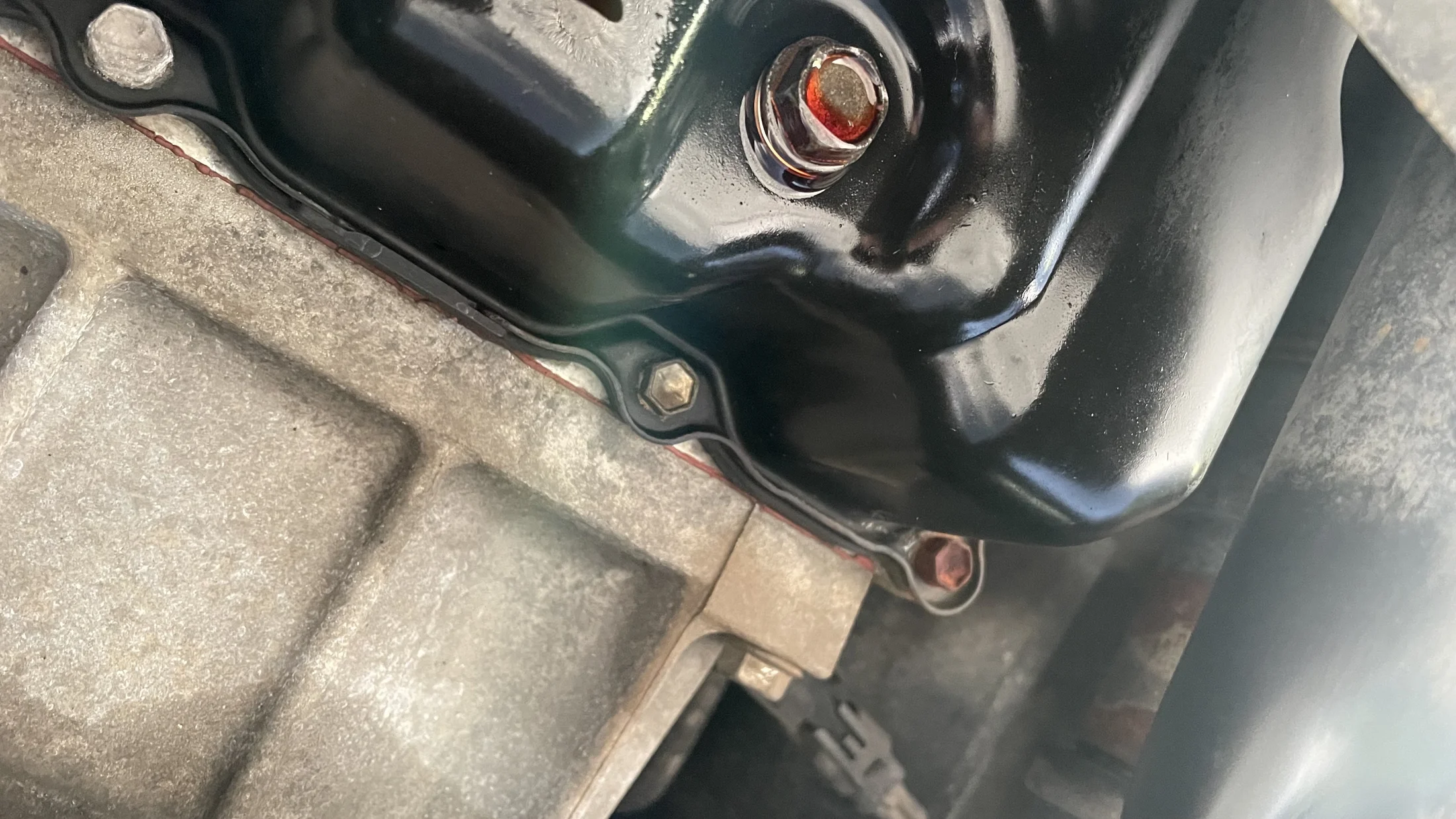

Took my car to the Car Care Nut shop (TCCN Automotive) for a trans drain/fill and they left me with a leaky drain plug. Guess that shop is not god-tier after all 😂😂View attachment 4000163
All hail his name!
But seriously, call them up to let them know. I am SURE if there's a shop that would want to know and make it right, it's them.
