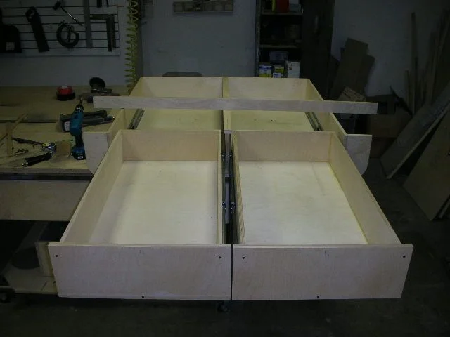

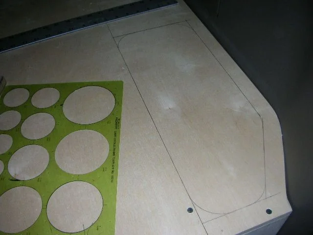

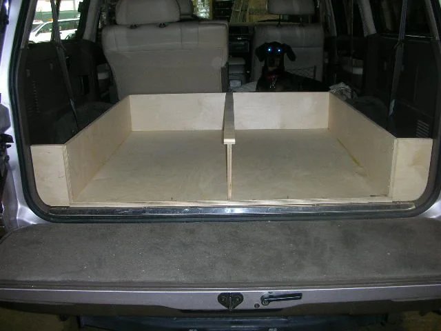

Here are some preliminary pics of the rear portion. I've started on the front sections as well but no pics. You'll notice the outline of what will ultimately be a removeable door behind the wheel wells (this will be modified to allow room for rear cargo hooks).

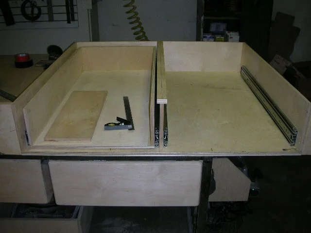

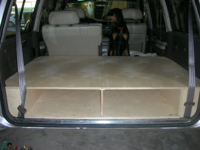

More pics:

looks like a real nice start, id like to see what you do where the 2nd row is, that is my hesitaion so far till i work out a good plan
Like I said, I've already started on that section. It will be bolted down to stock seat bolt holes as well. The two sections have an angled front to allow a little recline of the front seats. They will bolt together if I'm using both of them (for better strength/rigidity) and although I haven't decided on the doors for the top yet, they will probably hinge along the front edge and use the same type of latches as I'm using on the drawers only a little smaller.

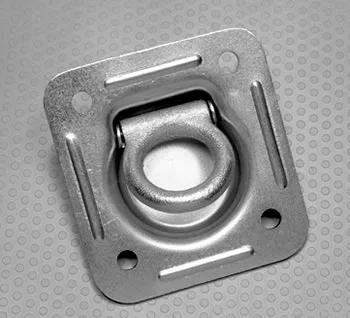

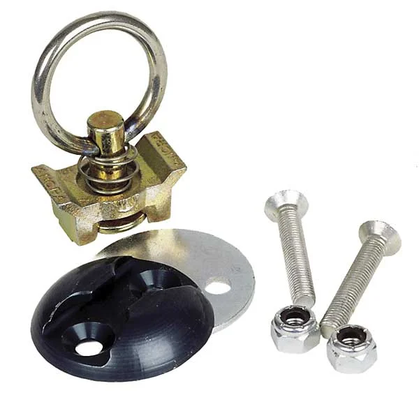

Well I haven't done anything sustantial since Saturday. I'm a little undecided on my cargo hold downs. I cant dial in the top until I come to a decision.
My choices are:
1.Flat plate with pivot ring (flush mount)
2. Aluminum track type (this will require building a structure under the top to support its entire length)
3. Aluminum nubs that use the same rings as the track
4. A threaded and removeable ring. Basically a large nut and bolt type piece that is hollow and sandwiches the top of the platform and allows screwing the ring into it.
Any experience or opinions with/on these?

i would use the first option, the flat plate with the ring
That's been my first choice from the start as well. I'm worried it will look too industrial? If the pin can be removed, I can get the plate powdercoated which would look pretty good.

Is the drawer hight about 7"'?
The opening is about 8" I'm pretty sure. That would make the inside of the drawer 7 1/4".

Looks similar to what I'm planning - though I'm not interested in removing the middle seats at this time. Something similar to that first tiedown is what I want to use as well. Where did you find it? And how do you intend to attach the whole thing to the floor - Drill new holes? Remove thge seat hardware and use those holes? Attach to the seat hardware somehow?
