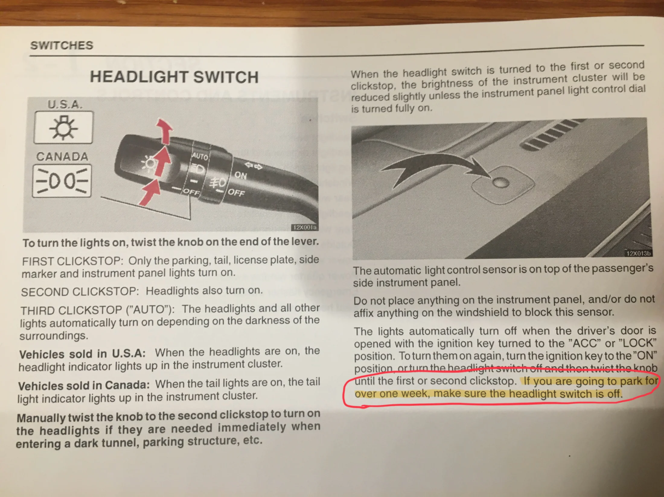

For #10 on your list, start with making sure the headlights are in the OFF position, and not AUTO when truck is off.
Does this drain the battery if the switch is in Auto? I leave mine in Auto all the time and haven't had any issues...
If you park it for a week or so without running it, it can drain down battery voltage if left on auto in my experience.
There’s a blurb about it in the owners manual.
I think the photo cell keeps working and drawing power while set to Auto.
There’s a blurb abut it in the owners manual.
I did not know about this… headlight switch in auto can drain your battery…
But THERE IT IS.. right in the owners manual.
Thanks for the info.

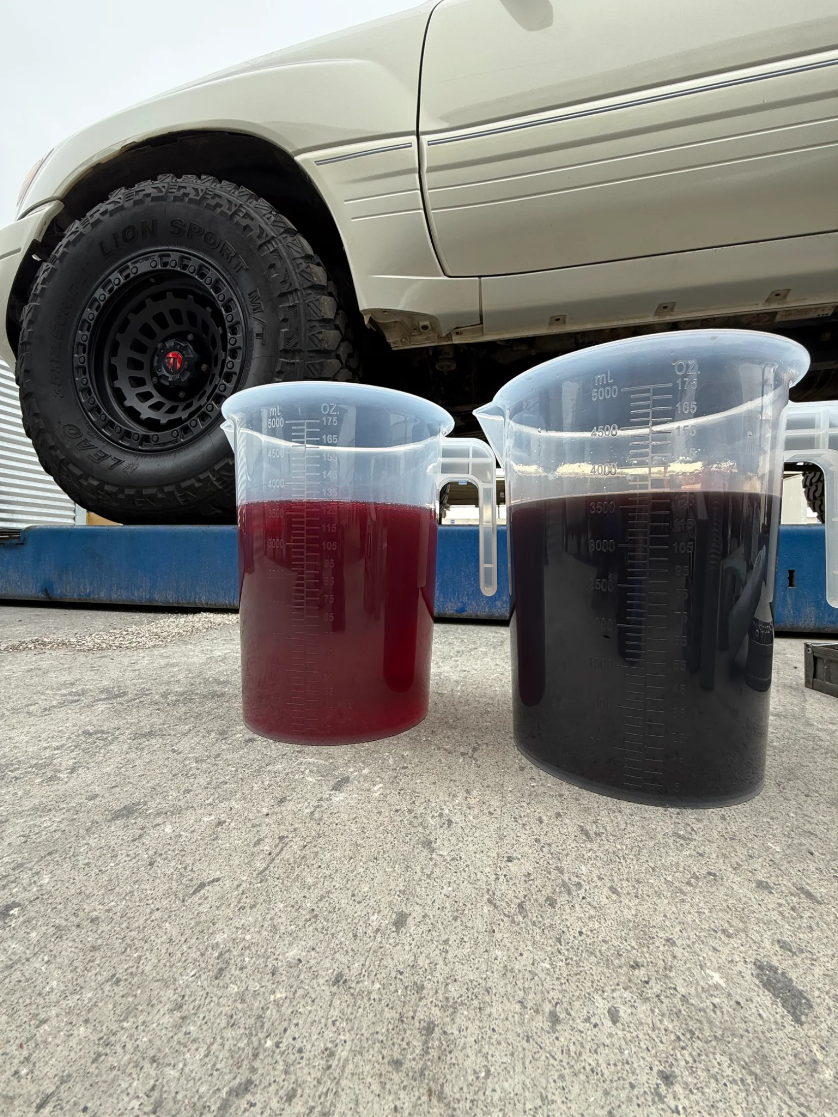

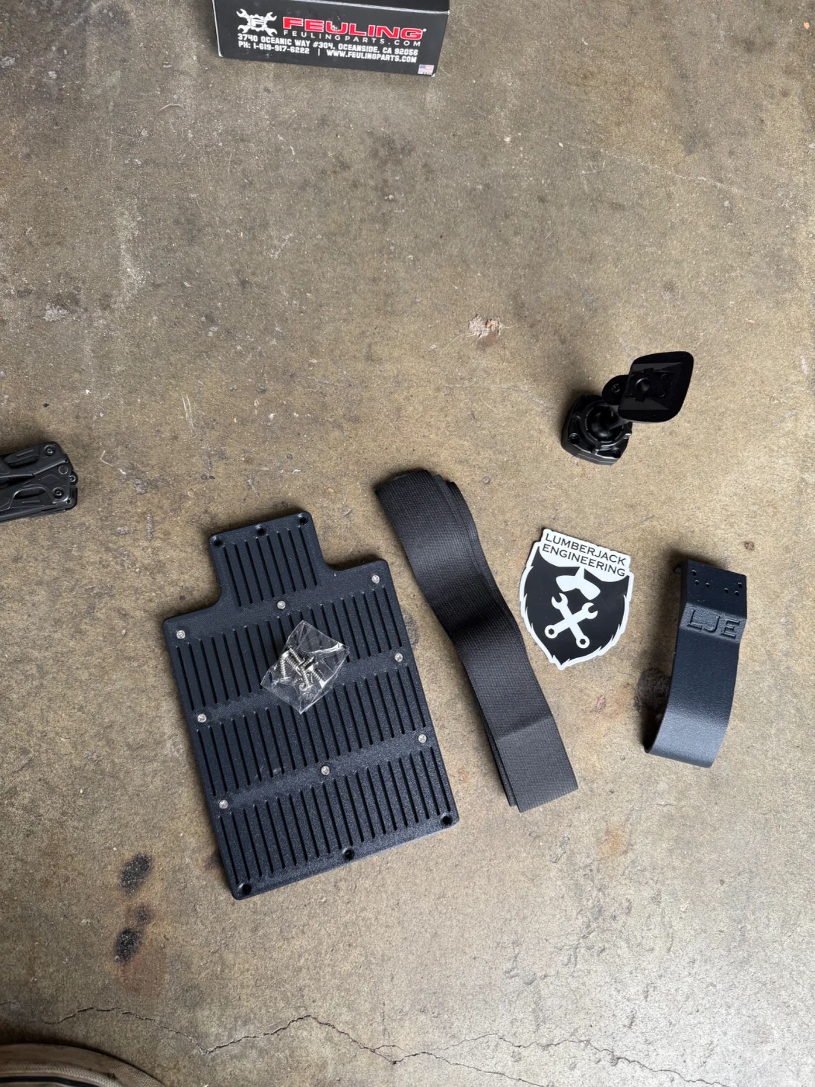

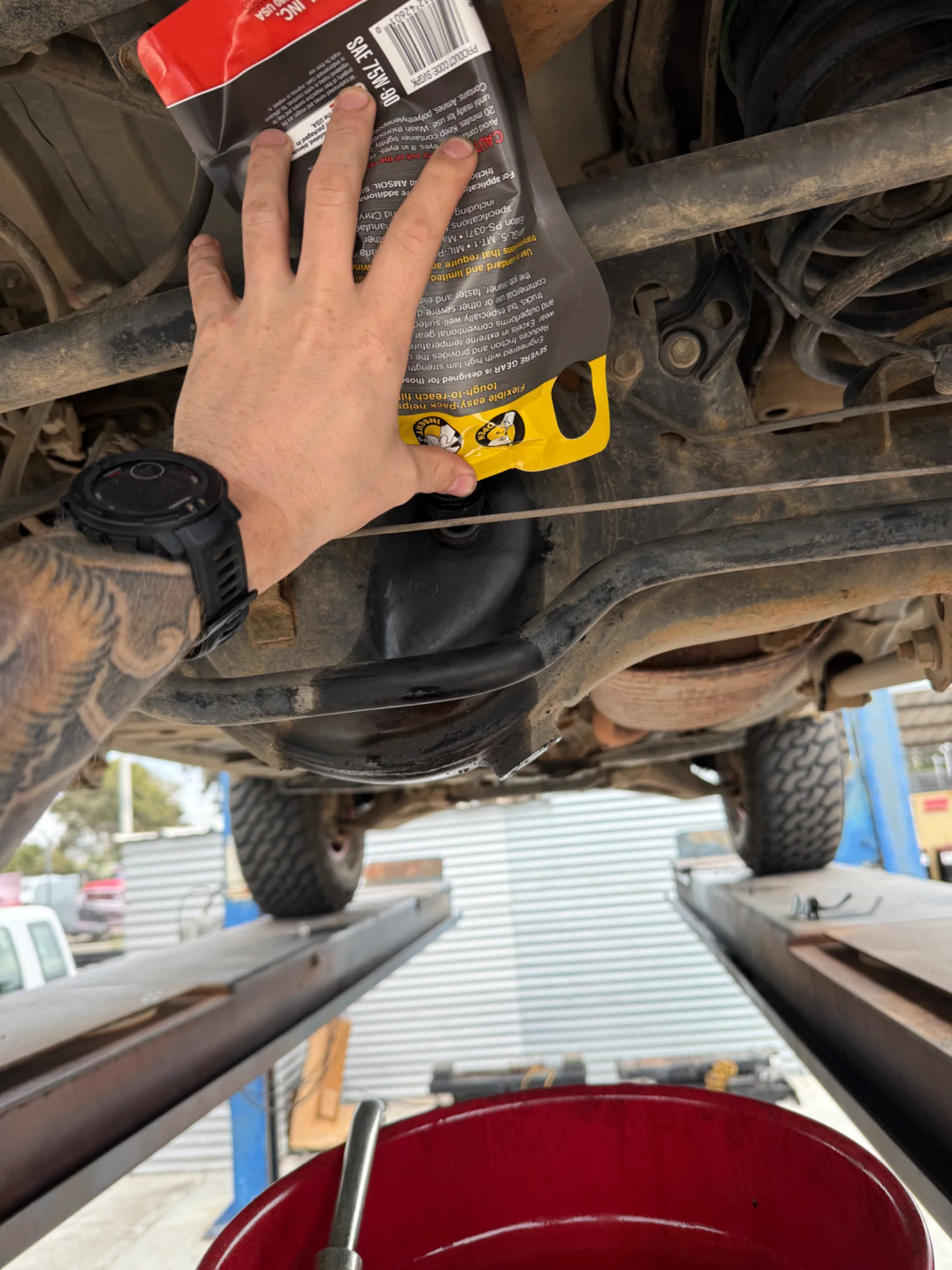

Went to go drop off some scooter parts for powder coat. Then did a transmission drain and fill for the first time today while I was changing out the oil in the diffs/tcase. Got some goodies from LJE but couldn’t get too far before the rain started

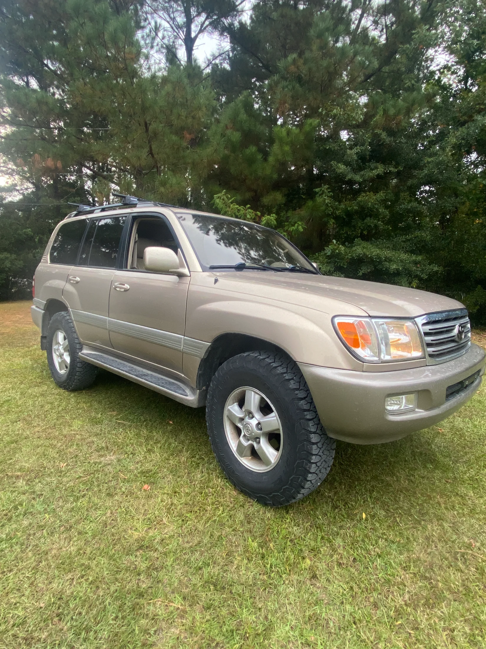

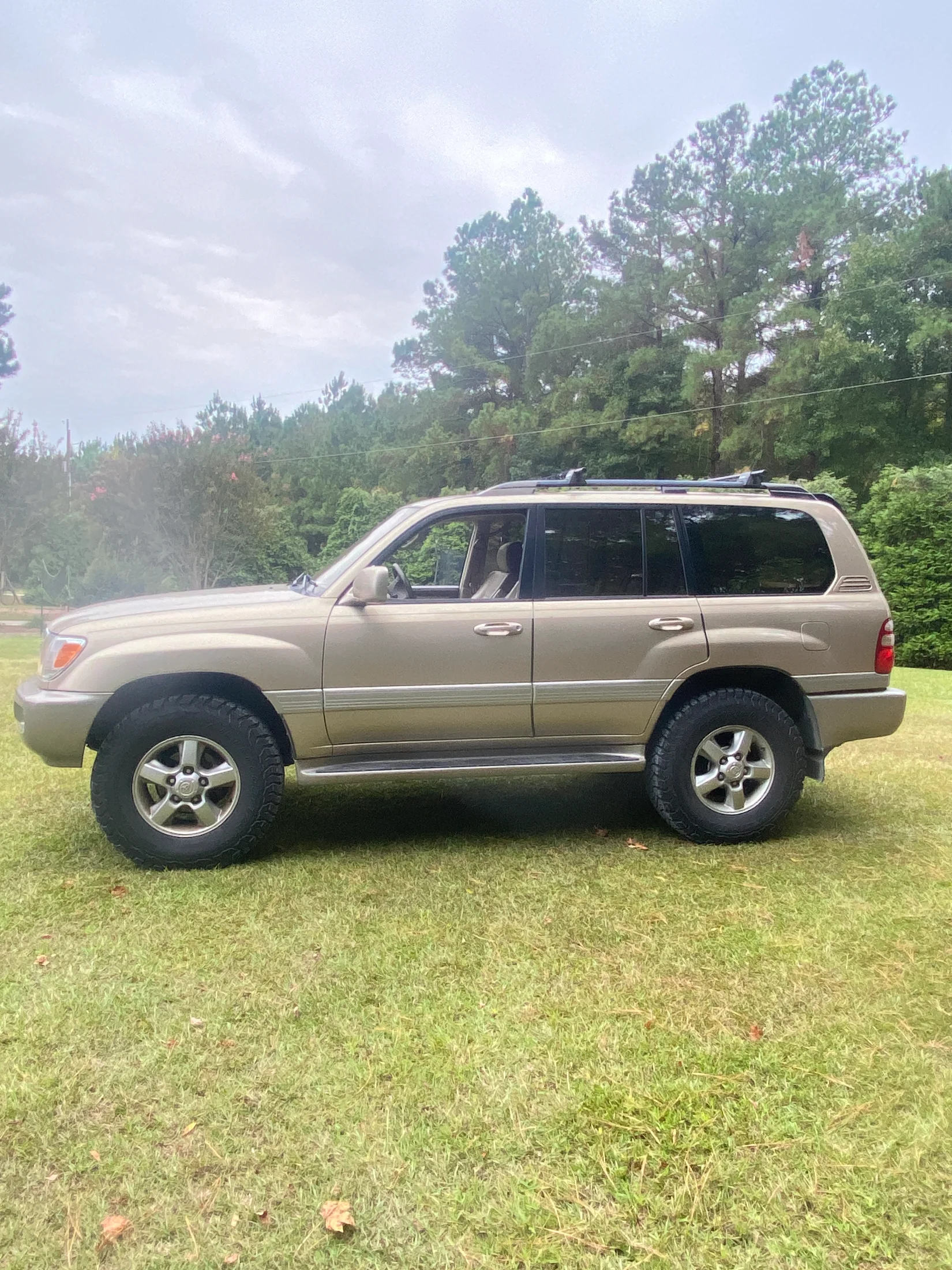

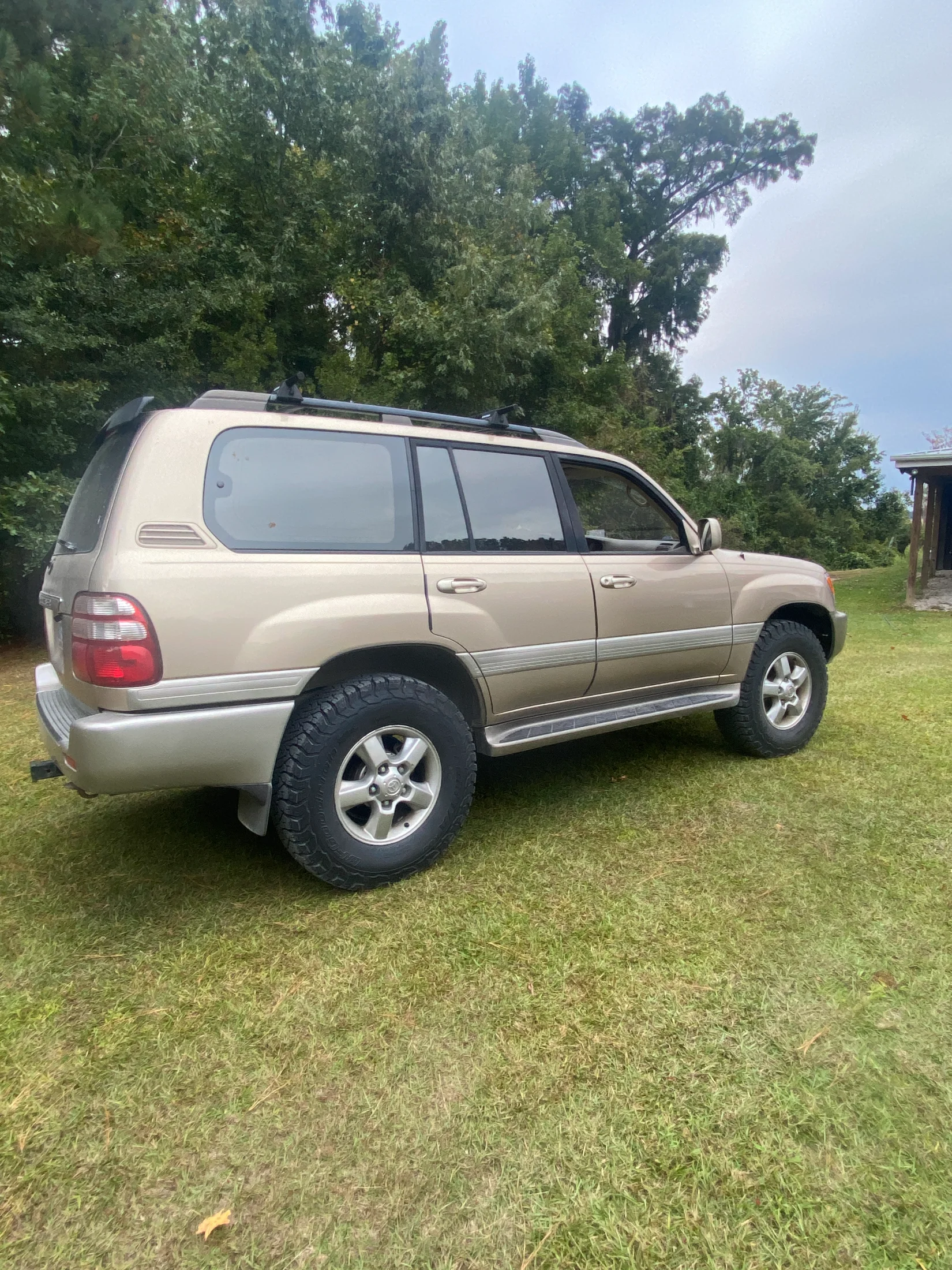

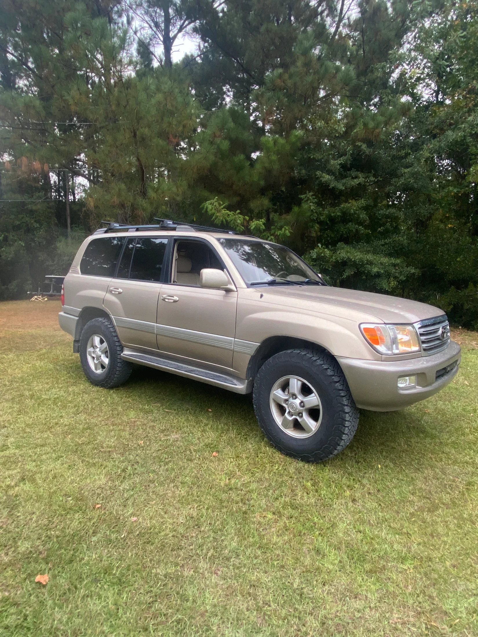

Added the 2" Ironman nitro gas lift and 285/75r18 BFG KO3s. My 100% stock suspension was clanking and squeaking around at 130k so figured I'd do what I always wanted to do and get it looking a little more level and a bit taller. I had a non lifted 2000 model that I put 285/75r16s on with a torsion bar lift. Maybe should have gone that route to keep the stock suspension ride but honestly the ride is just slightly tighter and I feel like it will settle in over time. My current one most definitely looks like a different truck altogether with the lift and 285s. Gotta hike up the leg a bit to get in but it looks great.
35s look good on the 100!

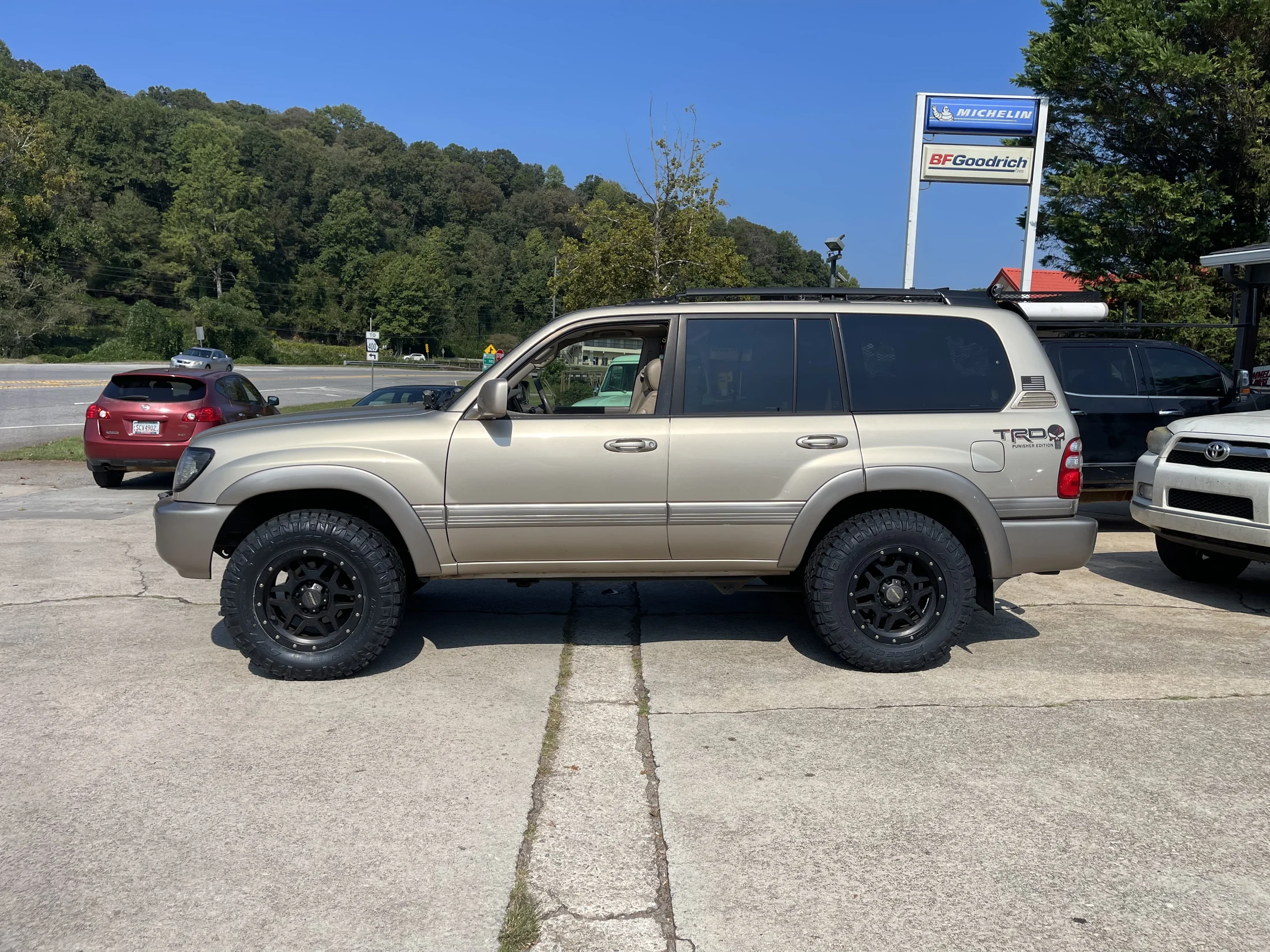

LC got a new set of shoes today. Been needing new ones for a minute… (Nitto Ridge Grapplers LT275/70R18). Love these tires Got a set on my 4Runner and they have been great!

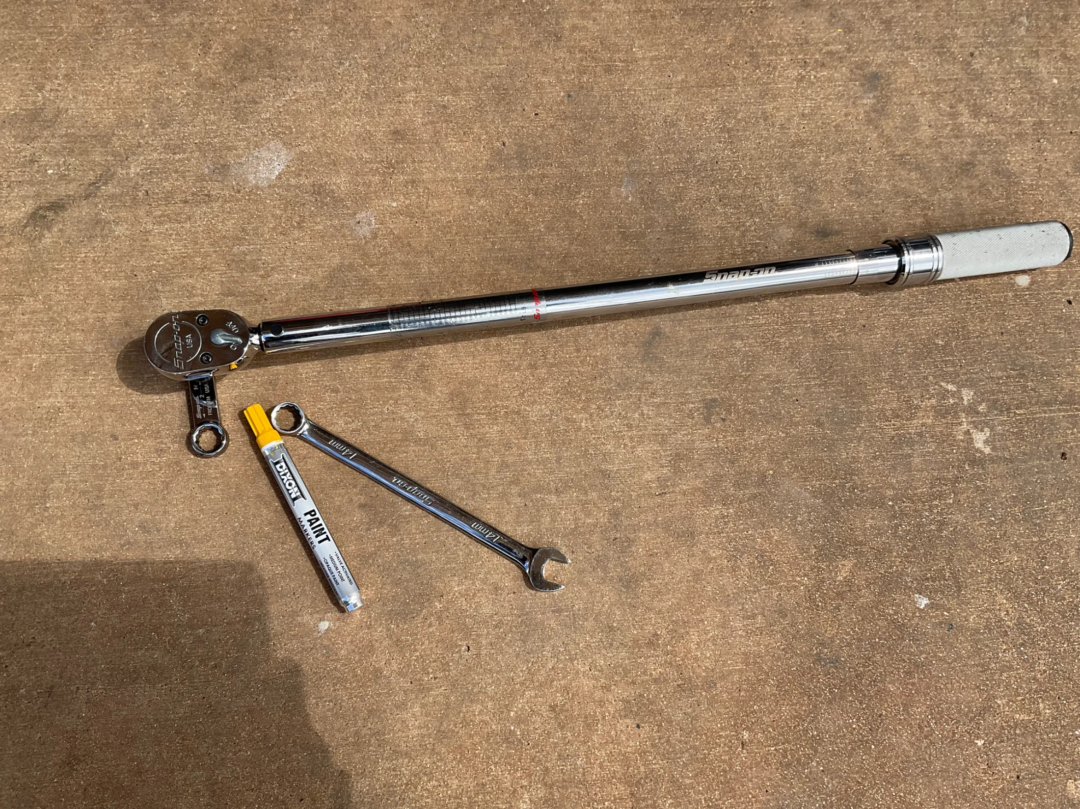

Re-pack front wheel bearings service coming up soon. I have collected all materials for this task, and was going over in my head what I might have forgotten… but I think I’ve got it all. Then I started thinking about the preventative maintenance inspections that I may not have done on my 2002 LX…
I have had this vehicle for five years and have completely gone through everything on the truck… But I have never checked propeller shaft bolts torque. Why? No idea. So that’s what I did today, and it surprised me that 2 of the front shaft bolts to differential were not loose, but not even close to being torqued properly… all of the other bolts were right on the money.
So if you’ve never done it, torque your propeller shaft bolts, and mark them… Because if they’re not marked, they’re not torqued.
Doesn’t take much, but a box end torque adapter is REQUIRED for the rear bolts at 78 foot pounds… you’ll spring a crows foot at that torque. The front bolts are only 59 foot pounds. And it doesn’t take very long with a helper to hold the brakes.

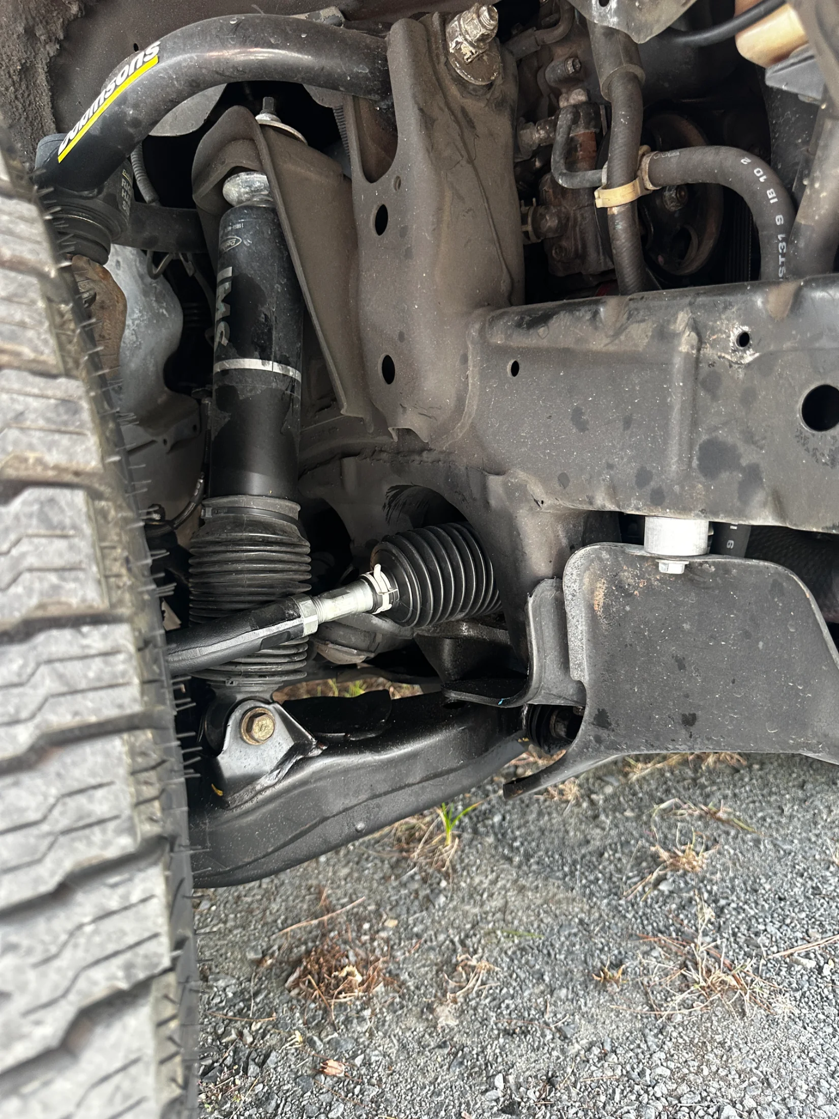

New steering rack (new Toyota, not refurb)

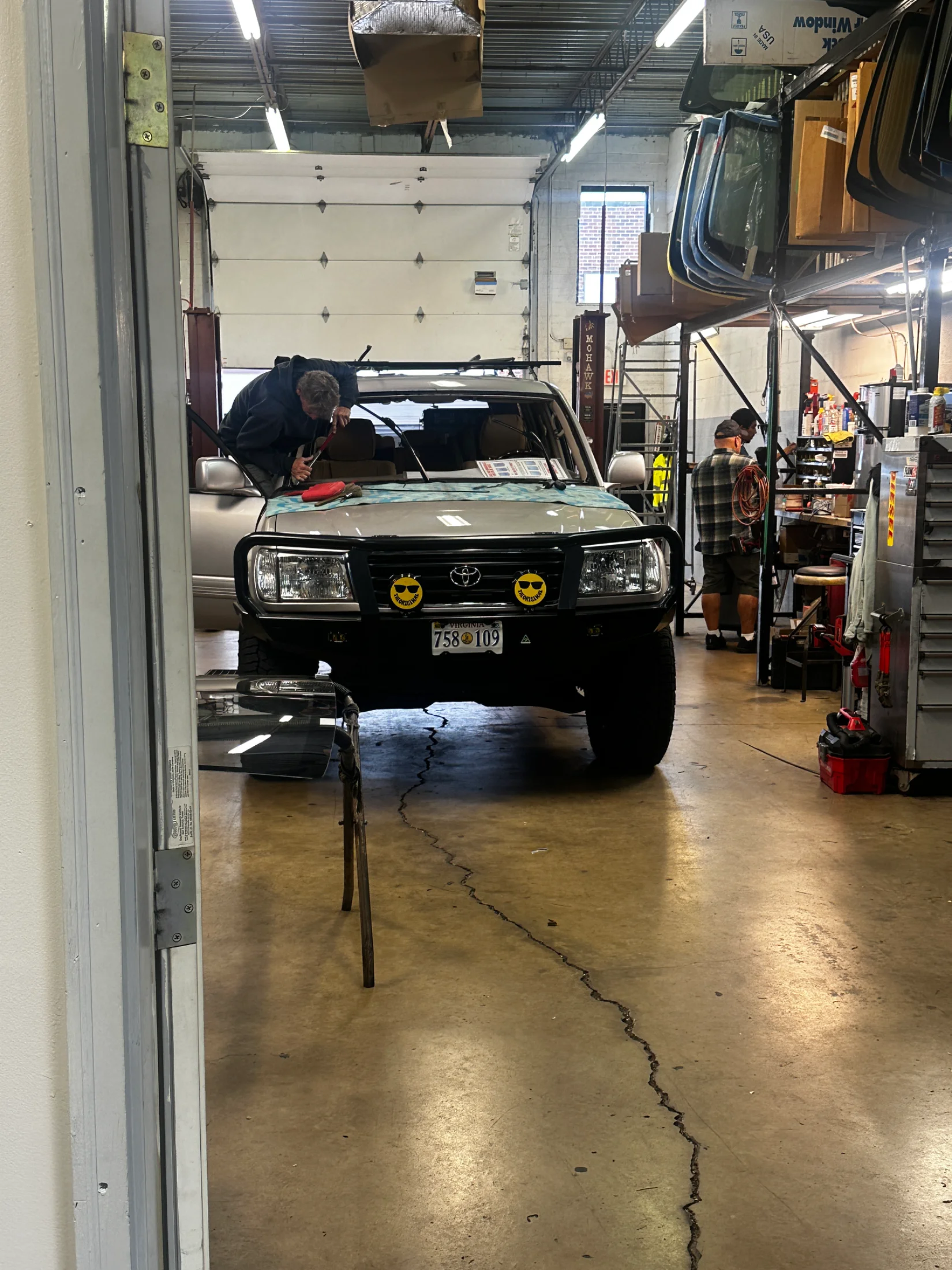

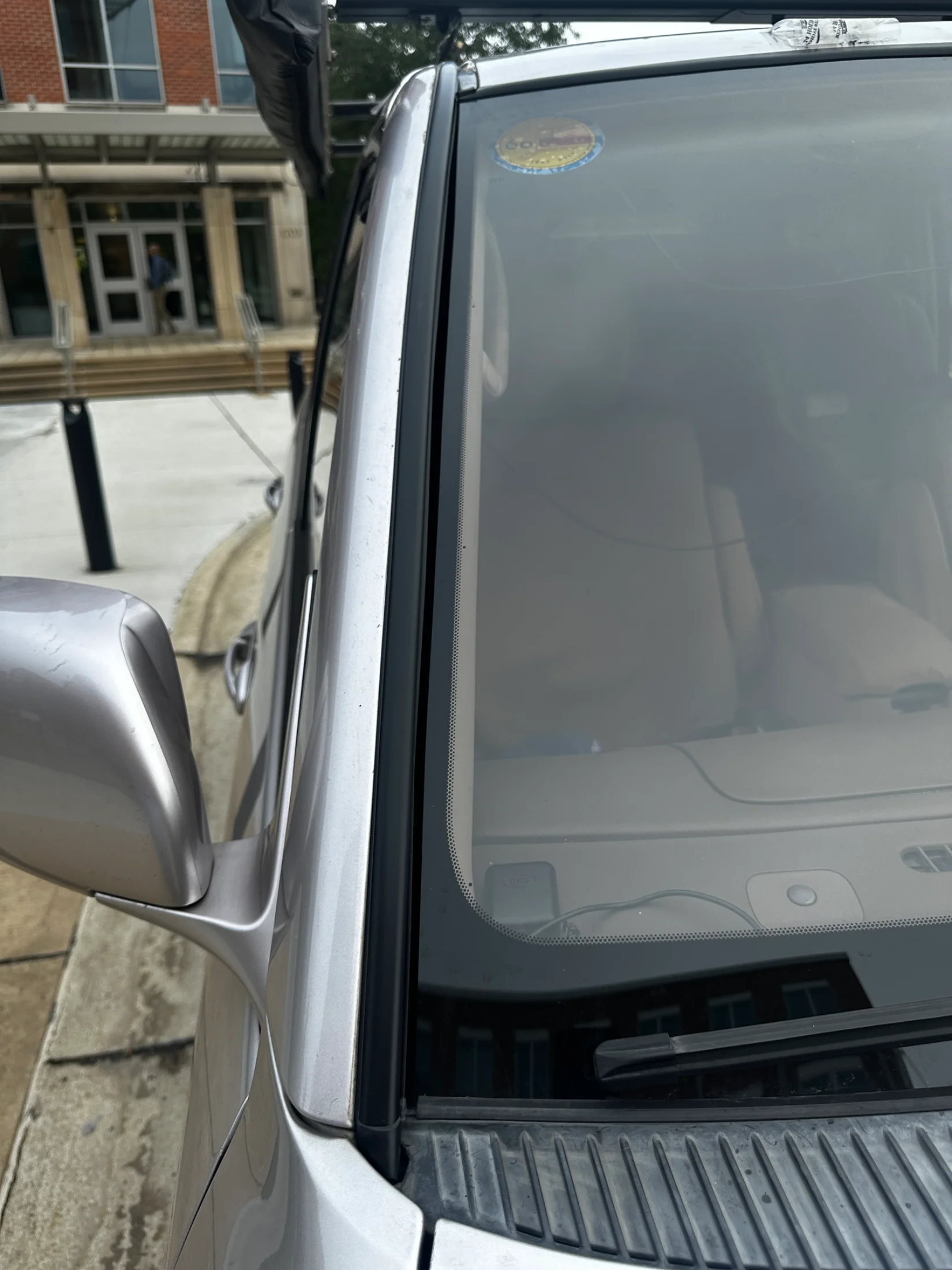

New windshield done properly with all new Toyota bits/trim

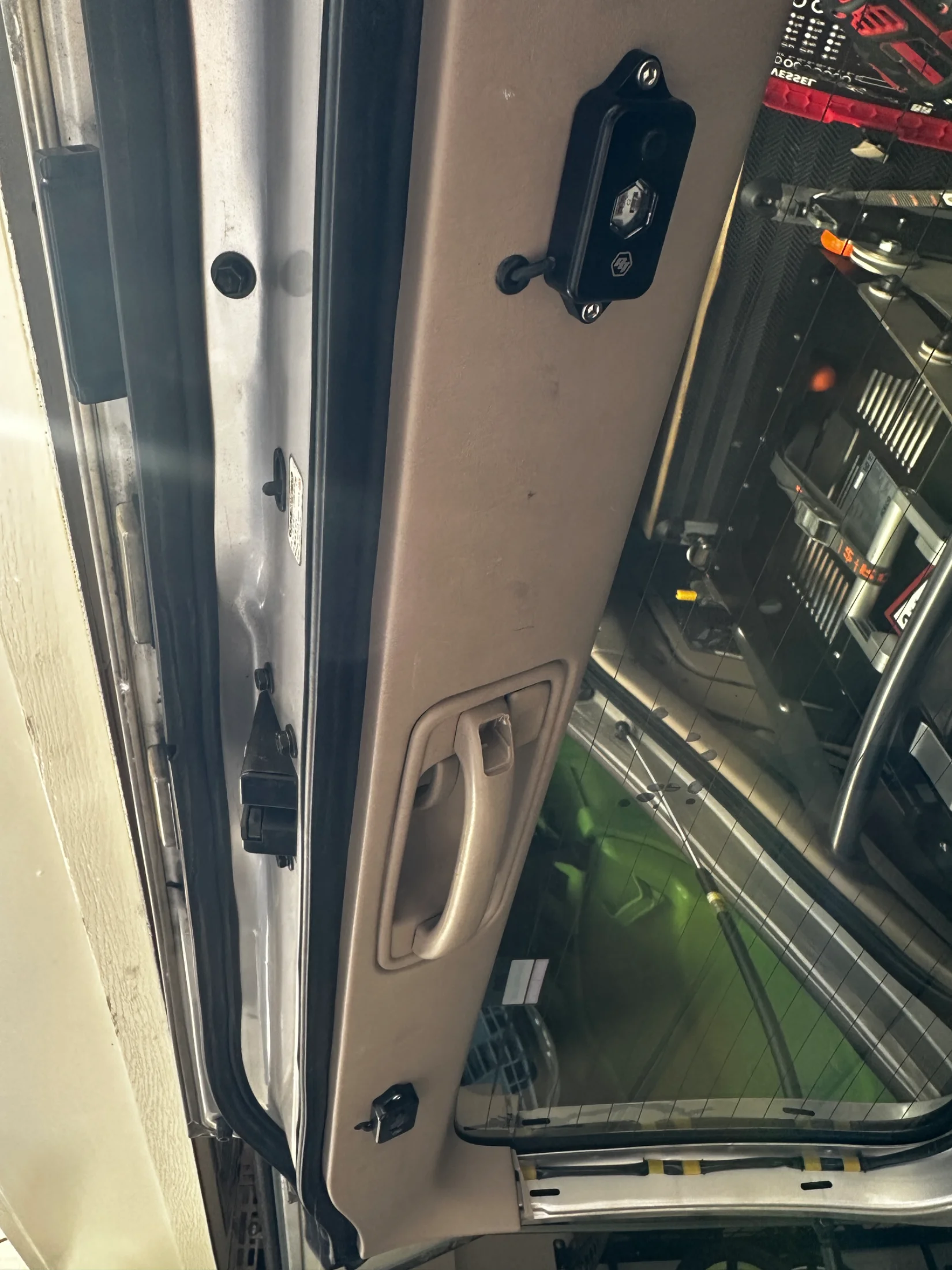

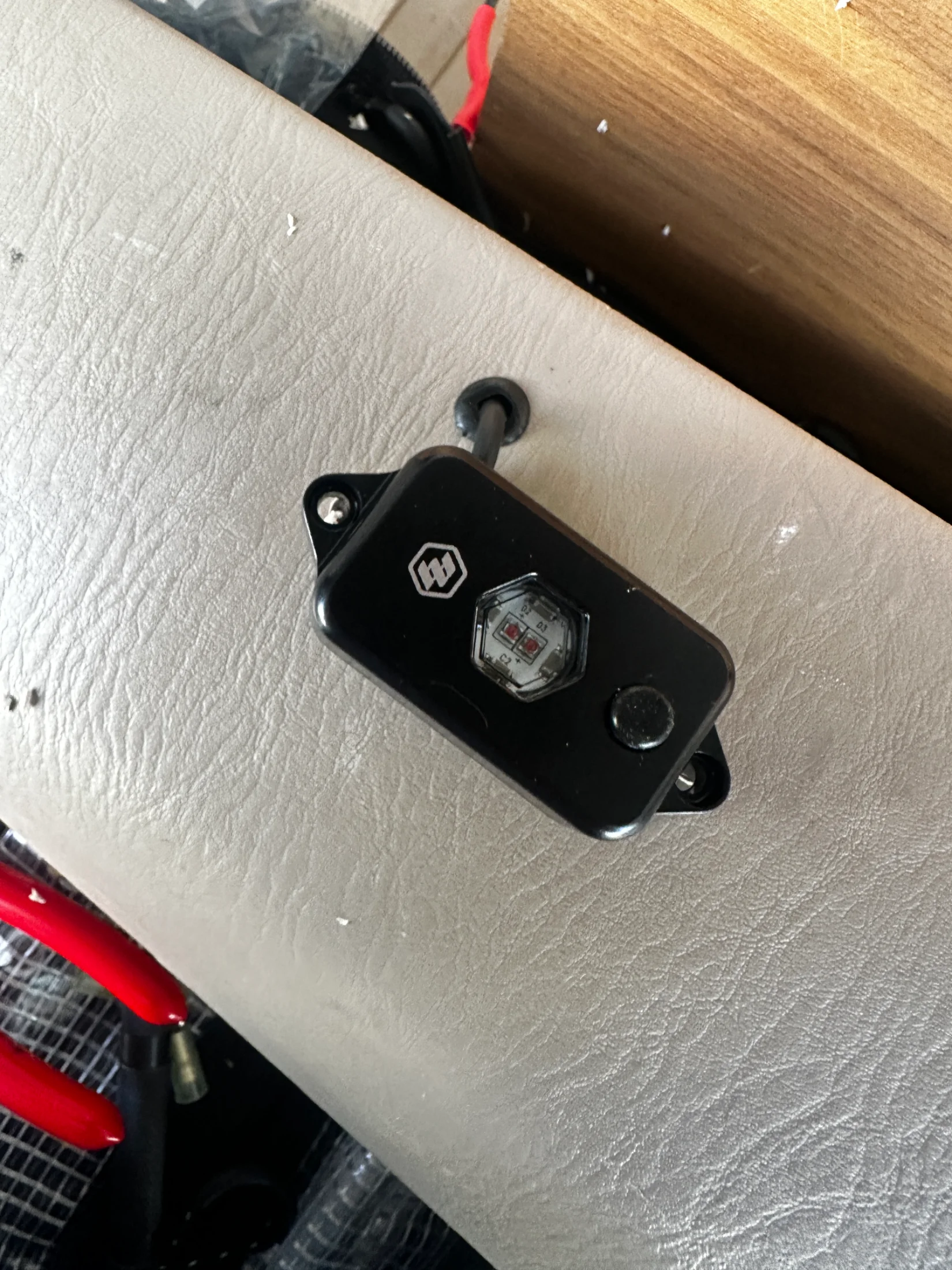

Added some Baja designs led with the built in switches to the lift gate. One white, one red
