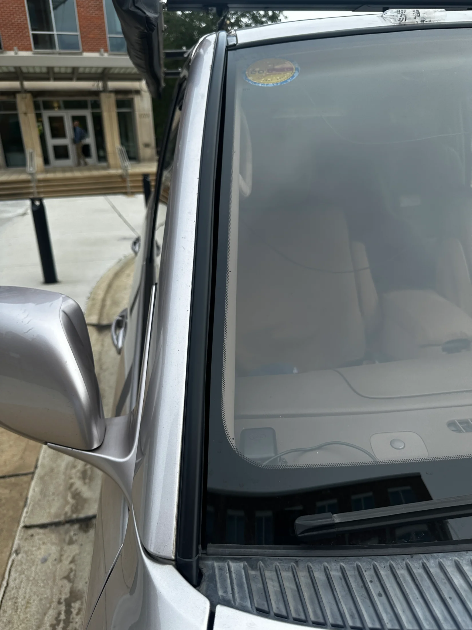

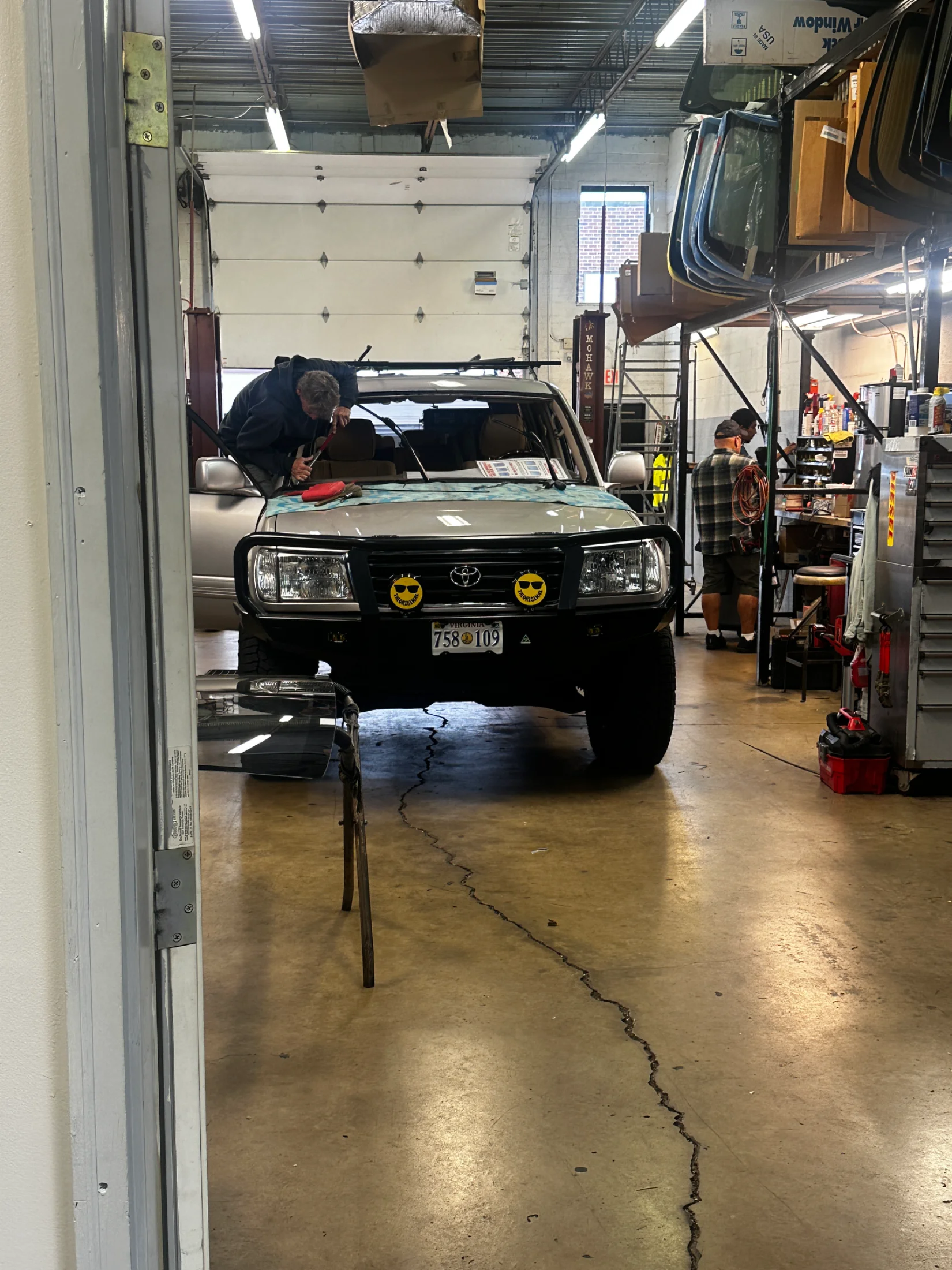

Where'd you go for the windshield? I got a foot-wide crack in mine Thursday. Night view too.
Looks like Windshield city shop in Chantilly VA. Owner does great work and nice guy too! Had them put new lexus windshield in the lx470 earlier this year. Highly recommend them, they do all the work for local lexus dealer too.

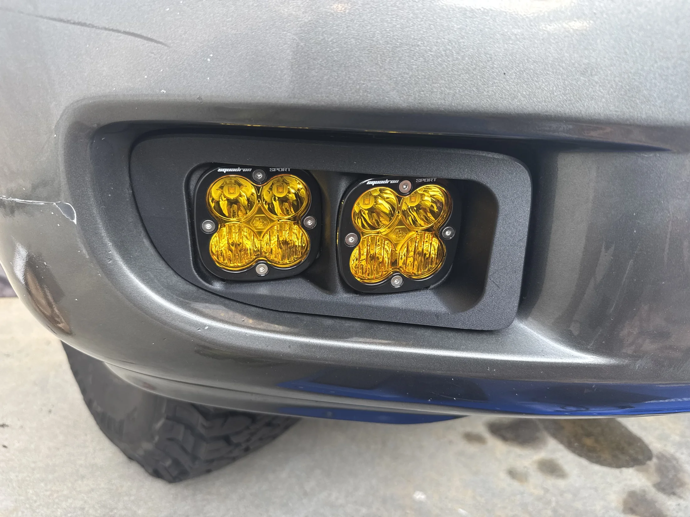

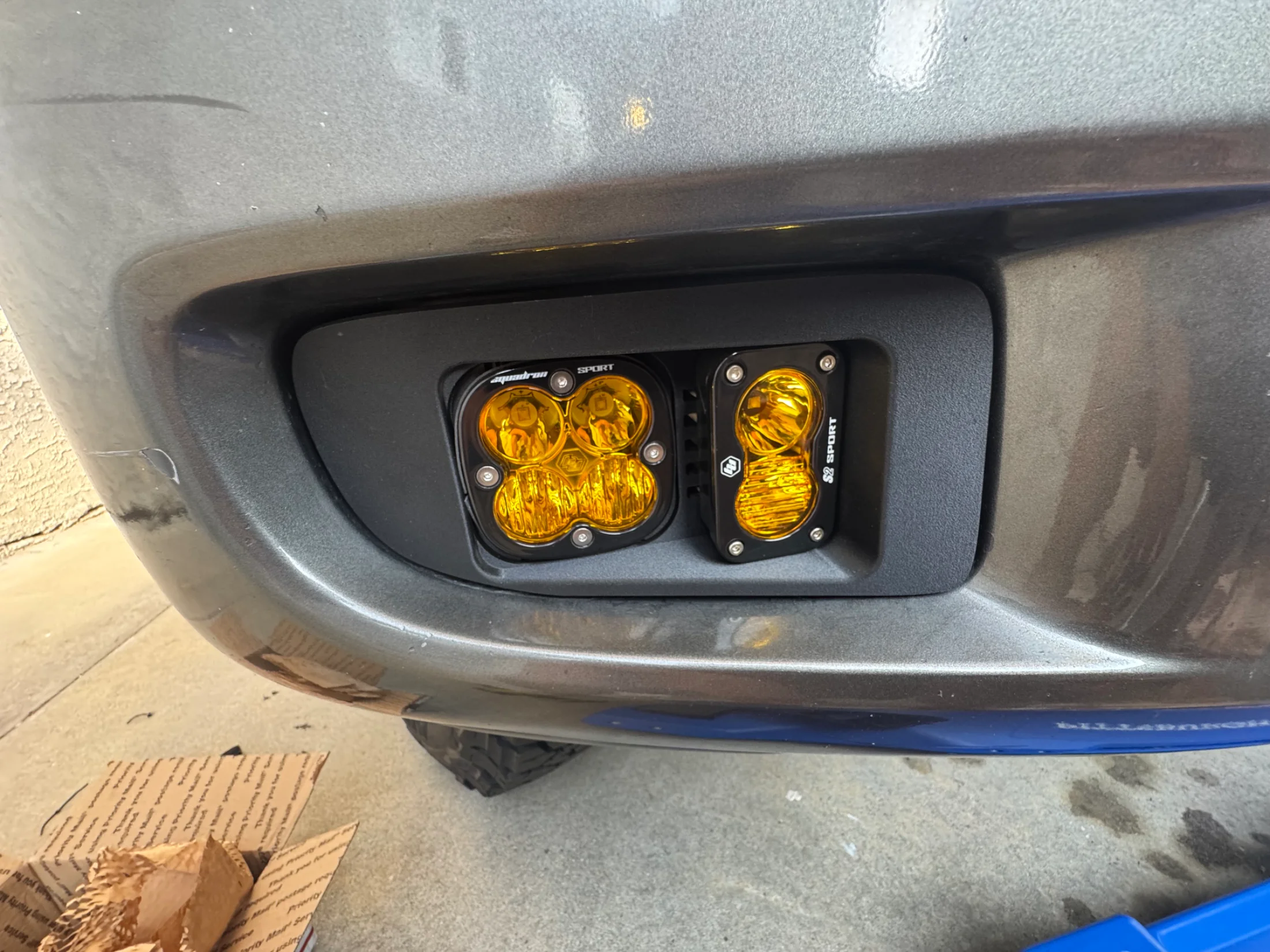

From Squadron Sports and S2 to double Squadron Sports 🤔 @Ben3DBuild

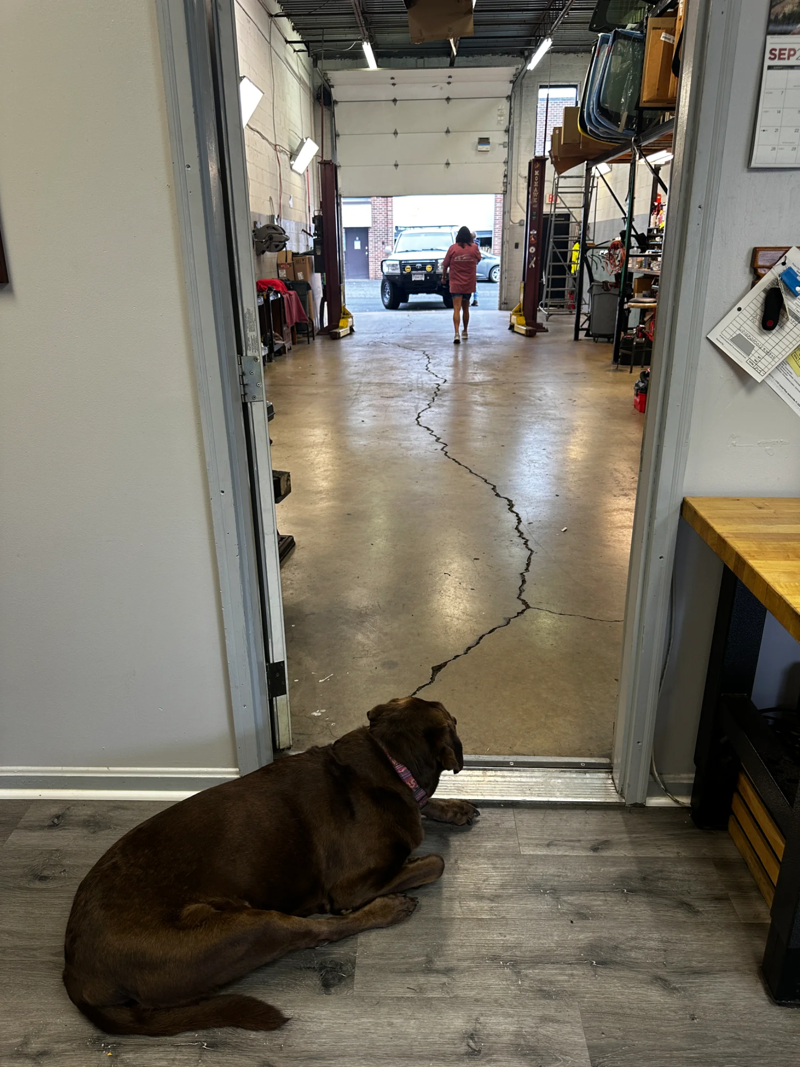

@ODSTbee yup, these guys! Bonus points for awesome shop pup too

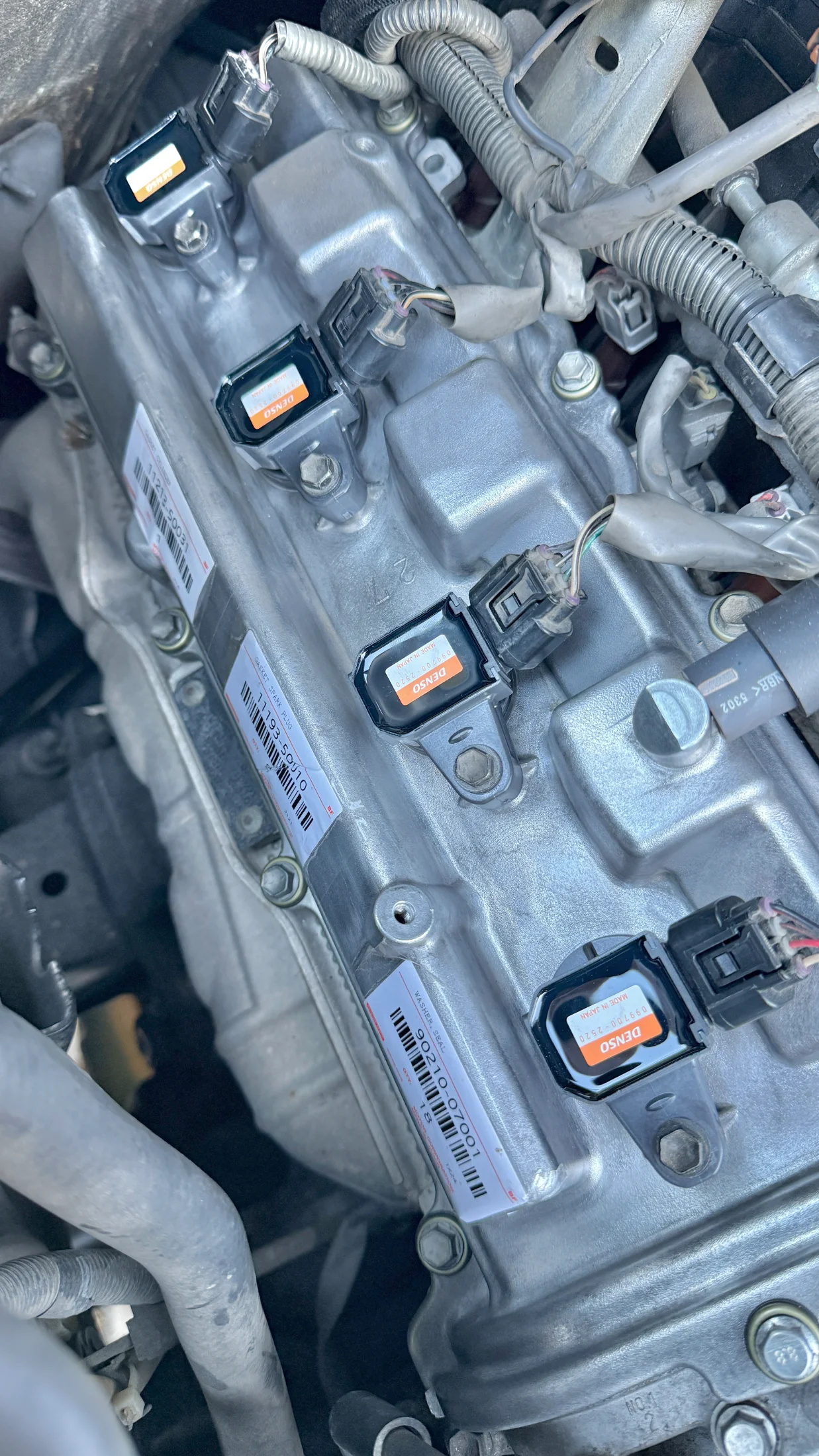

Thought of getting the valve covers powder-coated, but after using the rotary wire brush in an attempt to spruce it up, it turned out pretty good - came out clean and exposed the natural color of the aluminum material which I like the most. New oem valve cover seal, oem spark plug tube seals, oem bolt washers w/ rubber isolators, new spark plugs & coil plugs.

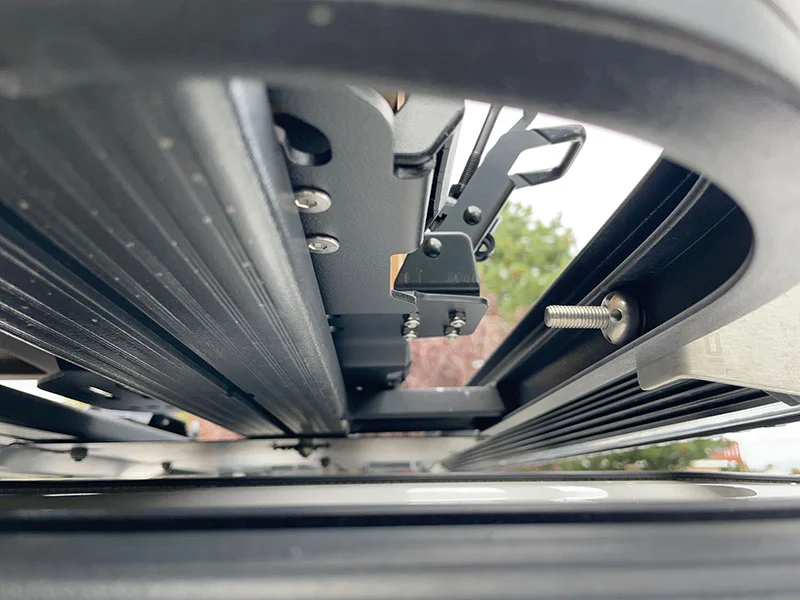

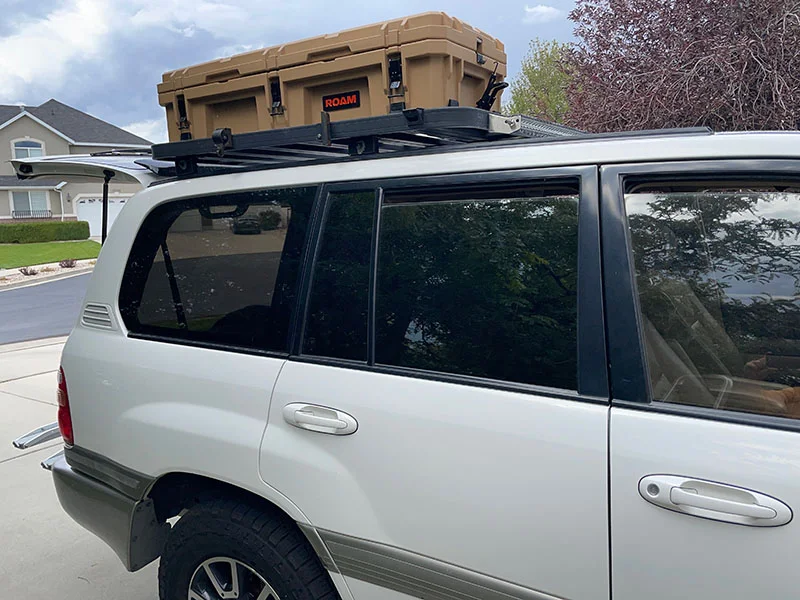

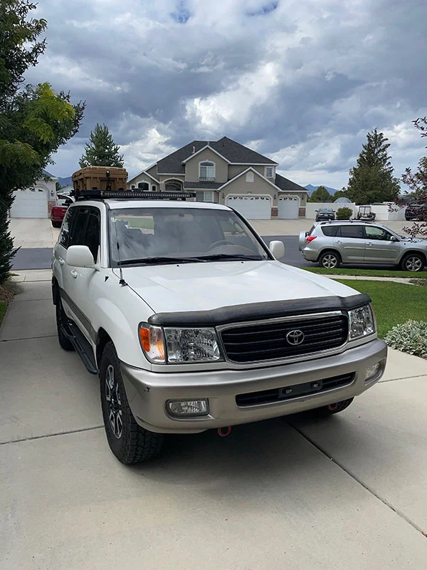

Finally got a storage box that will fit more stuff up top.

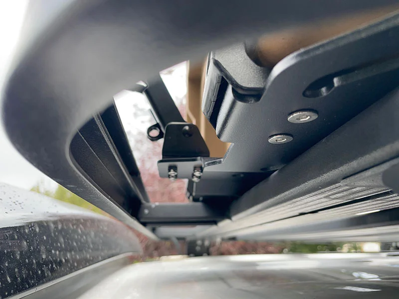

Just tested fitment of the 93L. Looks like it will mount up both front and rear.

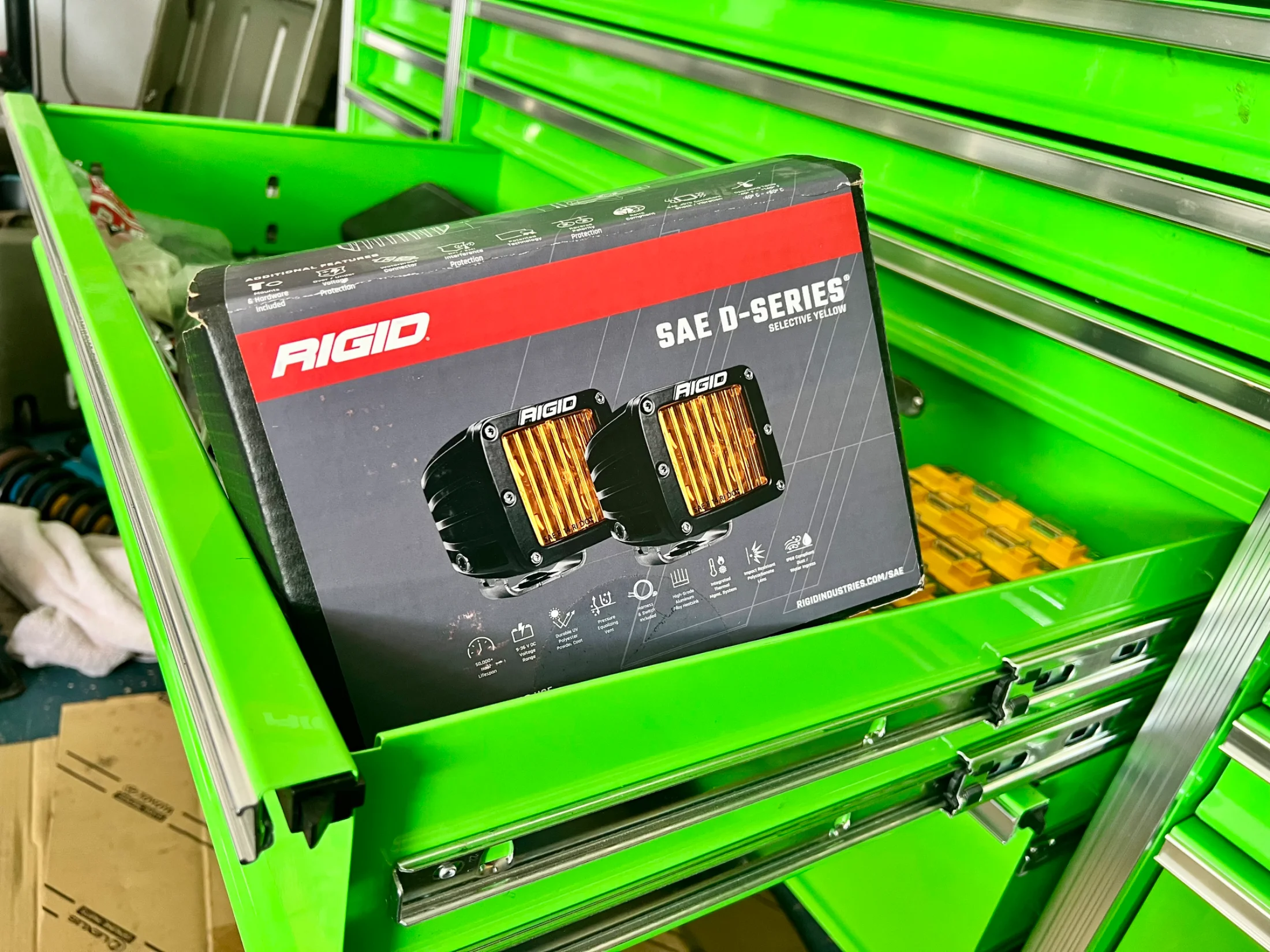

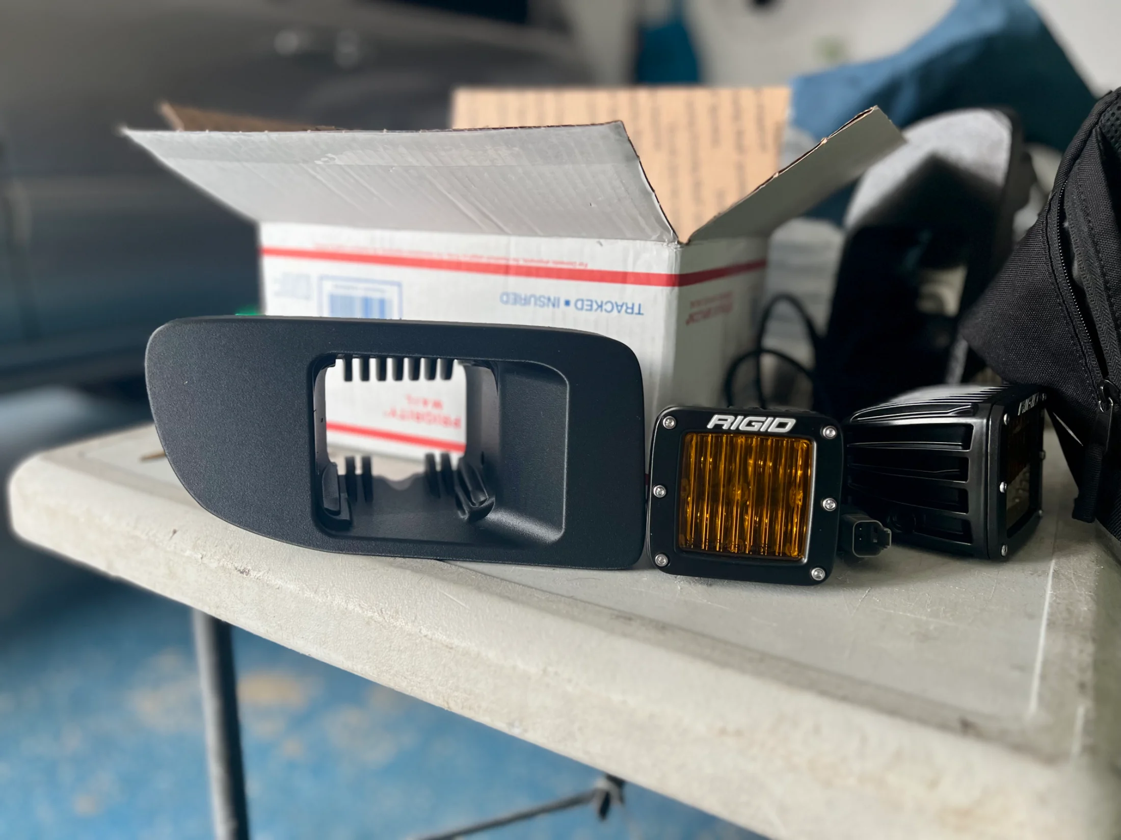

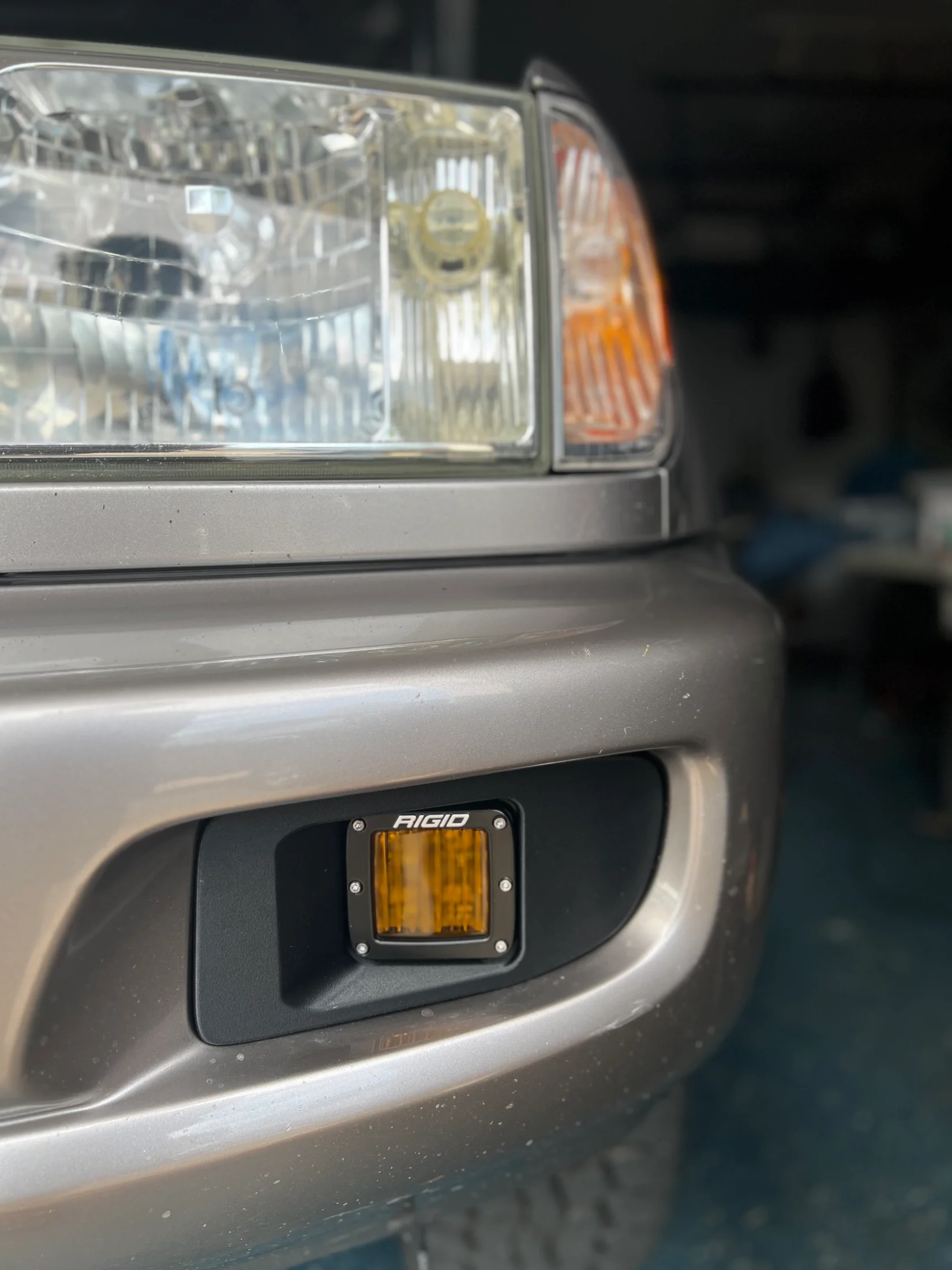

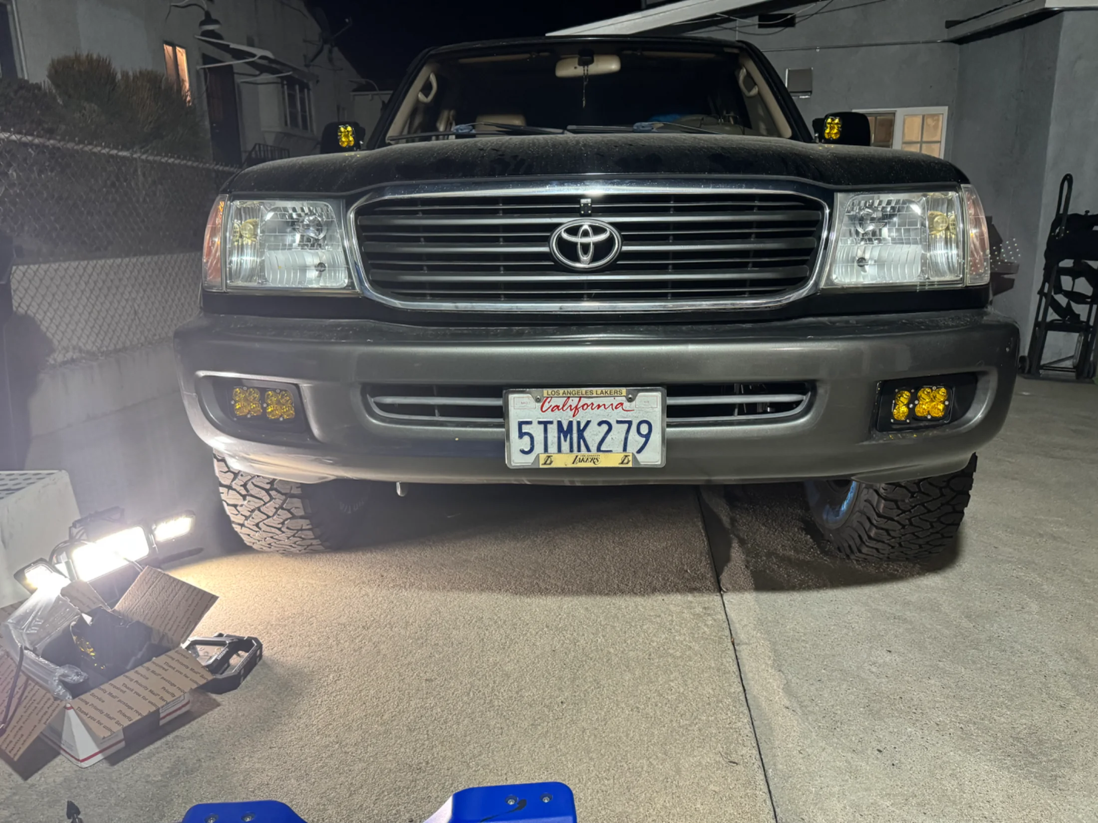

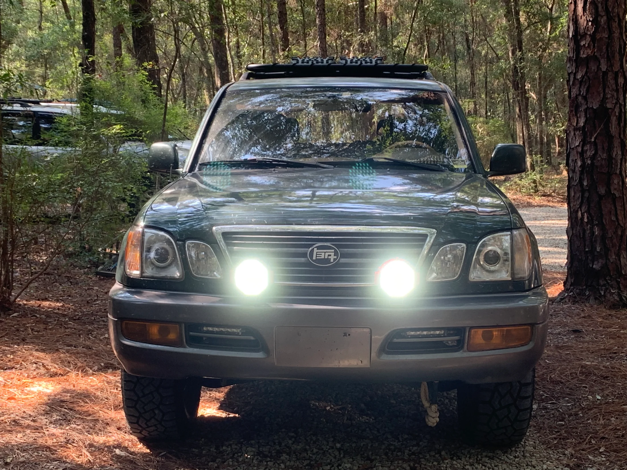

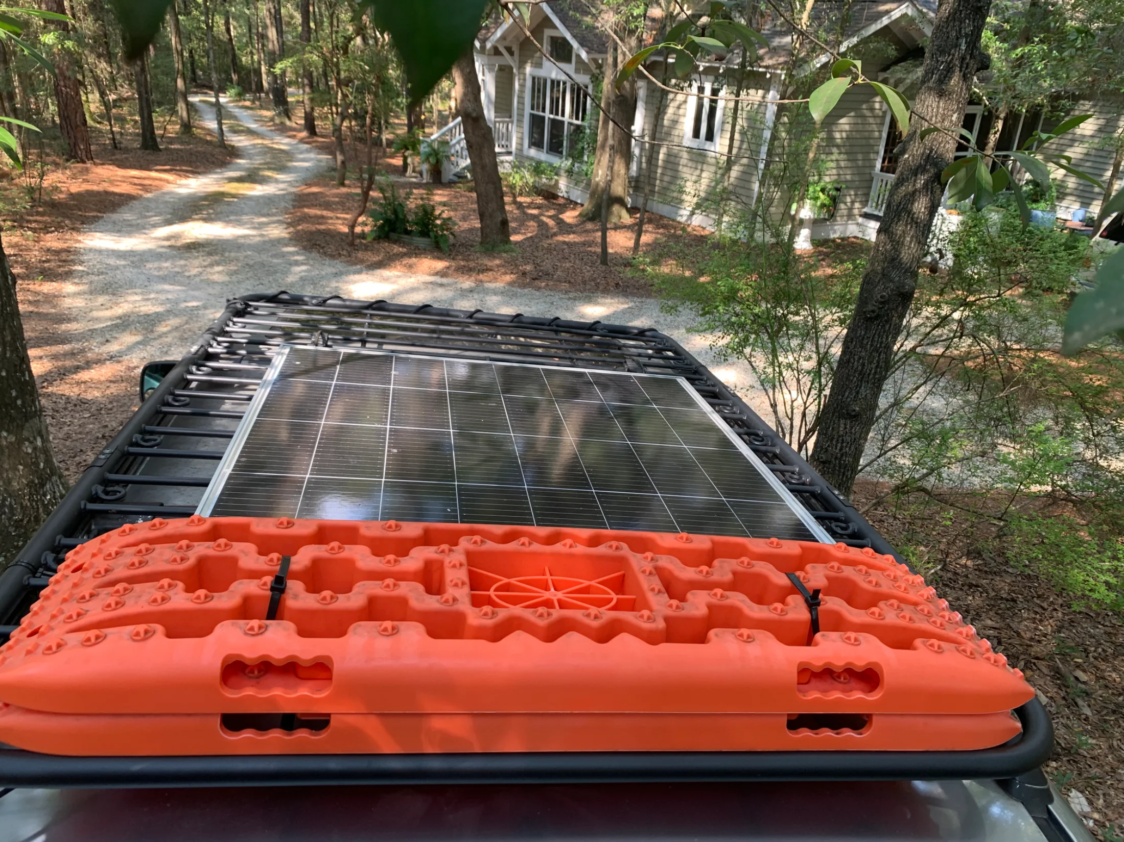

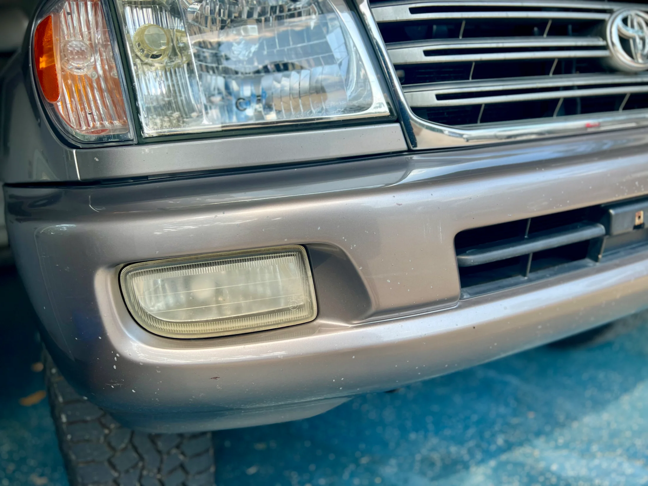

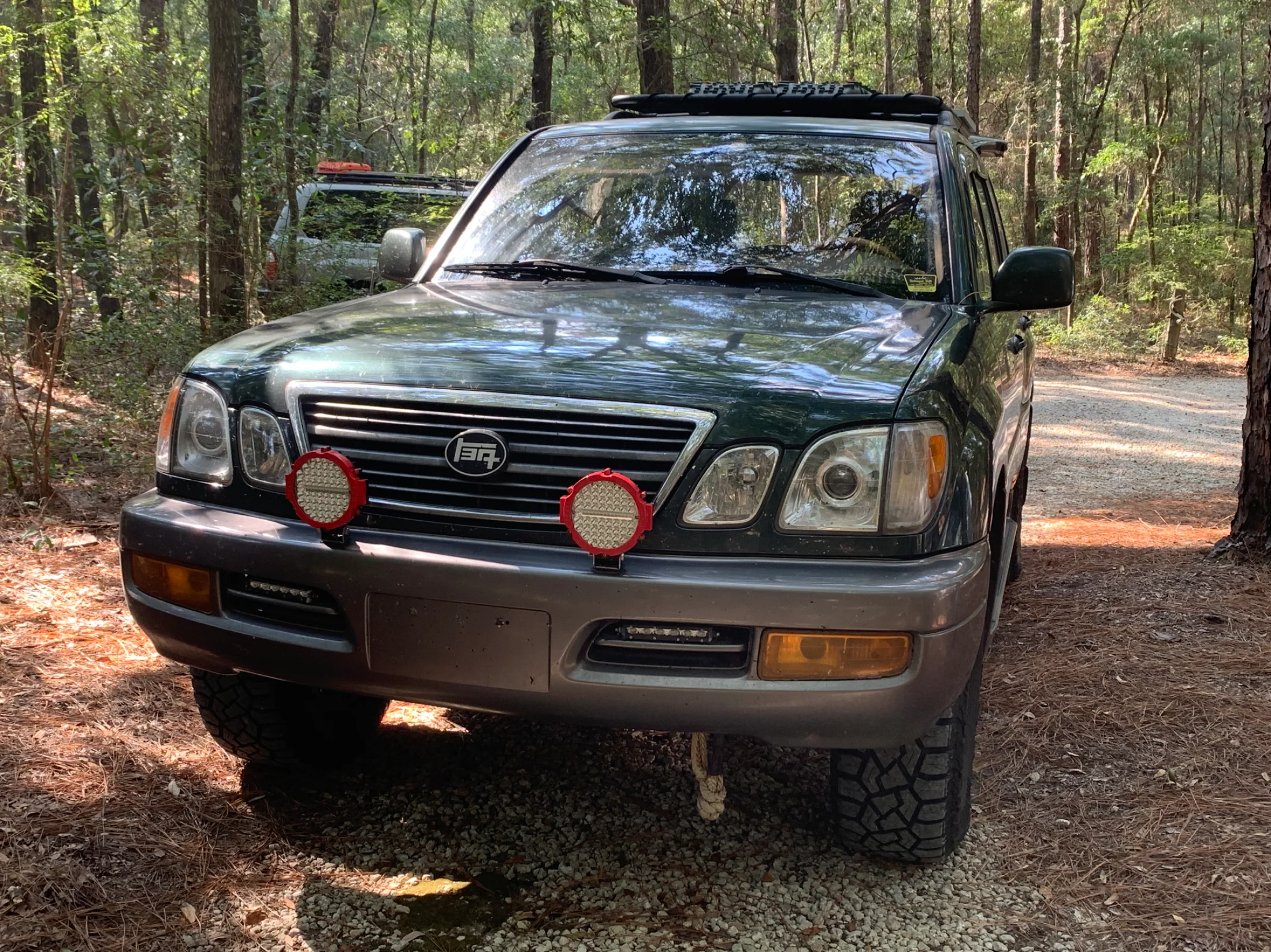

New LED fogs for my 480k mile LX. And solar panel for my '01 LX.

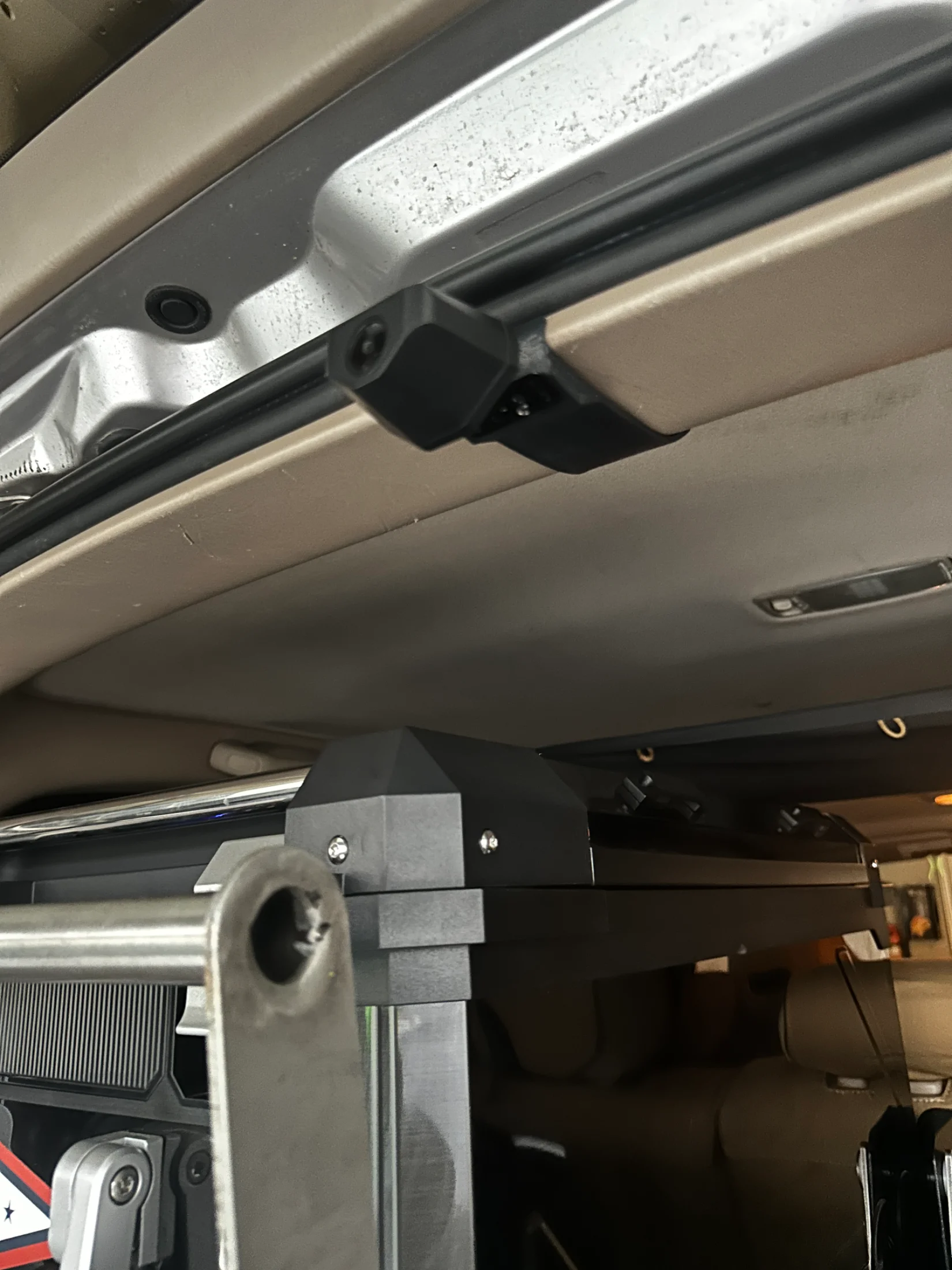

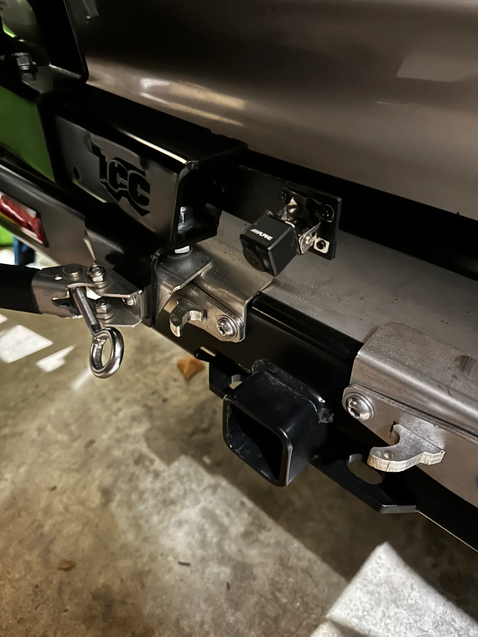

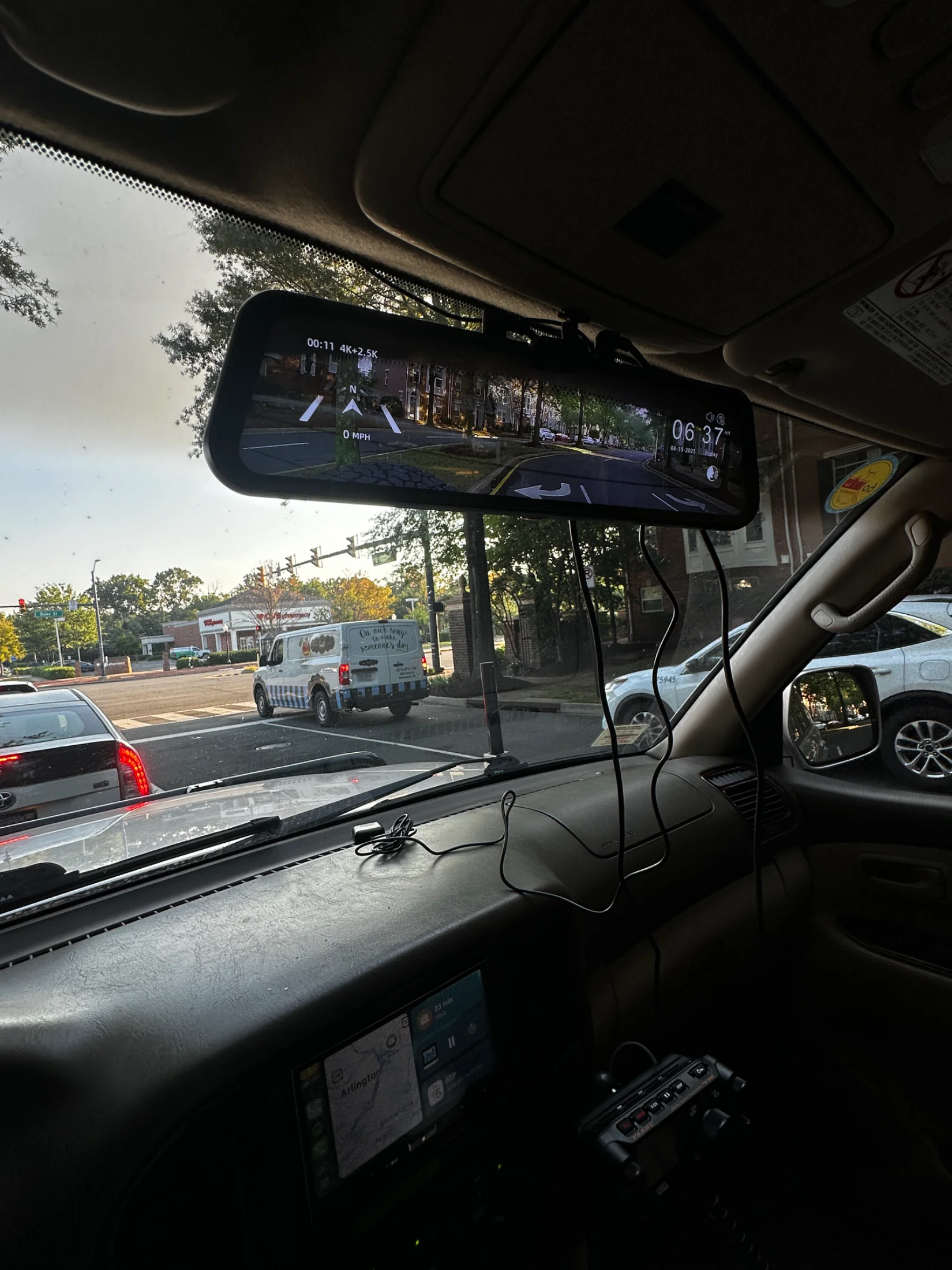

Moved back up camera from the license plate area to the new rear bumper. ABS plus some magnets. This goes to the Apple CarPlay head unit when in reverse
That plus the wolfbox g900 pro rear view mirror camera for a wider view is great. That’s mounted at the top of the hatch with the @LJE 3d printed mount

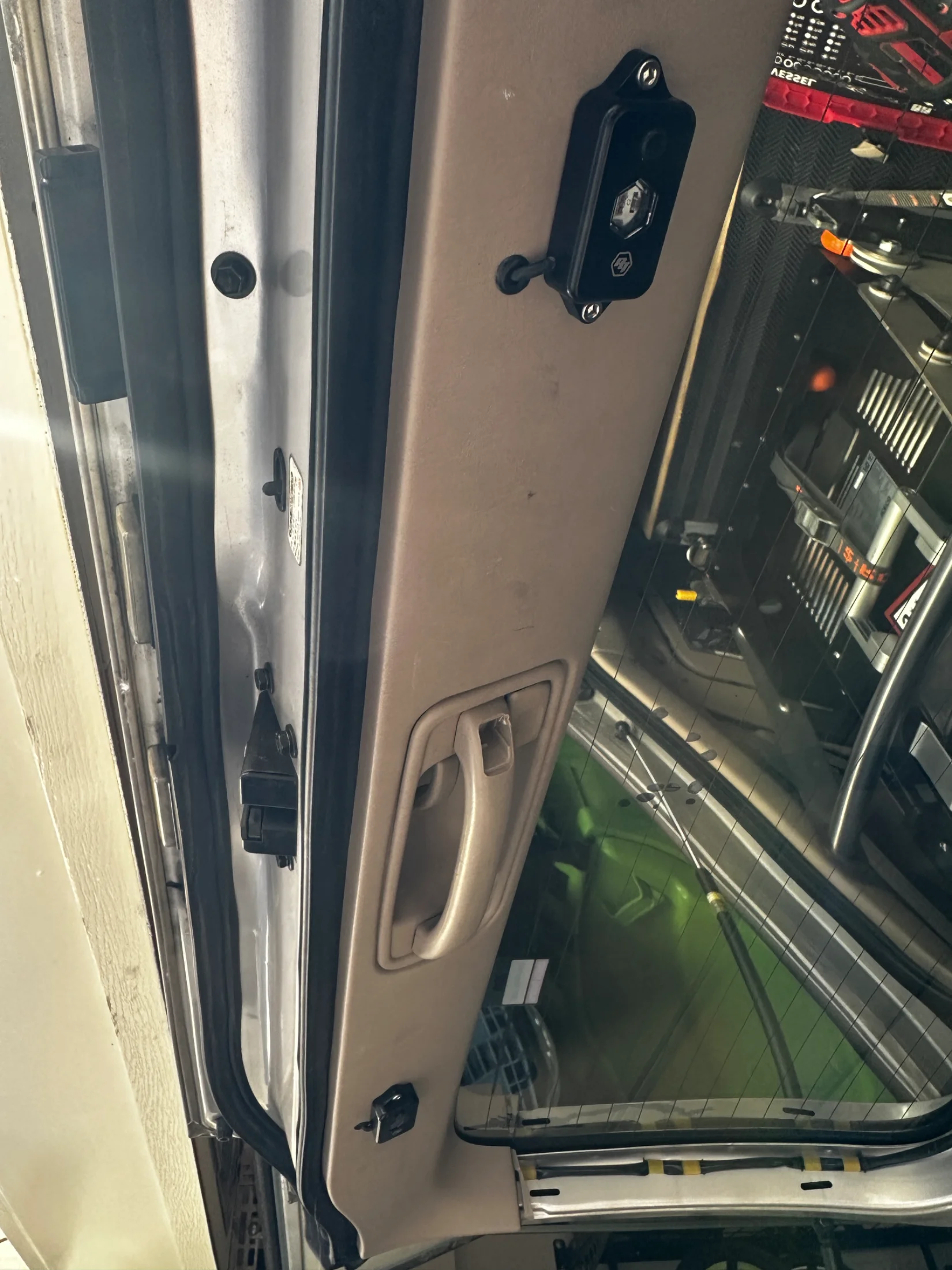

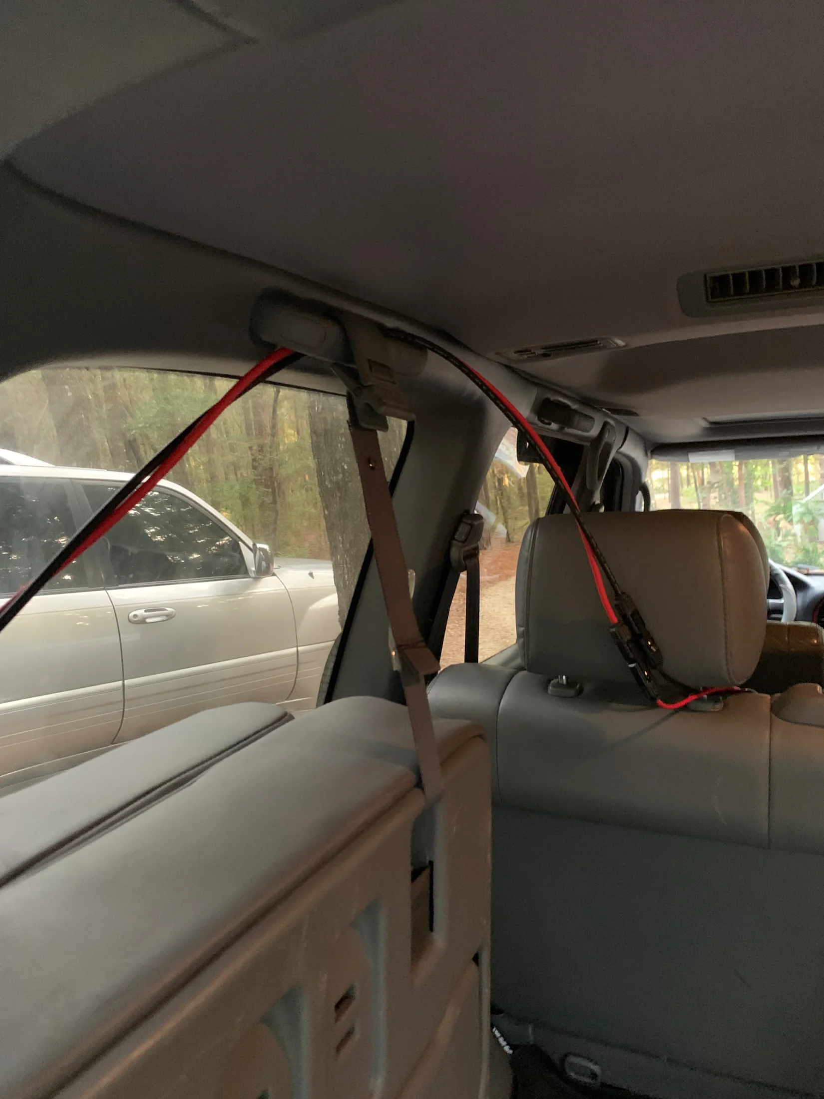

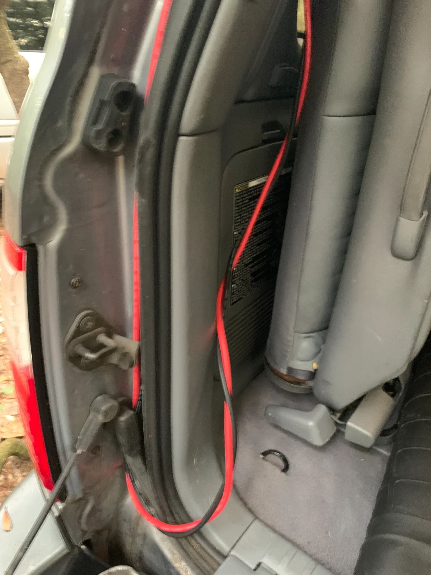

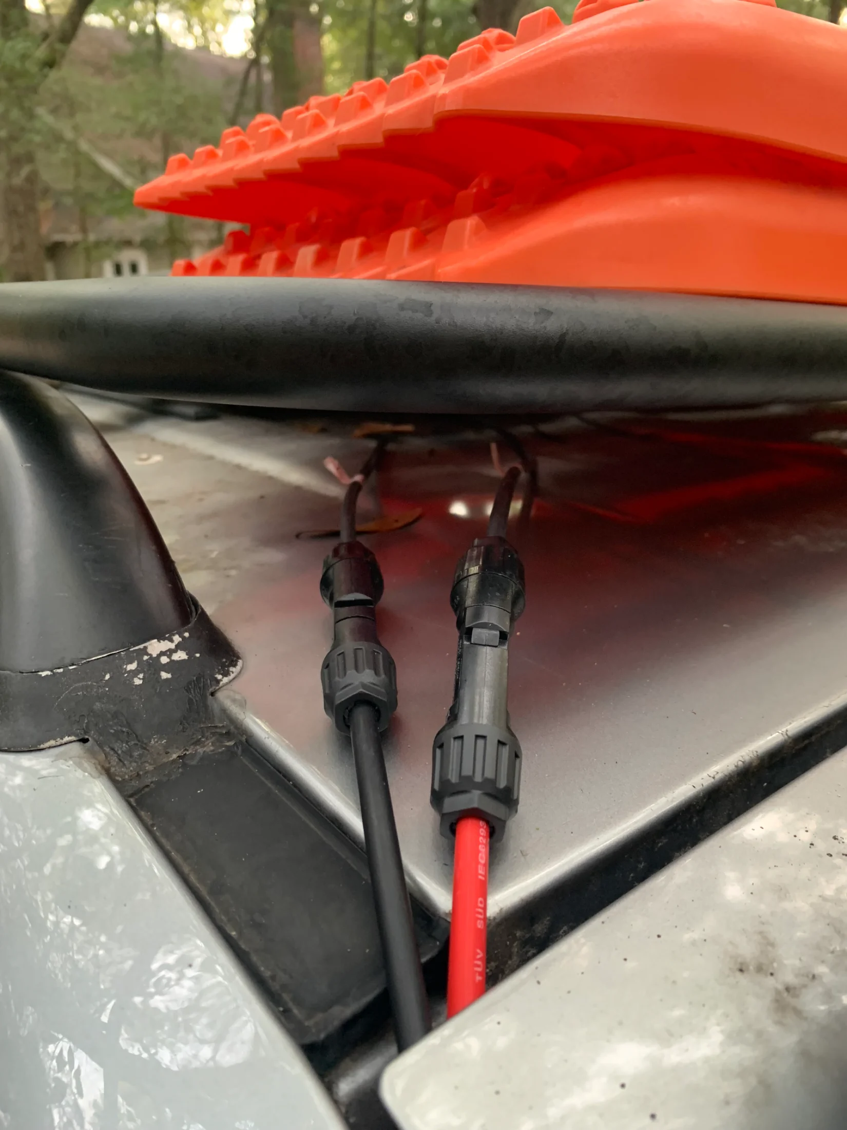

Nice setup! What charger did you use for the panel, and how/where did you run the cable?
I have a Jackery 300 Explorer, Bluetti Elite 30 V2 and a Wetown 299 wh powerstations. I'll use one of them charged with the solar panel as it keeps my fridge running. I ran POS and NEG cables from panel down left rear under edge of lift gate on left side of rubber seal. Then back into rear area at very bottom of tail gate. Then up behind third seat, thru the grab handle and onto middle seat where power station sits.
Then on other end of panel wires I use an adapter extension ---> to a single plug into power station. Will get pictures tomorrow.
Not worth trying to clean the baffles inside after the prep work for powder. I would just paint them with VHT paint.
