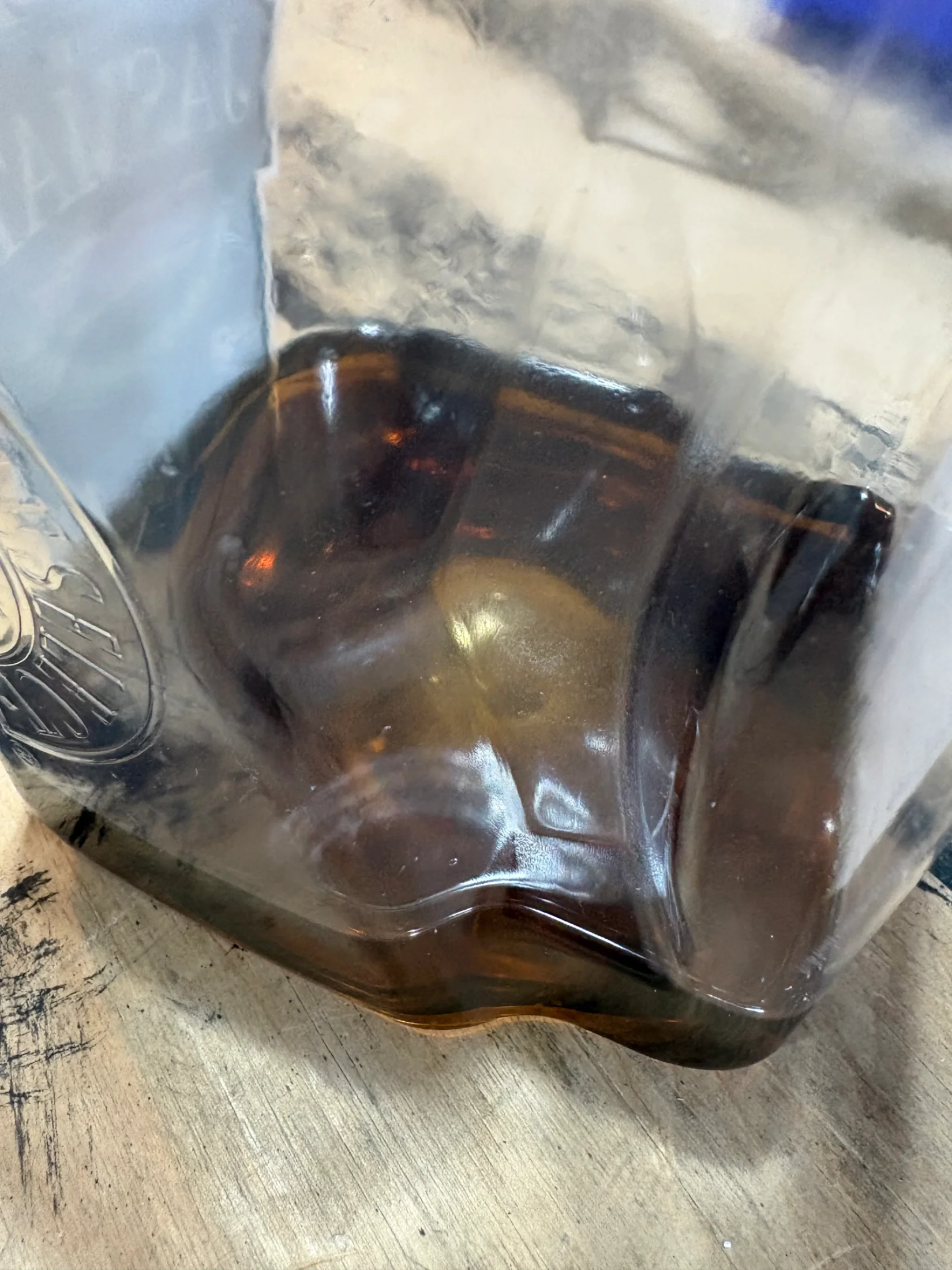

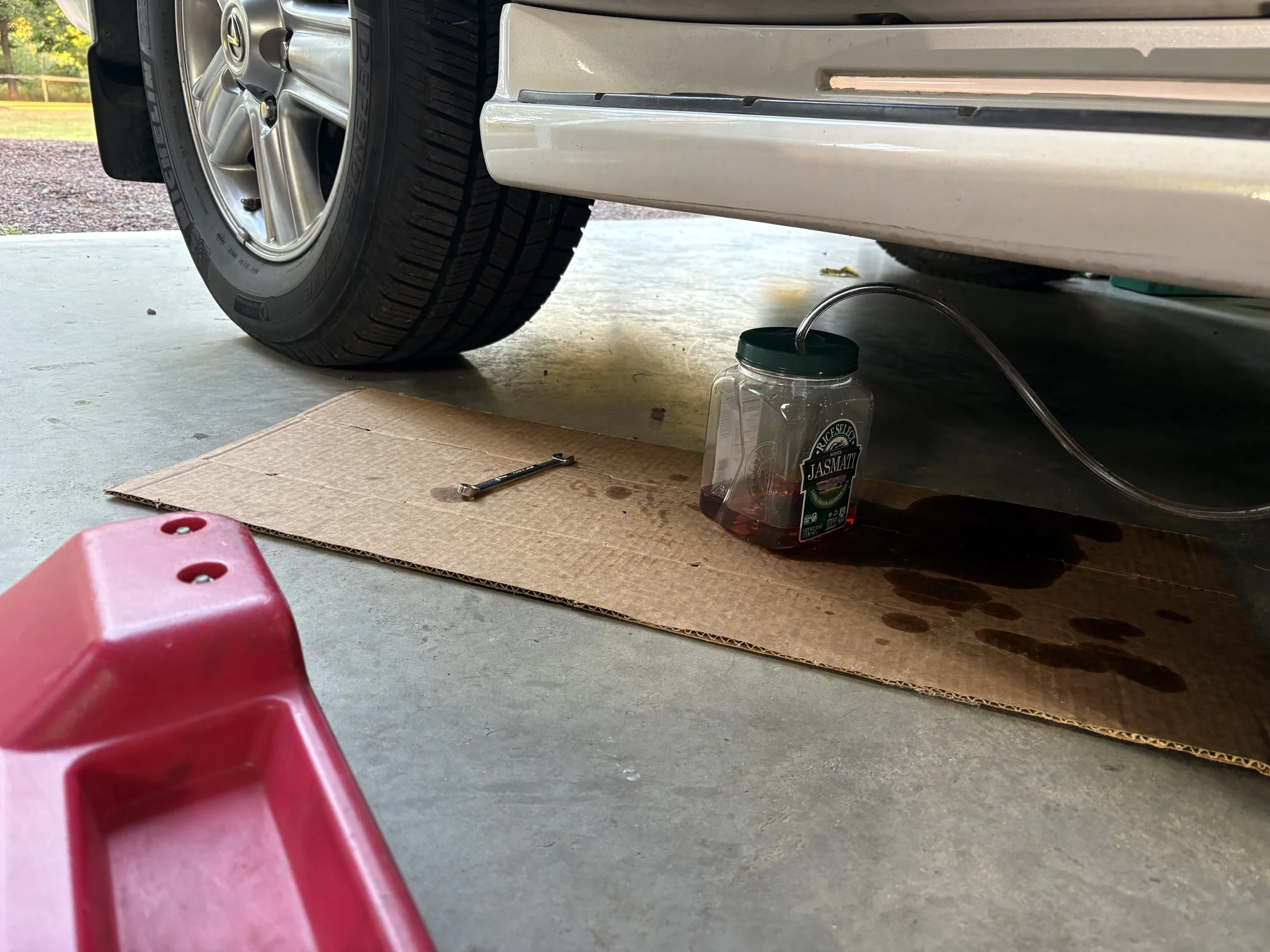

Flushed out my ahc globes. Came out pretty dirty. Didnt notice much of a ride difference. Also made a mess with the can, didn’t realize until the next day that the plastic piece around the can lid was a splash guard 😅

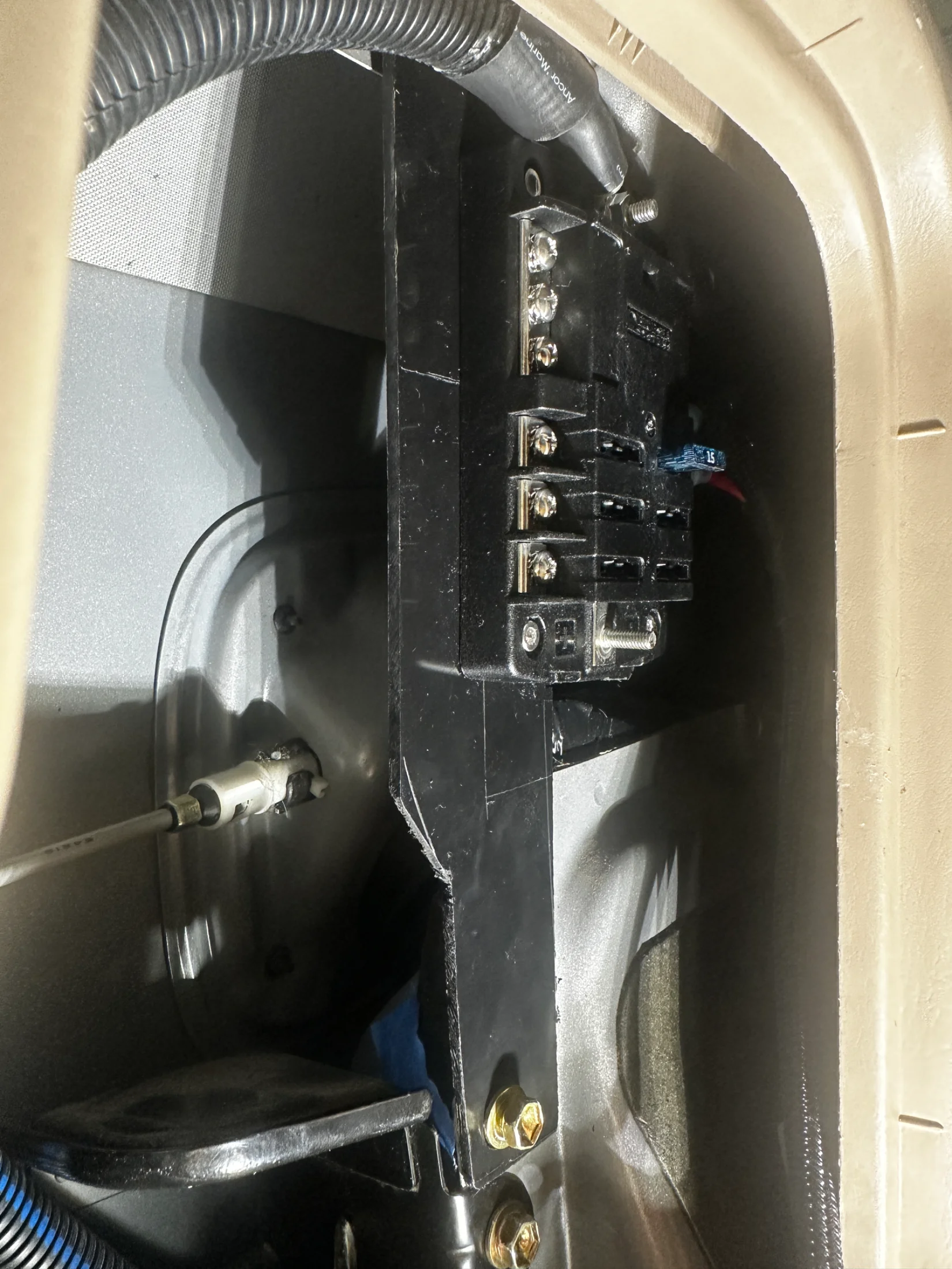

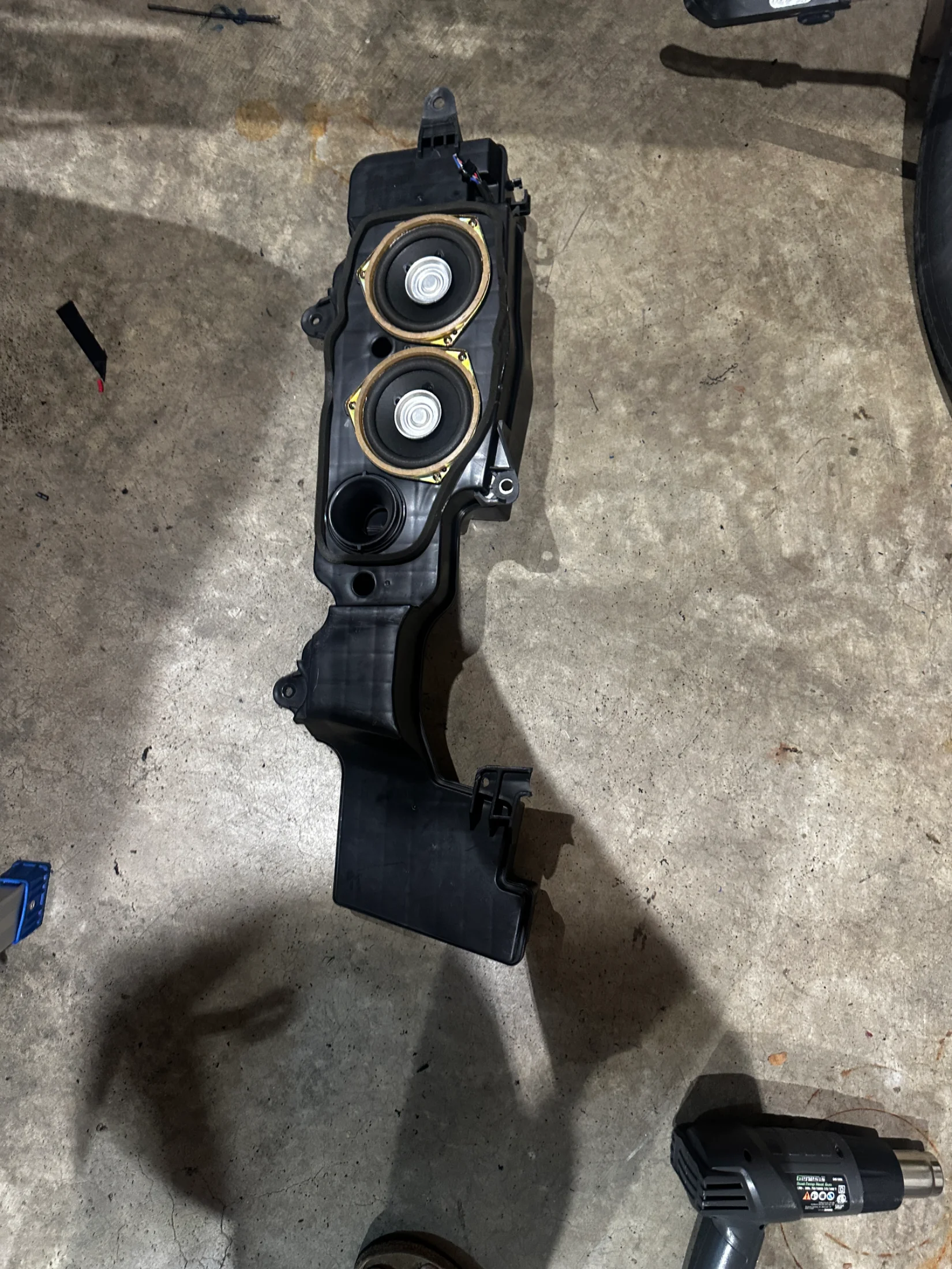

Birthed the factory subwoofer out of the rear quarter panel. This was a huge PITA since I didn’t want to pull out my fridge and drawers.
Subwoofer had already been bypassed when I bypassed the factory amp and wired the speakers directly to the alpine CarPlay head unit. Sounds so much better.

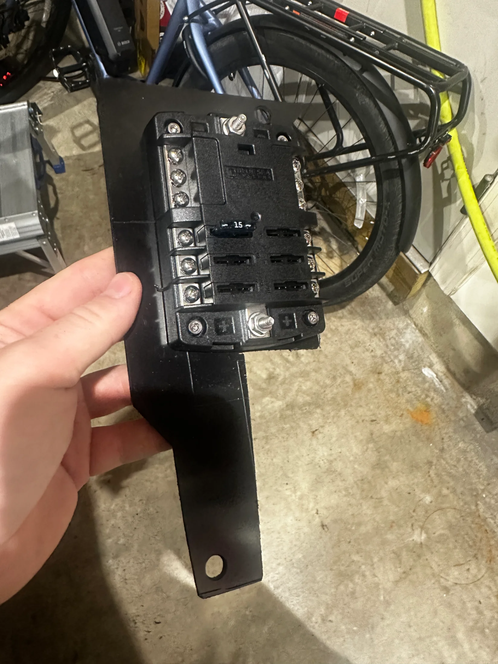

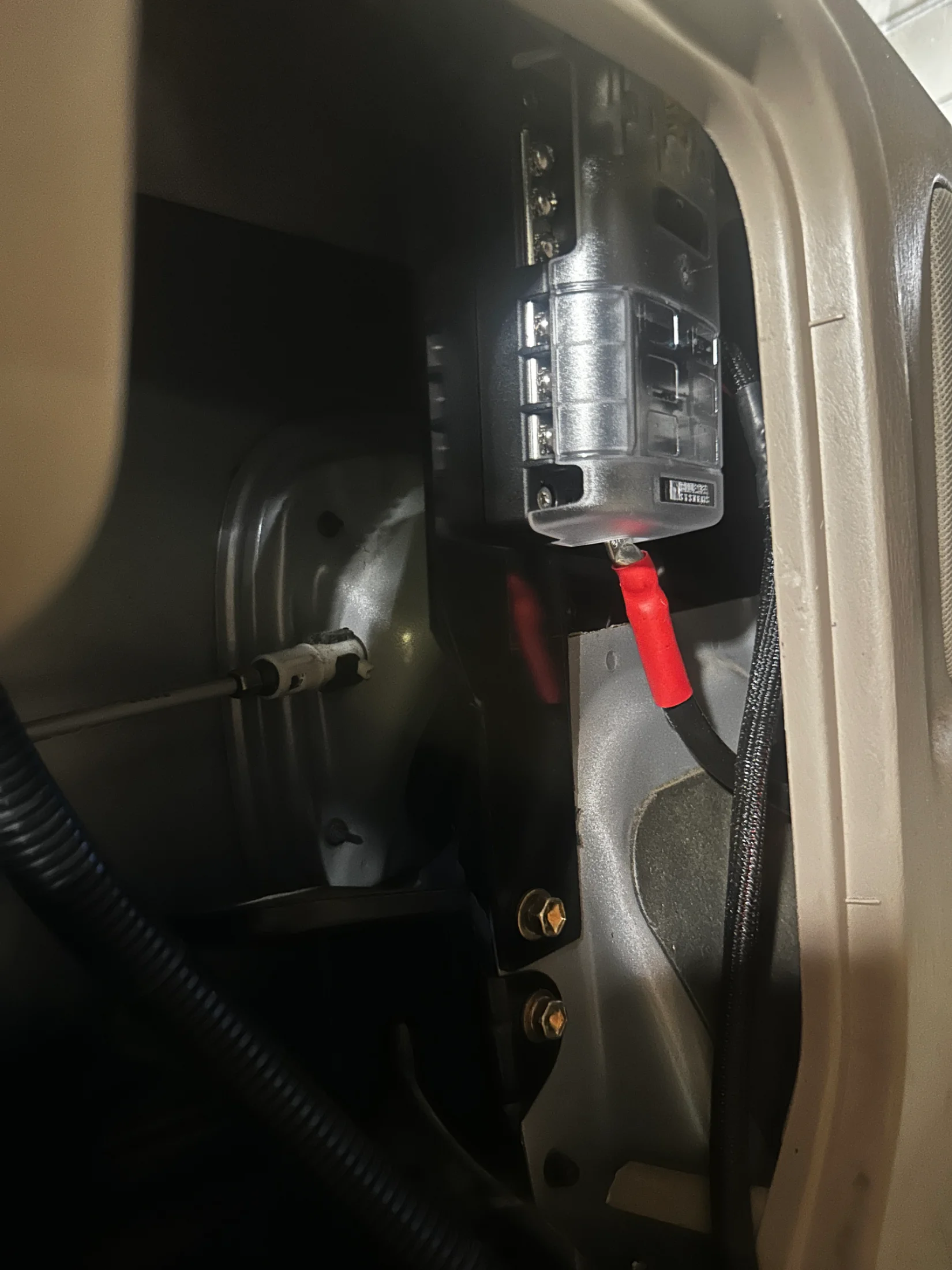

Then I cleaned up some of the previous auxiliary wiring I did and made a mount for the fuse panel where the subwoofer previously was.
Next up is adding the @BenCC 3d printed switch/socket panelsView attachment 4002342View attachment 4002343View attachment 4002344
Looking good. I recommend putting butyl type sound deadener on the outer skins of the rear quarter panel (ideally on both sides) and then covering up with some closed cell self adhesive foam. Will make a huge difference in the noise comfort.

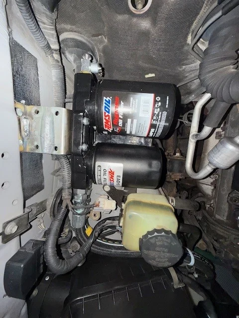

Installed dual remote full flow and bypass oil filters. Spent a s***-ton of money on getting this Cruiser ready for my upcoming DV 6 day adventure.

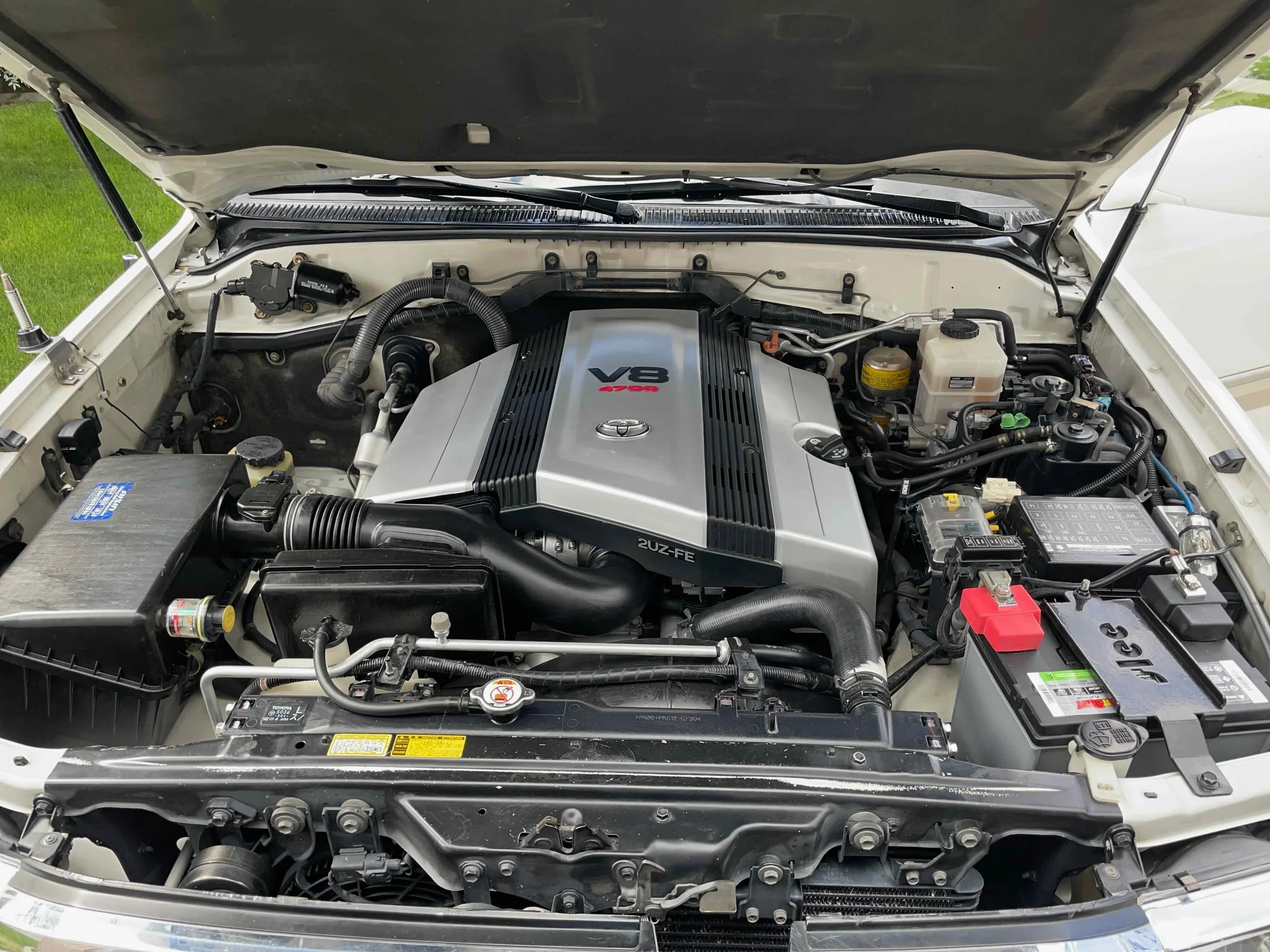

I decided to try out one of ChrisFix's tips to detail the engine bay using Maquiar's Ultimate Black on some of the plastic/rubber parts. Didn't turn out too bad. Maybe next time I'll try doing the painted surfaces.
I also finally got the SDHQ billet battery terminals installed that were sitting in my garage for months. Plus, I added a battery mat to raise the level of the battery to better fit the Slee tray. Next up is probably the "big 3 electrical upgrade" and a switch for some Baja Designs lights to be installed later using @BenCC's fog light replacement mod.

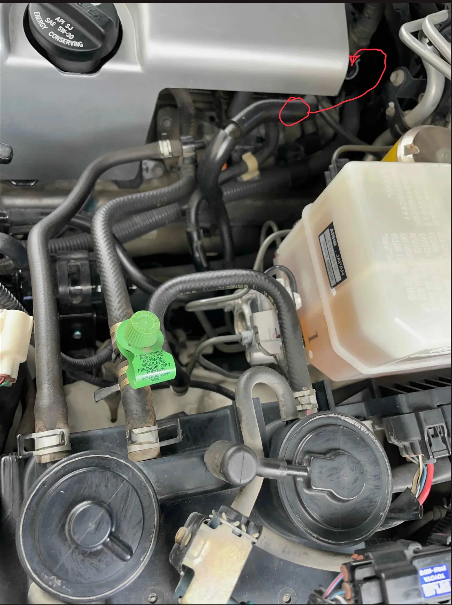

Last, I have a question about the bracket or connector(s) for the hoses coming off the charcoal canister, fuel filter, etc. Over the years as I've had my LC worked on they seem to have gone missing. Any insight what's missing and the part # to replace them?
I do not believe you are missing any brackets for the hoses from the charcoal cannister…
But I do think that one rubber hose goes into the clip at the rear of the engine cover… as shown.
