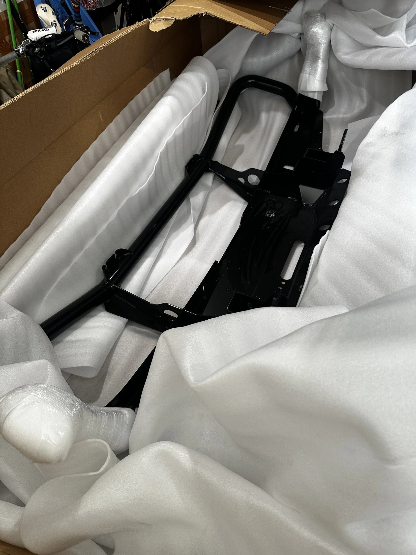

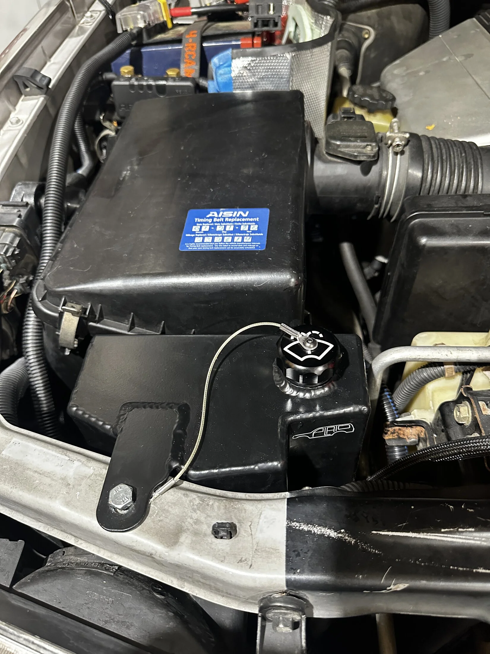

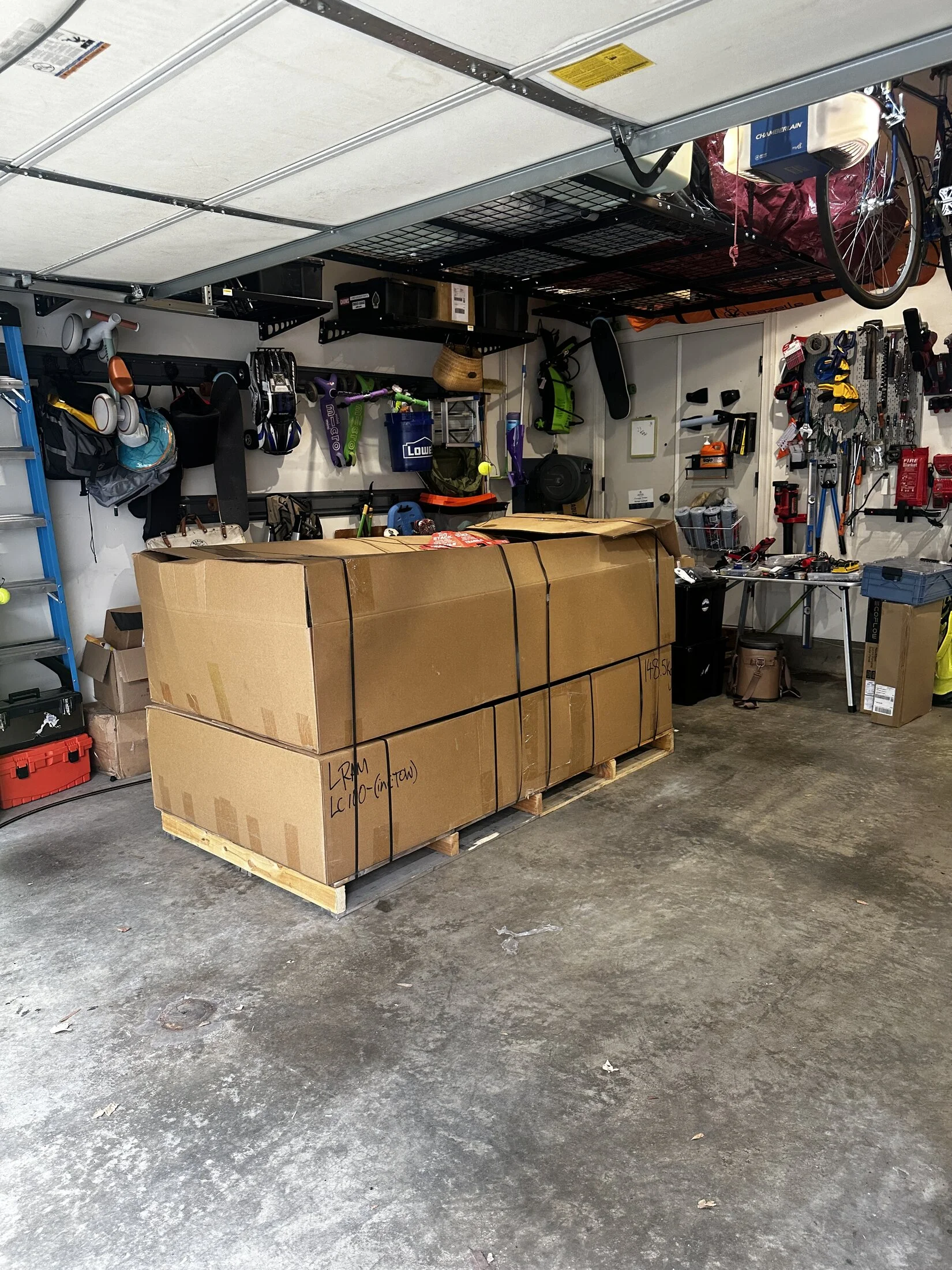

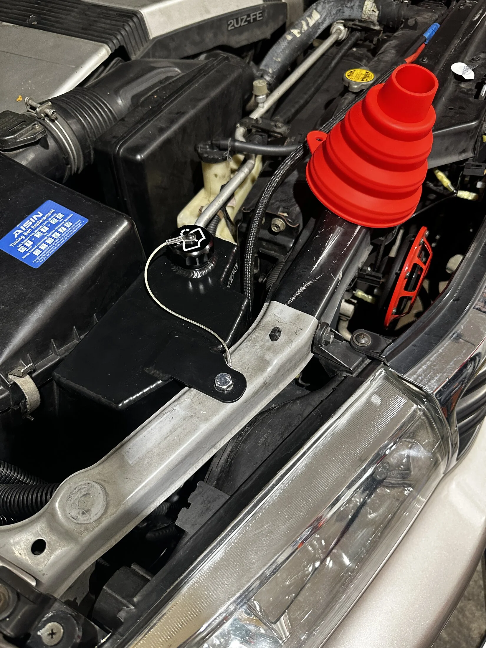

Plaid Wagon washer bottle relocation in prep for what was delivered today
…front and rear bumpers from The Cruiser Company

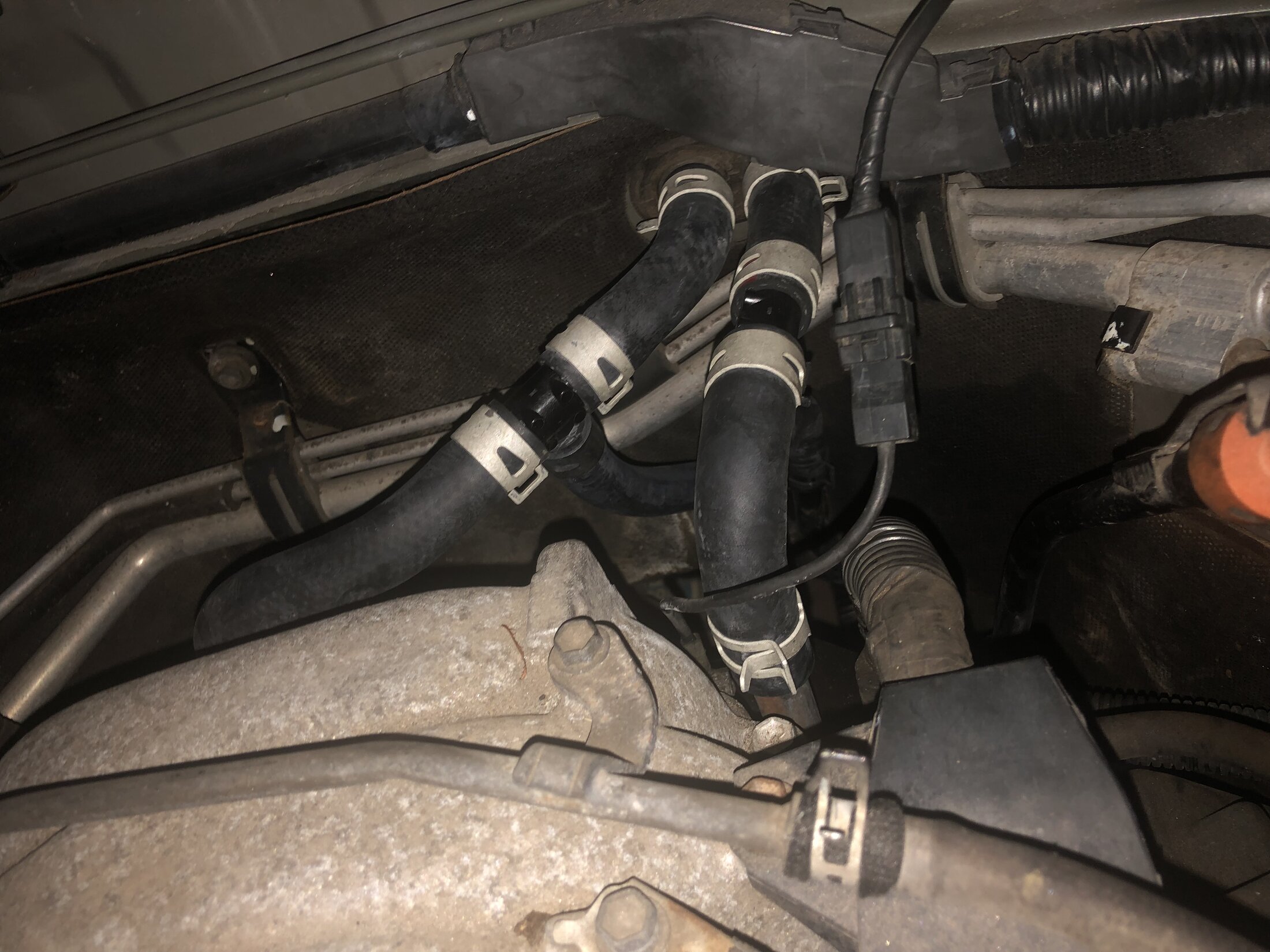

Changed out the heater tees and replaced all the hoses and clamps with OEM. Previous owner(s) had only replaced the left side and used worm clamps. The right side crumbled when i touched it.
Also replaced upper and lower rad hoses and thermostat with OEM since everything was apart and I did not know what was in there. I found aftermarket thermostat with the jiggle valve in the wrong place. 🤦‍♂️

I love retiring previous owners worm clamps… it’s the simple pleasures in life.

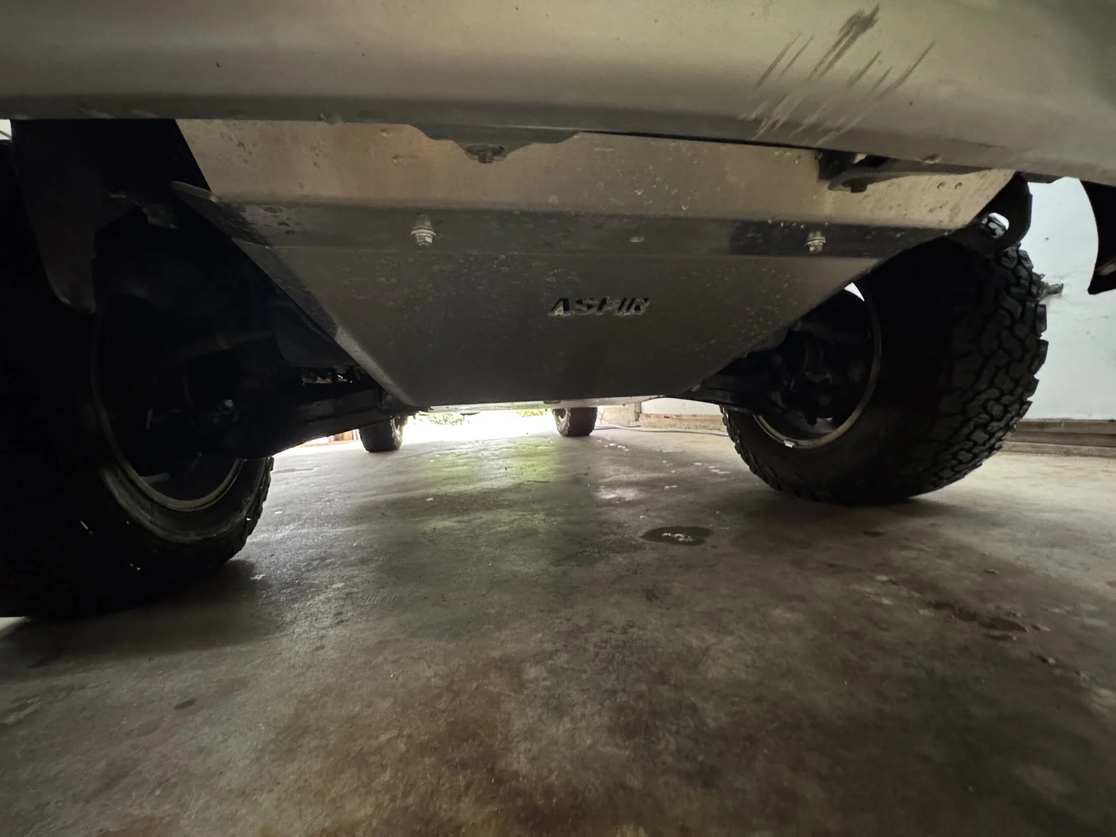

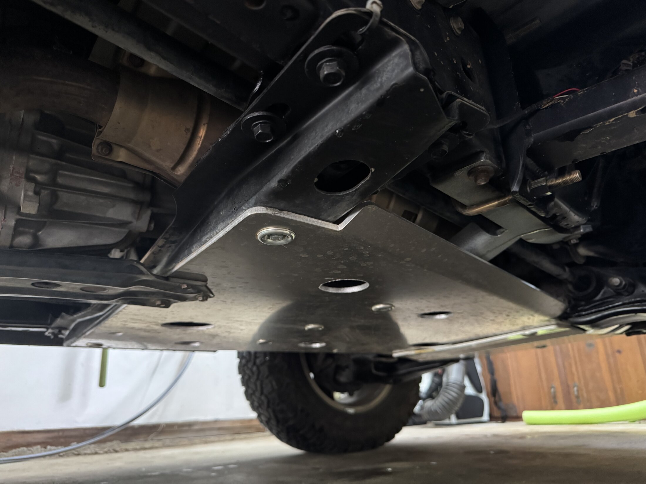

Asfir skids, front and transmission. Note I was able to get the stock transfer case bolted up however it is over the trans skid. I got a 1” whole saw and drilled through the asfir trans skid to get the stock transfer case skid/deflector mounted. I prefer this over the asfir stransfer case skid because there is an additional crossmember on theirs which seems like it would get in the way of functionality. I also drilled 2” holes in the transmission skid. I live in a city so stop and go driving is majority and having the exhaust next to the fuel lines covered by a 1/4 inch piece of aluminum seems like a recipe for something to go wrong, maybe it’s fine but maybe the holes give better ventilation.

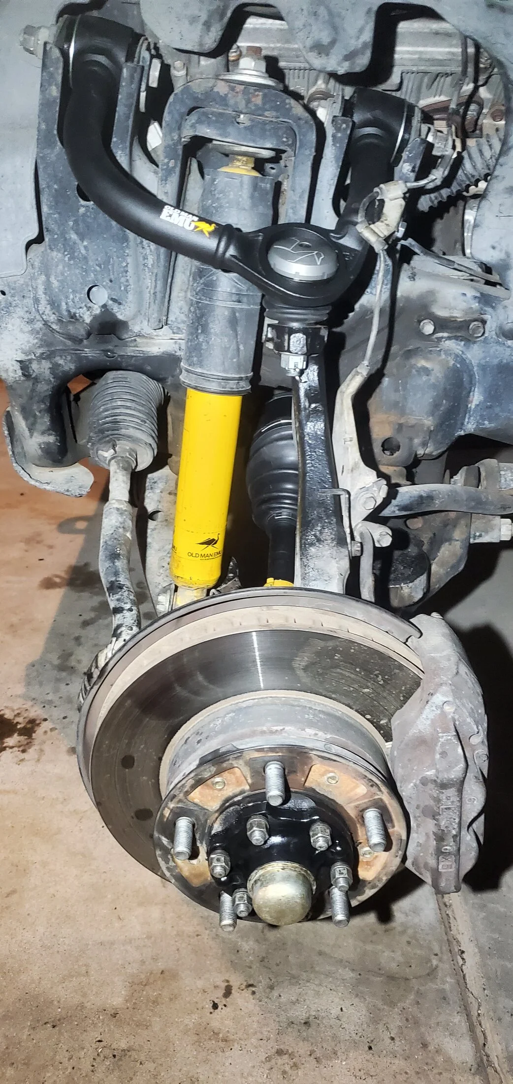

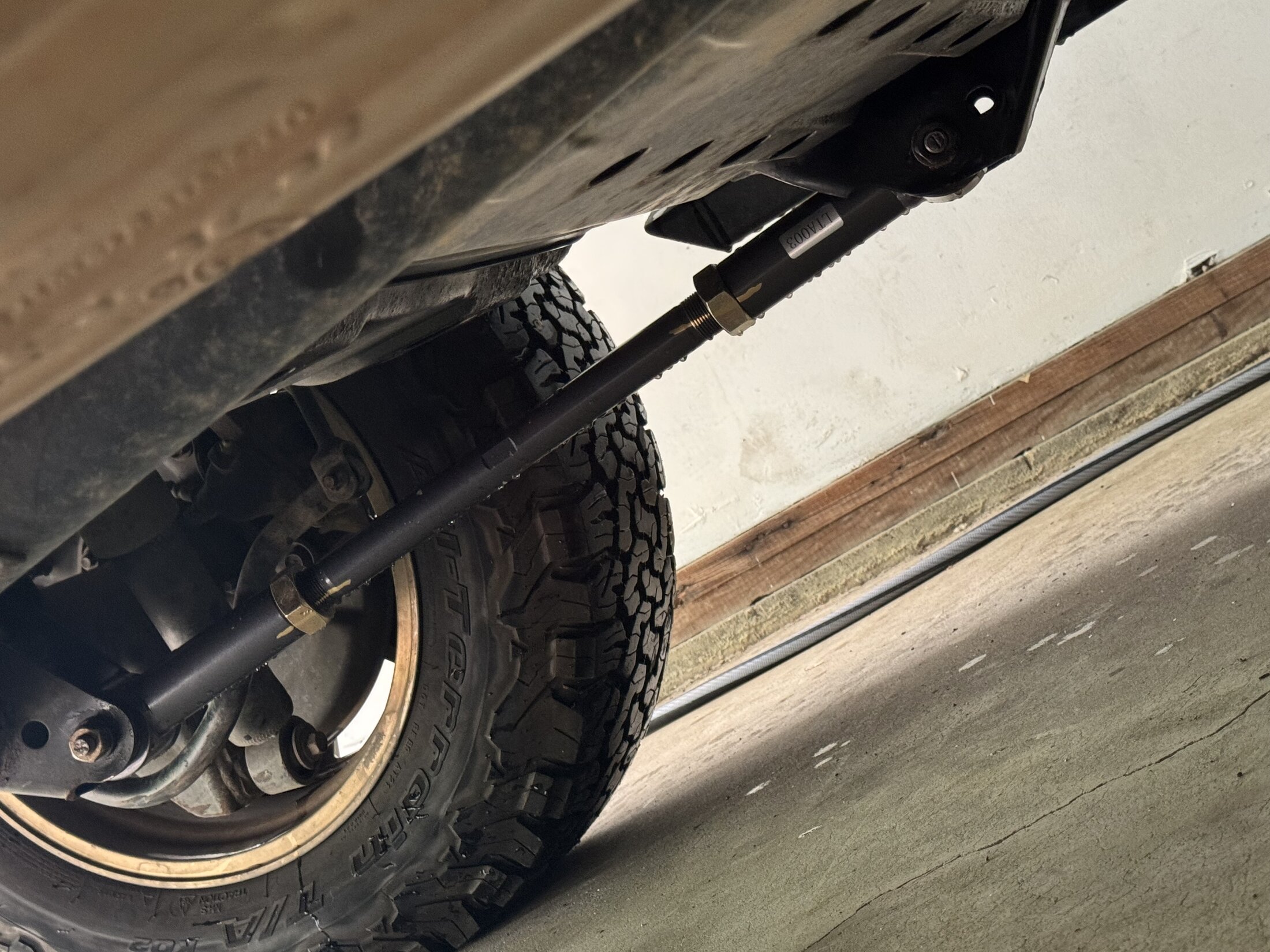

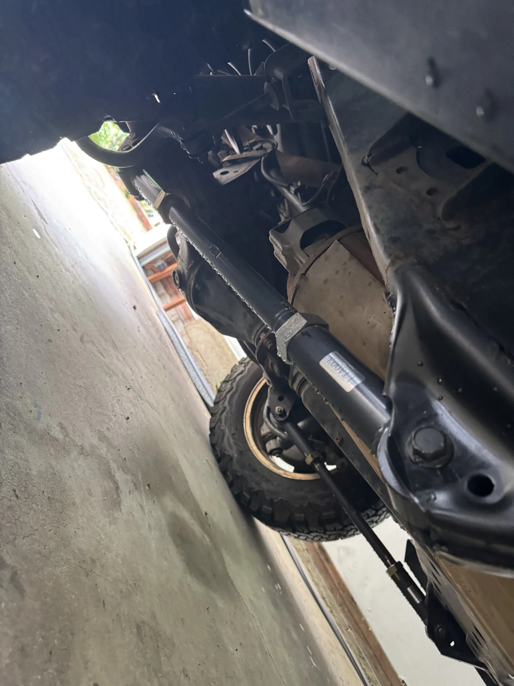

Iron man lower trailing arms; These are probably 2x heavier than stock. Way better ride, much more stable while keeping the nice AHC ride. I purchased the uppers but when they arrived they don’t have the AHC bracket so either I cut the old one off and weld it or just replace the stock bushings.

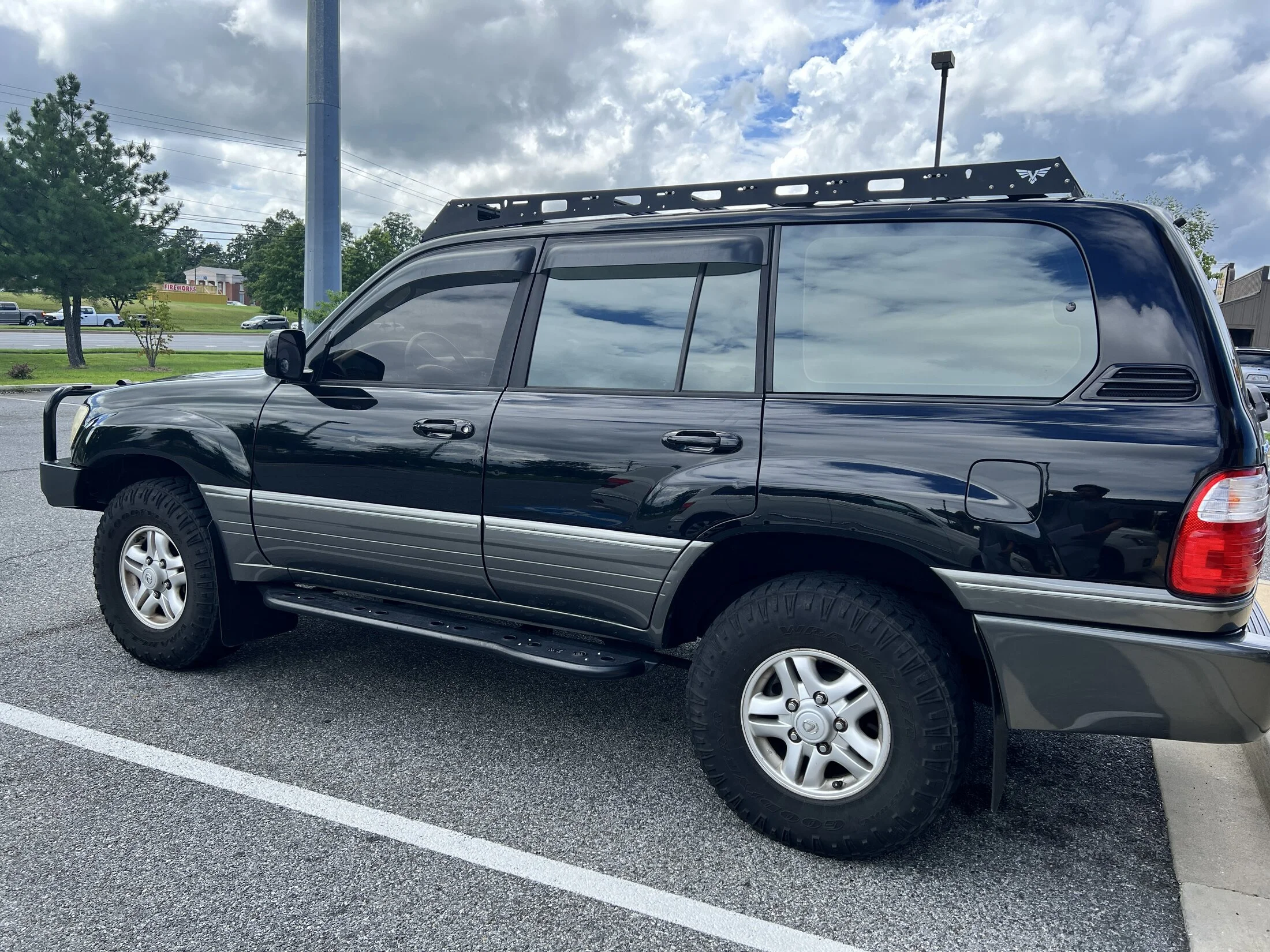

Ready for the 3k mile round trip to Crusiers on the Rockies!

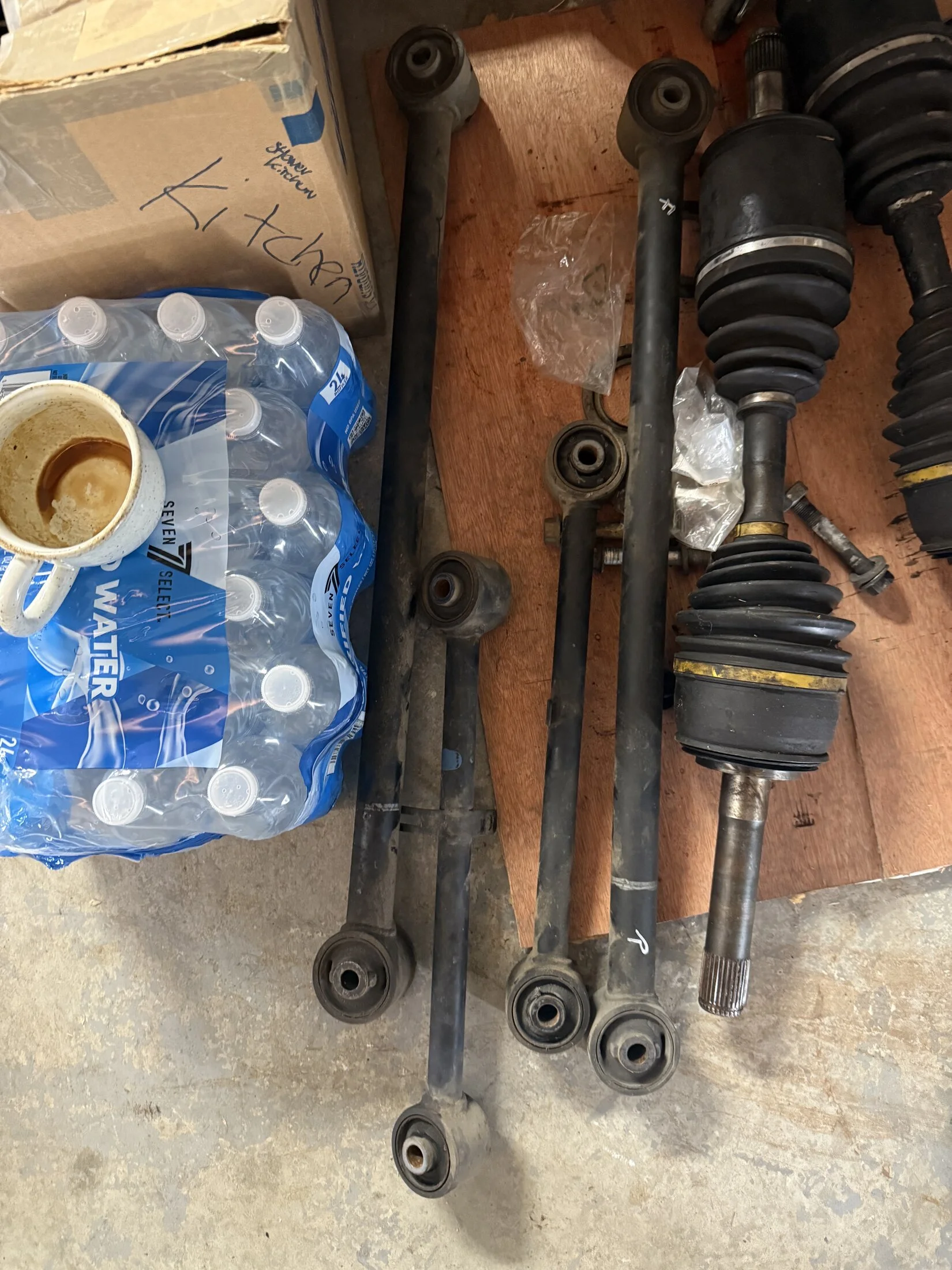

Today I finally did the rear upper control arms. Did the lowers last week. Slowly going through the suspension on my 210k truck and replacing all the parts with OEM. Next up will be the LCAs in the front and the tie rod ends.View attachment 3943642
How's bushings? Can't tell from the picture.
