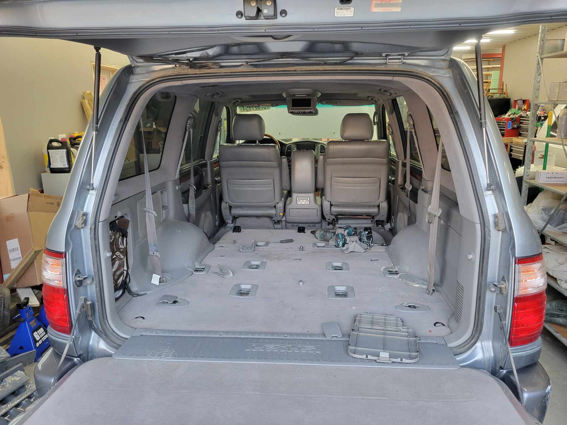

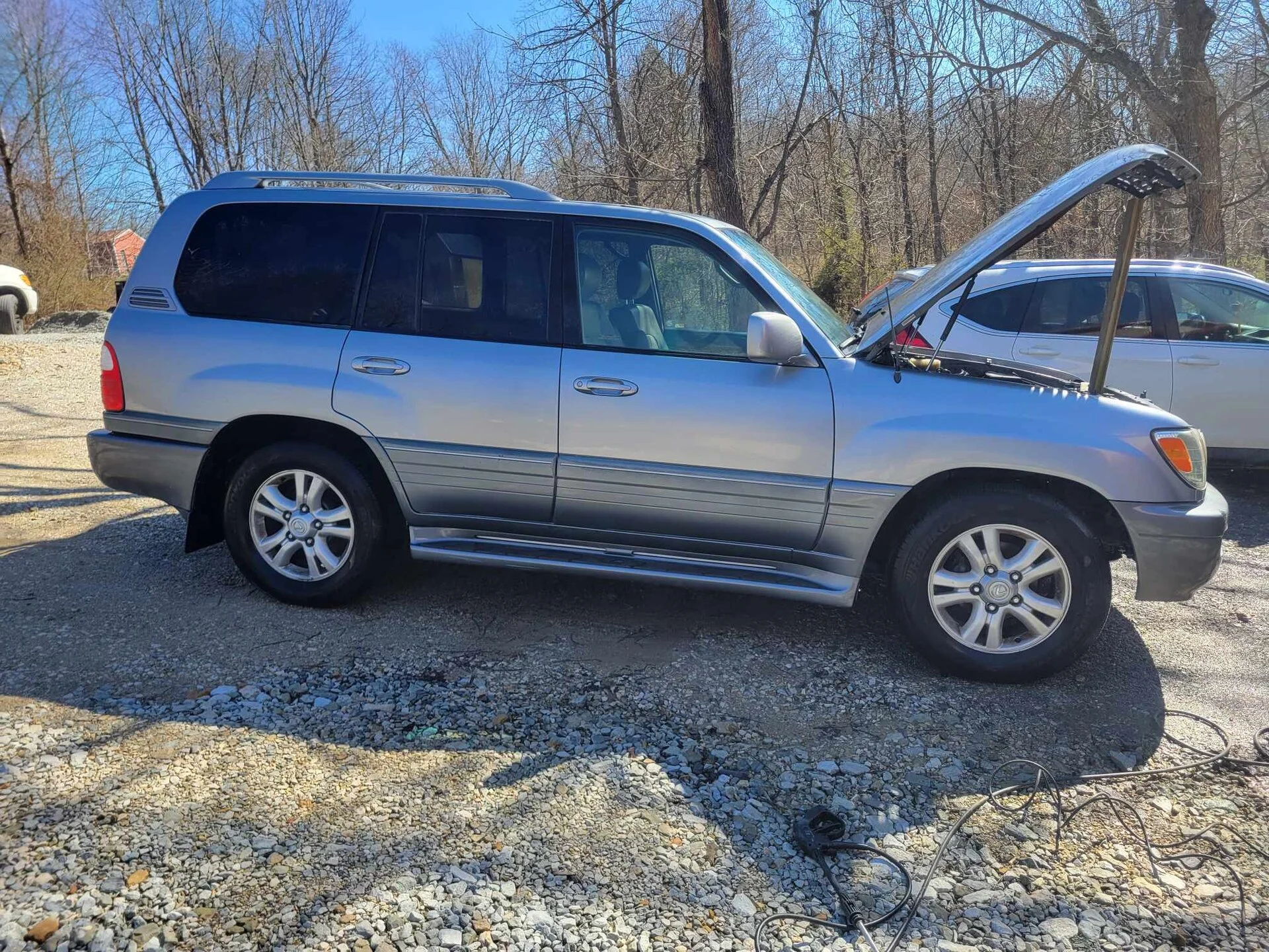

I bid on it, won the bid, and it was delivered a couple weeks ago. As you can see in the picture below, it looks like it dumped coolant from the radiator cap - the pictures below are after I power washed the engine bay even - you can see all the dried coolant. The engine cover (removed) is warped even! When I drained the engine oil I got at least a gallon of coolant out of it too, so this headgasket has probably been vaporized and I assume the heads would look like a banana if I were to take them off. I scoped the cylinders too - lots of rust and scoring. The heater tees are both intact, although one is just a brass tee with hose clamps. I'm not sure I've ever heard of these failing in this manner, so it's definitely a little weird to me.
I thought it was silver in the auction pictures, but it's actually the 'Blue Vapor' color. I dig it! I did replace the hood struts right away, since that's sorta a safety issue while working on the thing…

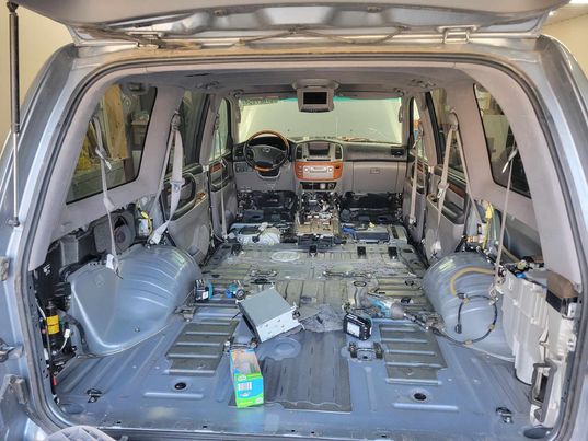

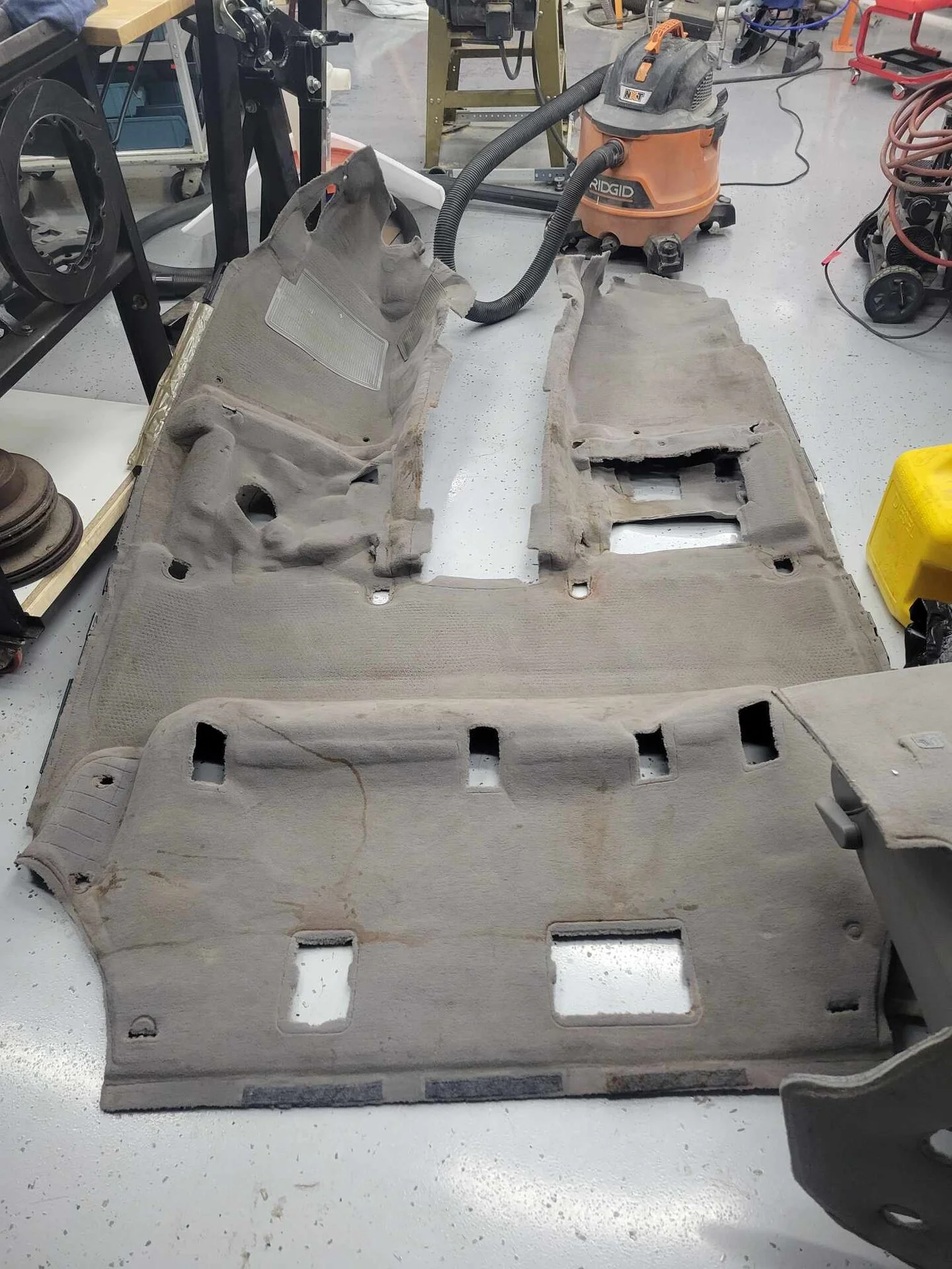

This is after I pulled the rear seats and the middle row, and did some preliminary vacuuming:

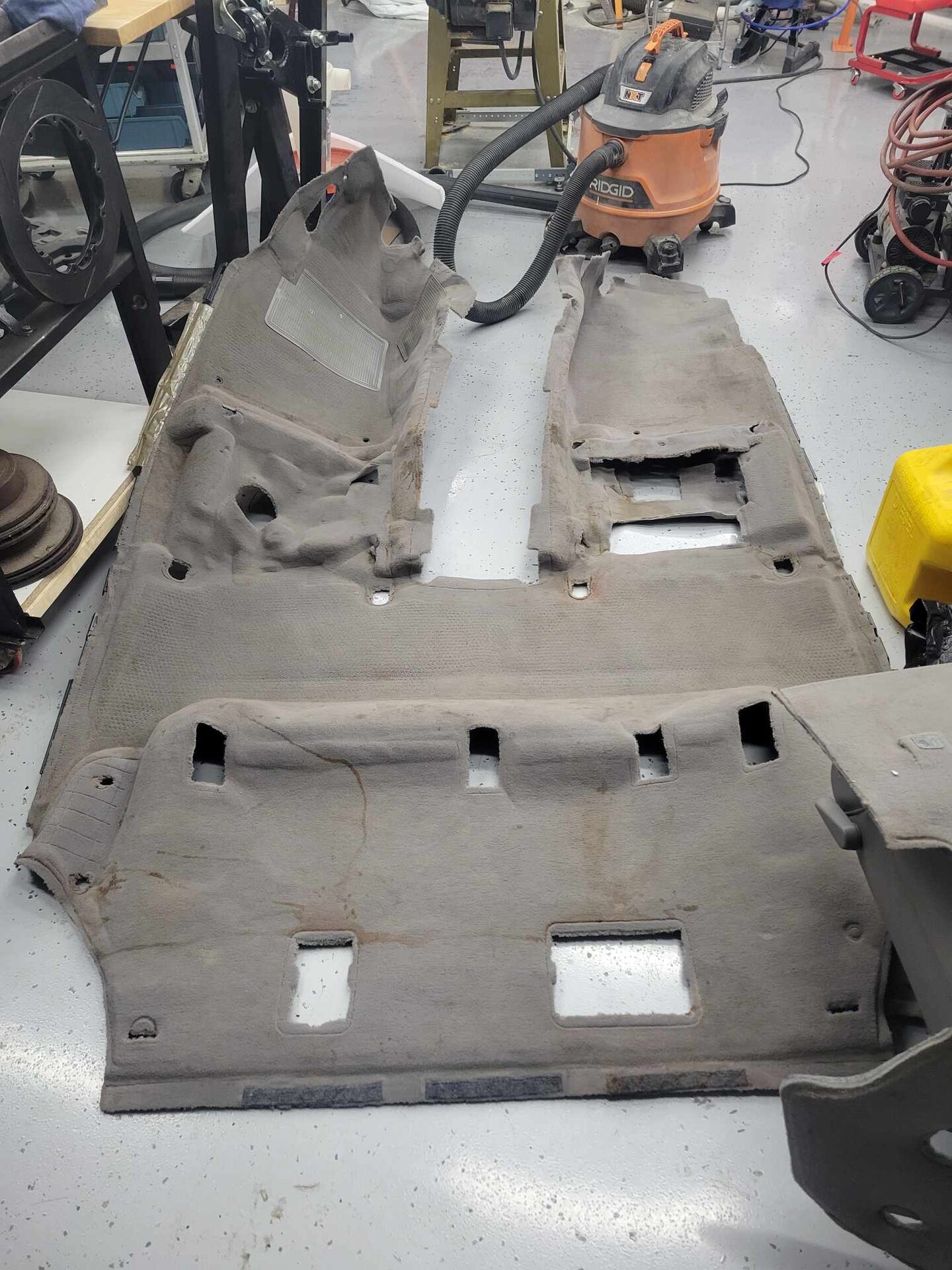

Prewash photo of the carpet - it was definitely more gross in person!

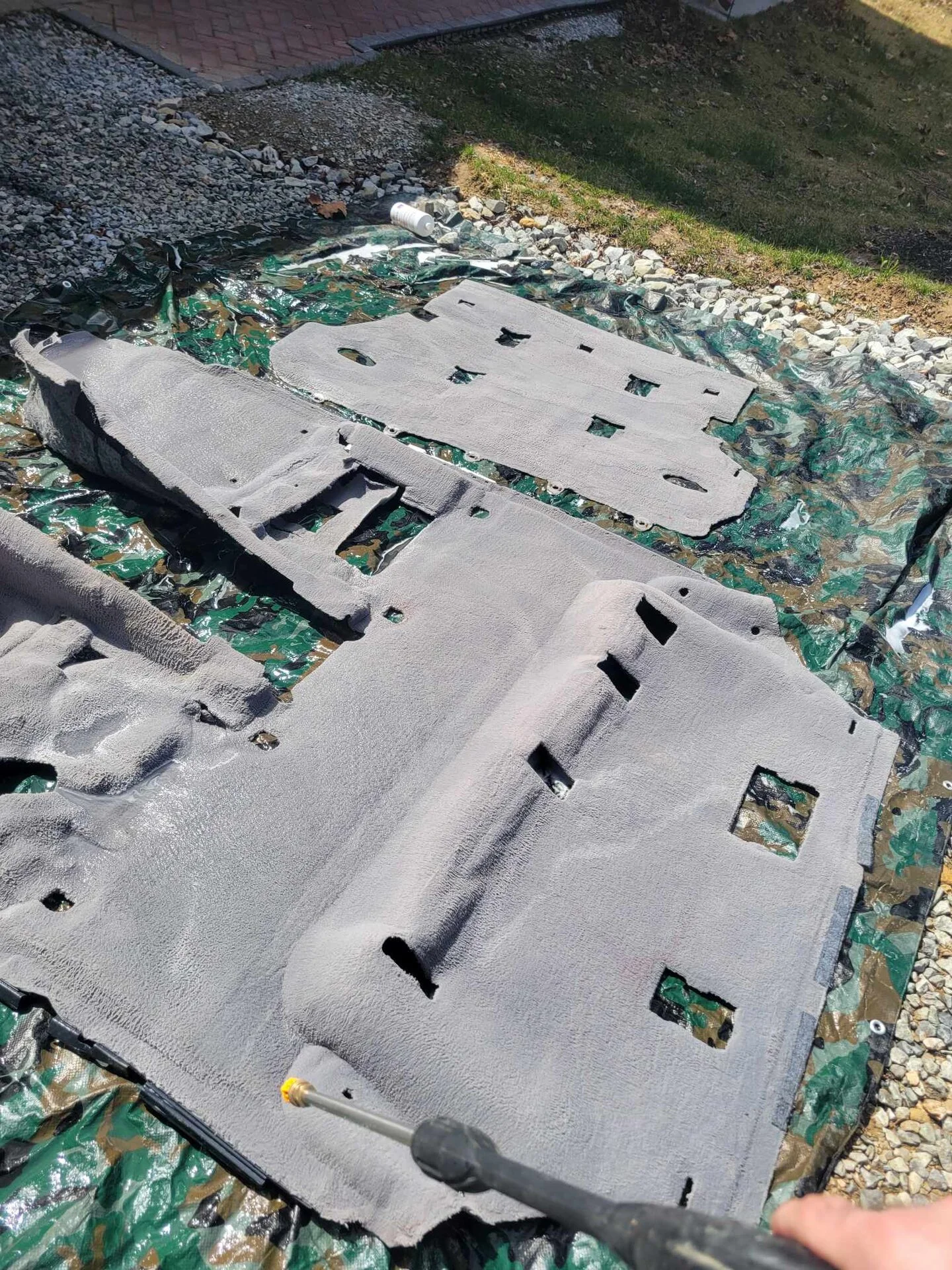

This is after scrubbing by hand with spot cleaner, power washing that out, shampooing, and now I'm making sure all the carpet shampoo is rinsed out…

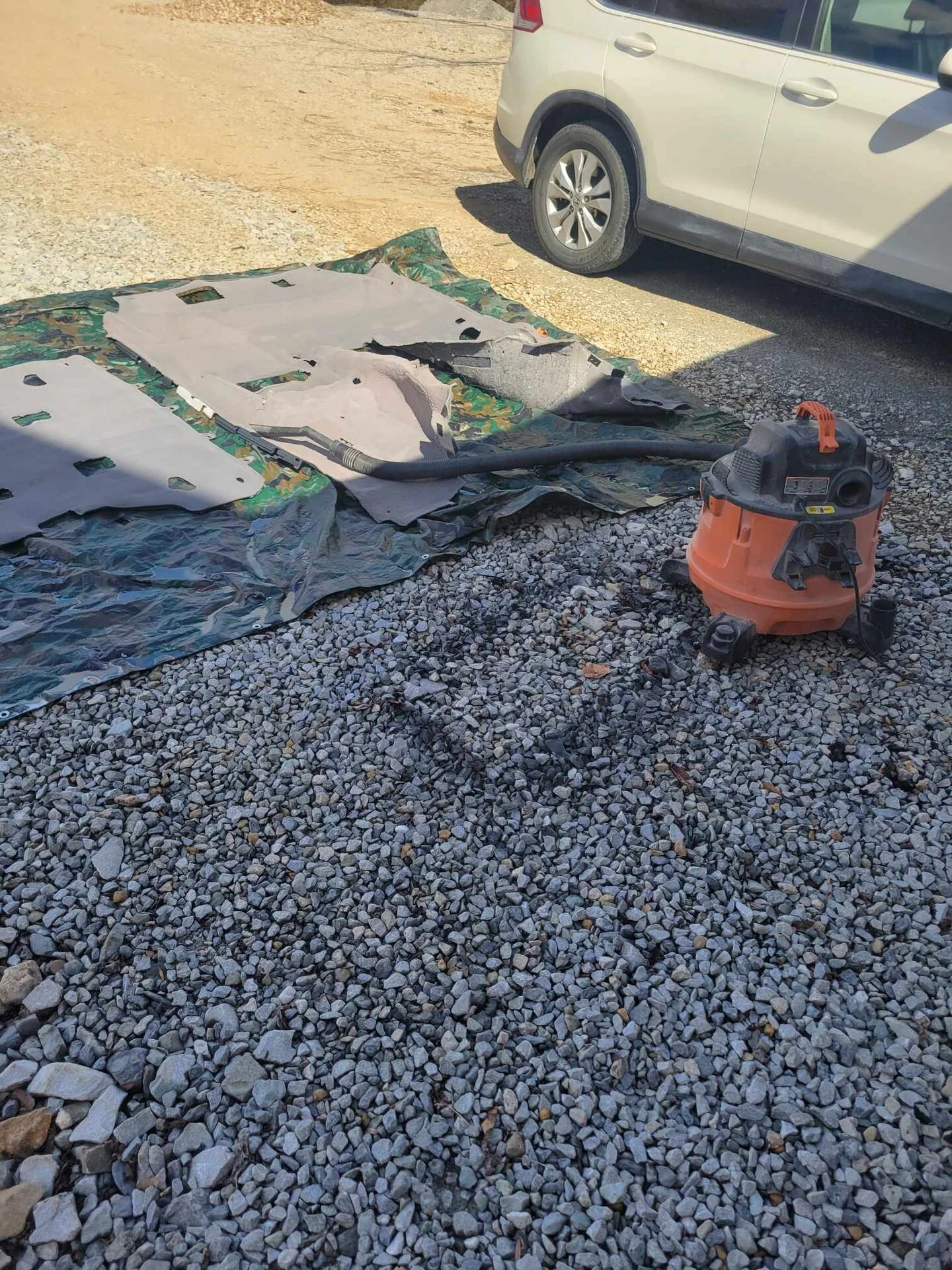

After I rinsed it thoroughly, I shopvac'd it to try to get as much water out as possible. It's been drying in the sun for the past several days to make sure all the pad gets dried before I reinstall it.

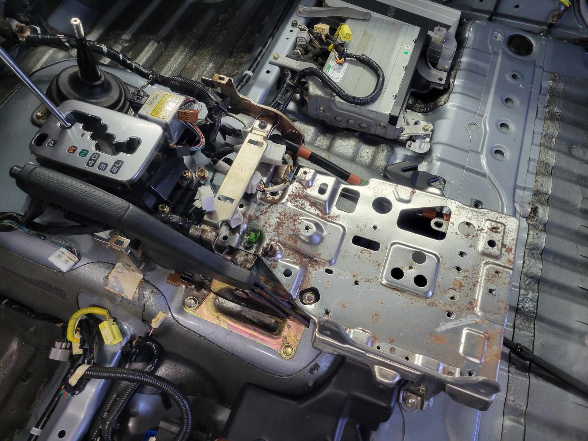

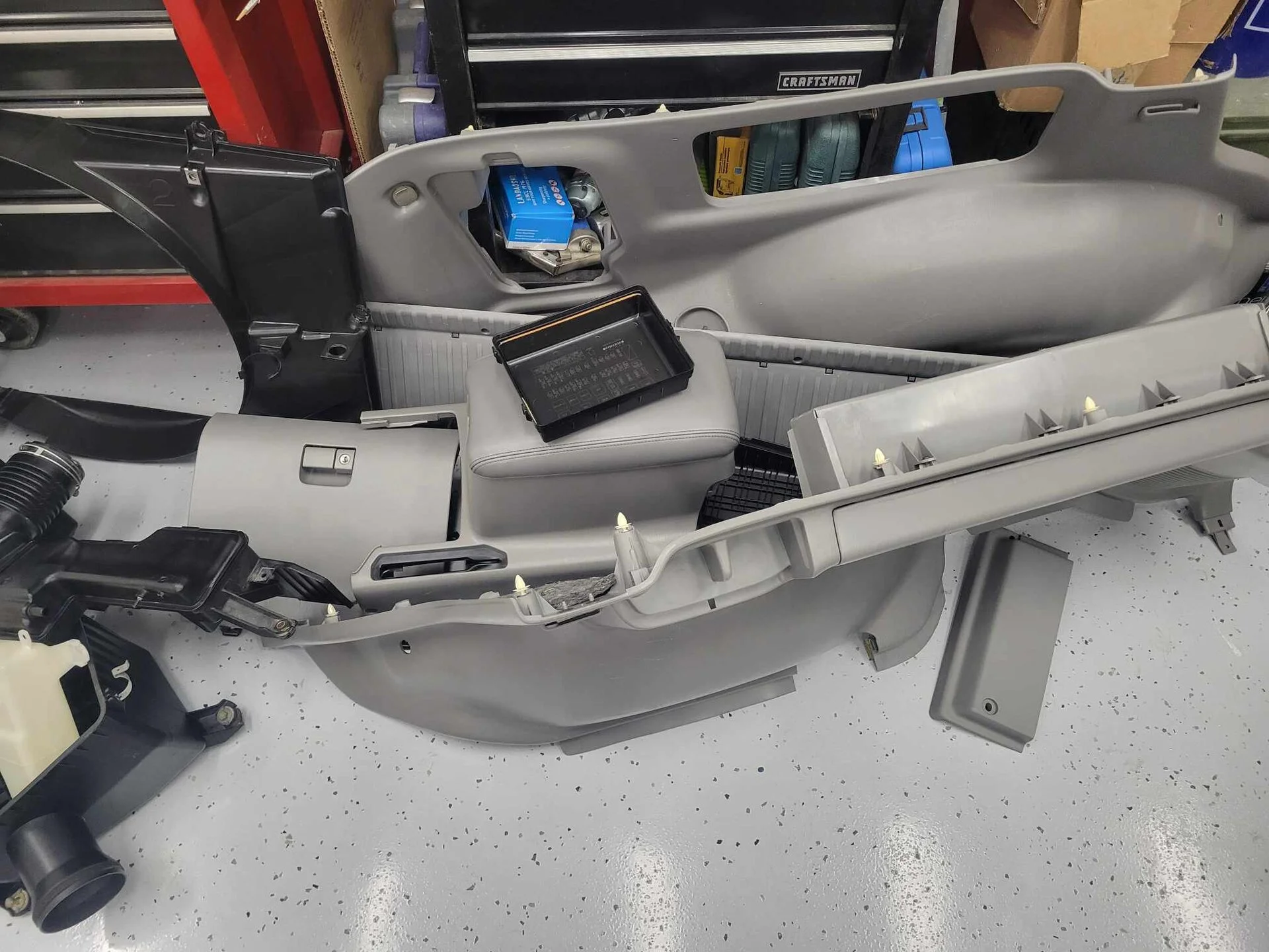

So bare inside! This was before I pulled the door panels and glove box out.
This shot was taken after I pulled everything out here, cleaned it, and put it back together. Minor surface rust on the plate, but nothing I'm worried about. The well where the parking brake cable jumps through the body was especially disgusting! So glad I took the time to deep clean this thing. I also pulled the amplifier and navigation DVD player under the passenger seat.

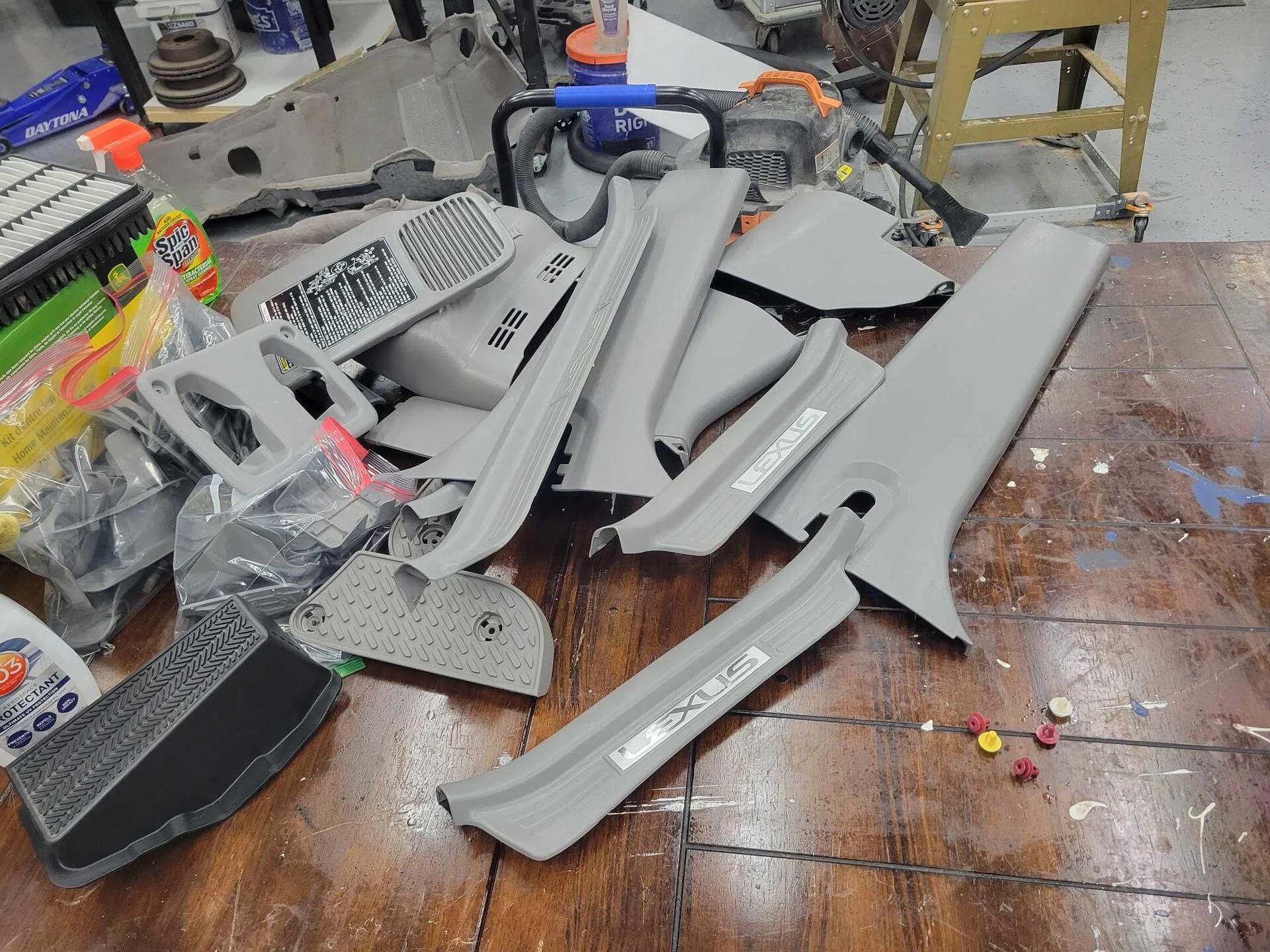

So many trim pieces! This was after a good scrub.

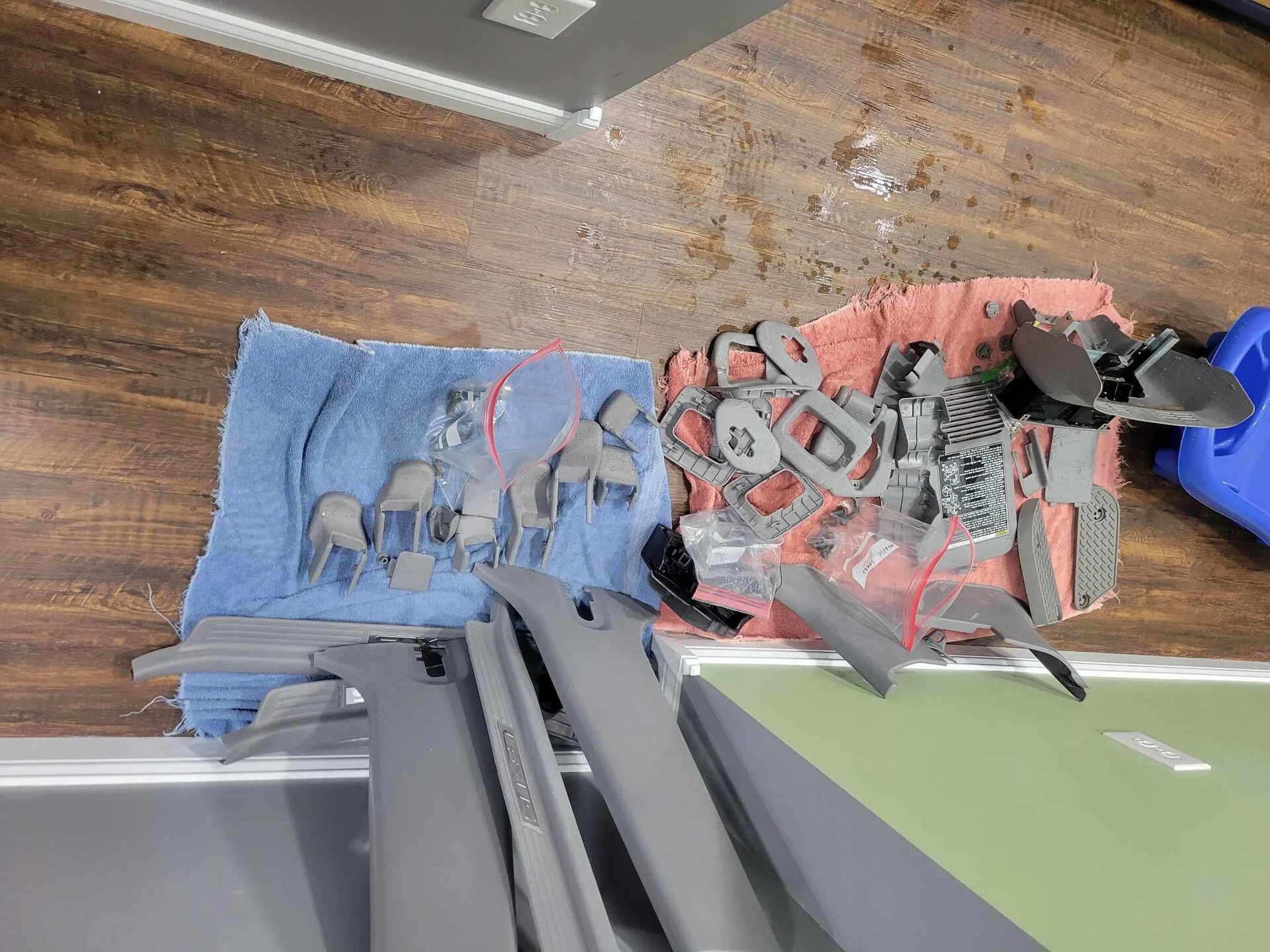

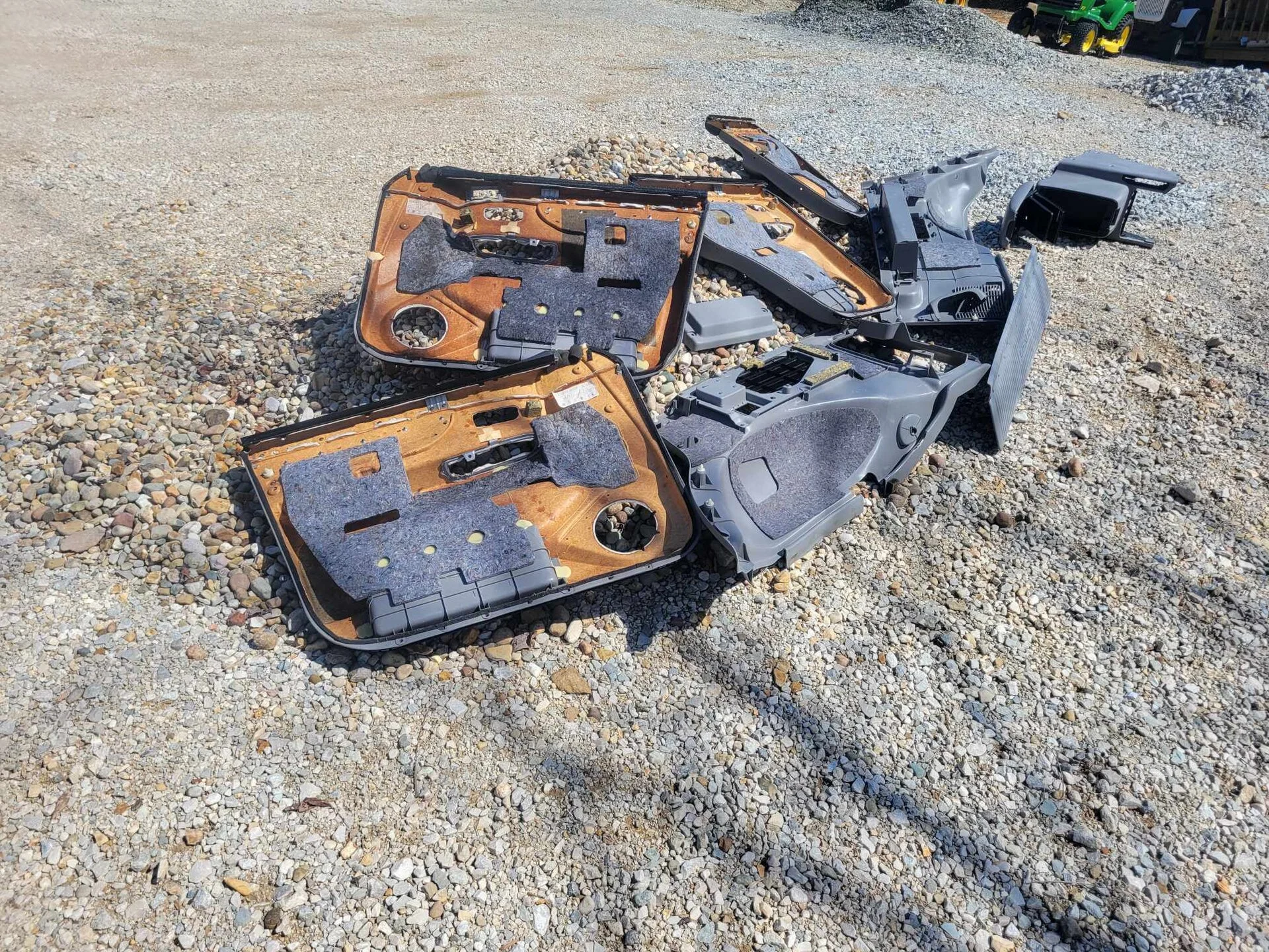

I washed the big pieces outside and let them all dry in the sun:
This is after conditioning all the big trim pieces:

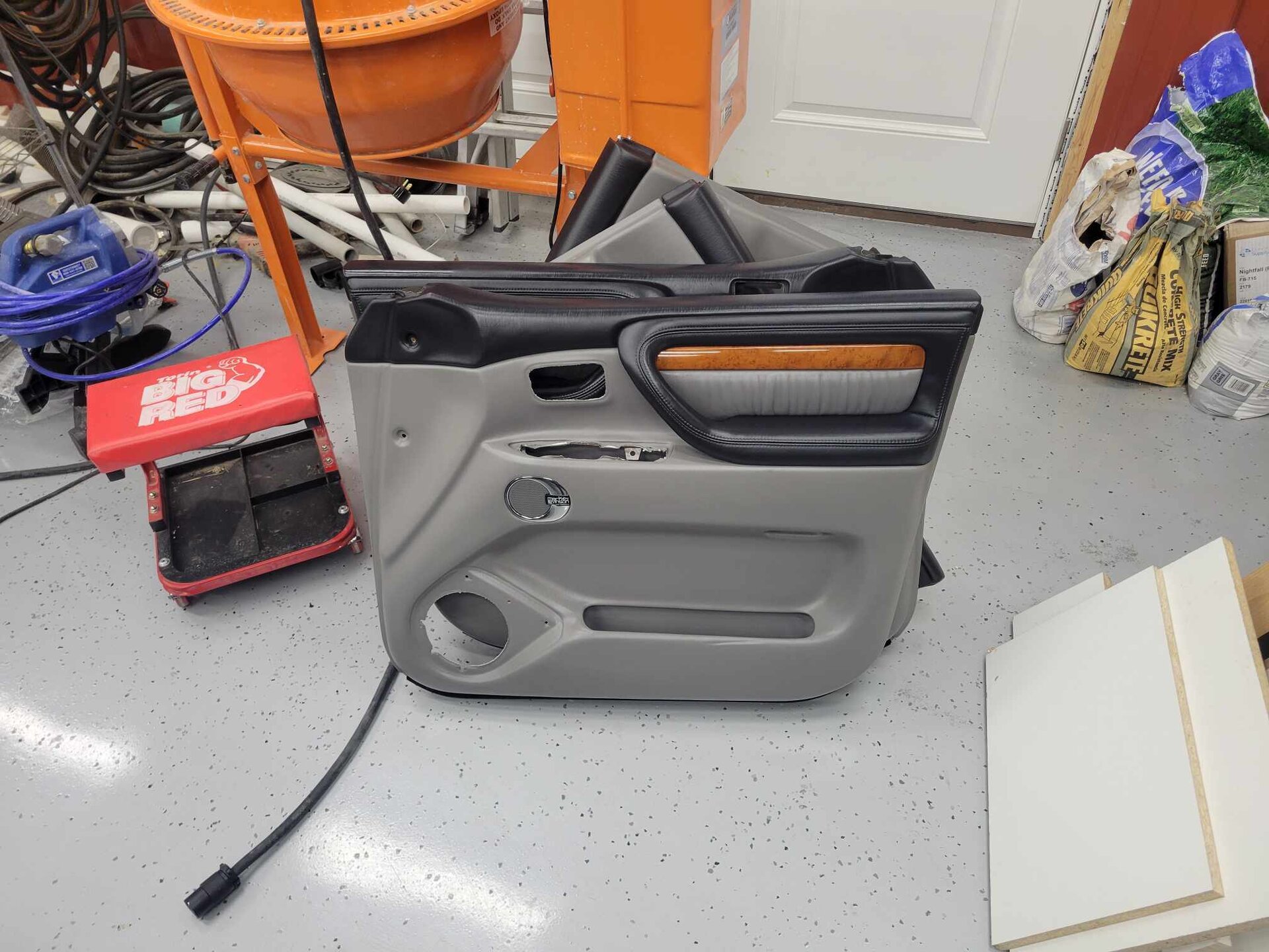

The door panels all cleaned up really nicely too. Overall, the interior did clean up really well - I'm quite happy for a 19 year old vehicle with 255K miles on it! The big trim pieces that cover over the rear wheel wheel have some scratching/gouges, but nothing major at all.
I used Aerospace 303 on all the parts - there's probably something better out there, but it's cheap and easy. I've been using it on our other vehicles and I think it does a pretty good job for interior components.

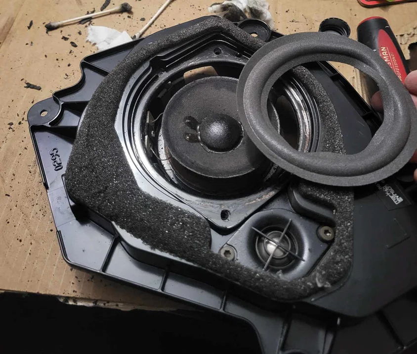

While I wait for all the carpet and padding to dry, I decided to work on the speaker foam on the rear two speakers. The front two are totally fine - not sure if they've been replaced in the past or what, but the rear spears were SHOT. I spent $20 on the refoam kit. It's not a super fun process, but I got it done. Here's an in-progress shot:
I didn't grab a final picture of these, but I figure you folks know what a speaker looks like :p. I decided to keep the Mark Levison system for the moment - we'll see if I upgrade in the future. The subwoofer is SHOT (like, the cone has been ripped out and is hanging…), so it's time to replace that rather than refoam. I ordered the SKAR EVL-65 D4 that's been recommended here. I'm not expecting huge bass, I just want it all functional.

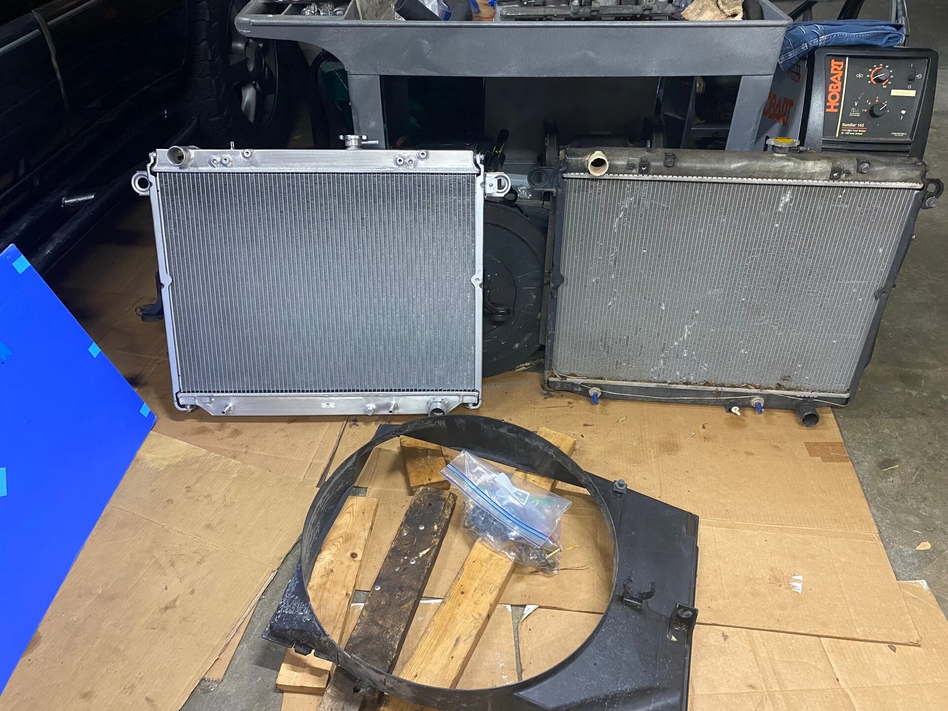

I have bene running the CSF aluminum radiator for a year now, and it's great. Fits perfect, No complaints whatsoever

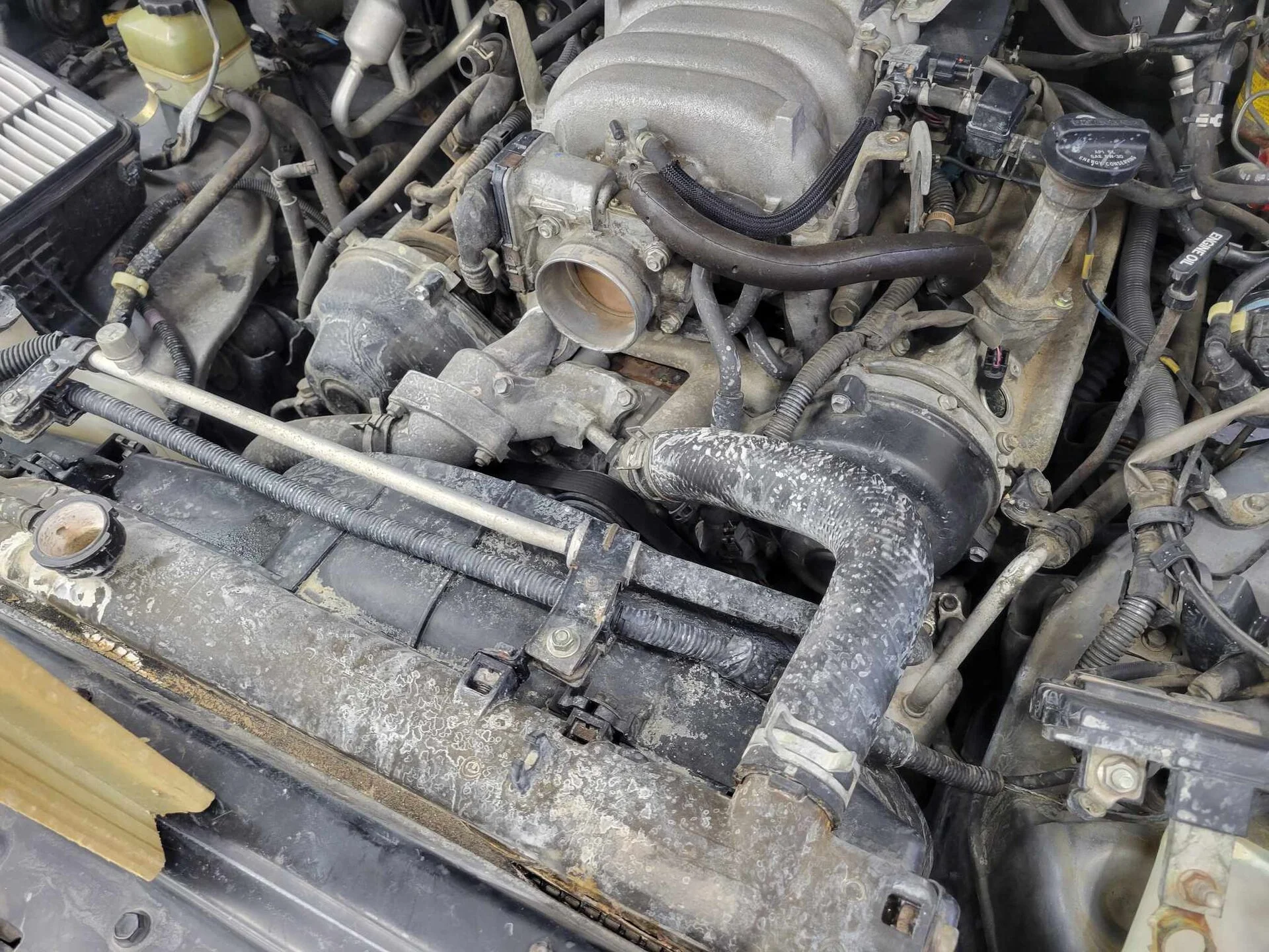

Also, while I working on getting the radiator out I found this as well... definitely not a happy radiator. Thanks for the feedback on the all-aluminum CSF @excessive - I'll give it some more consideration!

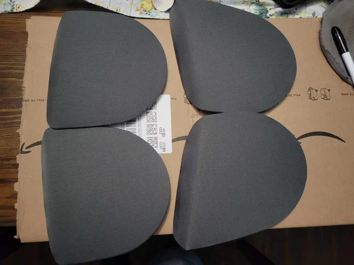

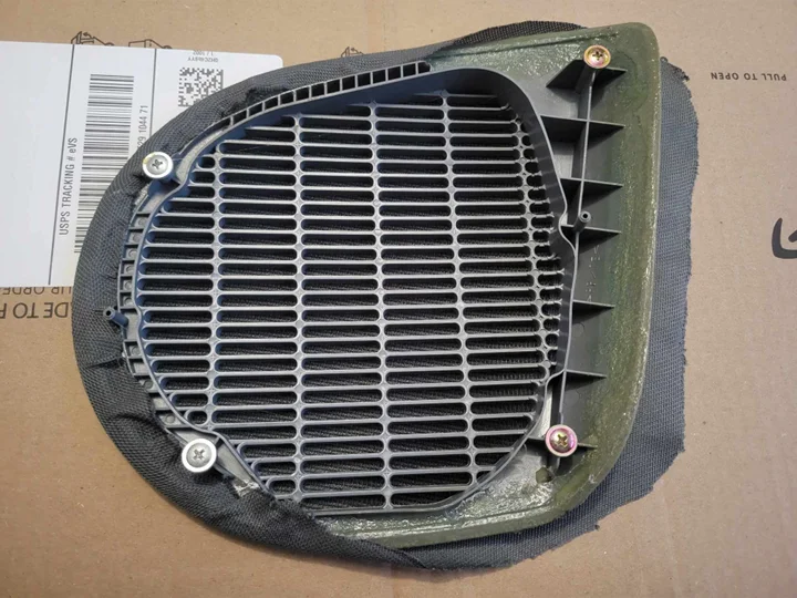

The speaker grills in the interior door panels were pretty rough. They may have cleaned up with some soaking, but a couple of them were a little ratty looking. I ordered some speaker grill material from Amazon - I'm not sure how well it'll hold up, it's definitely thinner than what came in the vehicle. It's an easy enough job that if I need to redo it if this stuff doesn't end up being durable enough, no worries.
Step one is to use each of the old grills to trace out & cut out the new material:
No description available.
There's a black mesh that sits under the fabric. Once I cut the new material out, I lined everything up before applying the contact adhesive.
Once I apply the contact adhesive to the back of the plastic grill, I let it set up for a couple minutes, then start gently stretching the fabric over it and pressing down. Super easy!
And here's all four of them done. I haven't put them in the door panels yet, but I think they'll look sharp.

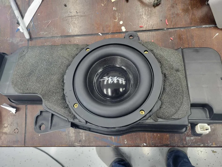

My replacement subwoofer (SKL-65 D4) came in today, so I took some time to get it mounted. It's not quite a direct fit, you do need to trim out some of the ribbing on the interior of the backside of the sub enclosure.
I marked out the ribs I thought I needed to remove - I think I ended up taking some more of the vertical ones above the ones I marked, but this is close:
I found the easiest way to remove the ribbing was with just using some lineman's pliers - grab it as close to the bottom of the rib as you can, and then just twist. I used the endsnips to clean up anything nubs that got left behind. You could definitely spend more time with this if you wanted, but this ended up decently clean:
The EVL-65 D4 is a dual voice coil - so there's two 4 ohm coils. The stock ML sub is something like 12 ohms (though, I didn't actually measure), so it's definitely weird. 8 ohms is close-ish, and it seems like people get away with it without destroying their stock amplifier. To achieve 8 ohms, you wire the voice coils in series (so the positive (+) terminal of one goes to the negative (-) of the other - like this:
Then, I just wired the red wire running to the original sub to the remaining positive terminal, and the black wire to the remaining negative terminal:
The bezel is also larger than the stock ML sub, so I used some butyl rope material (the same stuff you'd use on the vapor barrier on the doors) to form a seal. I ran a continuous 'bead' around the bottom of the bezel of the subwoofer, then pressed it down tight into the enclosure. You're seeing the squish-out here - I think it made a really good seal. I definitely wouldn't skip this part, since I can only assume it'd negatively affect performance.

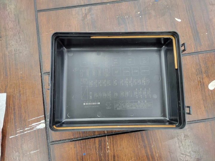

The gasket isn't a part that you can order separate from the lid (or do you have to order an entire fuse box? I can't remember...). However, I found a post somewhere here on MUD where a helpful user (@05JLX470 ) stated it's just a 3/32" square gasket. I ordered 10 ft (the minimum order...) from Zoro for something like $9.50 shipped. Super quick and easy!
You can see part of the gasket that is laying in the left of the fuse box:
And here's the rest of the gasket left in the lid - it just shattered into pieces trying to get it out with a pick:

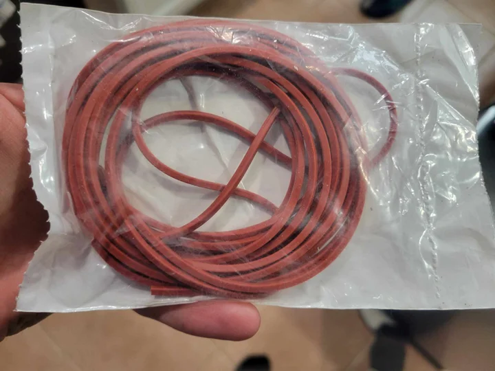

Here's the gasket material I used:
And this is what it looks like:
Pick a spot to start at and just make your way around:
I realized that I forgot to get a picture of the gasket once trimmed and fully installed - but I figure you can use your imagination, haha. Just cut it a little long and trim it down to get a perfect fit when you butt the two ends.
Here's a picture I grabbed with the lid reinstalled. It's amazing the contrast between the (uncleaned) fuse block body and the cleaned/conditions lid, haha:

I also had a chance to disconnect the engine harness from the ECU and pull it out. RELEASE THE KRAKEN! hahaha.
At this point, I just need to dismount the AC compressor (sounds like I should be able to leave the AC system all connected, just need to pull the compressor off the engine) and then disconnect the motor mounts and I (think) it should all be ready to pull out! I'm going to review the FSM again to make sure I'm not missing anything though.
Hey nice progress. Rear speakers can be addressed with Dayton Audio components, such as in the link. I have some B-stock, 2 bnib and 2 open-box/never installed units, all four for $160. If you are interested, DM me on IG or my shop's site, I am a one man army so just say that you are from Mud.
Thanks for the offer! I think I'm going to keep the front speakers (still in great condition) for the moment though. I'd like to get an idea of what this system sounds like as close to 'stock' as possible I think.

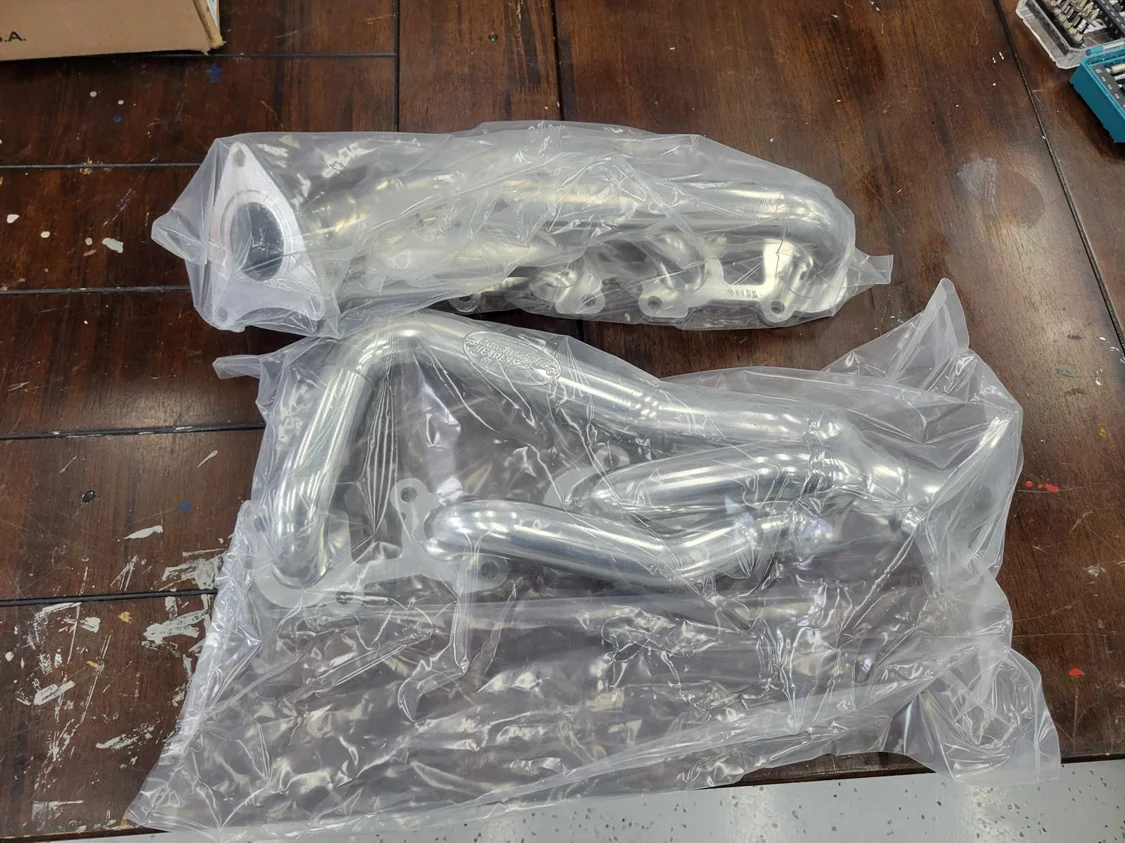

And speaking of manifolds/headers... these came in yesterday!
wow, i thought those headers were NLA! They look beautiful !
DT does short runs, so sometimes you have to wait - but they've got some in stock right now! They definitely look really good. Too bad they'll be nearly invisible once installed, haha.
