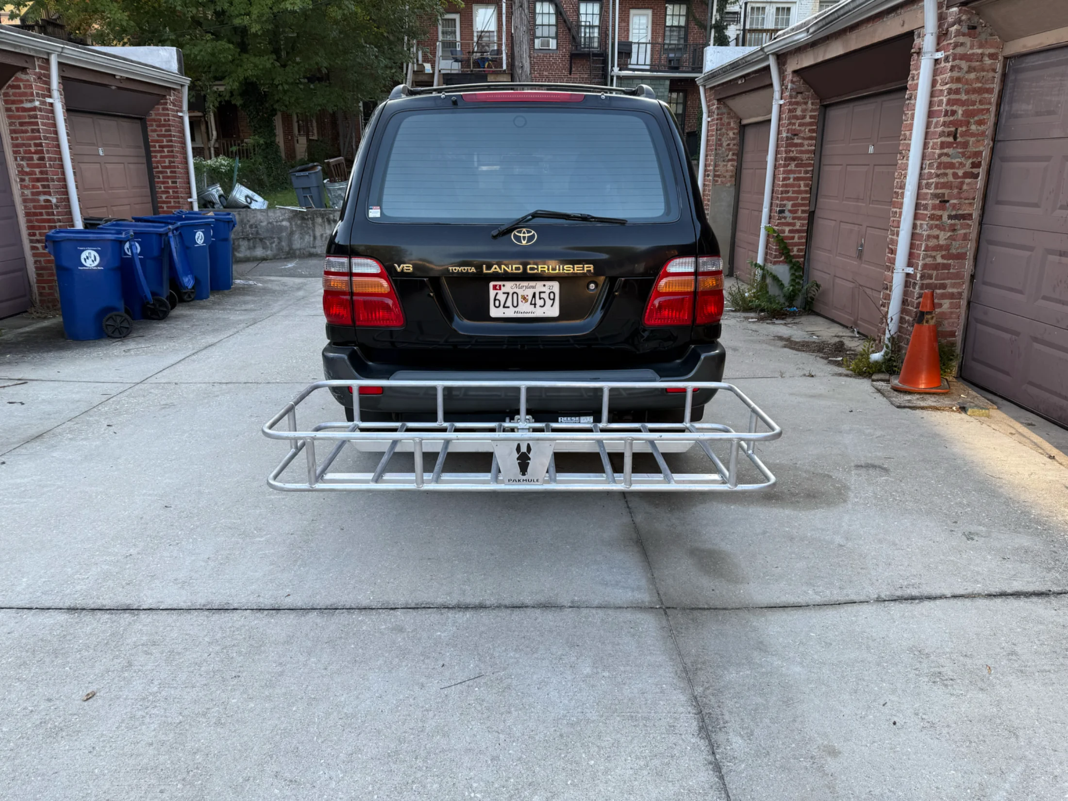

I acquired a PAK MULE today. Used with lock excellent condition. Nice looking and very sturdy. It's an original pro version, but I'm going to need a high / low hitch adapter to be able to lay my tailgate down flat with out the tailgate resting on the cargo carrier. I do love it though. I was able to haul a huge recliner on it today with no issues. I think it's going to come in handy for many more future choirs and adventures!

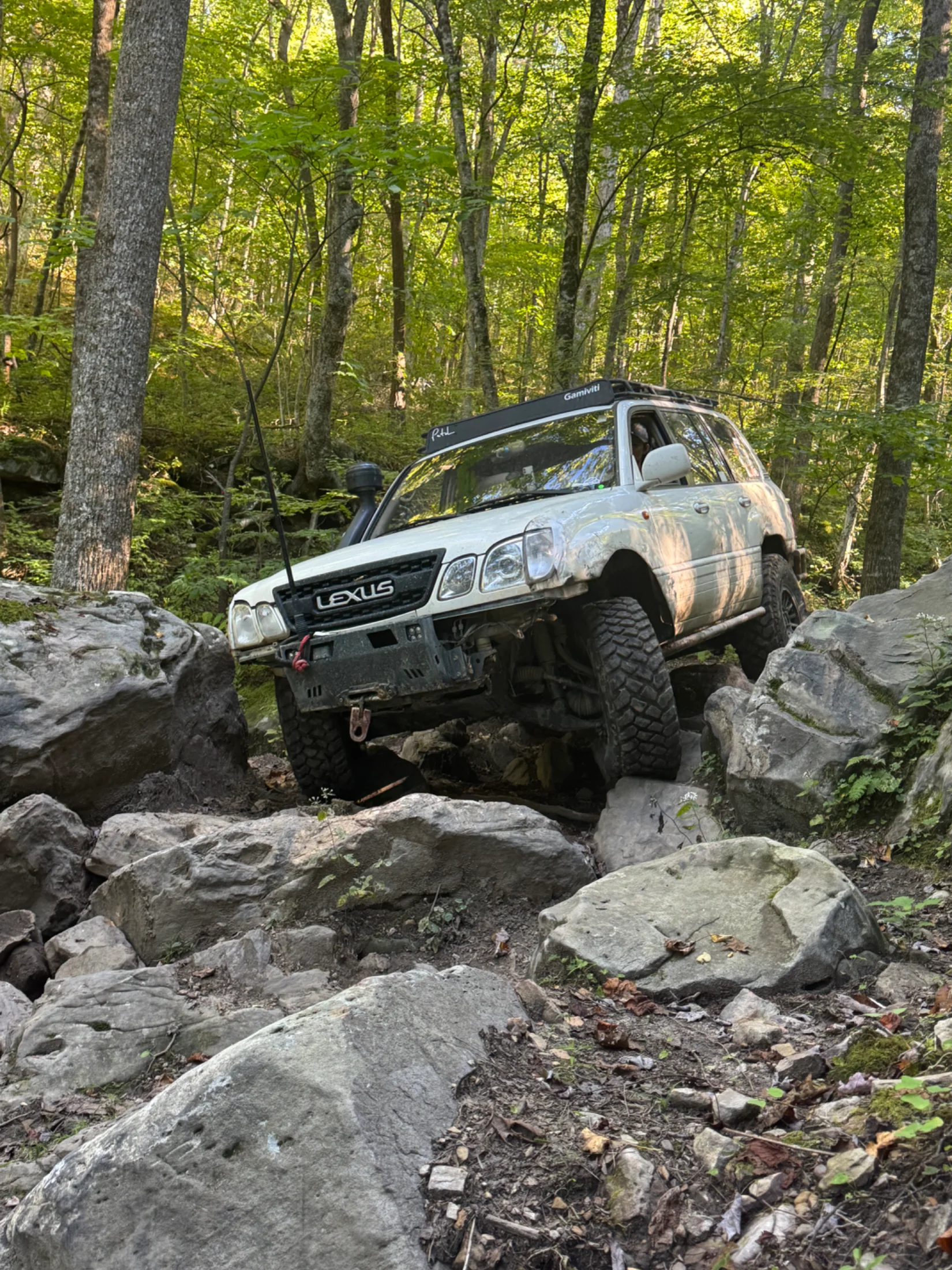

Blew up my center diff last weekend…
1.097:1 high range
3.31:1 low range
37x12.50r17 tires
4.30 gears in the diffs
Beginning to think 100s just can’t hang with the big dogs…
Threw in a spare center diff to get it back on the road. Will probably part-time it next time I have to open the case

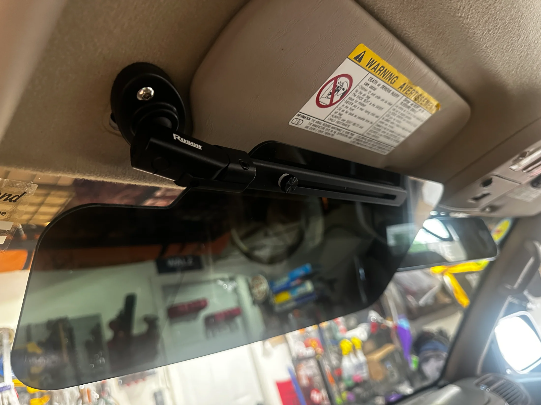

Rosen Sunvisor installed on my 1998. Their website says it fits some 100s. I got one for the driver side only.
All it needed was some longer m5 mounting bolts. I used 20mm but 15mm would probably work).

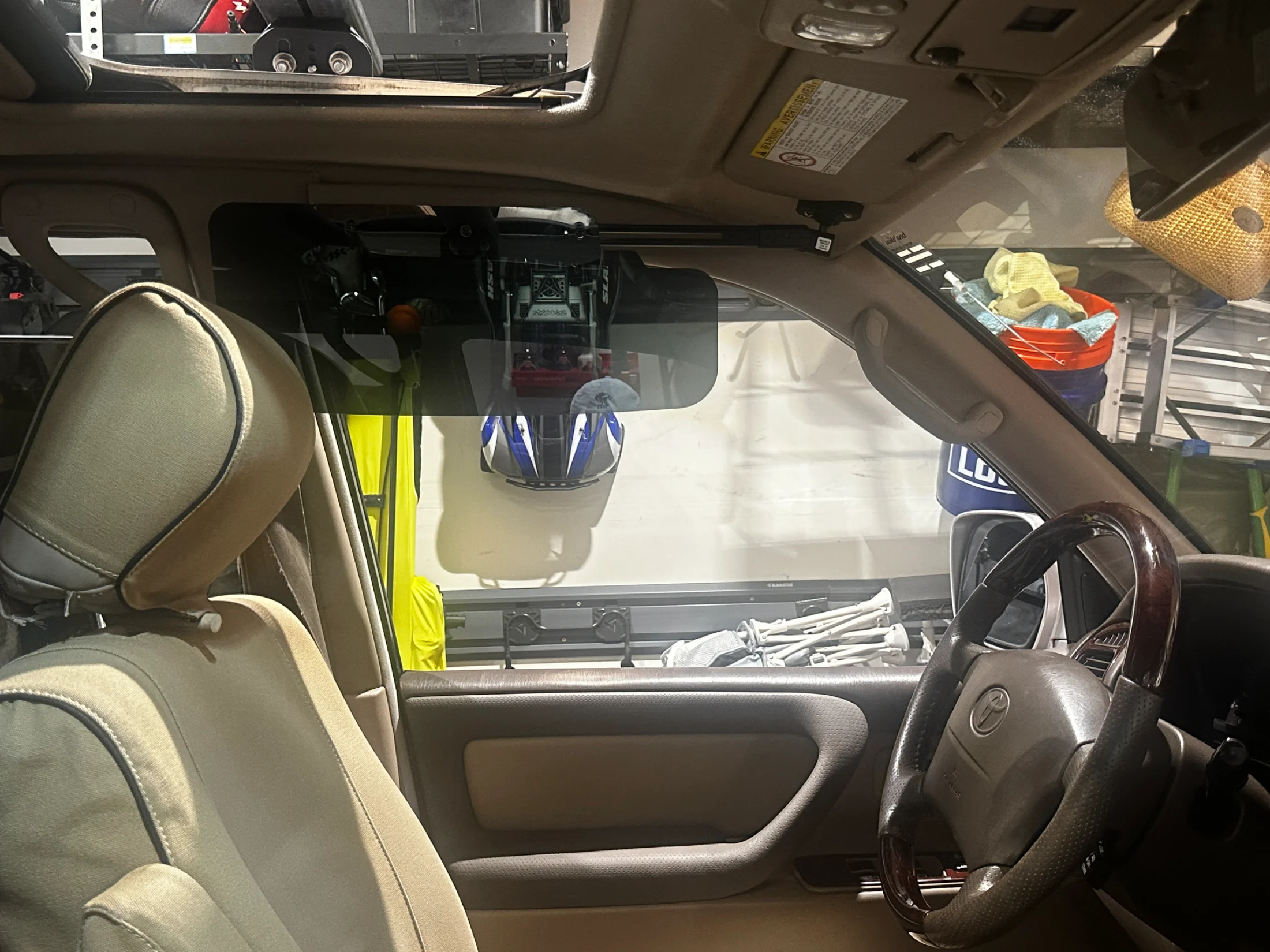

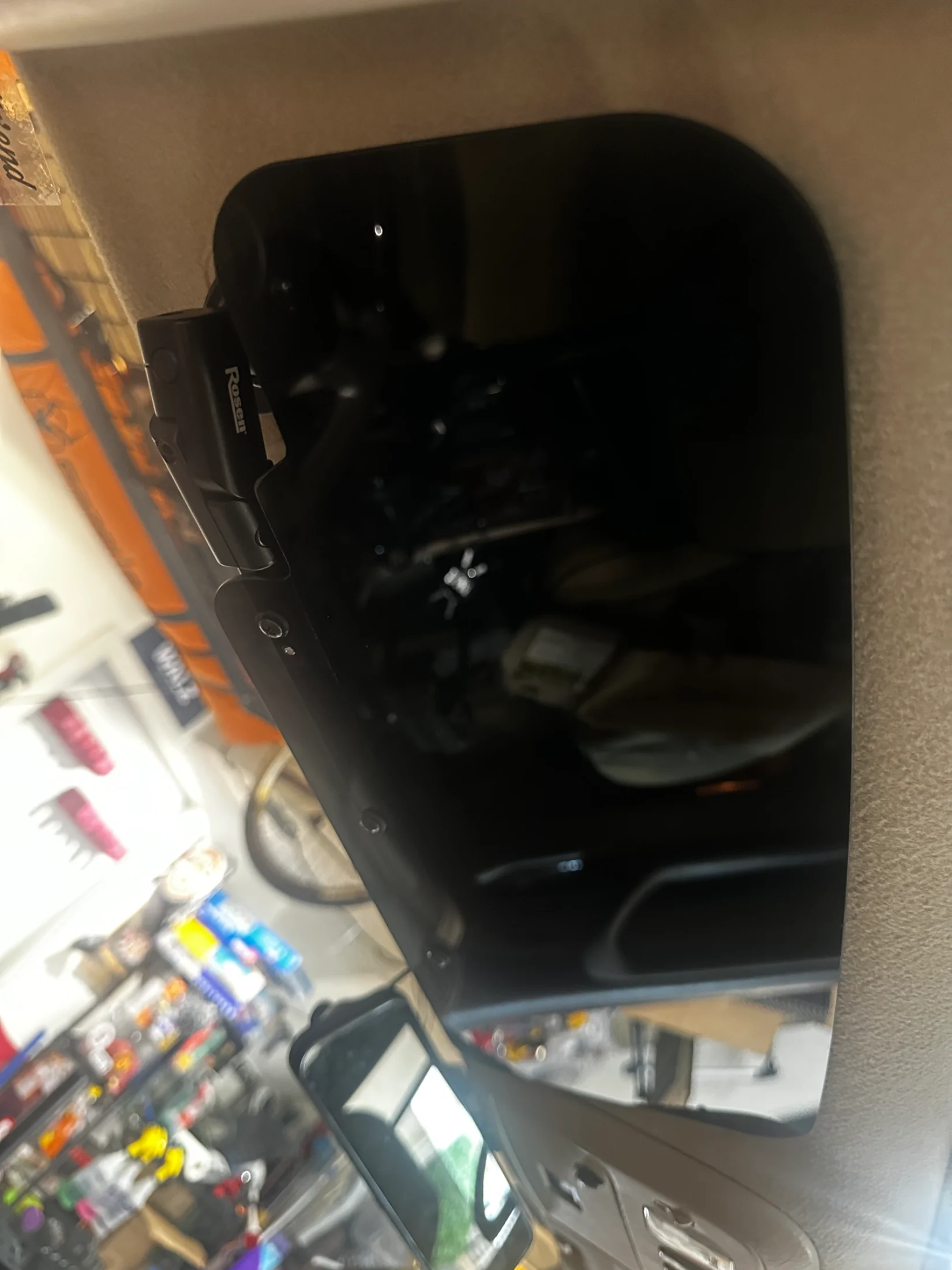

Clears the 12” wolfbox g900 mirror with no issue.
1.097:1 high range
3.31:1 low range
37x12.50r17 tires
1999 Lexus LX470 2-pinion center differential failure (316,000 miles)
Patch, you're definitely the guru here I will admit, but isn't that kind of high gearing still for 37s? Wouldn't adding 4.88s reduce the strain on everything even further and give you more control in the rocks? I've heard these t-cases are pretty robust.
I know the automatic definitely helps. Just thinking out loud really. Absolutely love seeing you test these rigs to their limits. Keep on ROCKING it!
Might be “high” for some but personally I think it’s right at the sweet spot. A 100 can’t really crawl anything anyway (out here in the east, anyway).
Momentum is nearly always required over here on the east coast. I’d be more worried about breaking an already weak pinion setup (in the front) if I go to 4.88s
At 7,060 lbs, my truck is just too heavy to crawl anything anymore…

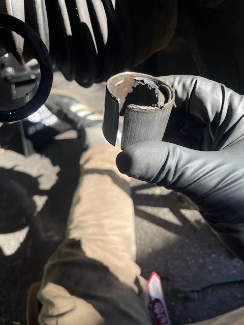

Did lower control arms, #2 bushings and ahc "shock" bushings. Truck is finally silent again! LBJs were creaking and the shock bushings were so shot that eyelets were starting to make contact w/ the LCAs. I think it was time! What a pain though - ended up having to hacksaw them out of the eyelet.
View attachment 3997542View attachment 3997543
What does that look like when put off to the door side? Biggest complaint with OEM is that it does not extend and sun still hits my eyes
you can slide it almost the full length of its bracket so can place it anywhere in the door window you’d like.
Sweet, answers a question for me. Have the visors already, and mirror inbound.
Those are next on my to do list too. Not looking forward to it. My lower bjs have a tiny amount of play and I think it’s causing a little uneven tire wear on the front. Did you have any special pullers or presses for the No.2? I saw you had to hacksaw, just curious if you tried anything else prior to resorting to the saw.
Yeah I couldn’t scrap anything together for the shock bushings that were the right diameter. Was able to use the rented ball joint press from advance auto to get the new bushing into place.
