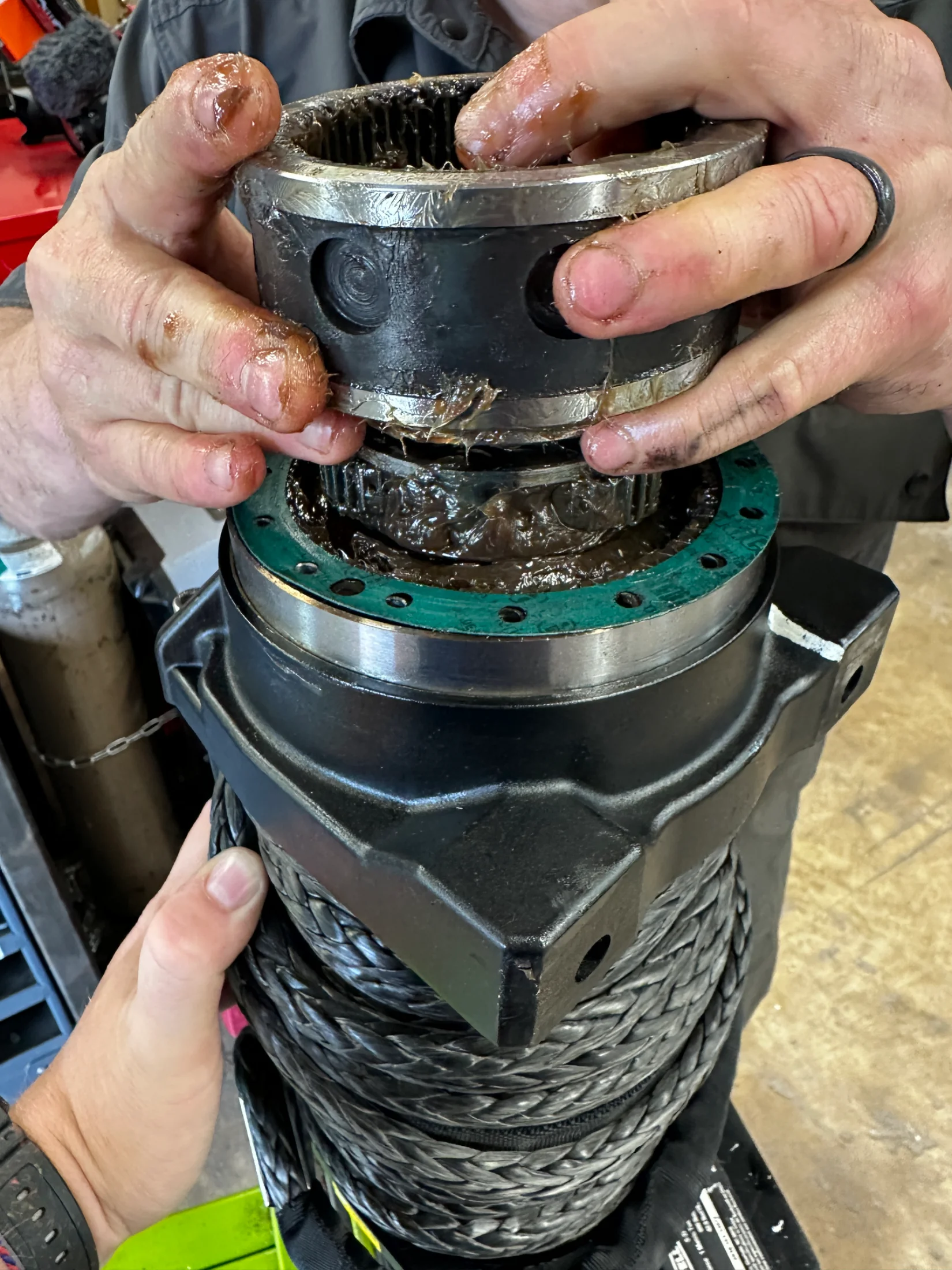

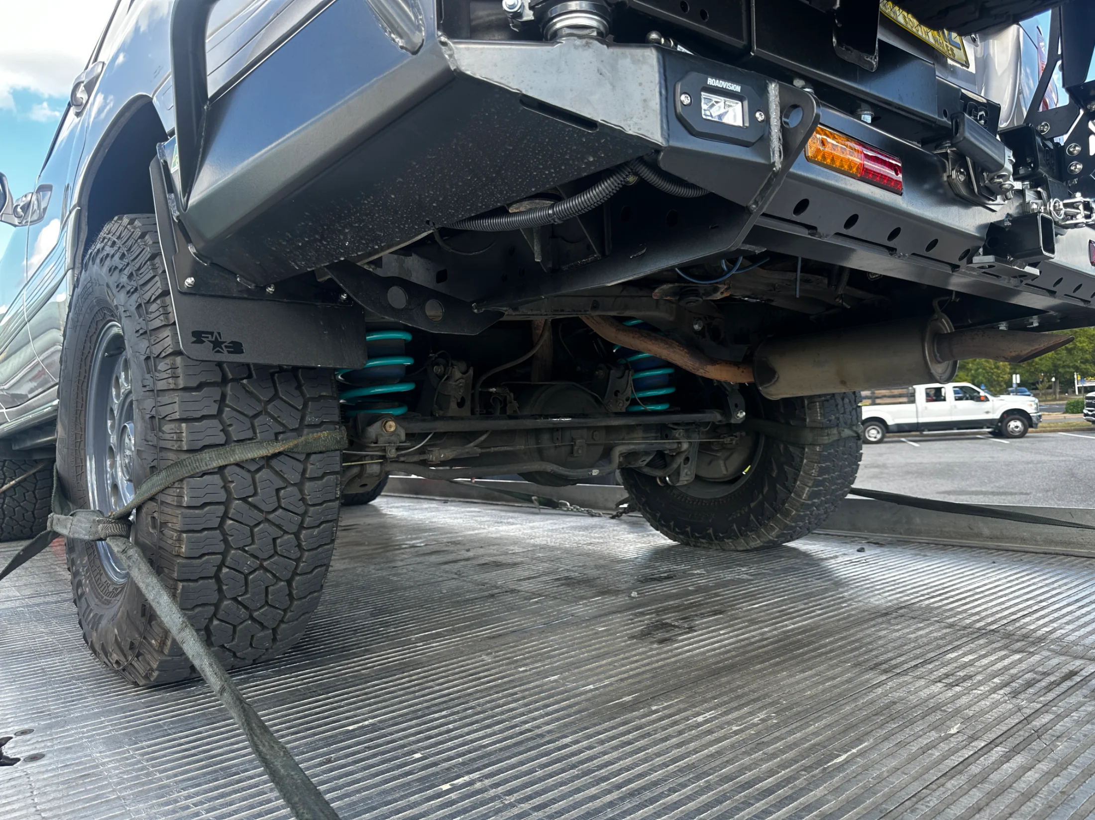

Swapped Dobinsons springs during a shop day at @OTRAMM to go up to the 440lbs constant. Also got some help clocking my winch.

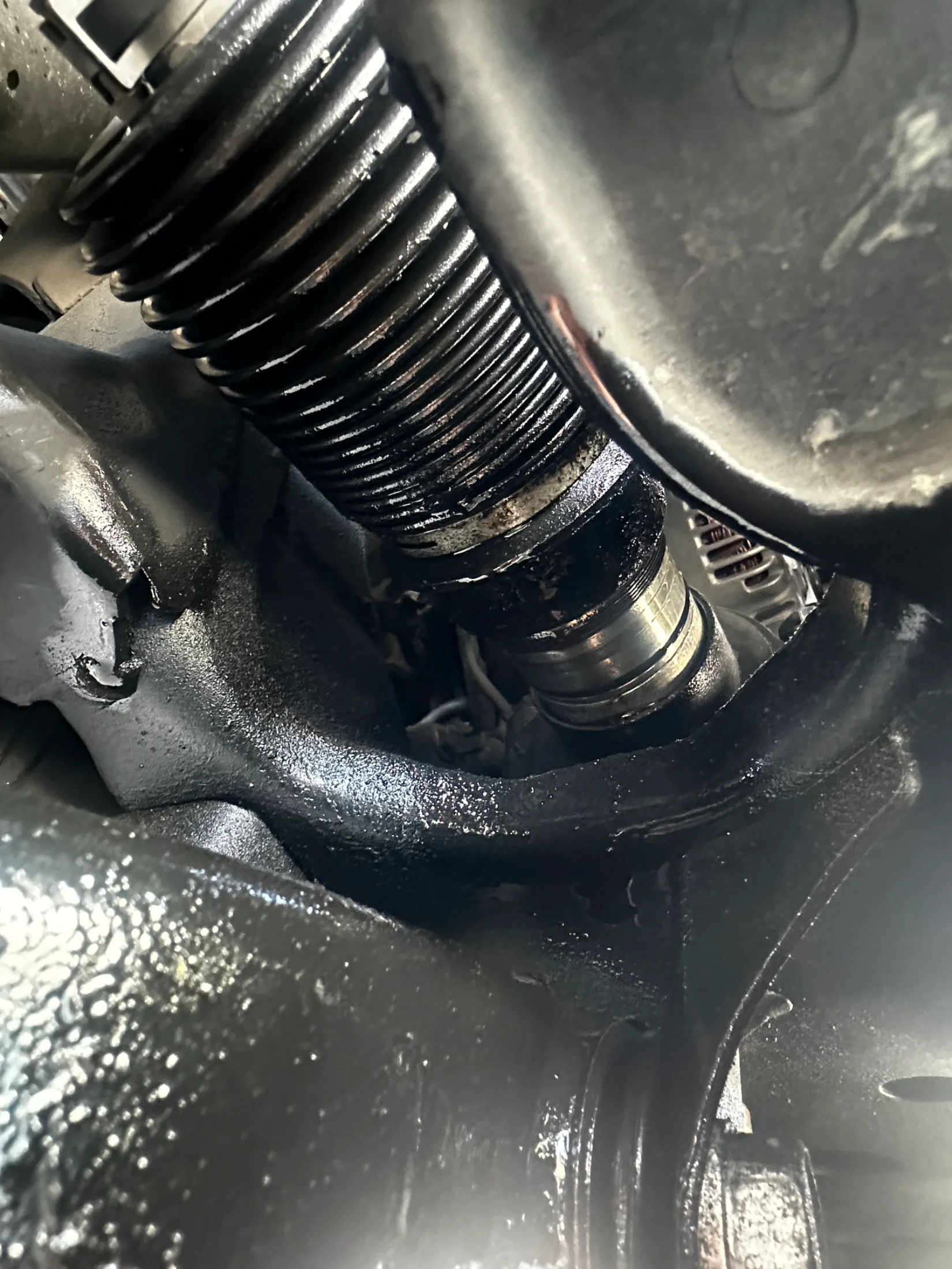

…then latter that week literally blew my steering rack. Threads separated. Anyone ever see that before??
Unclear if it was reman or by whom but did have Toyota stampings. Other than putting some new boots on it a few years ago and a flush I hadn’t touched it since I’ve owned the truck (6 years)

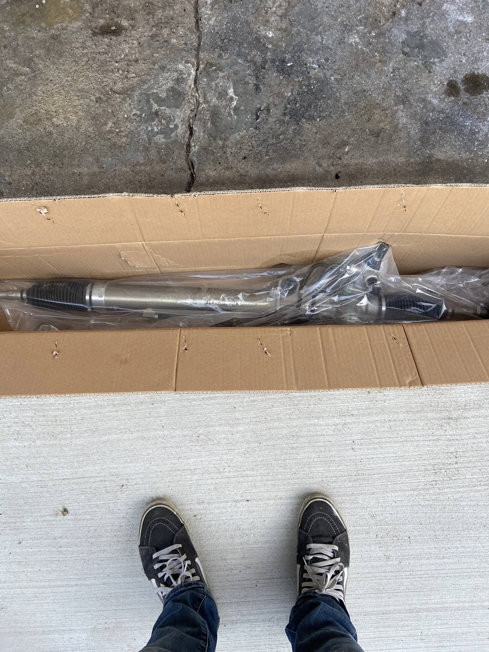

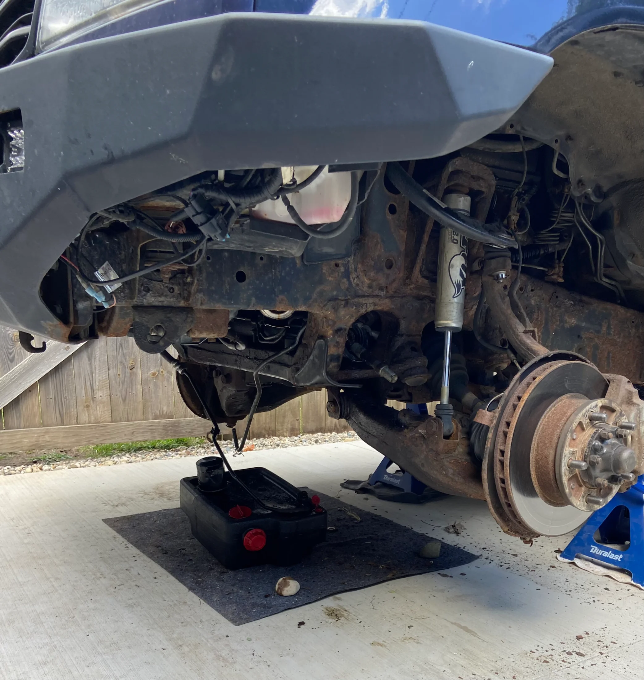

Holy s***! I tackled the dreaded steering rack job on a rusty old Michigan Cruiser! What a job! Not bad over all, but man, between the return line seized in the rack and the steering shaft seized at the rack, there was a lot of extra time handling those, 10-12 hour estimated completion. Sawzall for the line as I had new, and removed the rack shaft attached. New went in pretty easy, got it all buttoned up… one or so spline off 🤦🏼‍♂️ manageable for now. Fix it next weekend…
Well, it wasn’t every single other steering component possible... But at least everything is new I suppose 🤦🏼‍♂️
Before the OEM only crowd comes for me, yes I know. My girl is not getting cleaner, only rustier, but I’ve accepted that and battle it where winnable. And after 8 years of ownership at $4500 purchase price, everything from here out is aftermarket (non-engine related) until she croaks. If the rack goes in 2 years or even a year, it’s just a reason to finally say goodbye.
I need to replace my rack before I drop in the engine, which brand did you get and how much? Thanks for sharing.
I rolled the dice. As you can see the old girl is rusty, so justifying a $700 part for a truck that might not be on the road in 2-4 years, just didn’t make sense. The dice roll paid off from what I have found. I grabbed the “Wholesale private label” $186 rack from RockAuto. Turned out to be (from what I can tell) a $400 API Automotive rack. Does that mean it’s better than a $186 rack? I don’t know, but it looked pretty nice and feels good thus far.
Walked out to my truck after work today and noticed my passenger tire looked a bit kicked out. I didn’t notice it initially after finishing the steering rack, bleeding, and test drive. I chalked all the wonky feeling steering to the steering wheel being a spline or so off. Thought to myself perhaps I’m not off and my over clocking is misalignment compensation? Hazaaaa! It was! I measured out the front tires and got it back within spec. The steering wheel went back to center thereafter and all wonky steering is gone and nice tight new poly held steering is going on!
Moral of this story, measure your inners better than me. I counted my outer TRE’s turns to the T and measured the inners from boot end to tip to make sure it’s centered on the new rack… not taking the same measurement off the old to notice the 3 turn difference in the passenger side 🤦🏼‍♂️
Been sitting on this rack for a while, so I farmed out the labor to Toyota, in favor of time and potential headaches. OE part carries a warranty from installation date, dealer warranties their work, so I’ll take it. lt’s in there, driveway is happy to be steering fluid free.
