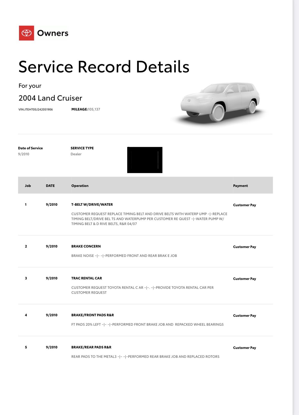

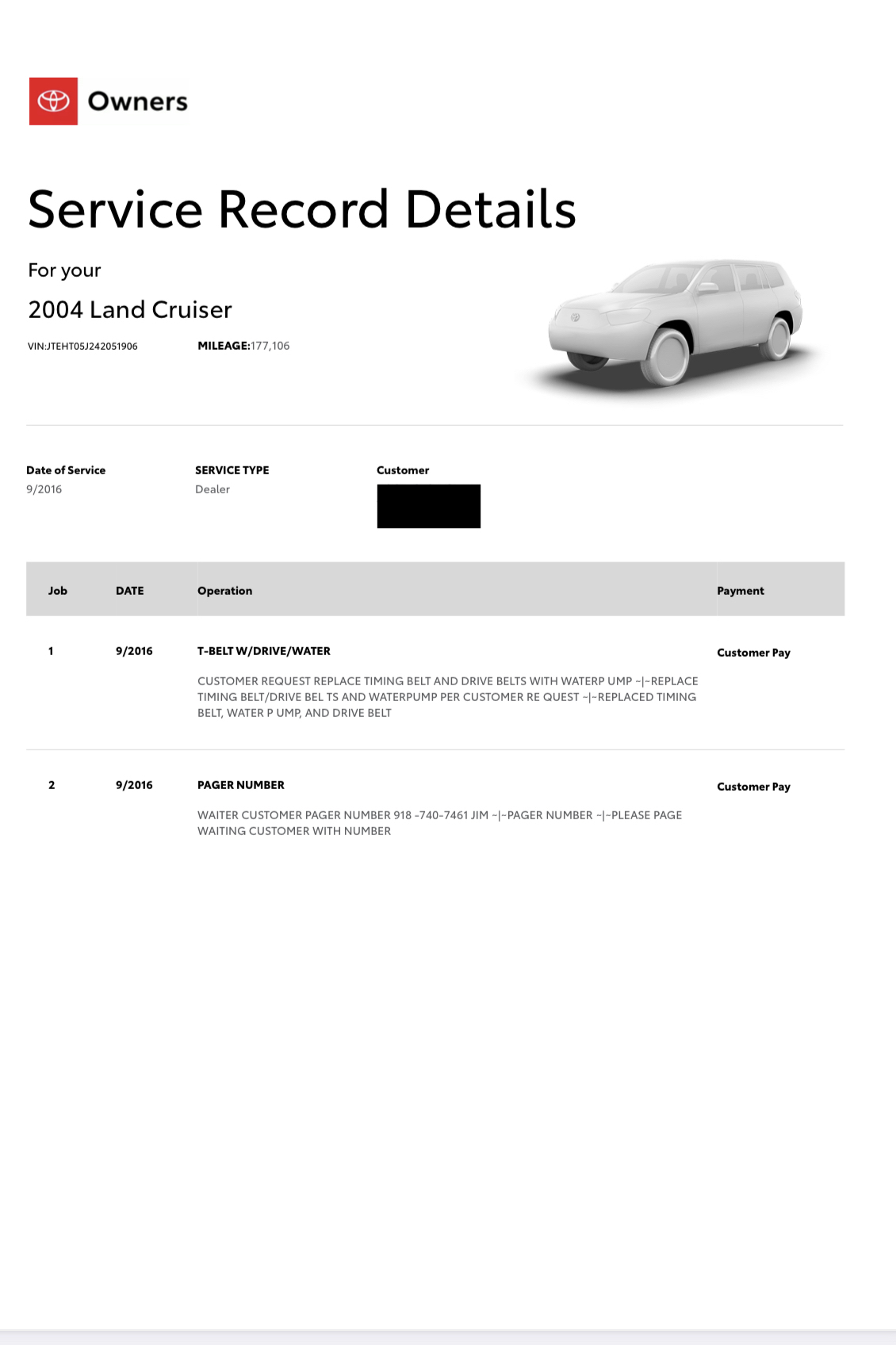

Pulled the Toyota maintenance records on this big booty Judy. Everything looks good from what I can piece together. Big ticket item like the timing belt & water pump were replaced at around 105K and then again at 177k. So we should be good to hook on that for a bit. I’ll try to keep a good rolling log, starting with the Toyota reported stuff, and see what lines up with carfax in some type of reverse chronological order.

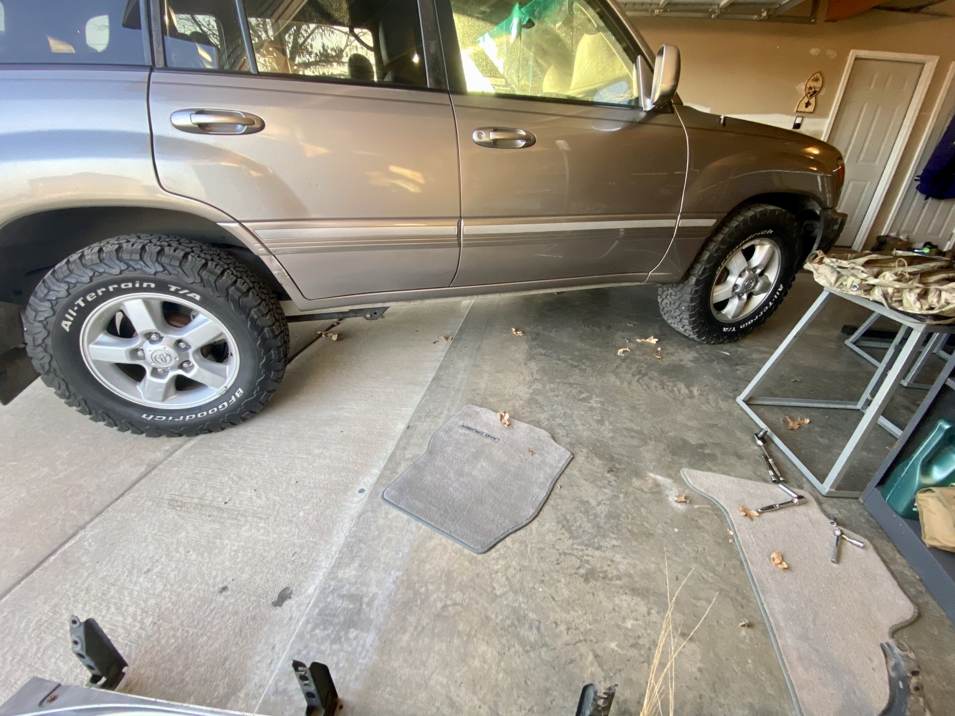

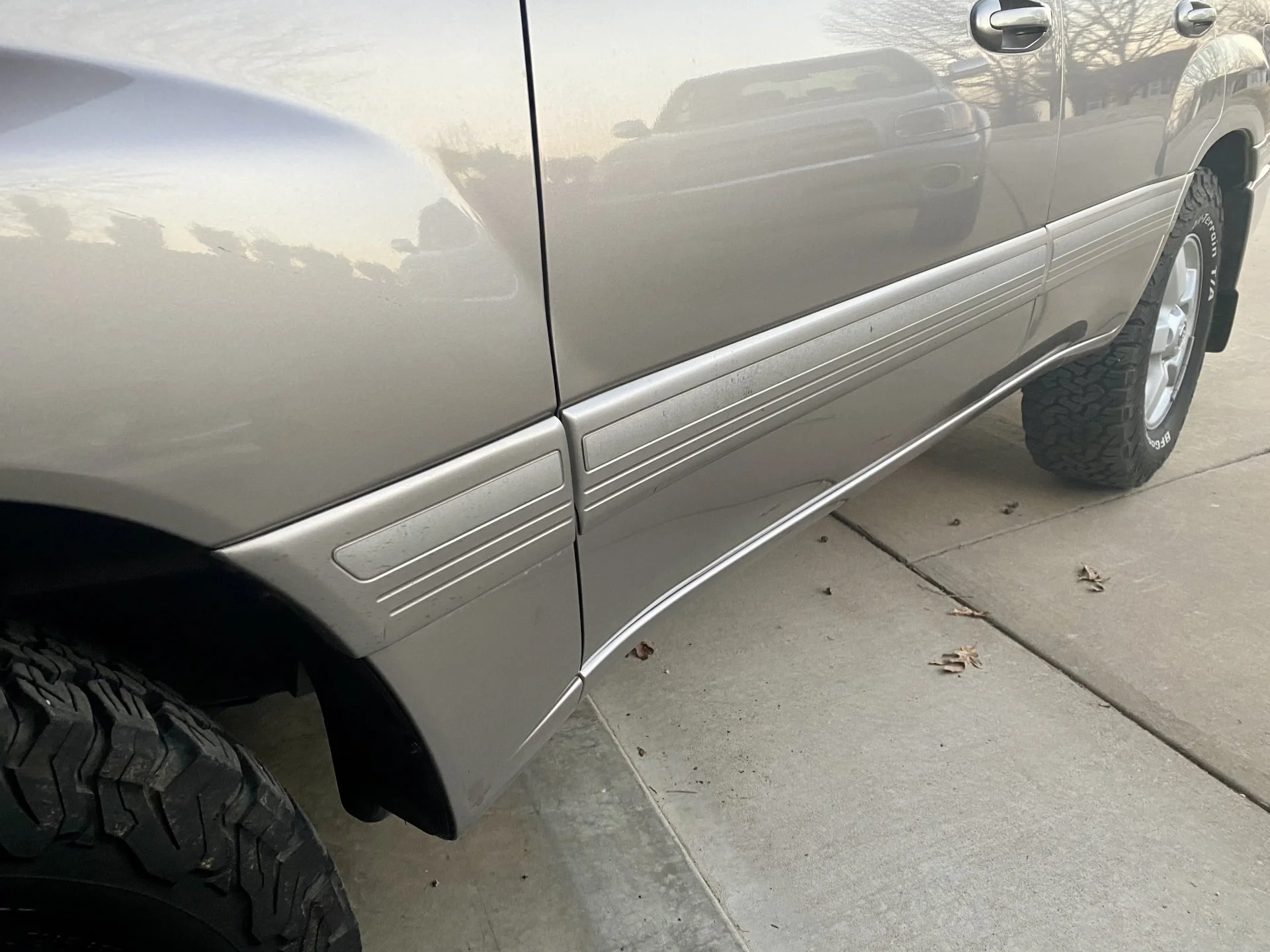

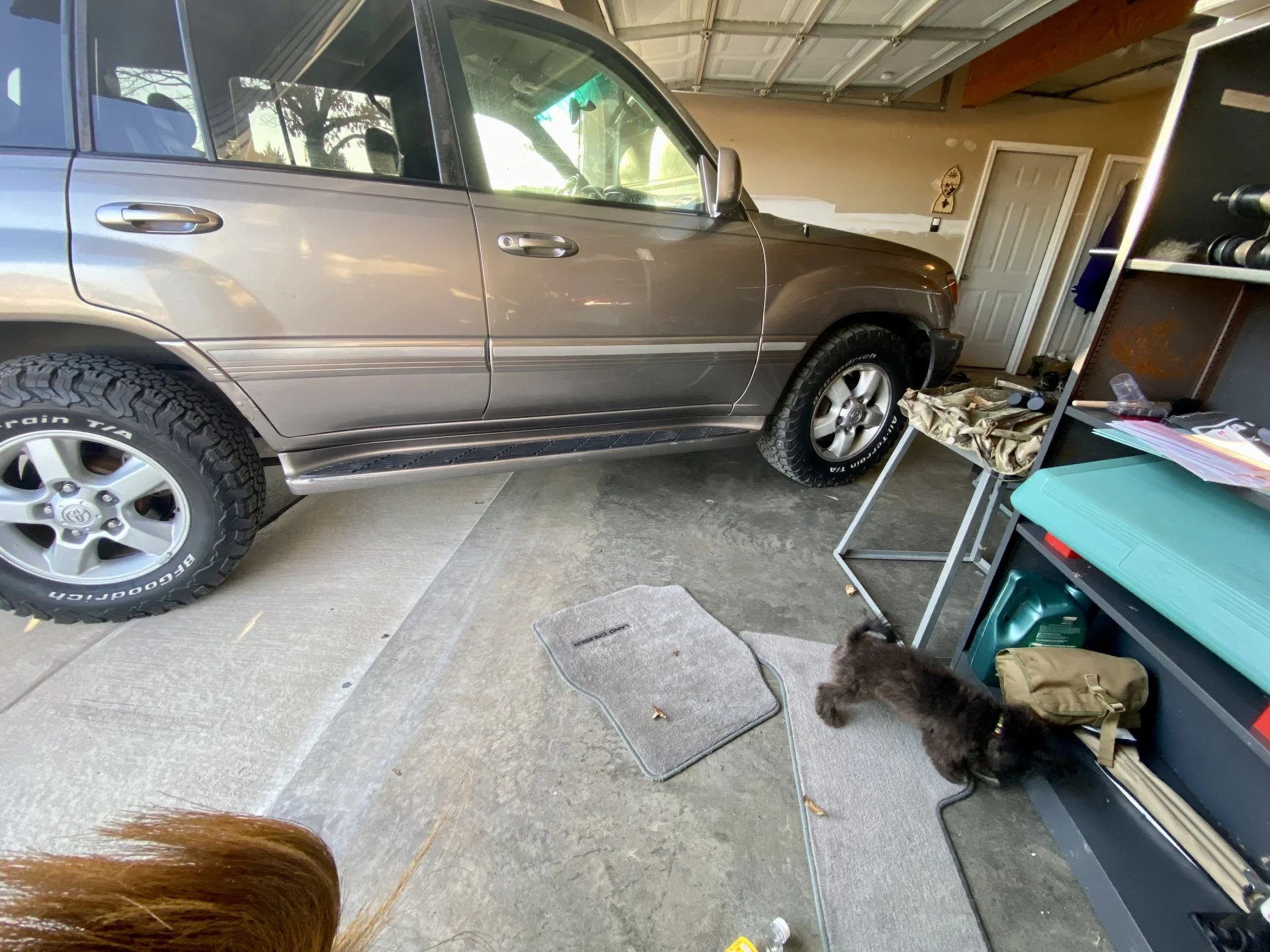

No big doings on the 1D2 girlly girl. Got off work early and knocked out the running board delete. Passenger side lines in the way, made me get up and look for 1/4” drive swivel stuff, but no biggie. Cleaned out the debris hiding behind the fender liner, who knows how long it’s been there. 100% on board with free modifications.
Before
After

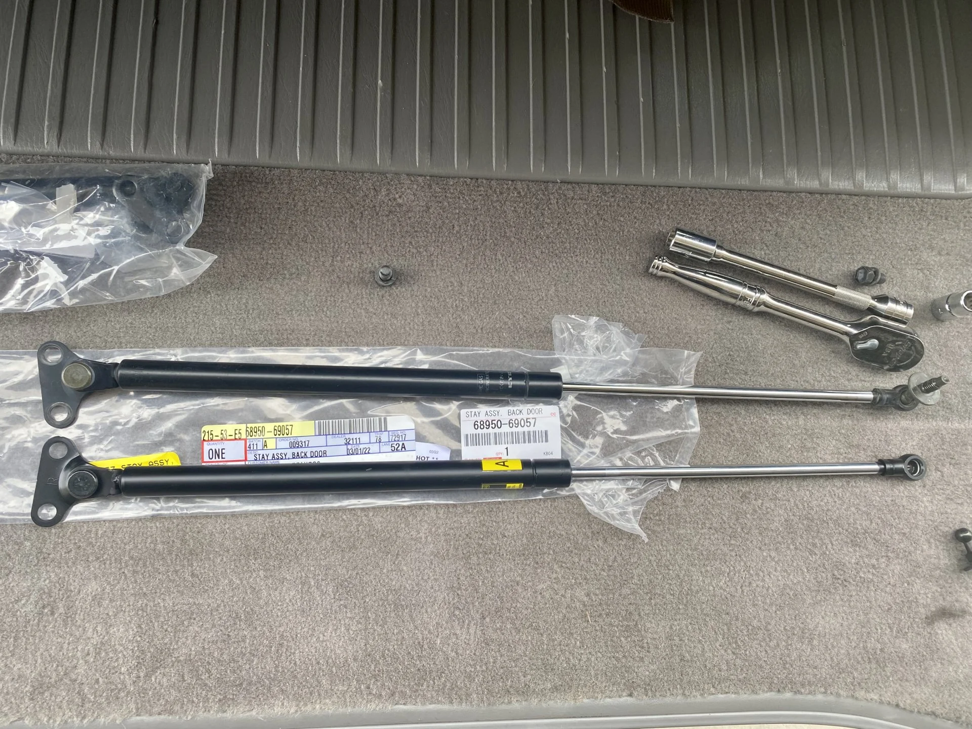

6Mar2022

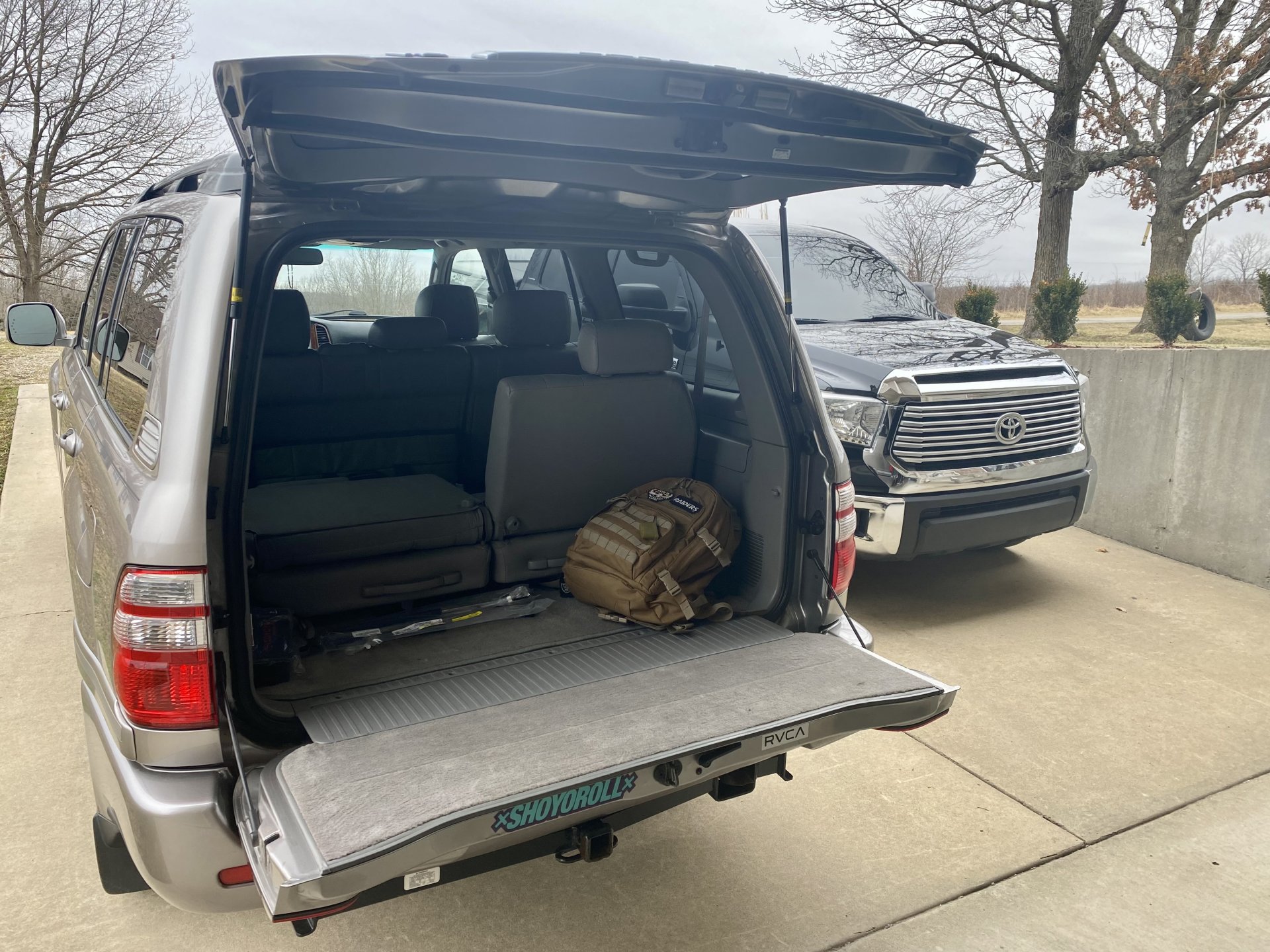

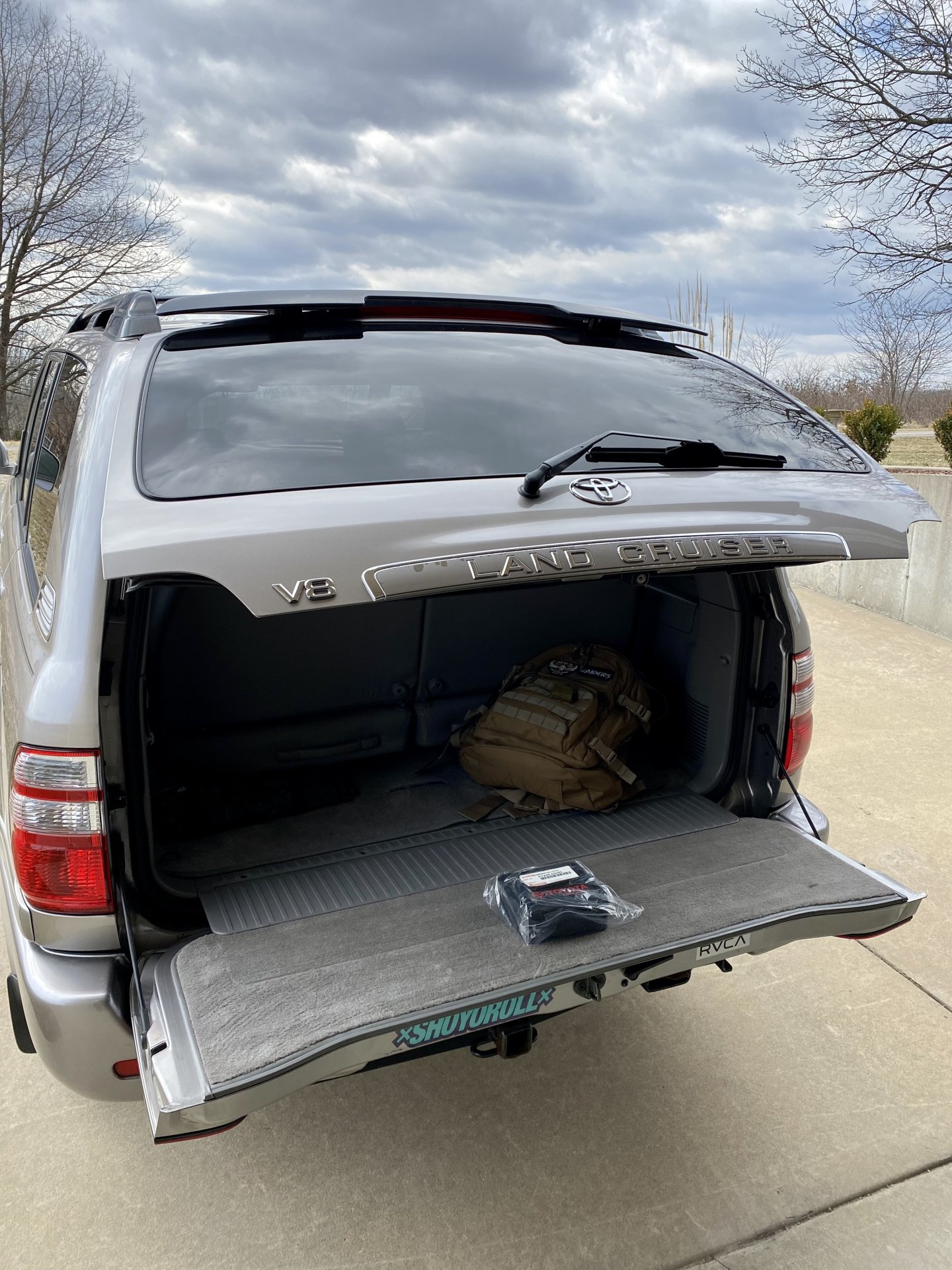

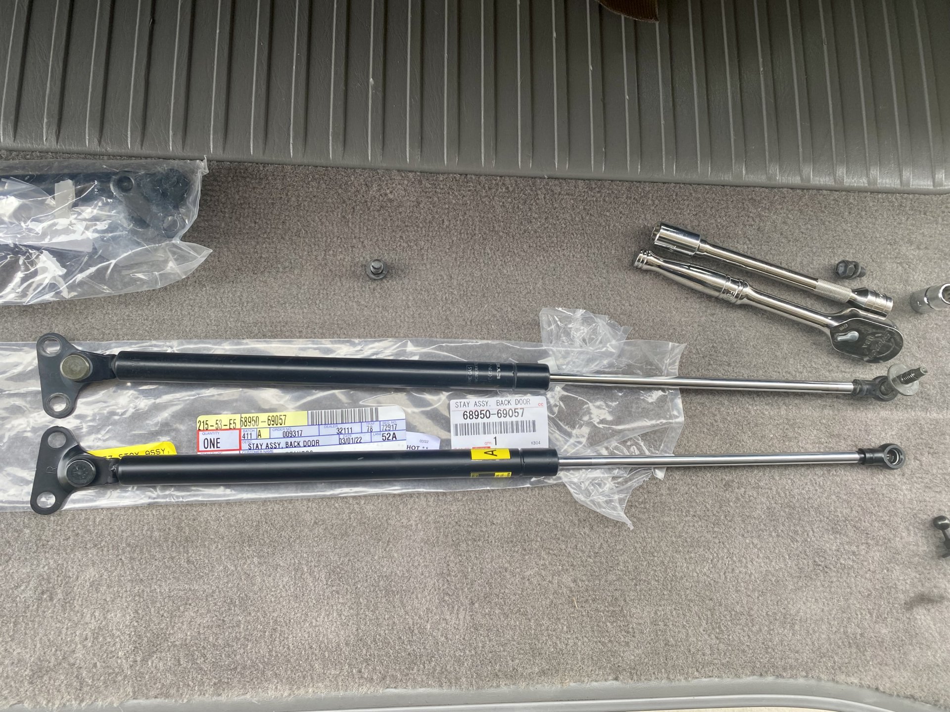

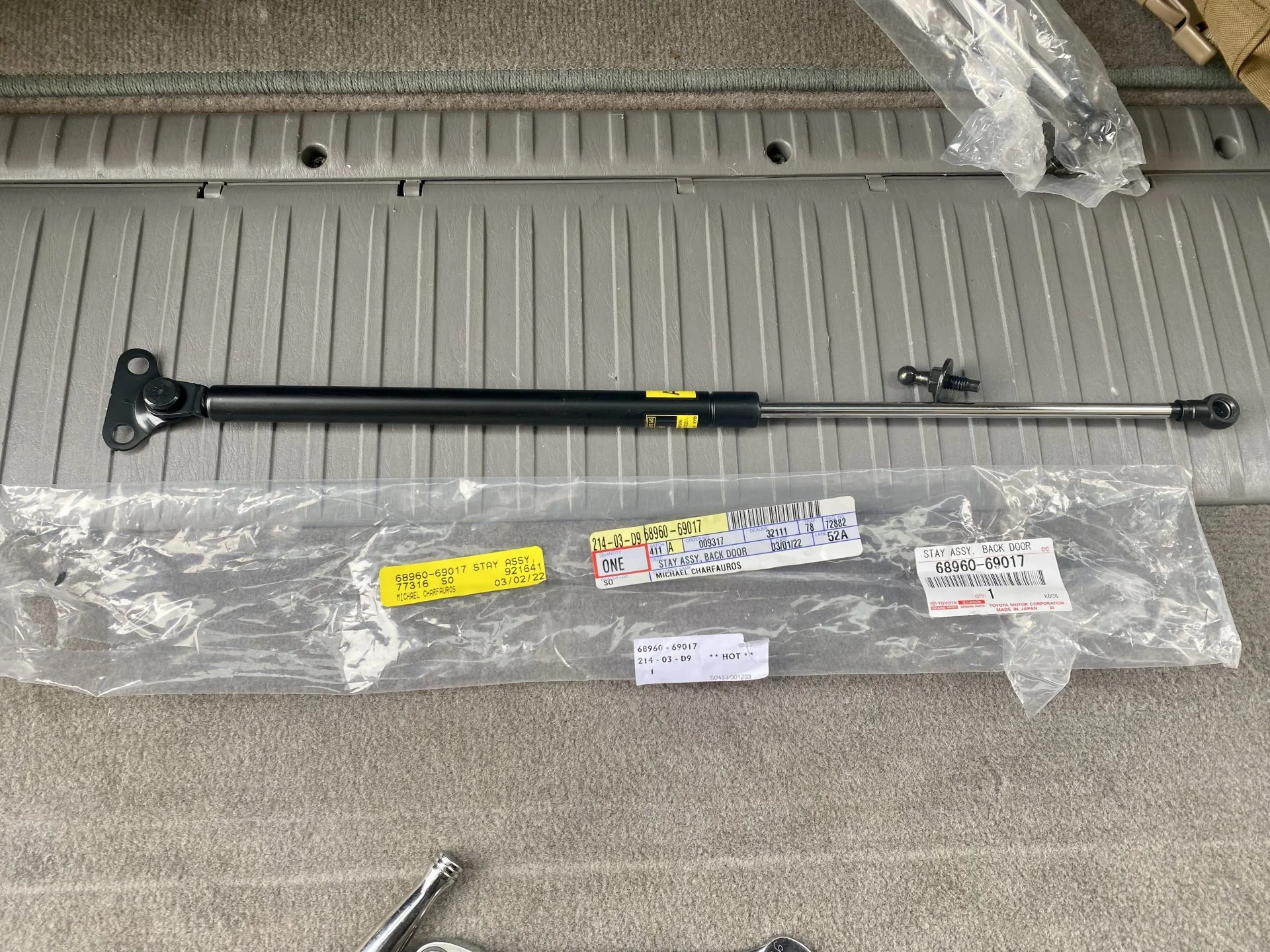

Rear hatch claimed me as its first victim, struts hold at the halfway point, then slowly give out, but not looking for round two TBI, so these struts are trash to me. Got a set on order, which came in yesterday, so swapped em out today. Went with the OEM KYB stuff, I figure if they lasted even just 10 years on a 18 year old truck, I’m good with that. All good to hook now on the rear hatch.
68950-69057 STAY ASSY, BACK DOOR (Right)
68960-69017 STAY ASSY, BACK DOOR (Left)

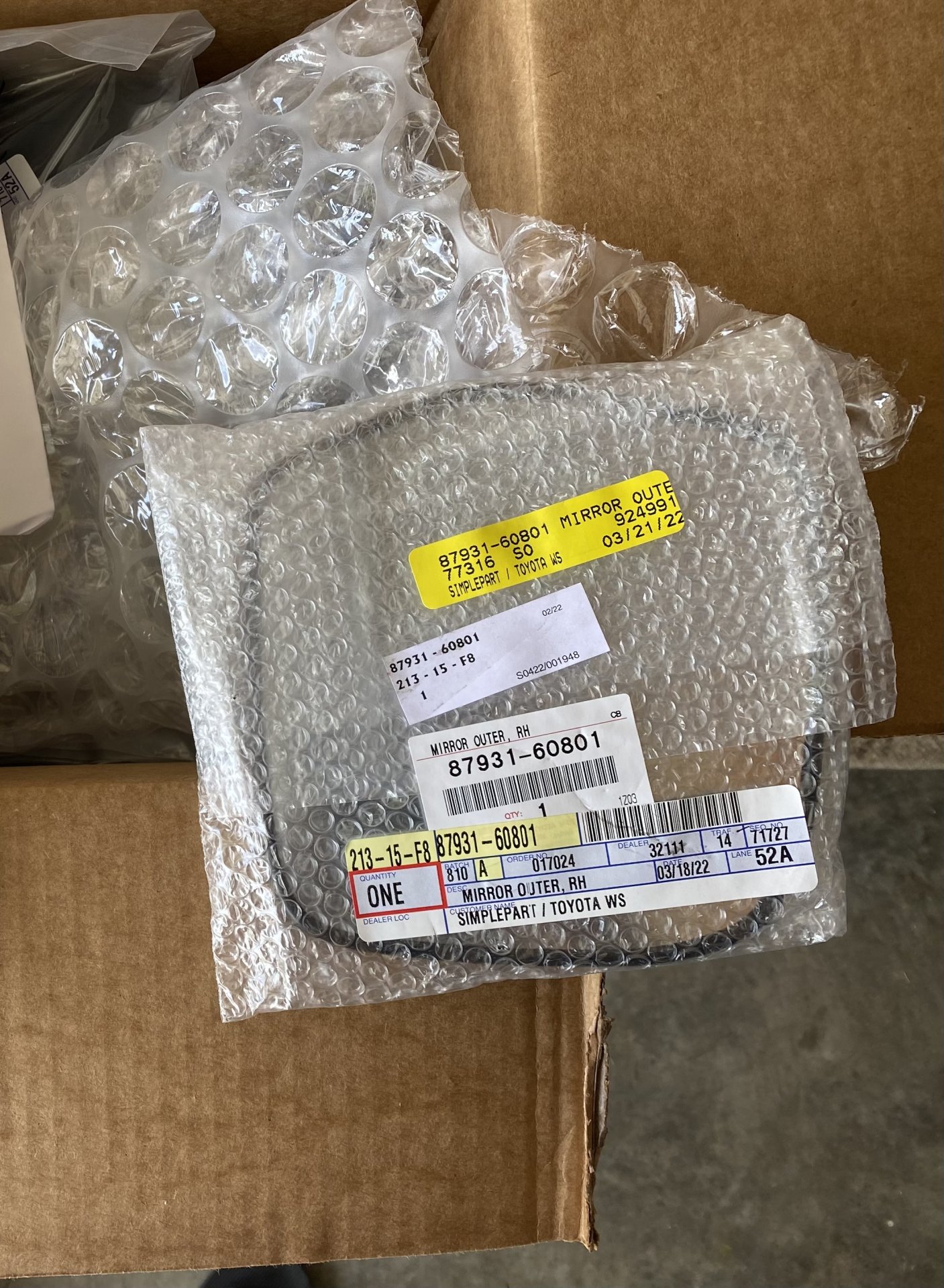

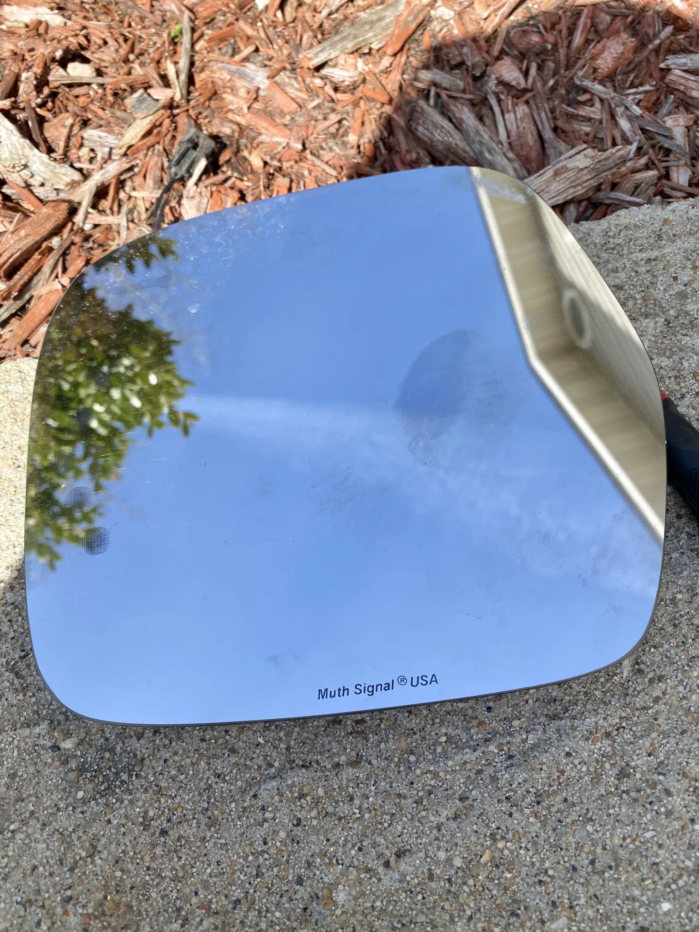

26Mar2022

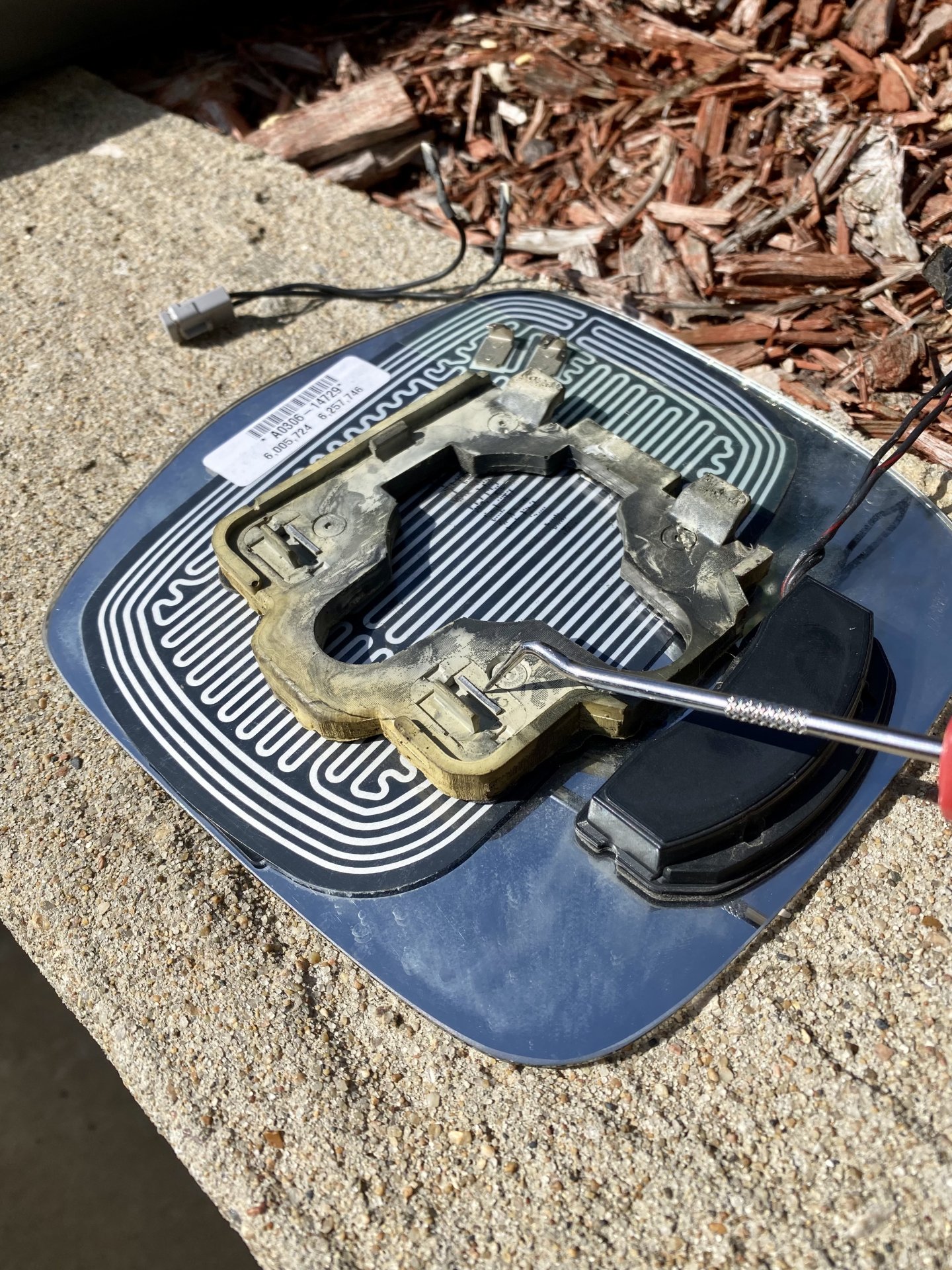

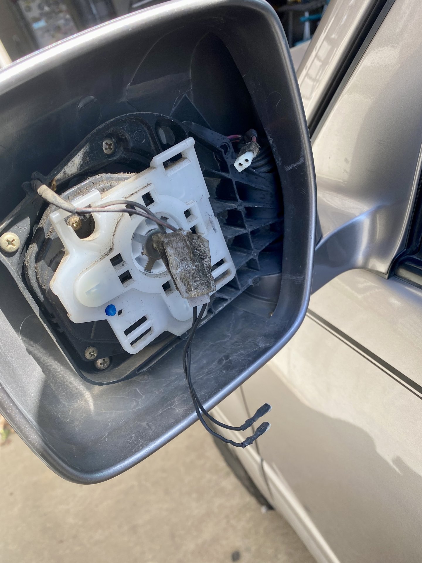

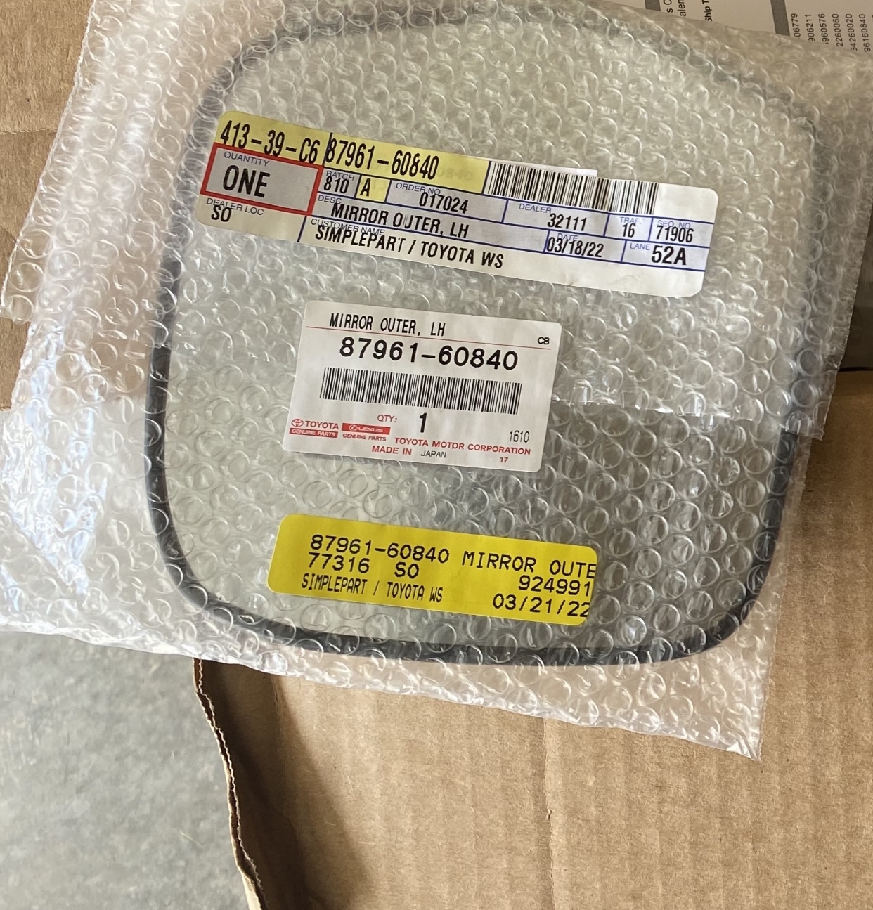

No big doings. Ordered a set of mirrors last week, they just showed up today, so got em changed out. Bought my 04 last month which came with some aftermarket Muth signal mirrors. The driver's side was janky already, turns out the lower clips are broken, and the lights are done. Not wanting to replace them with the $110 price tag on em, ended getting that pair via Modern Toyota’s March deal of 25% off Genuine Parts and free shipping.
Busted Lower Clips
Deleted the LED signal tap.
OEM stuff, definitely better built.

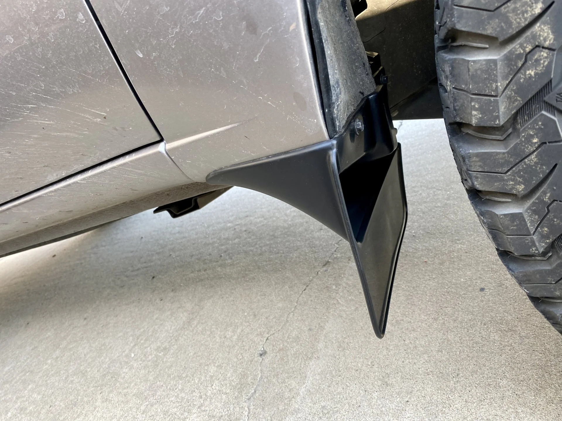

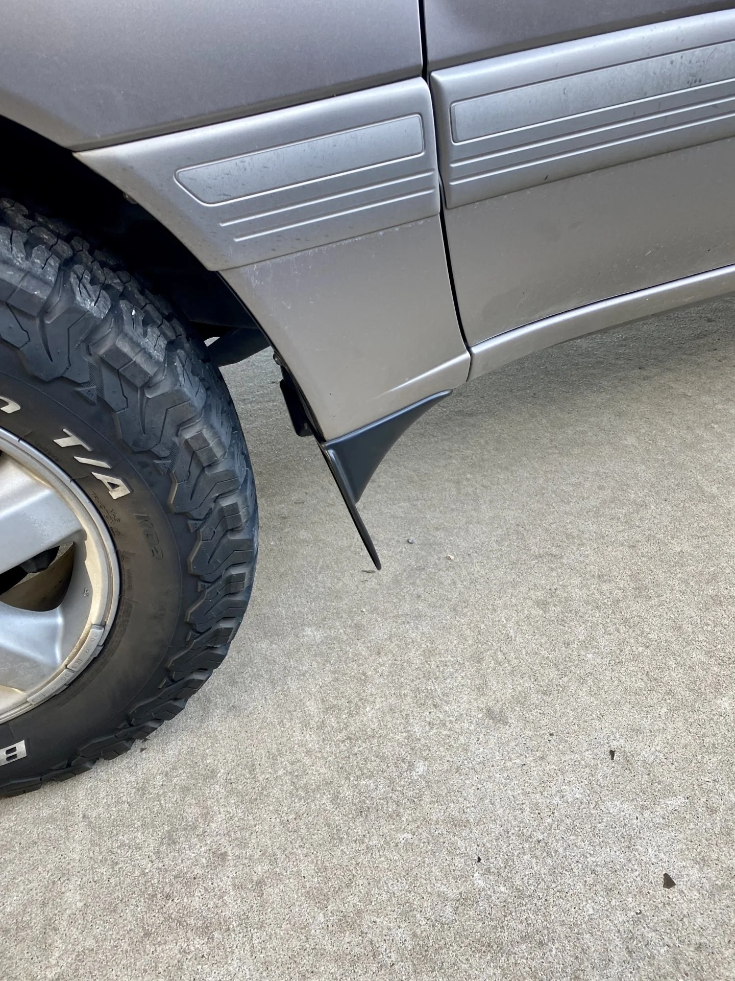

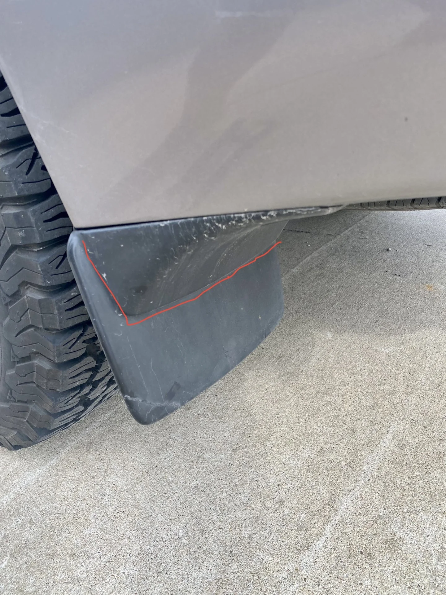

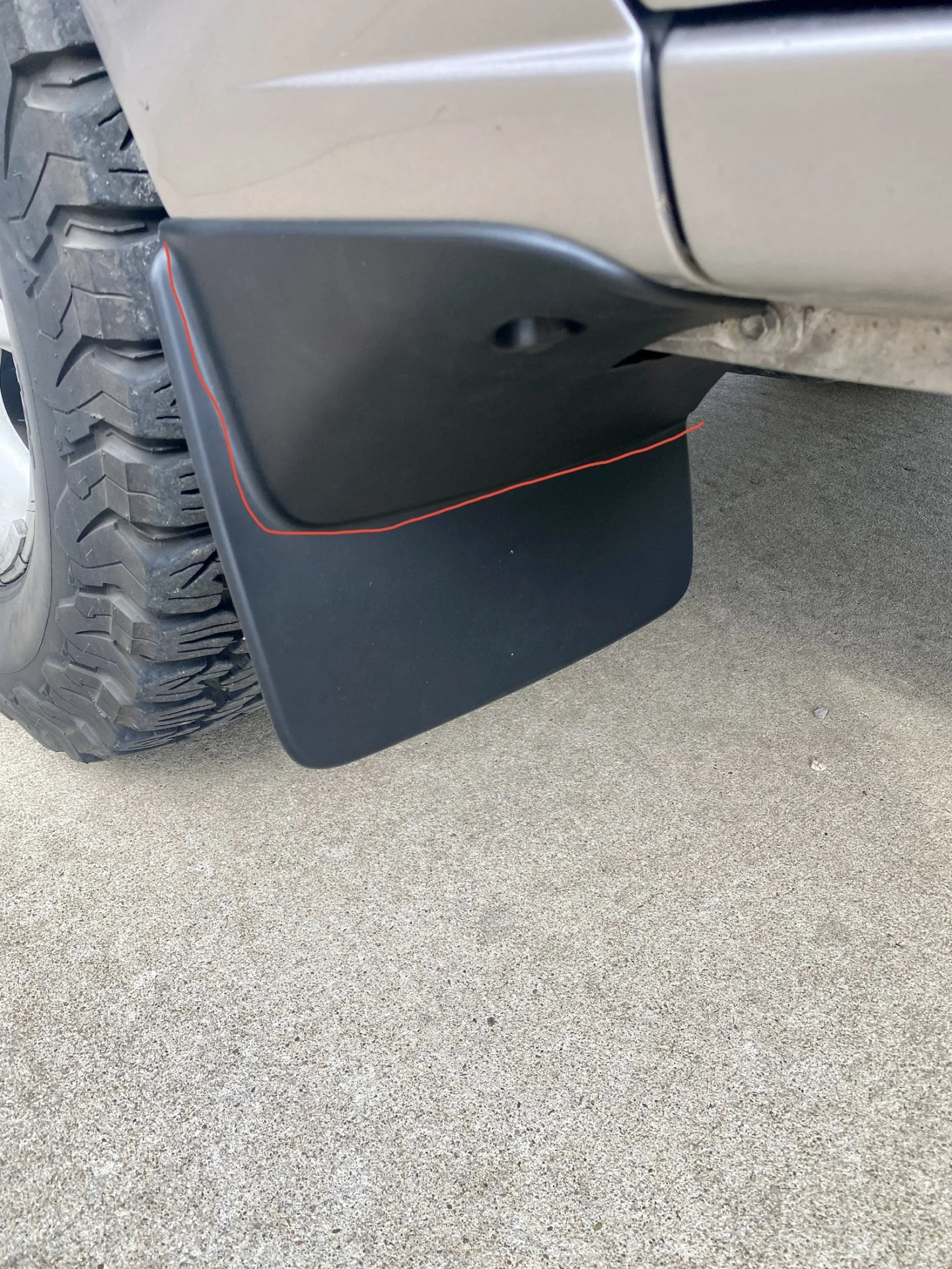

28Mar22
Pulled the running boards a few weeks ago, which left the front fender liners kinda flapping in the wind. Ordered up the front mud guards along with the associated brackets and hardware. OEM stuff of course.
7662260060 Mudflap Left
7662160070 Mudflap Right
7664260020 Mudflap Bracket Left
7664160020 Mudflap Bracket Right
9011906779 Bolt, W/Washer (6)
9015960576 Rocker Panel Molding Screw (2)
9018906211 Ground Effects Kit Grommet Screw (2)
Just after deleting the running boards
Driver’s Side all in
Passenger side all in

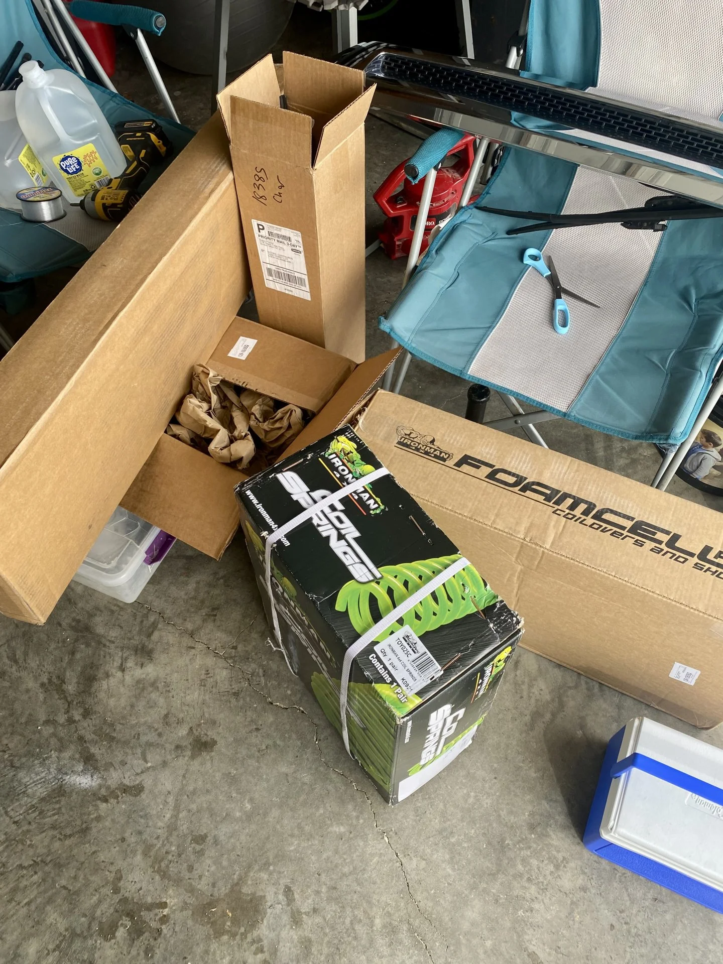

29Mar22
Car parts came in from Sherwood, Oregon. Looks like the torsion bars didn’t make the trip, but will be here on Friday. Nothing crazy or fancy, just looking for a solid upgrade over the OEM suspension. At this price point, I think it’s a decent solution. Came at a discount for @Ironman 4x4 USA 's March promotion 25% off and free shipping, so I’ll take that small win. Hope everyone is having a great week.
Ironman 4x4’s Nitro Gas 2” stage 2 kit, which came with the diff drop bracket.

Thanks @Mike NXP Definitely stoked to call it mine. This truck was something I’ve always thought was out of my reach with regard to price and cost of ownership, but definitely an iconic vehicle I’ve always admired. Seen a bunch of variations overseas throughout multiple assignments, and quietly wanted for a while.
I was pleasantly surprised when I input the VIN into the Toyota Owner system. This 100 series was dealer maintained like clockwork, which was a huge bonus while in the decision making process. I too would assume the previous owner did make good money, as we know Toyota Dealer Maintenance isn’t the cheapest around.

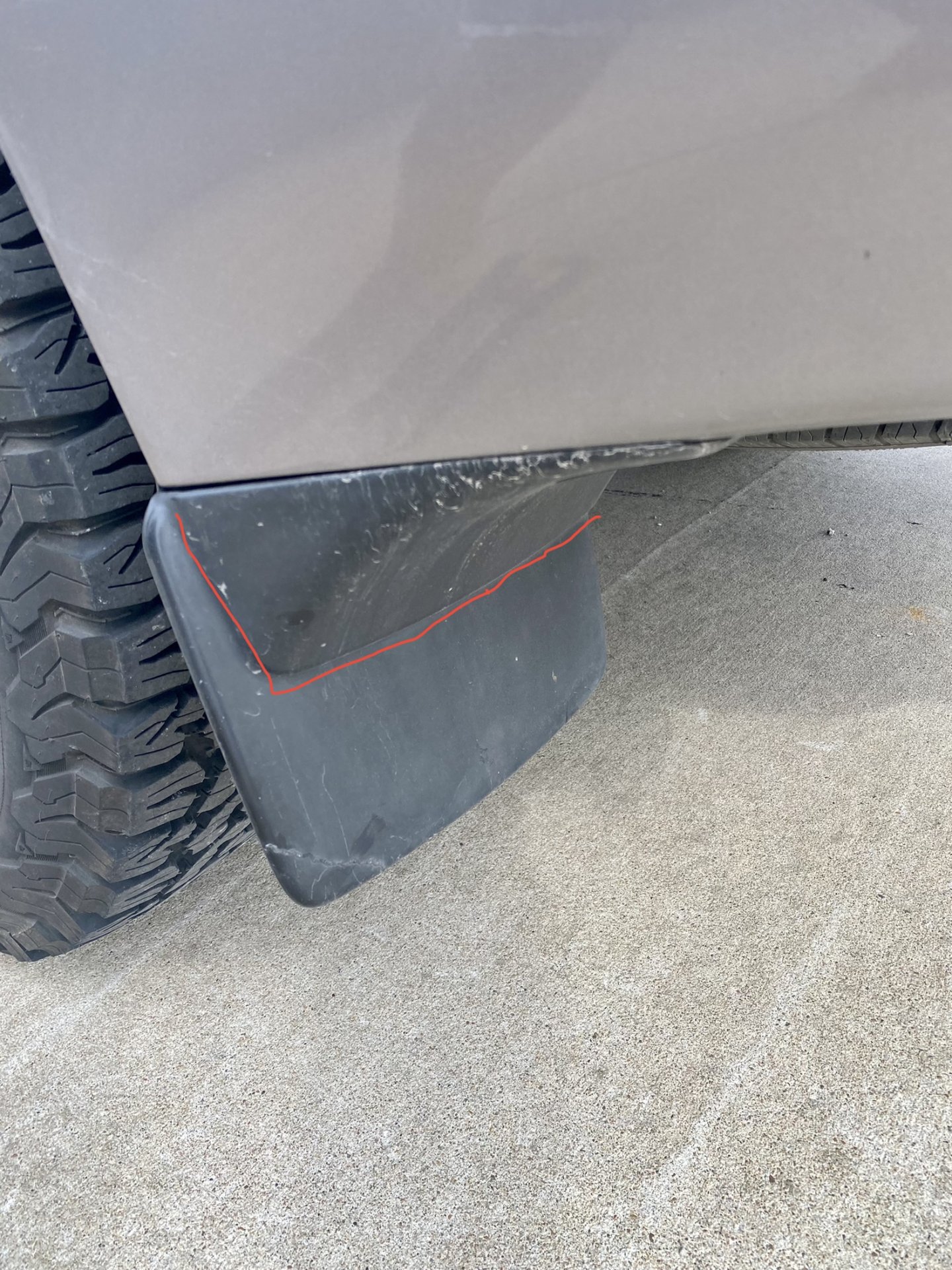

I was toying with the idea of taking the die grinder to the mud flaps while I had them off, but decided against it. Maybe something I’ll revisit later. The mud flaps do have their role, however they do visually give the truck a lower look, at least to me.

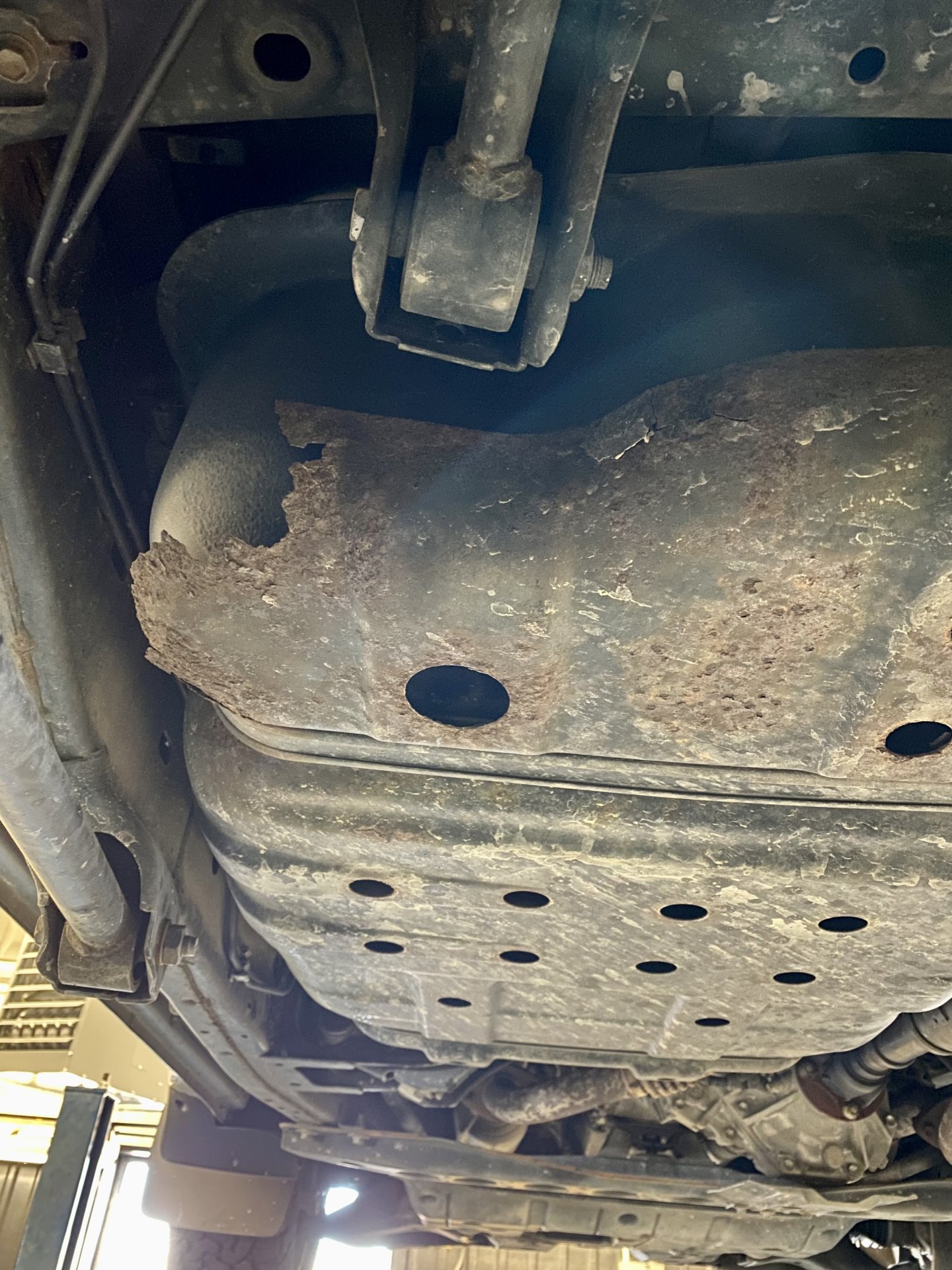

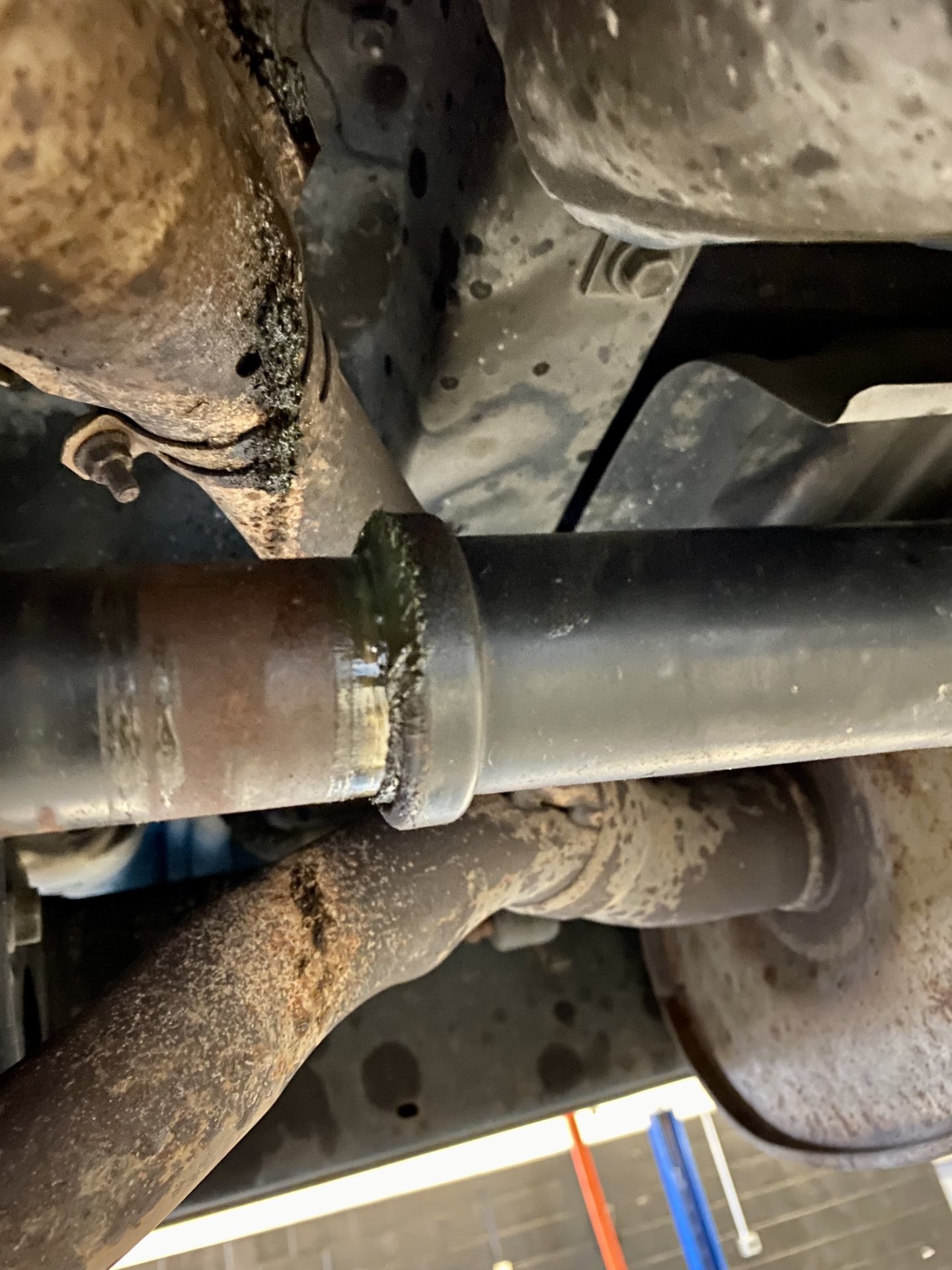

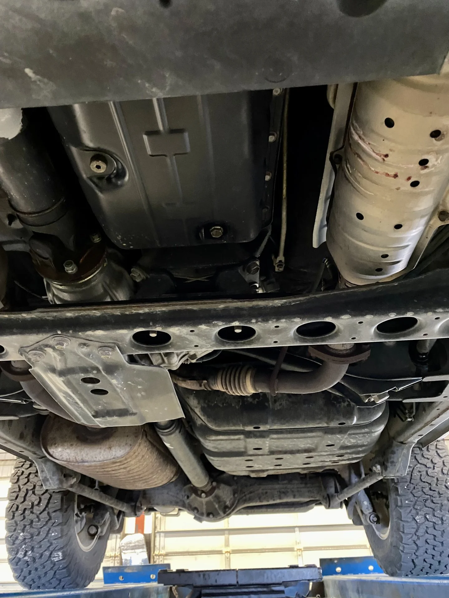

Not a whole lot going on. Got big booty Judy up in the air and knocked out greasing the U-joints and slip yokes. While I had her in the air noticed that imma probably need a skid for the fuel tank.
Greased up, took a 5 mile loop, and checked again.
Fuel tank skid not too bad, but might end up getting one sooner than later.
General inspection.
