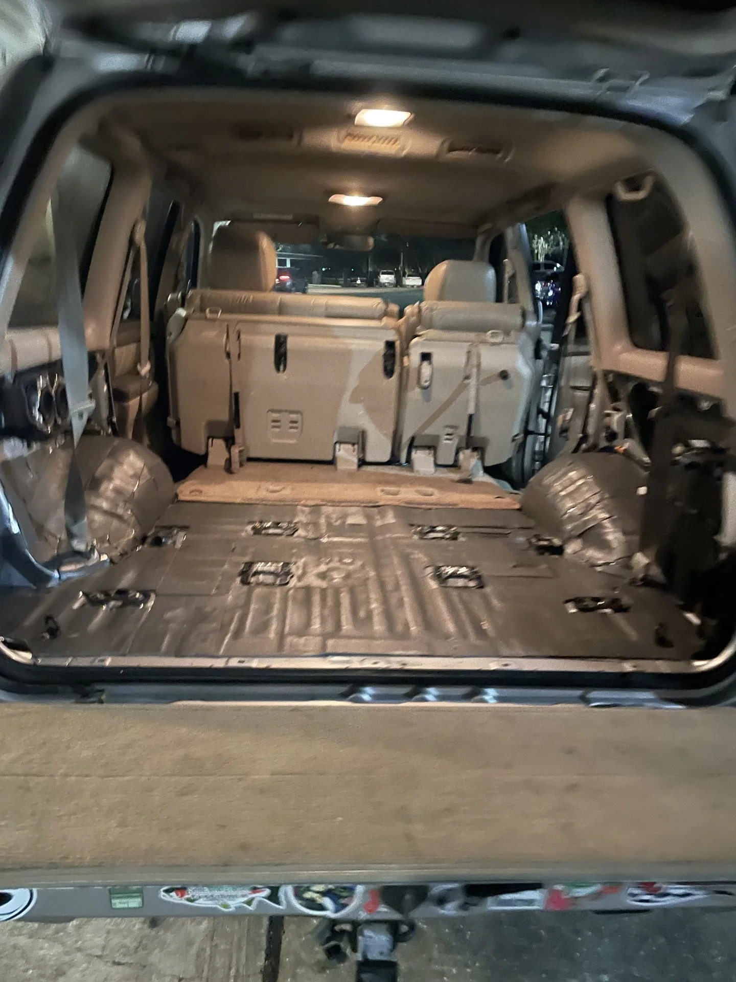

I finally decided to finish the sound deadening/stereo upgrade that I started a few months ago.
I had already replaced the radio with a Carplay unit years ago when I first bought it.
Fast forward to 6 months ago, I was given a bunch of sound deadening materials in exchange for my helping him swap CV's on his 4th gen runner. I also ended up ordering a set of JBL components, which I slapped in and called it done.
This weekend, I decided that I was going to do it all. I had grown sick of the road noise and was not happy with the components I had put in.

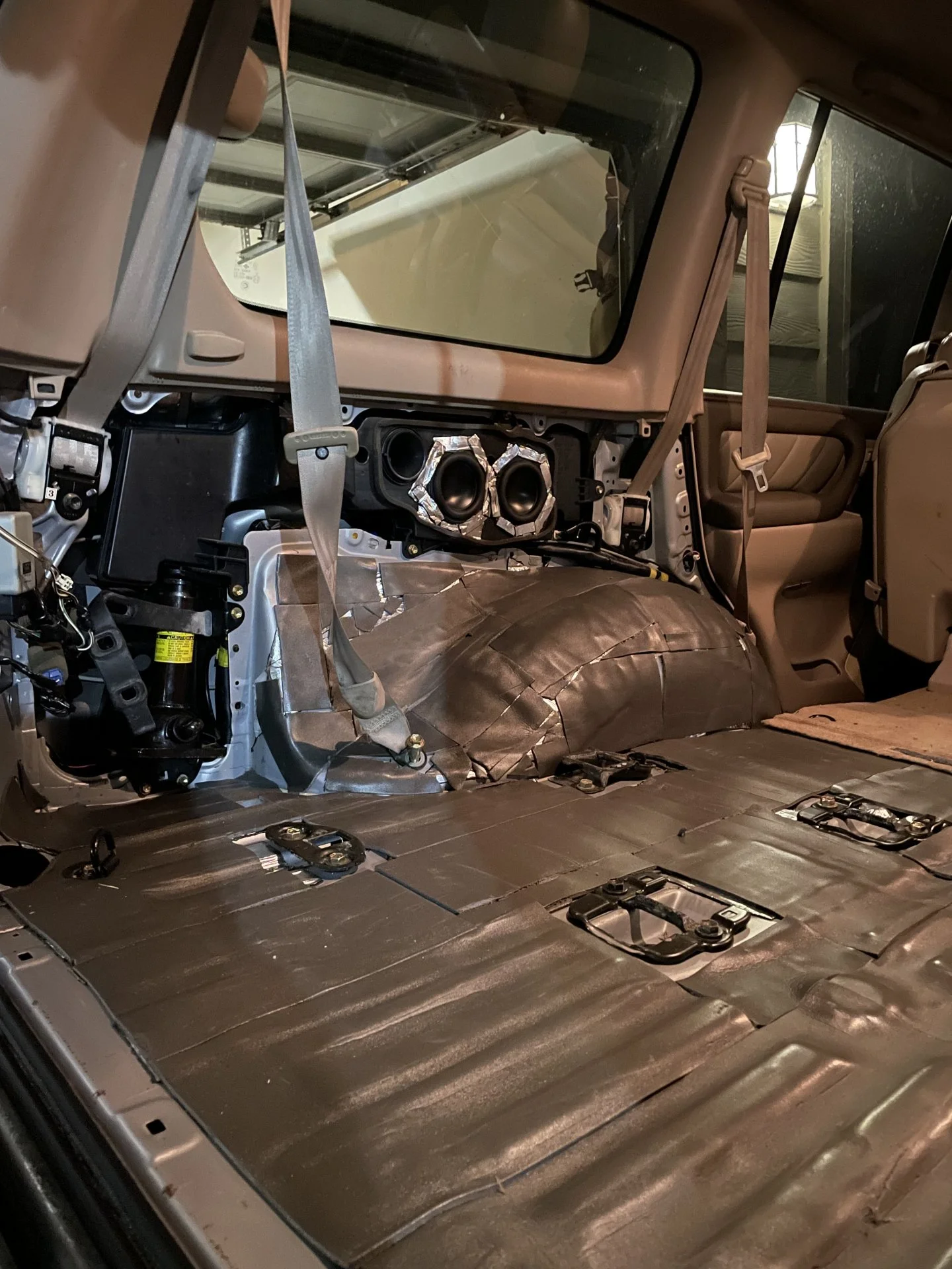

Started with the rear cargo area. Used butyl tiles, about (75% coverage) with 100% coverage of closed cell foam tiles over that. I also did the cargo areas, behind the subwoofer and around the rear AC. I also replaced the two stock 4" subwoofers with Dayton Audio drop in replacements, I'll get to that later.
(sorry for the s*** pics, some of them were take at night, absolutely none of them were made a priority)

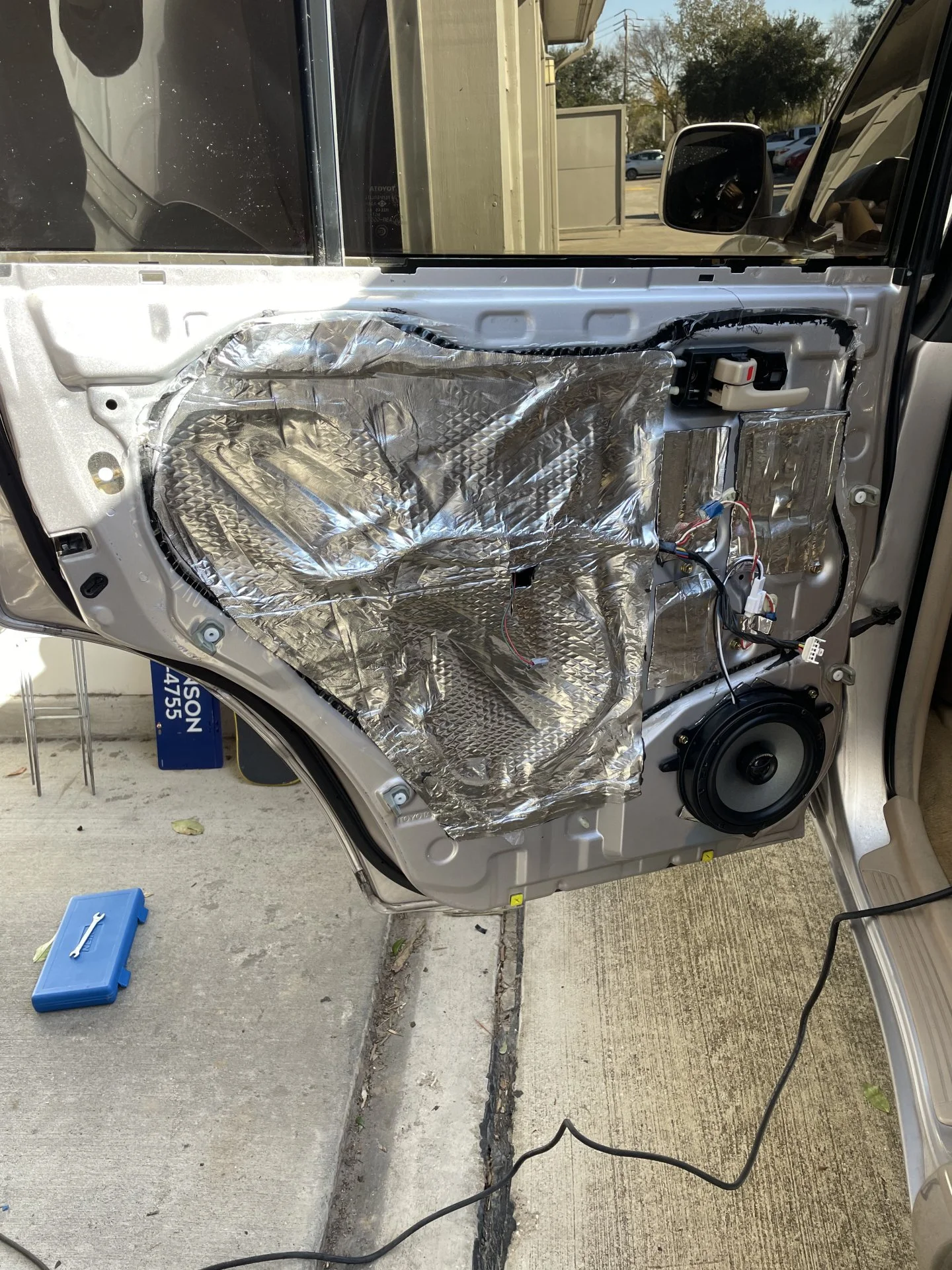

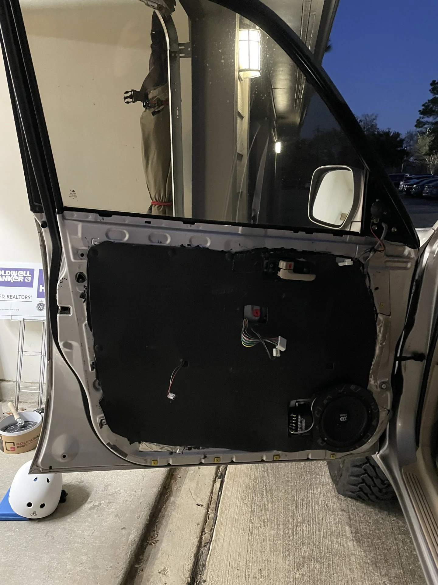

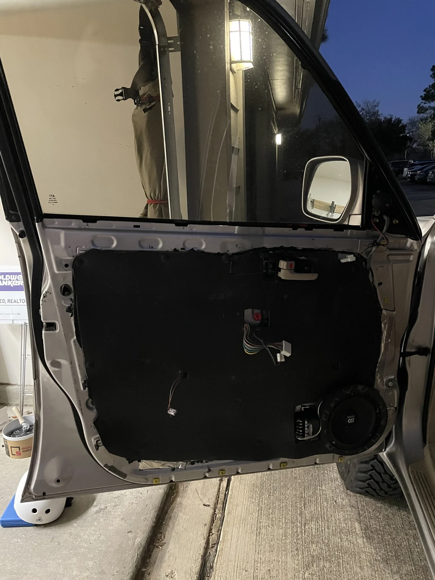

Next I moved on to the doors. I went with Morel Maximo 6.5" components in the front, Morel Maximo Ultra 6.5" coax in the back.
On the front doors, I did butyl tiles, again 75% coverage, with two large CCF tiles on each doorskin. I also used butyl tiles to "seal the inner door. Then did a layer of CCF, adhered to mass loaded vinyl in-between the door and its panel.
On the rear doors, I did the same, minus the liner between door and panel.

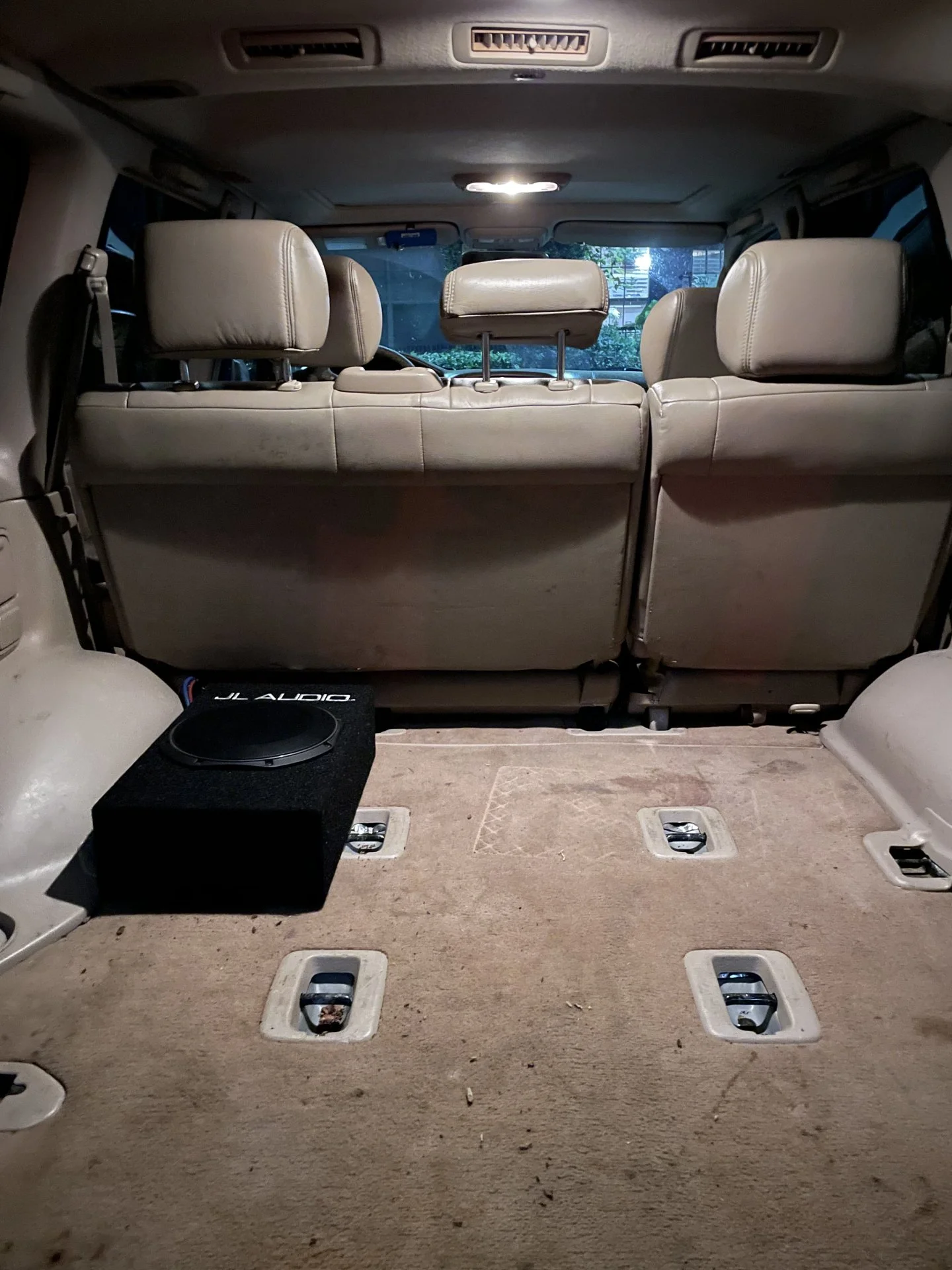

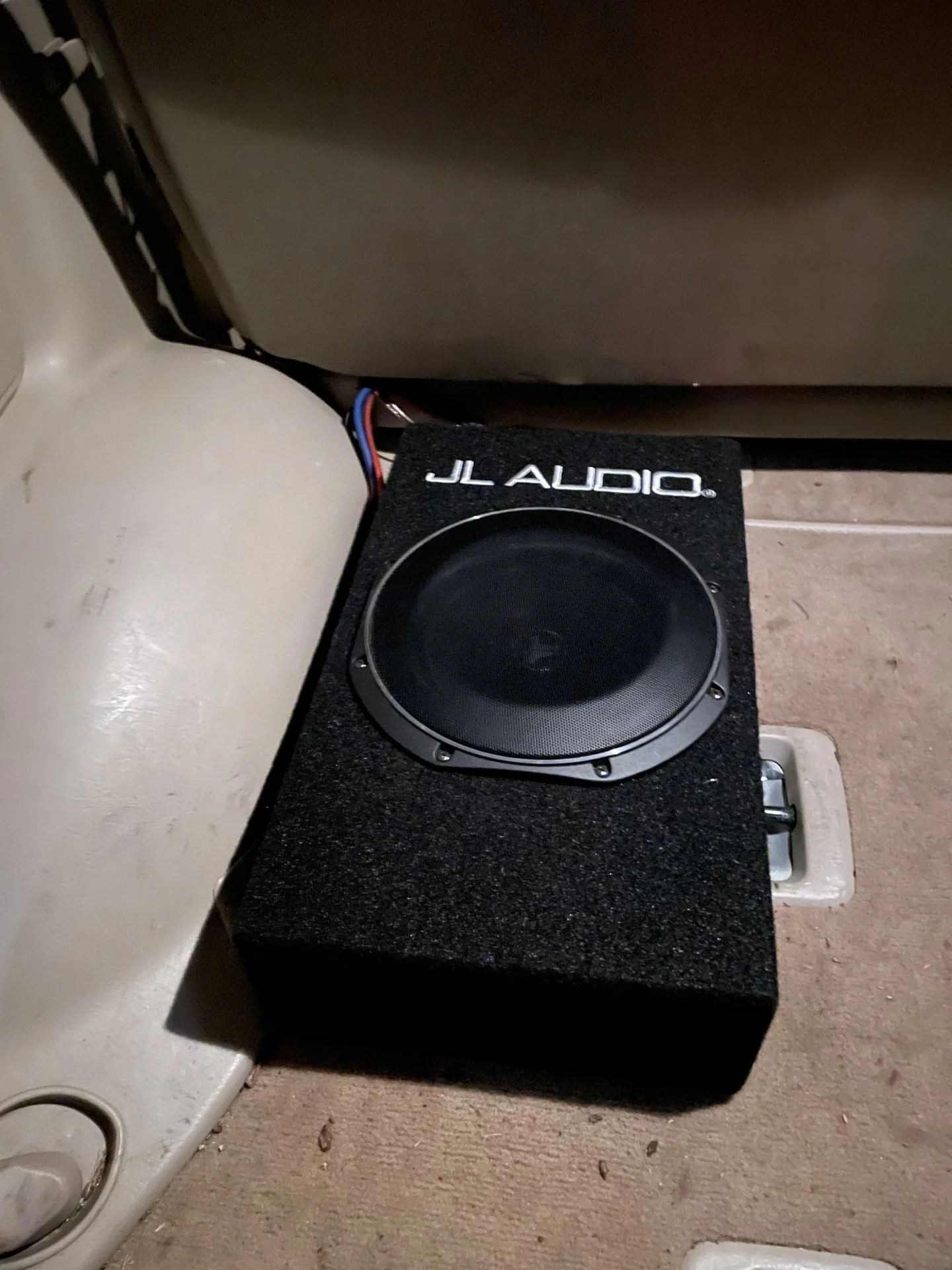

To test everything out, I gave it a good solid 45 minute drive through the city and spent a good amount of time on the highway. I was pretty happy with the sound deadening. My tires are loud, that will make a big difference when I finally replace them. The speakers sounded fantastic, however, I was disappointed in the bass. I hopped on FB marketplace, found this JL 10" enclosure with built in amp, picked it up and installed it. Made such a world of difference.

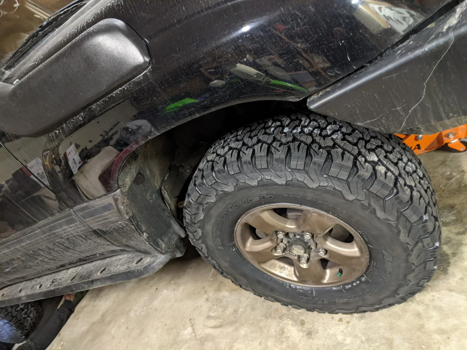

Well, I didn't get new tires today. Ordered 285 KO2's on a deal from Costco, went to the install appointment today and they refused install. Apparently they've had a long standing policy that they won't go over 3% either way from OEM size. 275 to 285 is just over 5% according to their calculator. This is despite the fact that the truck currently has 285 Revo's on it that they installed, as well as the KO2's (285's also) the set before that. Counter guy said it's ultimately tire manager discretion. Going to call around to the other 2 Costco's in town to see if they have different discretion, but bummed if they won't, Costco's road hazard warranty was excellent.
I have had always get Discount Tire to match Costco's price and include the road hazard warranty. DT has been excellent in their service and usually doesn't raise a stink abt slightly larger tires.
I know it's a pain, but I've heard of folks taking in only the tires, off the vehicle, to have mounted and balanced. What they don't know won't hurt them.

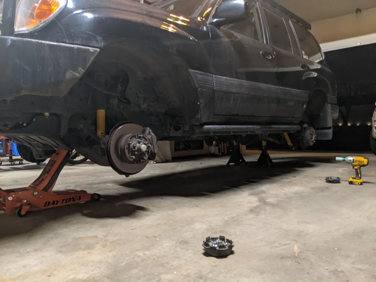

Changed passenger side CV axle, swapped out the sway bar end link. The CV took me forever- I just couldn't get it all lined up to come out clean to start with (that axle completely came apart when I started removing it, so it was... well past time), and was sort of figuring it out as I went. After being covered in grease so long and just tired of fooling with it, I knuckled under and took it to the shop for the other side, plus tie rod ends and an alignment, AND (turns out) my driveline vibration was a bad U-joint, maybe two. They called with the "can we do this too" and I said "yeah just make it right." Picking it up this afternoon- looking forward to having a correctly functioning truck again and mmmmaybe getting back to the fun parts- driving it, slowly adding fun stuff.

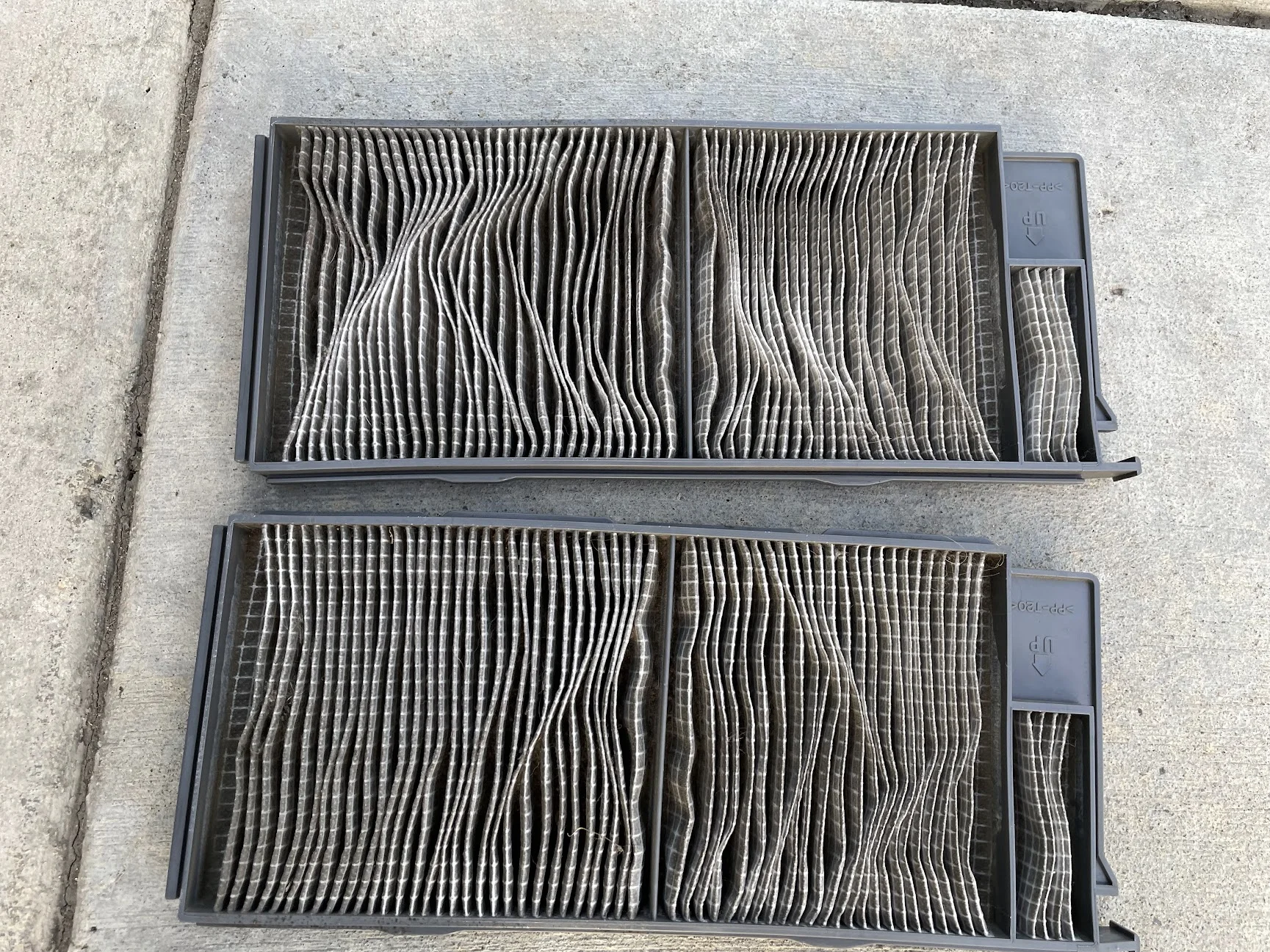

Got around to changing out my cabin air filters today, noticed that the last person touching this area did NOT put a screw back into the black trim that holds the airbag connector, that's mildly annoying. Then noticed why my glovebox was not aligned as well as it should (left side sagged a bit). The person that lost the screw just tapped a new hole SMH, I realigned it and the gap is a lot better up top now.
Not as dirty as I had expected but compared to the brand new WHITE filters this thing looks nasty.

Oh, and end results of Costo. They begrudgingly mounted them off truck, when I went to pick them up the manager conceded defeat, told me to bring the truck by so they could verify torque and no rubbing and they'd honor the full warranty.
