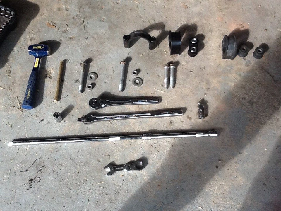

Picture attached is all the tools I needed
1/2 breaker bar and 6 pt 19mm socket
1/2 ratchet once the one big bushing bolt was loose
30" of extension with 1/2 universal joint and 19mm 6 pt for the hard to reach big bushing bolt from top of engine bay and used 1/2 breaker bar and took out just by spinning the breaker bar
Mini sledge and brass drift to get smaller bushings out
Gear wrench mini 19mm ratcheting wrench for holding top nuts on little bushing bolts
When putting in new small bushings going to use the technique mentioned elsewhere to use the nut on the bolt to squeeze top bushings into socket. Not sure yet if I even need to jack up oil pan we'll see.

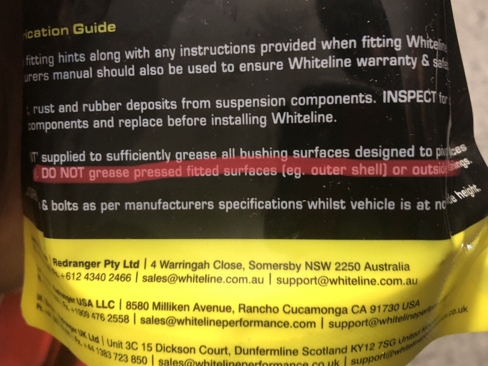

From the directions on the Whiteline bushings it says not to grease outer shell.
Saw a video on YouTube where they installed Whiteline bushings on a Subaru and they only greased the outer shell. Not the inner part where the metal piece goes.

Just so I am clear: Grease goes between metal and inner part of bushing. Is this correct?
I would grease not only the inner sleeve parts (inside and out of the metal sleeve) but also the rubber/poly outsides also...for two reasons ease of install and that's how I was taught...
Do you remember what you greased on the big and smaller bushings?
Thanks.
Sorry for late reply here. I am pretty sure I greased everything to make it easier to install. Just like what @zulufoxtrot said:
I generally tried to avoid greasing the outside because the instructions say not to, but it probably would have made it a bit easier.

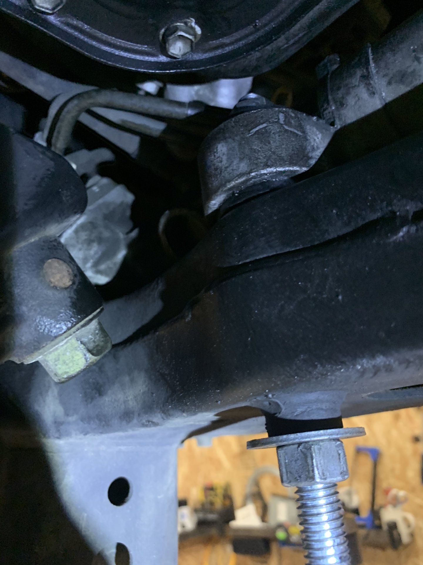

Thank you, @hoser for the post on how to do this. It took me two days (got a late start both days), but I was finally able to get the big bushing and the front bushing replaced. The back bushing looked OK and it did not want to press out easily so I left it as is. I do have two recommendations for those who are going to attempt this: 1) Disconnect the transmission send and return lines and secure them with hose pinchers somewhere up out of the way when you get started. Really helped with the two bolts on the big PS bushing. 2)Cut a wooden wedge out of a 2x4 and use this to lift up the rack once you have the big bushing and front DS bolt out. This allowed me to get purchase on the rubber bushing to push it out. Mine was so gone it easily pushed out by hand. My rack is leaking on the DS so I will need to watch the fluid level. I will be swapping some of the PS fluid out with AT-205 to see if this will staunch the leak. Can't afford a replacement at this point in time with all of the other expenses on this vehicle. Wish this thing was 100K less in mileage. Might have been able to do some PM and saved these issues. 4th of July weekend = AHC globe replacement! Thank you all for the great information on the forum. It has really been handy.
I just did this tonight—thanks a ton to all who’ve posted here before; made it pretty dang easy. I was able to use a pry bar to push both DS bushings out, with a little help from a brass hammer on the rear one. For installation I found starting with the bottom bushing made it easier, followed by the top bushing and the steel sleeve at the same time. I used a piece of threaded rod from Home Depot and two nuts and two washers, for a grand total of $3.00, for my “bushing pushing.” On the rear one, I had just enough room to sneak the top washer and nut on, and did not have to jack up the engine. I also used a 19mm crows foot (as mentioned before) on the top nut, since there’s not much access. Overall it was about a two hour job from start to finish. I’ll post a pic of my pusher.

As for the process. Realistic 2.5 hour job. 3 hours if you have meaty paws. I wear a large glove and found it to be REALLY tight getting the rear DS bushing situated and the nut/washer set up. Not impossible and only required a liberal dose of profanity to persuade the bits to cooperate. I would suggest that the all-thread be of the same diameter as the stock bolt. I think this will help keep things aligned. not imperative but helpful. I don't see a need to lift the engine up. I used a large flat head screwdriver, 1/2 drive socket wrench, 3/8 drive socket wrench, box end/open end 19mm wrench. I had the vehicle up on ramps. The kit I used is from amazon and costs ~$25.
