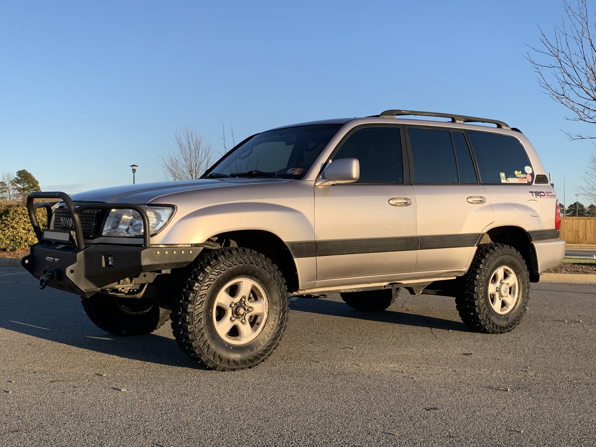

Threw on some new Yokohama Geolandar M/T G003 in 285/75/16. I was coming from the A/T G013’s which were excellent tires and I actually ran through 3 sets, I just really wanted a M/T and 33’s (or 32.8” if you want to be technical). Plus Discount Tire price matched them at $220/ea which was awesome. Love them so far!
They look great. That's a smoking good deal.

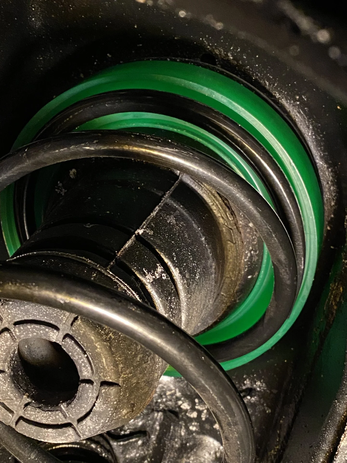

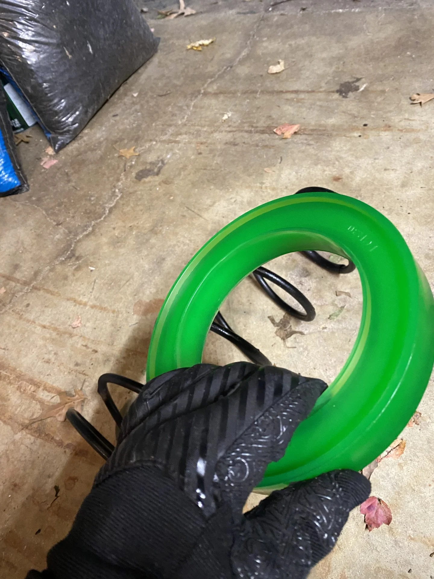

New Toyota AHC Coils
Ironman 30mm spacers
Replaced broken FL AHC height sensor linkage.
Adjusted torsion bars
Pressures in check. Feels good.
Rear shocks still need to be replaced though ☠️

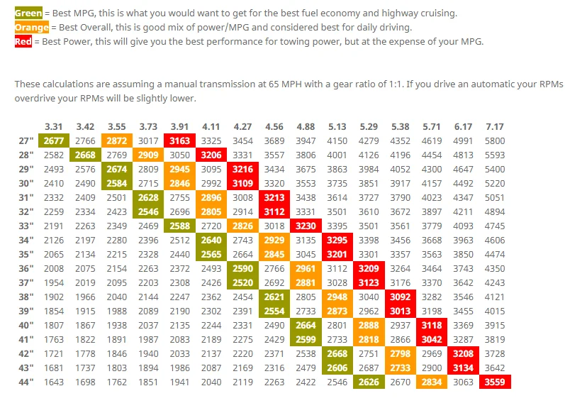

I found this gear ratio calculator to be interesting.
It's helping me come to terms with whether I should go with 40" tires that I need for off-roading versus keeping my 33" and driving on more reasonable trails.
Adding only 1" inch of ground clearance by going with 35" tires does little for my clearance problem.
Another "devil in the details" factor that I need to consider is with changing "rotating mass" where a lighter wheel and tire take less energy to accelerate (+/-), whereas the heavier wheel takes more energy. A large portion of my driving is on hills and curves. So I am constantly accelerating and braking.
