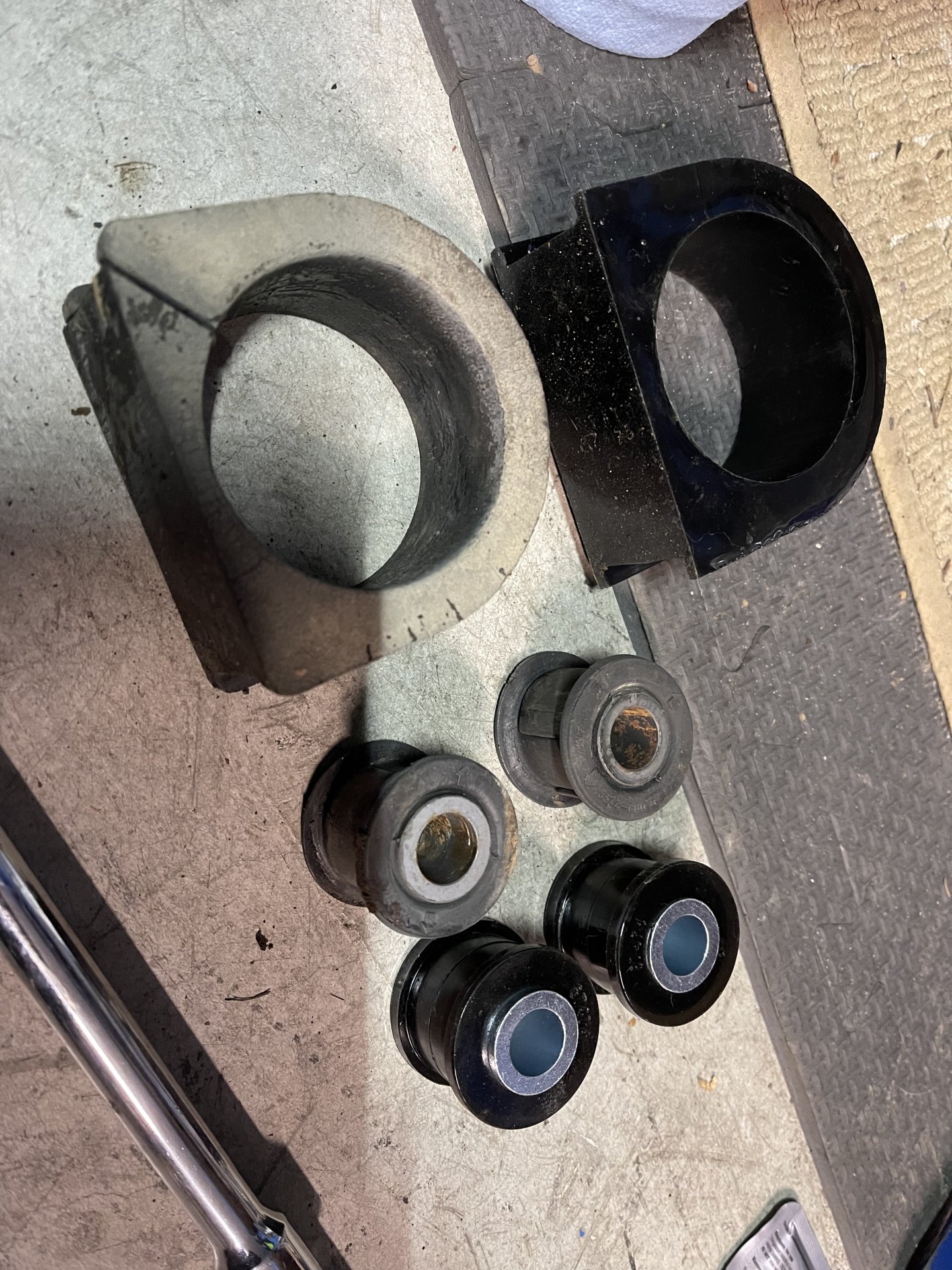

A few weeks ago I did the front diff bushings, this weekend I decided to knock out the steering rack bushings. Was not bad at all, maybe 2-3 hours.
Hah, I'd probably spend the first hour just cursing at it
Lol! Yeah, when I first looked at it I was wondering how the heck I was going to get this done. Once you start putting your tools together and removing the lower engine covers it all starts to click and make sense.
For your 2-3 hours for me probably double
I know there's quite a few "step by step explanations" out there on how to do this but they leave a lot to the imagination. The tie rod ends DON'T have to be removed and the OE bushings are NOT 2-piece like the aftermarket ones. They do get pressed out from the bottom using the floor jack / flat head trick.
I did struggle with the front top bushing getting pressed in cockeyed 3 times, 4th was the charm... :bang:
I also followed this explanation to the letter for pressing in the lower and top bushings (plus the metal sleeve).
(Press in the lower bushing > Press in the metal sleeve > Press in the top bushing)
If I didn't follow this, I probably would have spent another hour running around the garage looking for a long bolt, nut, and washers.

I chamfered the outer edge of the small bushings (only on the side the goes in first) and the made it super easy to get them started. Oh, and douse it with silicone to make it easier to slide it in.
I chamfered the outer edge of the small bushings (only on the side the goes in first) and the made it super easy to get them started. Ih, and douse it silicone to make it easier to slide it in.
I had to do that to the front top bushing. It was getting pinched at the back for some reason.

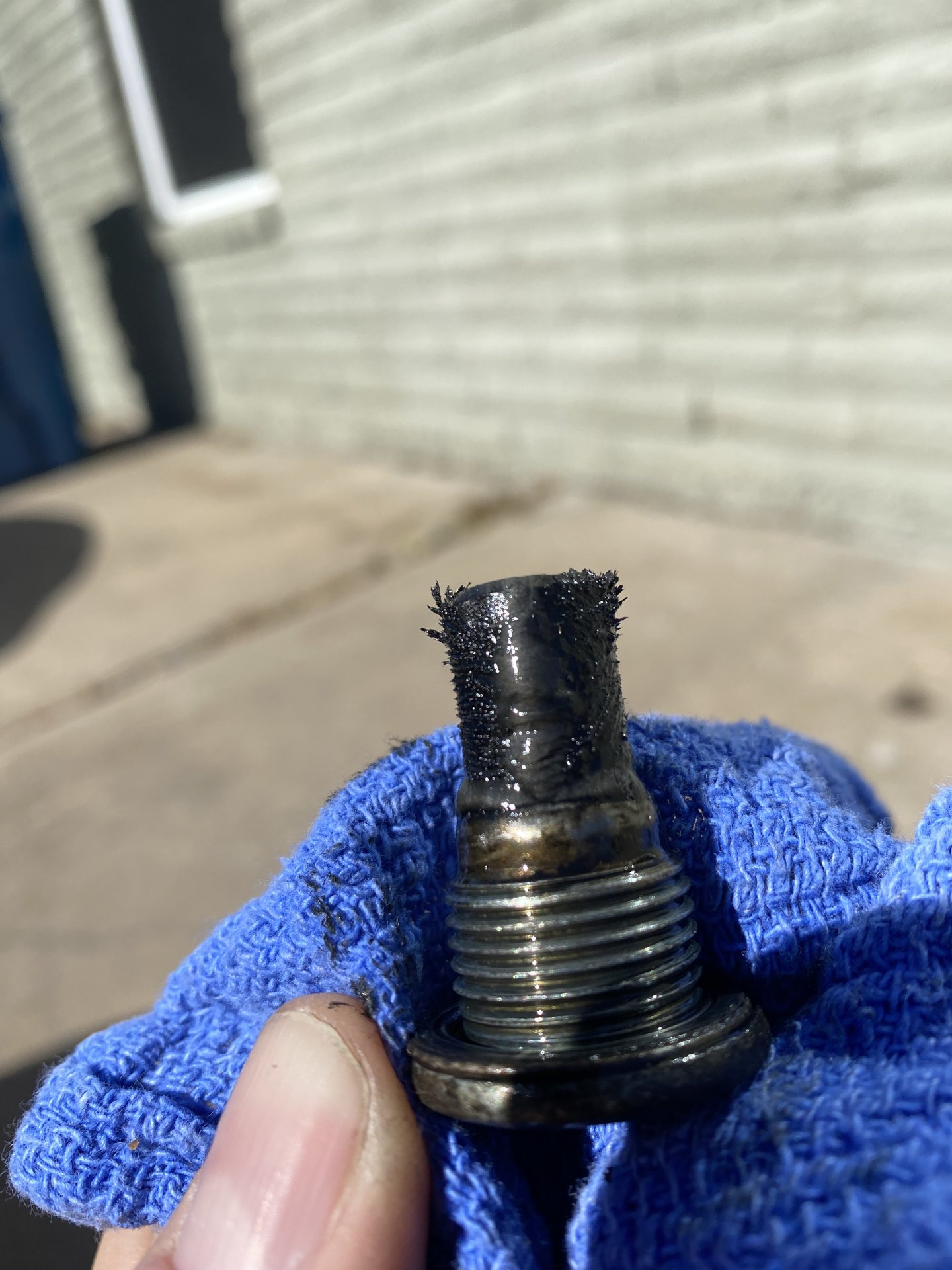

Front/rear/transfer/engine oil changes. Front looked good. T case wasn’t great but not terrible. Rear fine. Debating wheel bearing check and repack and ball joints.
Had what I thought was a small chunk of something in the rear. Once I wiped it, literally paper thin. Nice little shaving, and I’m glad it wasn’t a chunk of something. I’d appreciate the lockers if it was (not that you can gears right now).

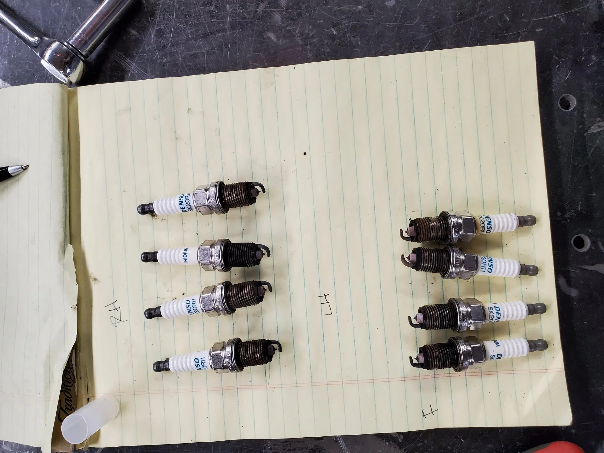

I’ve had the cold start tick ever since I bought my 03 LX three years ago, and always assumed that it was a cracked exhaust manifold. But I kept coming across the “Check your spark plugs” thread, and also seeing reports of burnt or cracked coil pack tubes, possibly due to loose plugs. Then, when I replaced my muffler with a Magnaflow unit I got a check engine light suggesting an O2 sensor problem. So I decided I’d start rectifying all the potential sources of bad combustion, starting with the symptom I’ve had all along, the tick. Bought all new plugs, as I couldn’t see any record from the dealer of plugs having been replaced (PO had the truck serviced by the local Lexus dealer), and three Denso coils. Every single plug creaked as it came out (“gosh, I hope this doesn’t twist off”) and looked to be in really good condition. None were what I’d call loose, though one was torqued somewhat lower than the other 7. All the coils were fine- new looking, even. Glad to not find any problems (257k), but really want to figure out this CEL. O2 sensors next, I guess. Heading out for the evening, so will post if anything has changed.
I had codes 0430 and 0420. New rear O2 sensors seems to be the trick.

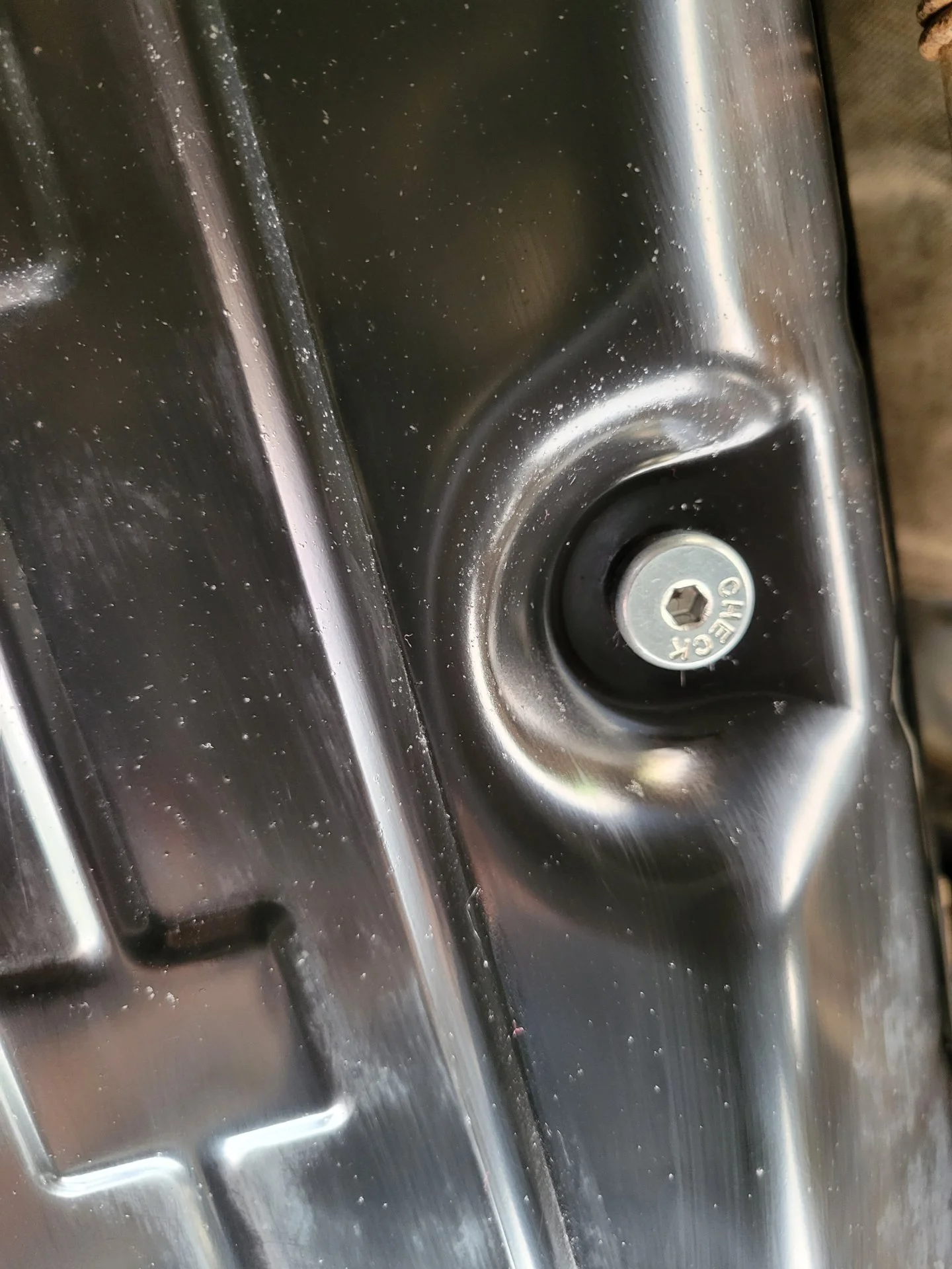

Did probably the most boring things I'll do to my LC. Installed a new transmission check/overflow plug. The original was stripping out bad. I nearly ruined the new one as I wasn't paying attention to the torque wrench I was using and almost overtightened it. 15 ft lbs for anyone curious. It got a new crush washer too.

So you reuse the brain plug and replace the washer? I need to do this soon

I like that drain plug. Care to share the source?
For the diffs, you have to. Crush washer.
The transfer case has an aluminum washer that isn't the crush style, but I venture on the safe side because the torque value is pretty low, and I would prefer having a fresh washer with the right amount of compression on it every time. At less than a buck a washer, no sense in not doing them.
Front and rear diff are a must though.
Thanks!
To avoid confusion, it is the overflow plug not the drain plug. On the later LC's they didn't have a dipstick to check the ATF level, you use this overflow plug. The drain plug is different, OEM 90341-10011.
I bought 90341-10021 on eBay. It is much cheaper on PartSouq (like $2 vs $7) if not for shipping but I didn't have anything else to order at the moment so I used eBay.
Also, they do use the same gasket though: 35178-30010
