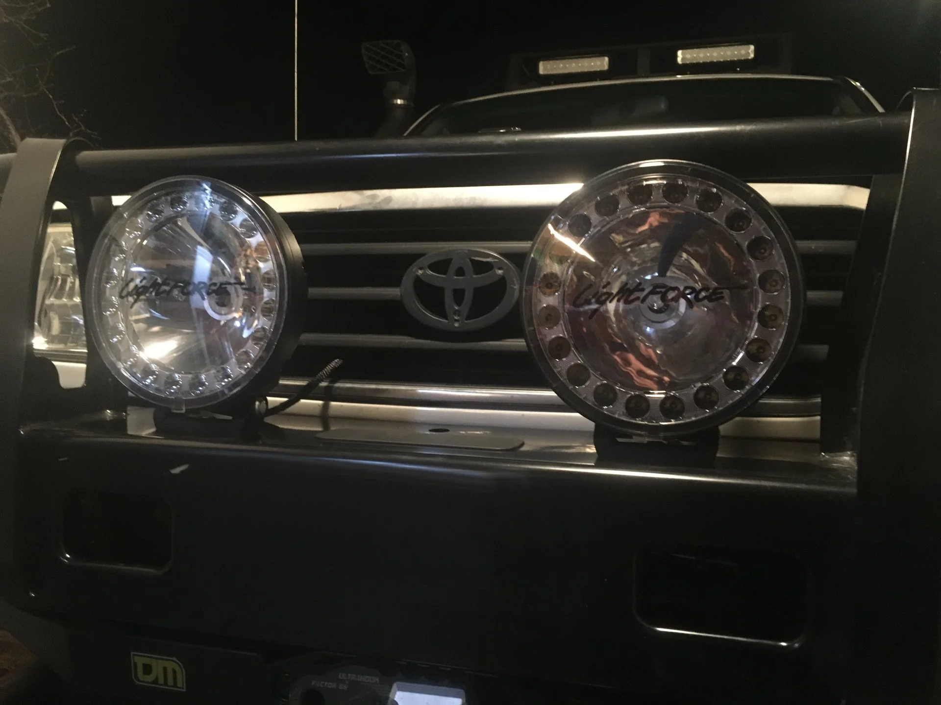

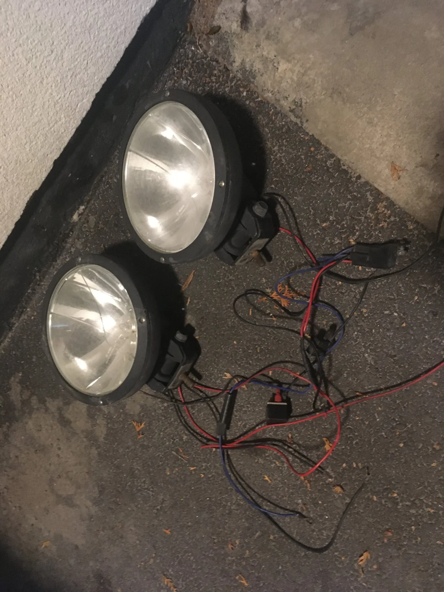

Changed lights from worn out and cracked Hellas to Lightforce HDX2's
Also rewired the old switching for the light bar as it was anything but safe...

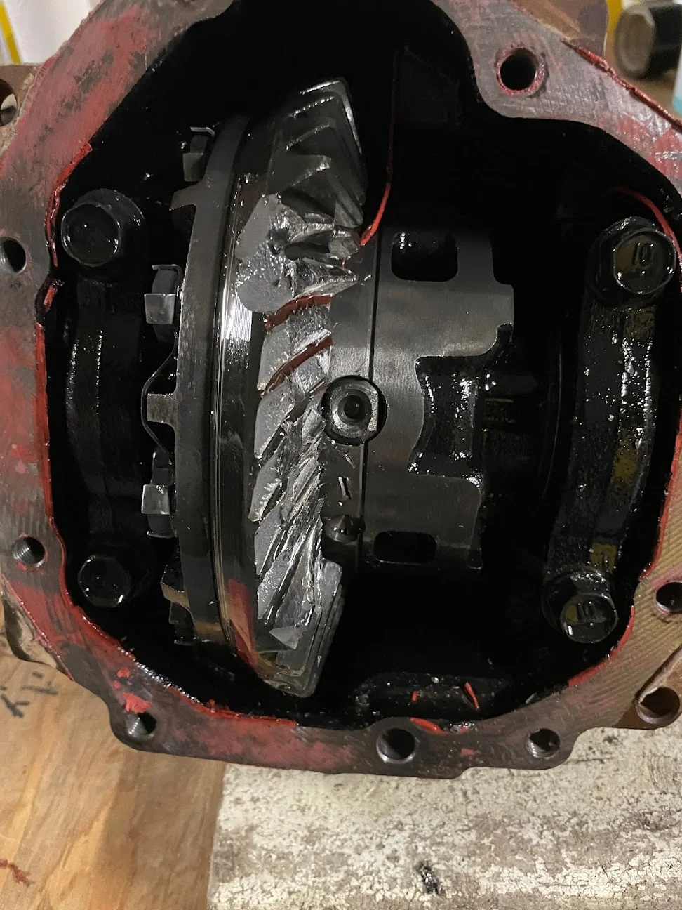

Thanks to anyone who posted. Dug into this over xmas break. Flanges, c-clip and splines were just fine. Drained the diff oil and found:
Pulled the cv's out and then the diff to find broken ring:
And broken main(?) pinion:

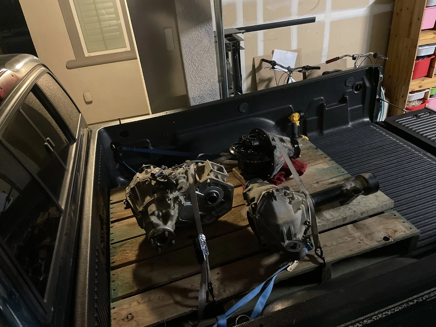

I decided to pull the pin and get it all done! All the children tightly tucked in heading to gearing school:
Differentials to the diff shop and then Transfer Case to Valley Hybrids for the regear low. I got to meet George (@orangefj45 - he was great) and Roark and he even pulled the transfer case apart to give me tour of its innards while I was there. They had so many old Cruisers there it was mind blowing... I'm sure they're numb to it but I was in awe! Snapped a pic with permission:

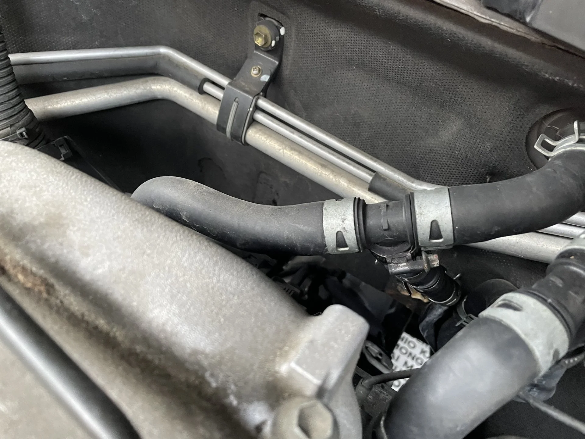

I was planning to do these with the radiator in a week or two, but it was starting to seep a bit so no more stalling. Thankfully I had the parts sitting at the house ready to go.
Someone was obviously in here at some point "fixing" the leak. For whatever reason they decided to add even more junctions and used worm drive clamps.
Took me about an hour, I put a garden kneeler on the core support and kneeled on that. It worked pretty well and I was able to reach all the clamps with long reach hose clamp pliers.
Topped off and bled with Toyota Red, it was definitely down a bit.
