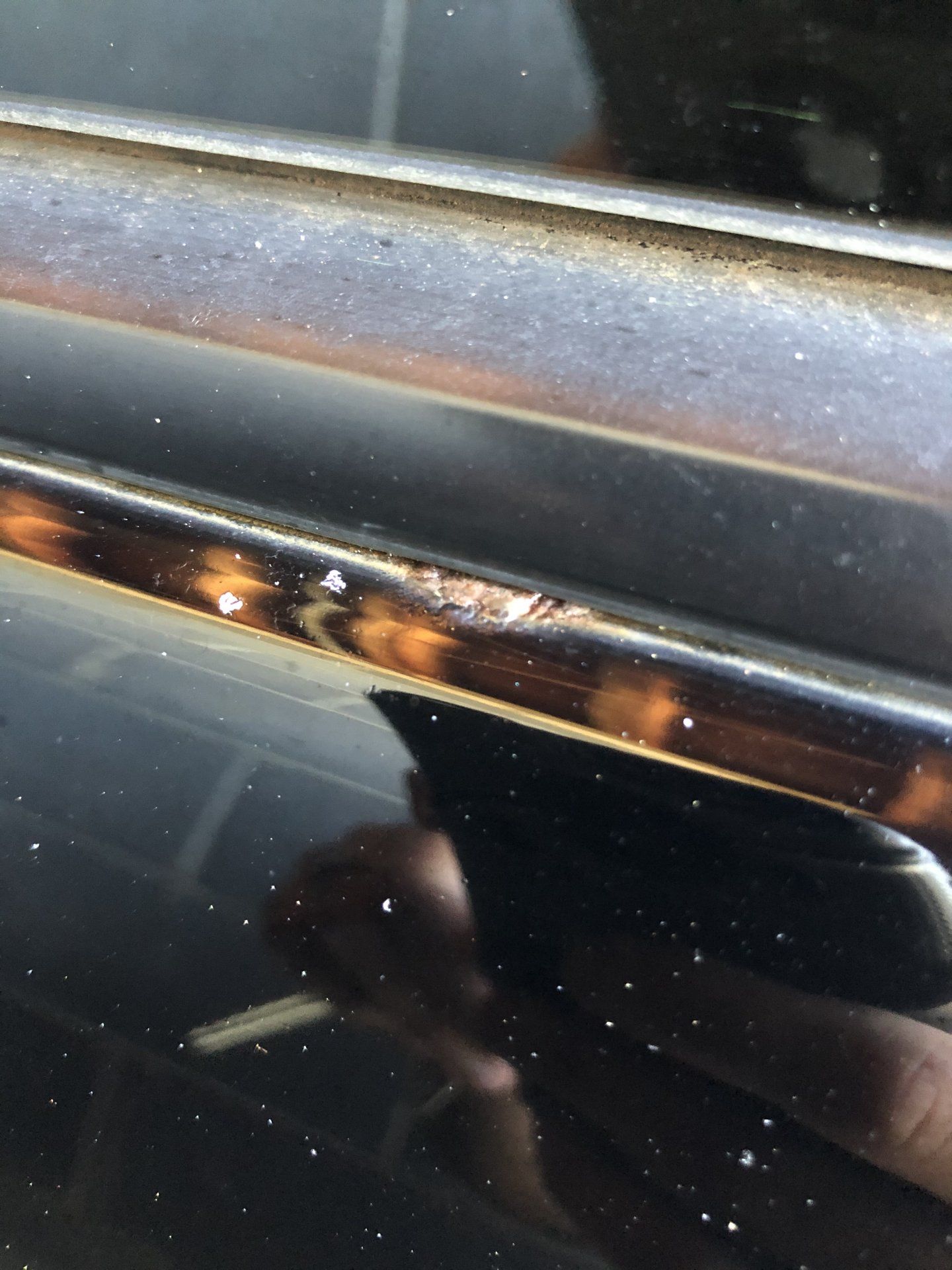

Also tonight did some rust remediation (found rust under a quarter window seal) and bolted up one of my new @TRAIL TAILOR shock protectors—these things are works of art; I feel so bad about what’s going to happen to them....
How did you clean up the rust and how hard was it to pull the seal and reinstall it? I’ve been neglecting this bit of bubble rust and want to try and handle it soon.

Is that rust bubble spot below the rear quarter windows? If so you may just need to pull the belt moulding below the windows and not the seal itself. But I think both involve similar amounts of work—in both cases pulling the upper and lower internal trim is the hard part. Window comes off with two nits up front and two at the motor in the rear. Just have new belt moulding on hand because by all accounts you’ll destroy the original removing it.
i used a dremel tool flap wheel to grind the rust away and Eastwood’s rust encapsulate spray. I’ll let you know in five years how it worked!
Thread about the overall job here: Replace Moulding, Quarter Window--the trim at the front of your rearmost window

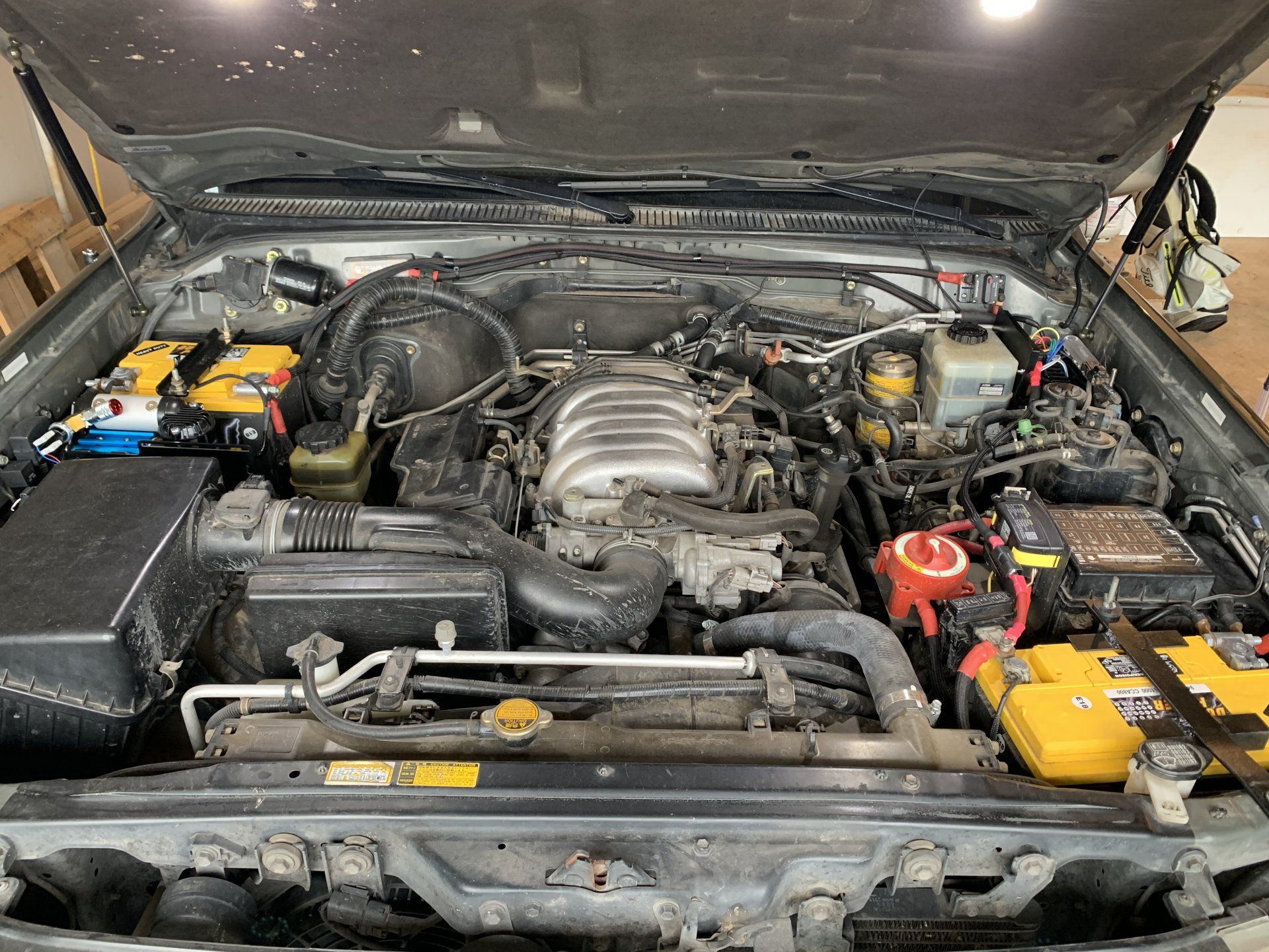

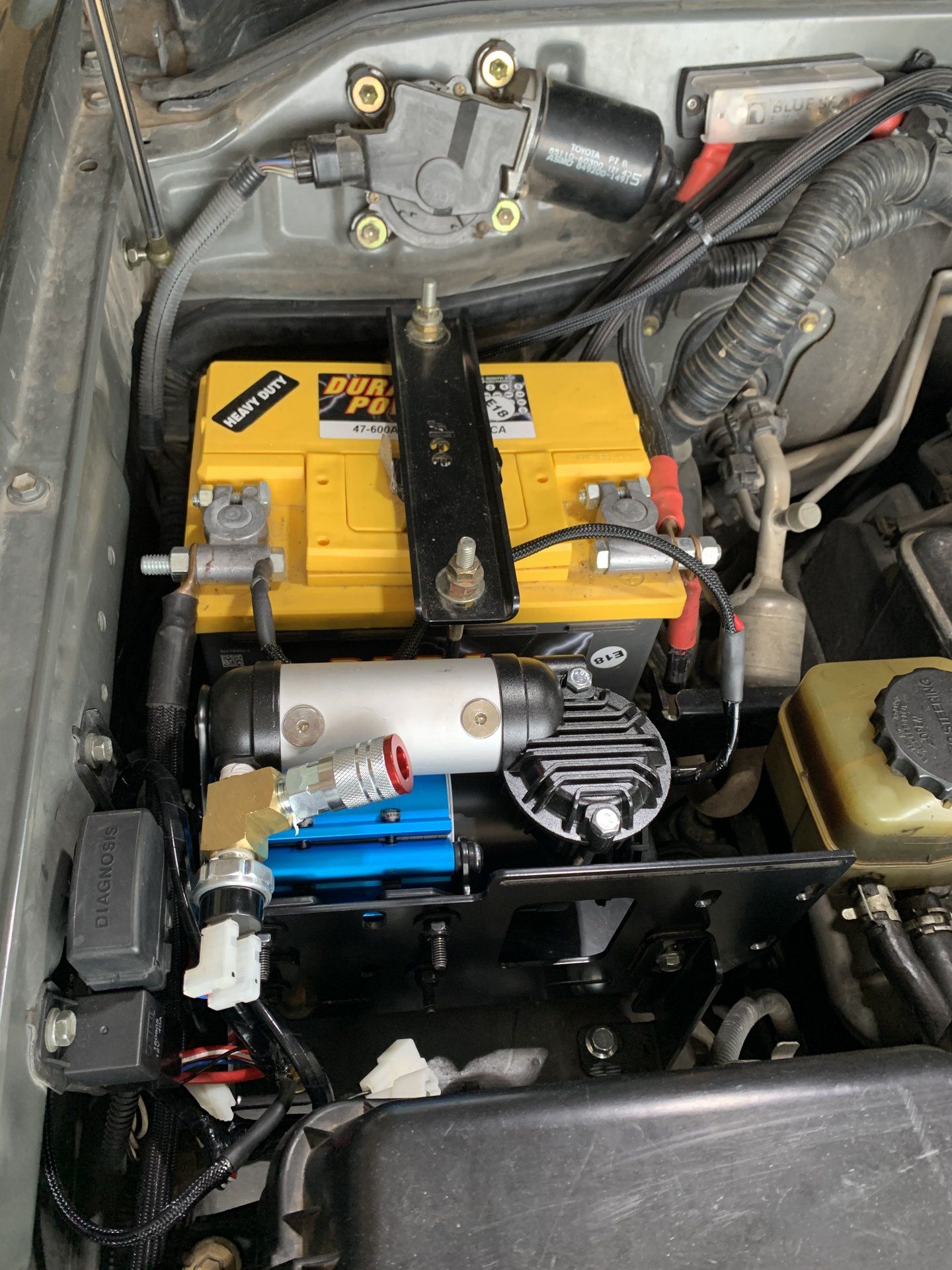

Finished up my Switch-Pros install so now I can finally get the rest of the lights that have been sitting in boxes for 6 months installed. Fabbed a quick mount out of 3/16ths and secured with a nutsert and treaded rod into an existing spot in the wheel well. So far I have the ARB air Compressor and under-hood work lights wired up. I love the RGB options on the controller, they match well with the OEM green interior lights.
