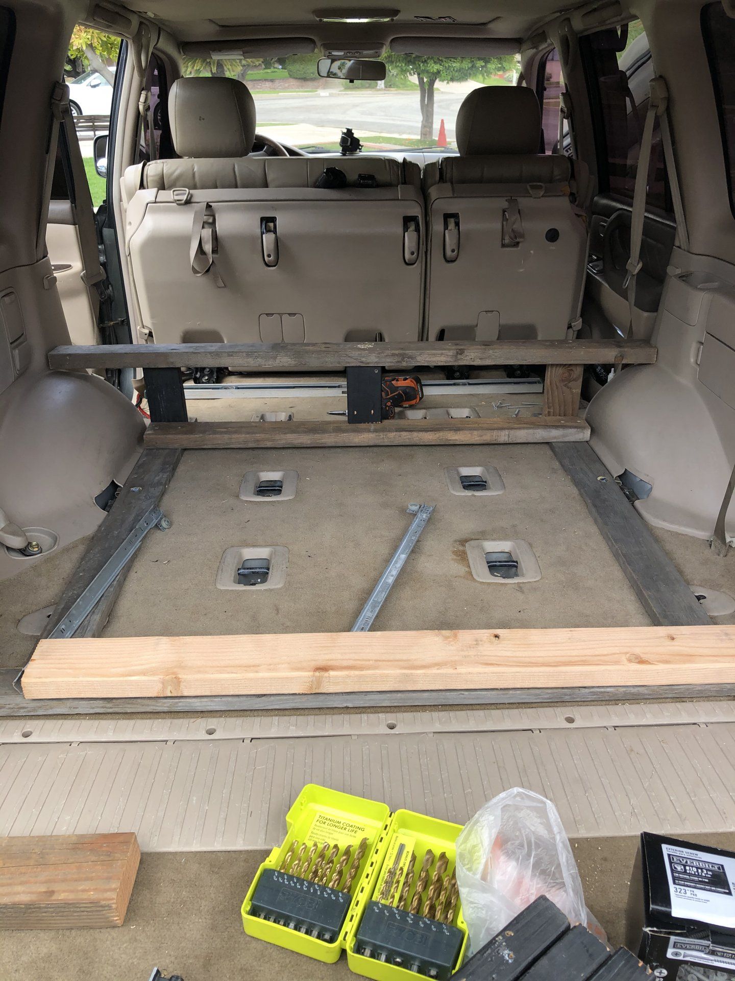

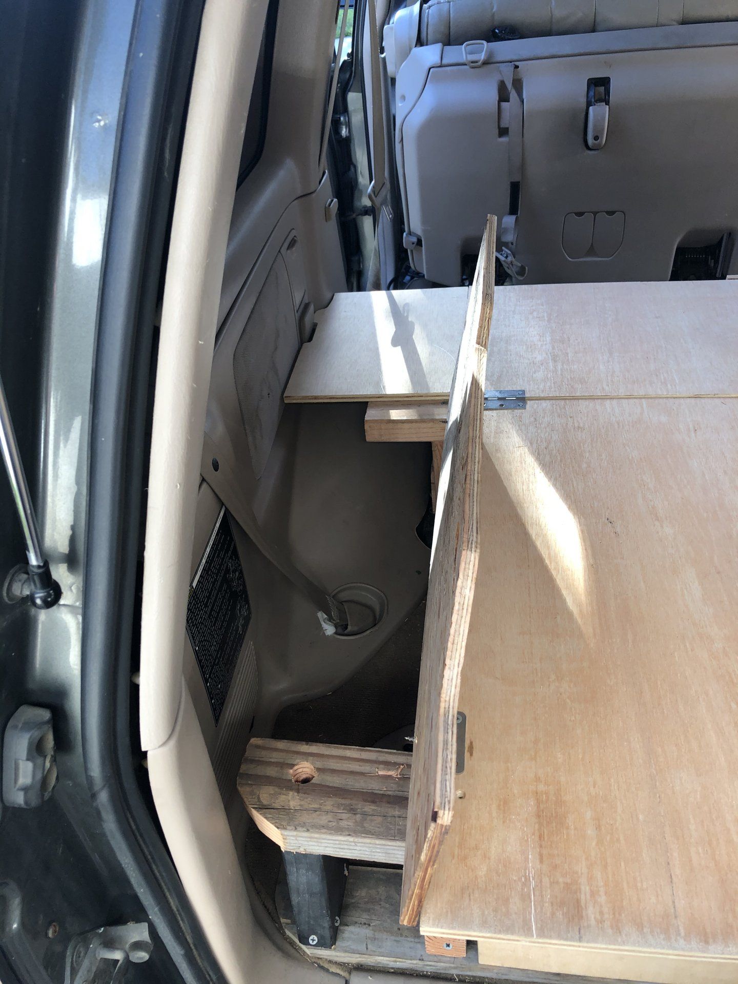

Finished it. The latches really leave a lot to be desired and with the metal plate cover from Huracan Fabrications the tailgate is very heavy to lift (I have to warn my wife!).
Otherwise, everything is well designed, instructions were easy to follow and the tailgate holds a surprising amount of cràp.

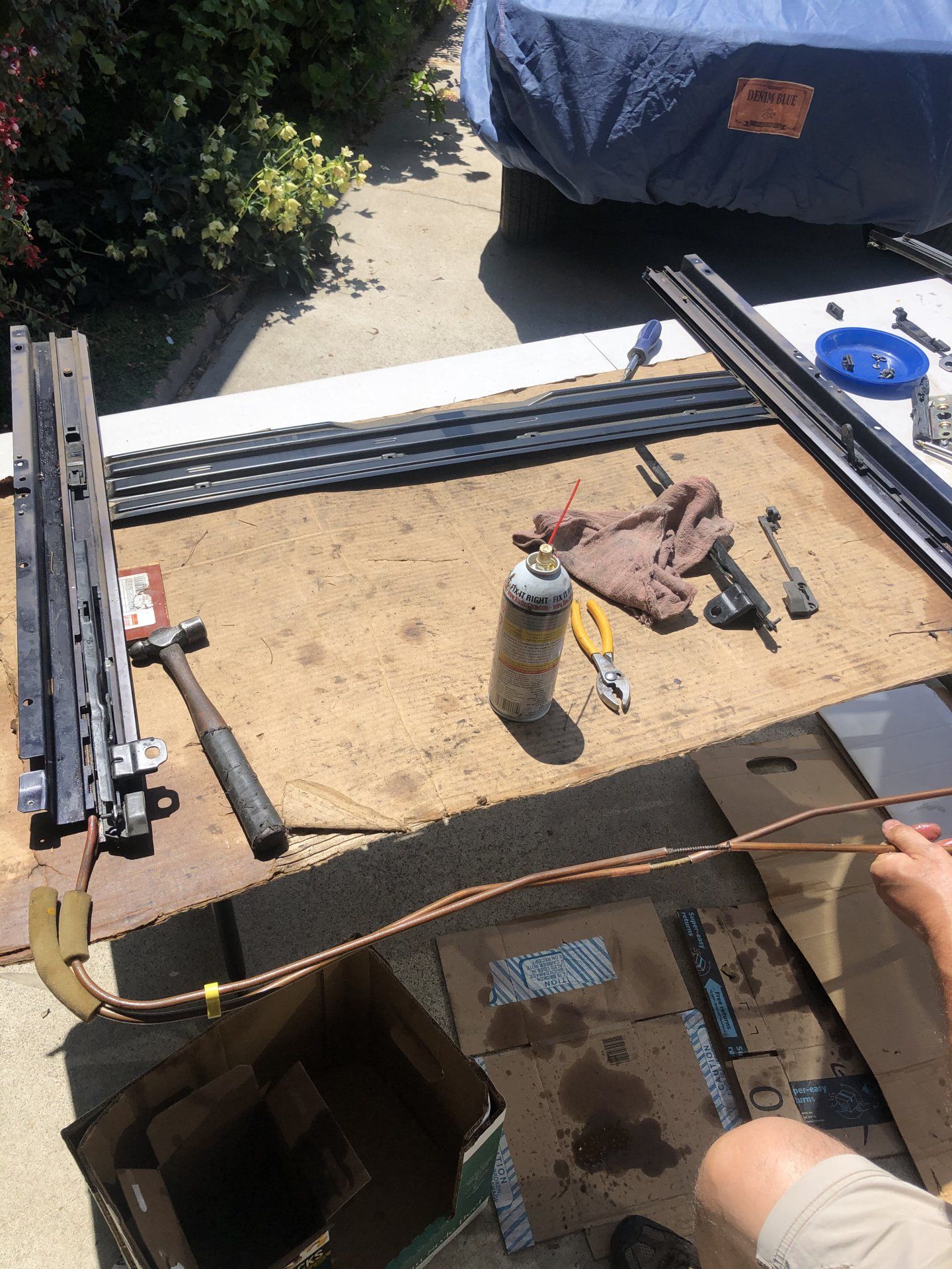

Since everything was apart I figure why not try and tackle the jammed up sunroof that leaks. Quick trip to ace hardware finding copper tubing that was very close in size a bit of solder and about 2 full days of work. Got the sunroof working again for a total of $10

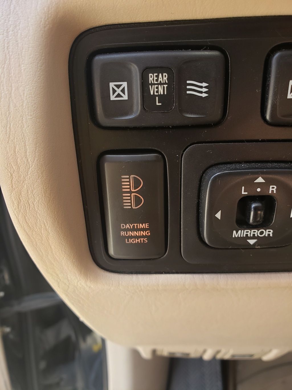

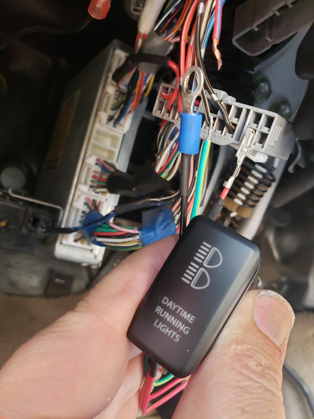

Today I installed my a daytime running lights switch from Cruiser Heads 4x4 ch4x4.com
I really hate that you can't ordinarily turn off the DRLs.
I installed the switch so that it only lights up when the DRLs are also on. I did this by connecting the power for the switch light to the same circuit that activates the relay for the DRLs.
