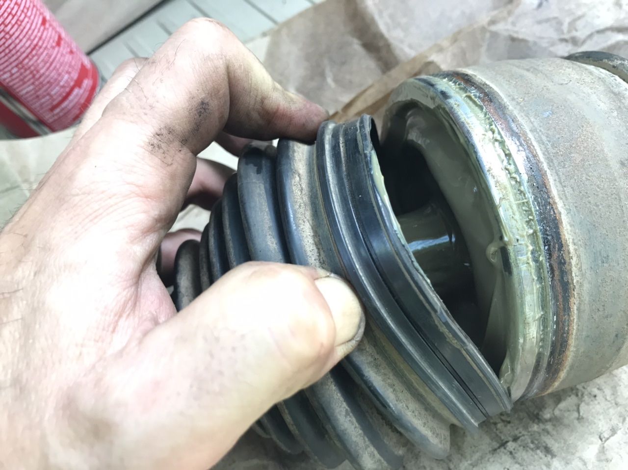

While my axles are out anyway (broken diff getting new gears and a harrop e-locker next week) I decided to check the CVs, which were just (2 years/20k miles ago) repacked/boots replaced by a Toyota dealer—bless the PO’s heart.
I initially thought —contaminated! But then I did some poking and found out the Toyota grease is just this color and, unless someone says, “swap it out” I’m going to leave well enough alone. This was the joint with the most grease seepage (From the inner clamp, which I tightened up a bit) out of all four, so if this ones good, they all are.
146k on the truck; cv boots/repack done at 126k
Run 'em! The grease looks great. The serviceable CV clamps available from PFran or McMaster Carr are nice if you don't already have something similar.

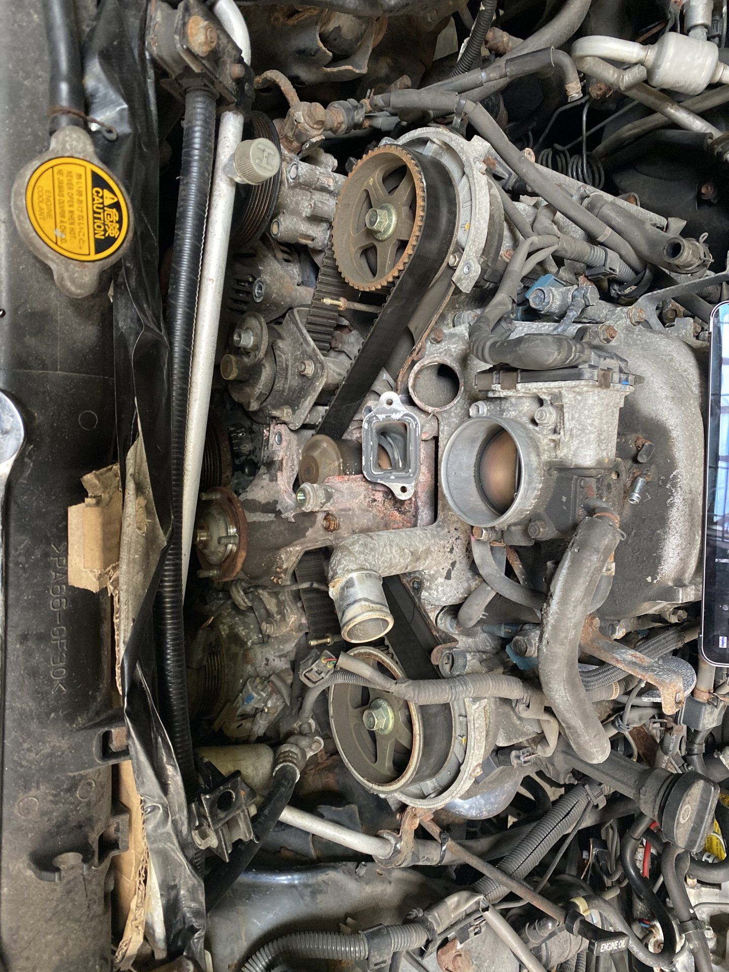

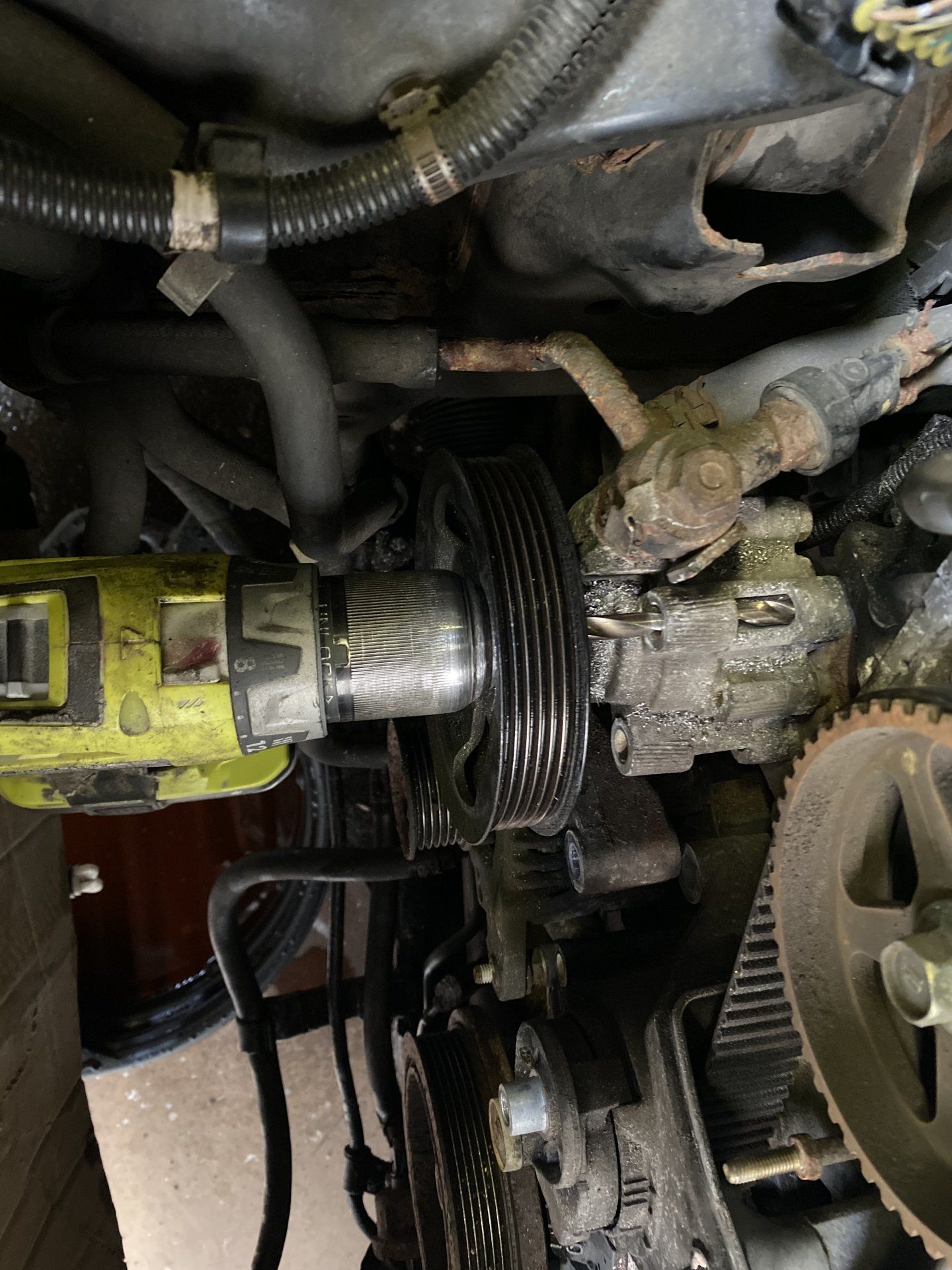

First half of timing belt/water pump job today.
A couple hiccups, the slow AC leak I’ve had since I bought the truck last year turned out to be a small hardline right at the condenser that became a big leak when I slightly moved the lines to get the fan out. Replacement ordered.

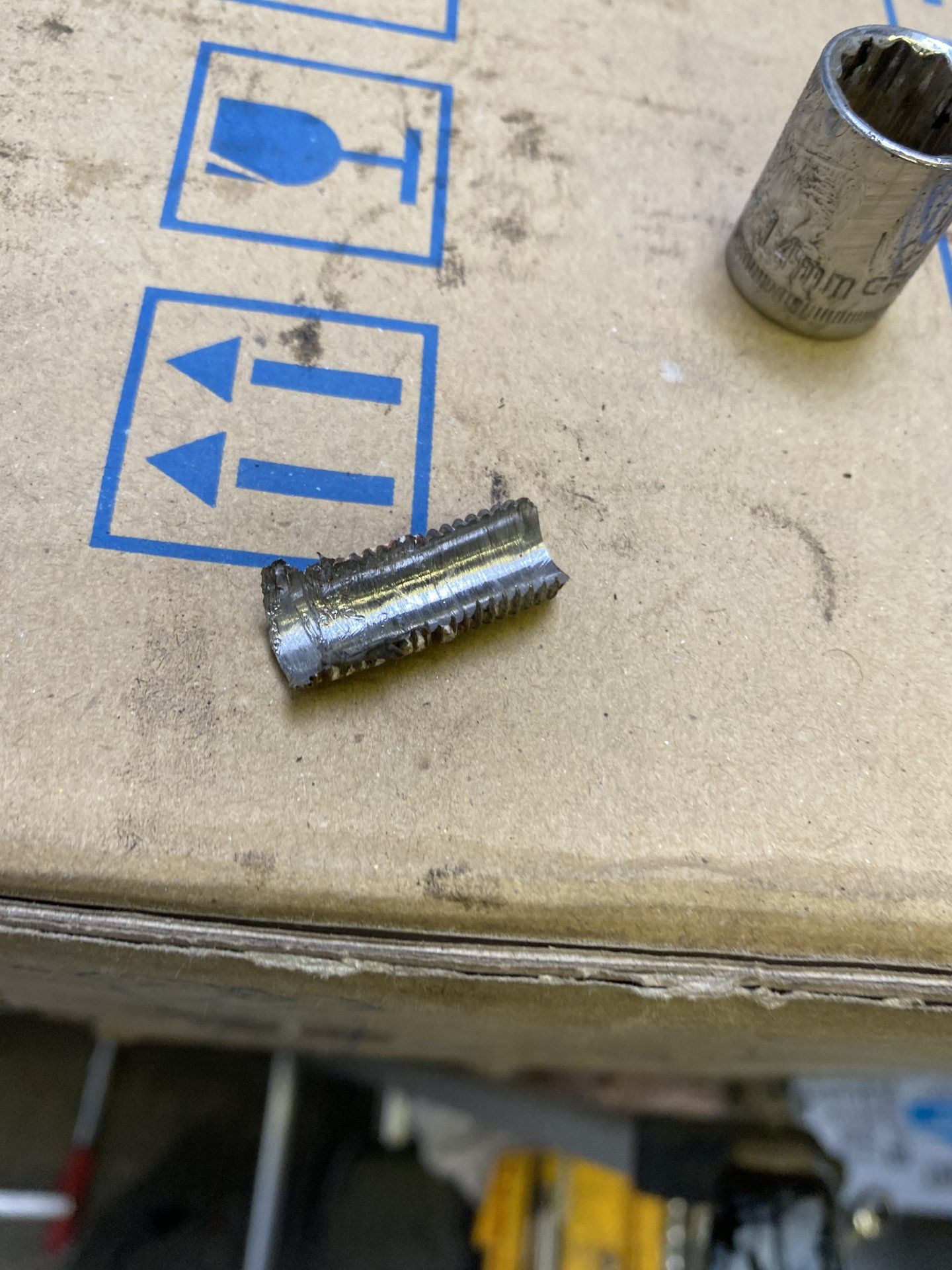

Also because my car is from the northeast, I broke one PS pump bolt and one fan bracket bolt, had to break out the drill to get em out. Will pick up some replacements tomorrow and button her up.
