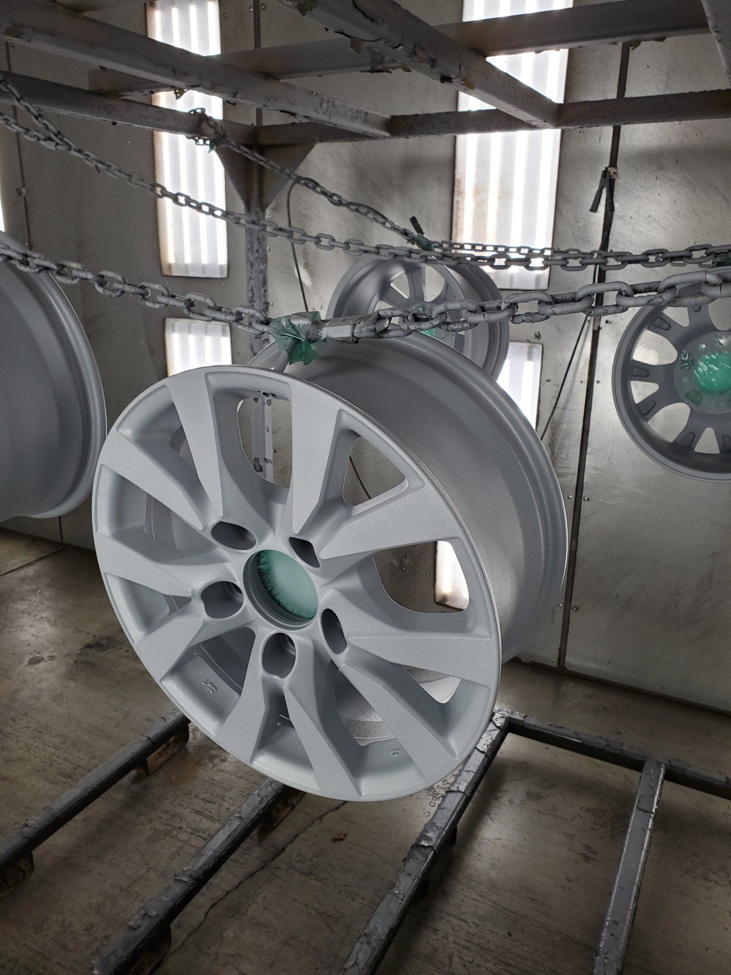

18" 200 Series wheels arrived today. Hoping to powder coat them next Friday. Thinking a texture black we have.
Also have 1.25" Bora spacers on order.
Painted my wheels today! Went with a Zinc-Rich Primer for added protection against corrosion followed by 'Bike Black'. Was hoping for something with a little less gloss to it but this is what we had on hand. Plus, they turned out awesome!
Also painted my engine and transfer case factory skid plates using a matte black texture paint.
Hoping my Bora spacers arrive this week so I can get my Falkens mounted and balanced!
