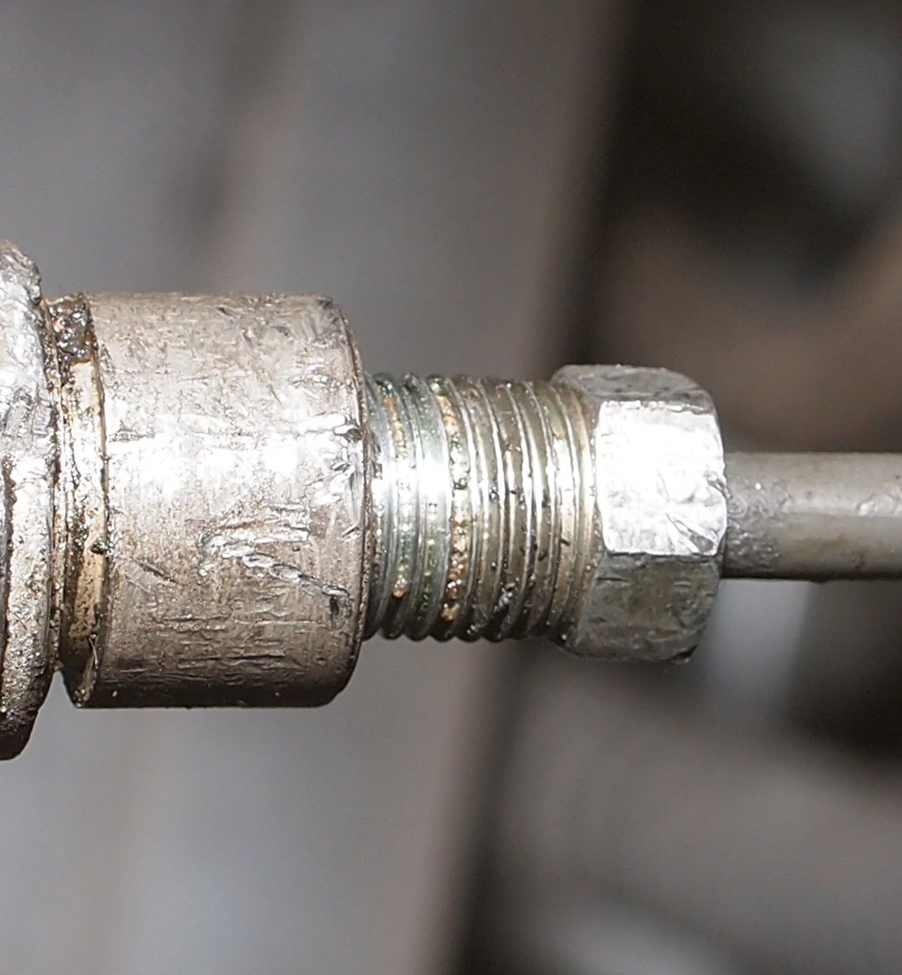

Ok this I've not seen this before. What appears to be a factory installed, brake hose from main pipe to differential pipe flare nut is stuck on female end.
While removing the two upper rear brake hoses, the flare nut of one hose was hard to turn, as if cross thread. But now that threads are fully or nearly exposed they don't look cross thread, at least not with to me.
But even now with threads all the way out it's hard to turn 90 degrees of a full 360 degrees, the other 270 degrees I can turn by hand.
But I just can't get the flare nut to release from the female hose end threaded fitting. I tried pulling on hose end while turning nut. I've tried pulling from both ends rocking back and forth while turning. Tried turning hose end while holding nut. Tried pulling while turning hard and at different angles. I just can't get it off after and hour or so of trying.

It appears threads aren't cross threaded.

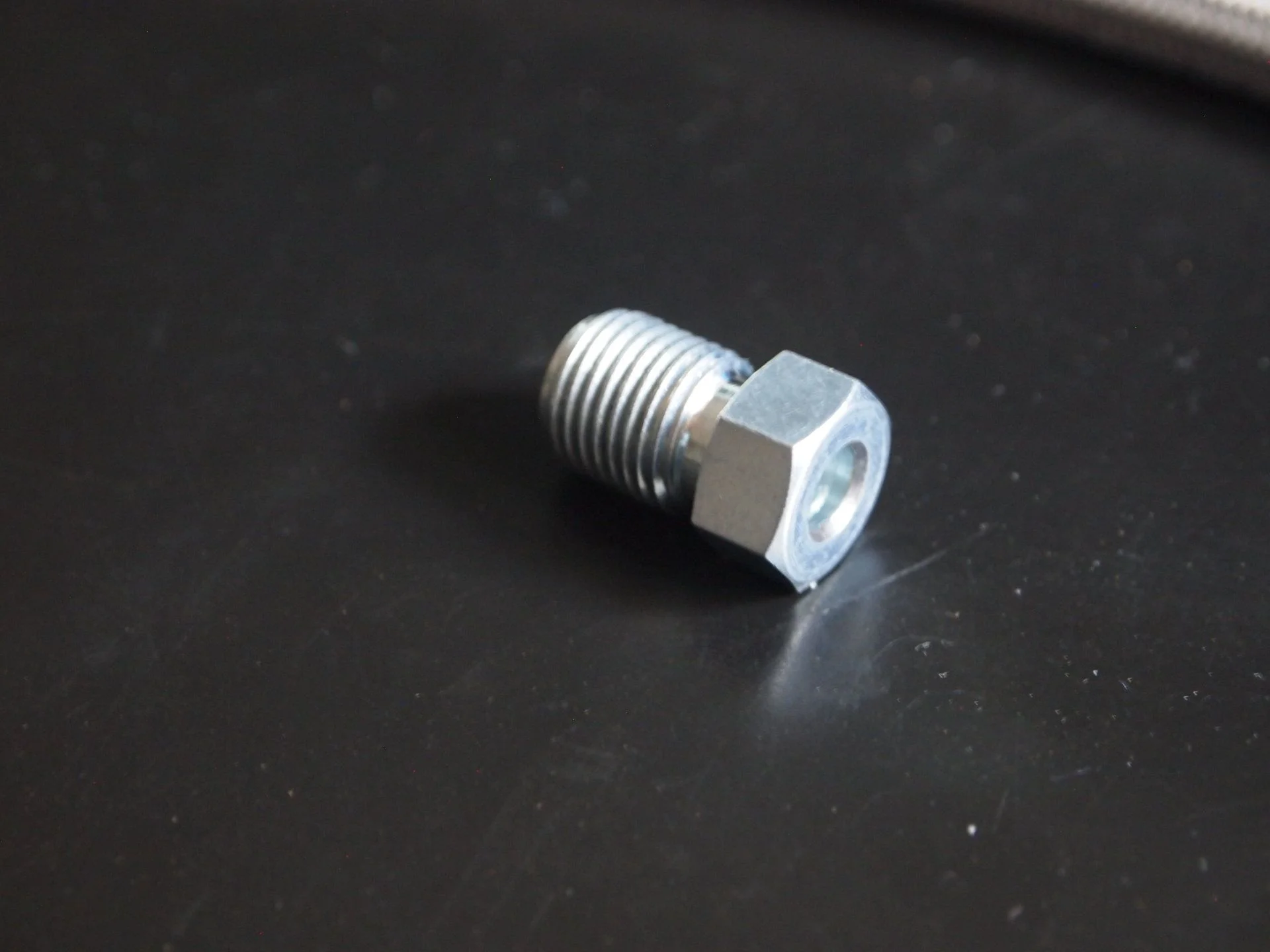

This is another hose female end for reference.
This is another pipes male flare nut for reference.
This is the difficult one, it doesn't look like it has ever been touched.

To be clear, it's not frozen on. I've unthreaded the flare nut and can turn 270 degrees by hand. The other 90 degrees turn is more difficult, but I can turn it. Notice too in video, I move the flare nut in and out of female end just a tad.
Looking at the female side I don't think it will separate, at least not unthread. It appears to a solid one piece pressure crimped on hose.
I do think lip rolled. Only thing I can think happened at this point!

The flare nut move freely up and down along with twisting on brake pipe. See video!. It stays stationary as I turn either flare nut or female end, without hanging up.
My first thought was cross threading, nope doesn't seem to be.
My second thought was flared tip of pipe was deformed or enlarged hanging it up. Nope doesn't appear to be!
It seems as if lip of flare nut is smashed (rolled) creating and offset lip hang me up. But I can't get off, even pulling twisting turning. Notice all the tooling marks I've put on this virgin assemble.
