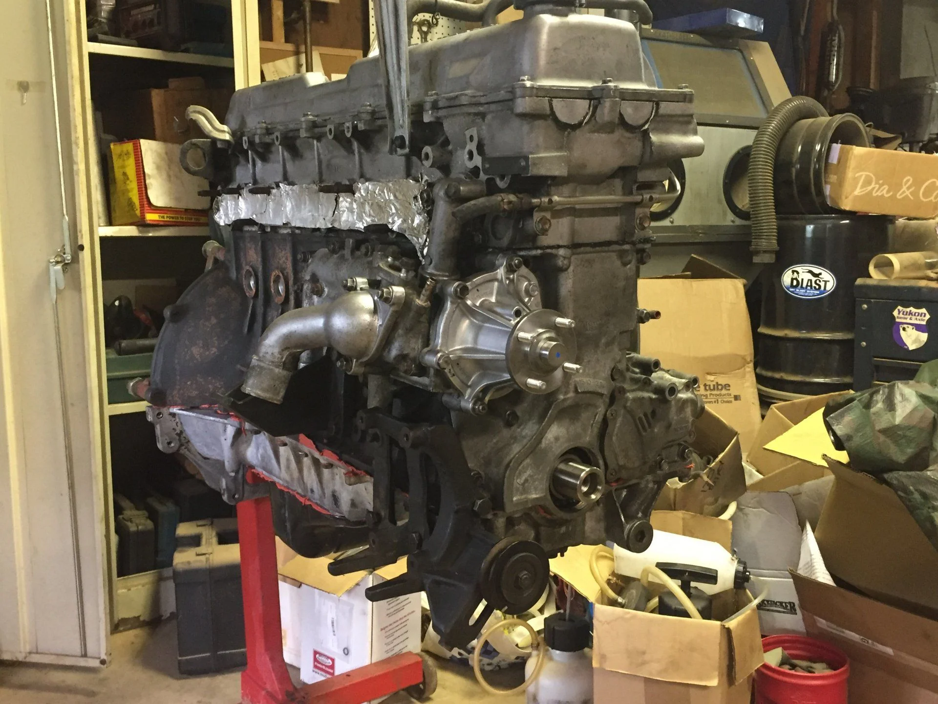

Jumped in the parts runner and spent the weekend at home working on the motor. Of course being an idiot in a rush, got the valve cover torqued down.. got the oil pans.. realized I used 1281 RED to seal the pans instead of BLACK FIGP. Going to be a fun weekend scraping all that mess off and cleaning everything up. In my defense this is the first reseal I've taken on myself.. Learning the hard way to make it easier next time

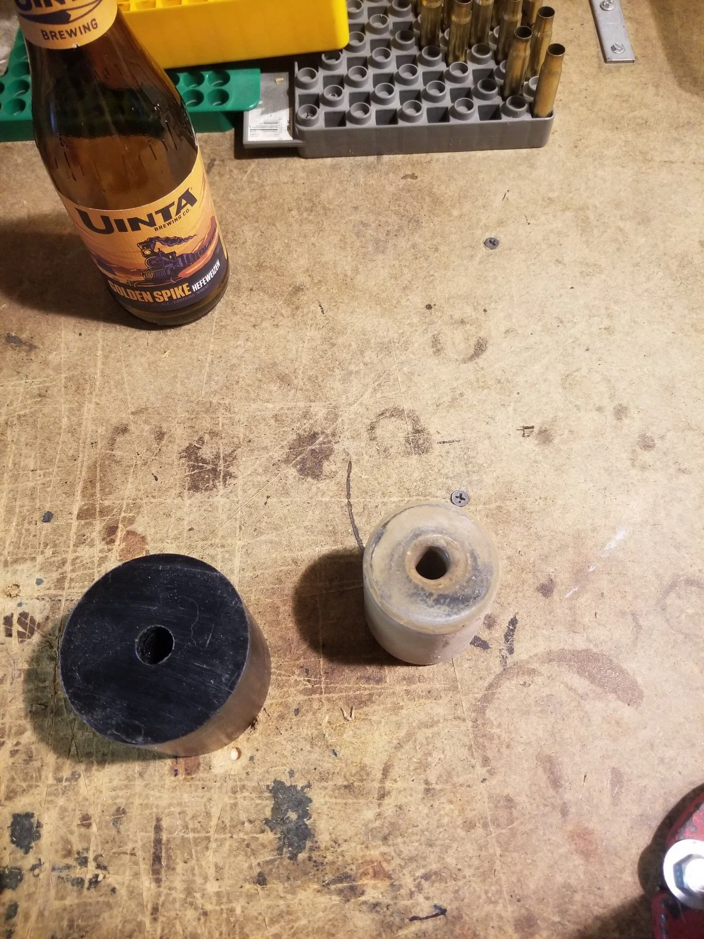

I spent a few hours today addressing the previous owners stupid body lift. A couple of years ago I was being an idiot and drove way to fast over some rocks that were way to big and it ended up cracking the body where one of the previous owners home brew aluminium body lift pucks made contact with the body. I welded the cracks and reinforced the body where it cracked and I figured the others would be good as long as I didn't abuse the rig by driving 30mph over a bunch of 1 foot+ boulders...

This time I decided to replace all the stupid aluminium blocks with something wider because the aluminium blocks were only 1.9"' inches in diameter and I am hoping that wider blocks will prevent this issue from reoccurring until I can just remove the entire stupid body lift in another year or two and redo the entire suspension. I found this guy online that will make custom body lift blocks so I went ahead and ordered a set. Mikellis body lifts The blocks seem great and are just what I wanted. I was able to weld the cracks and reinforce the area with extra metal again and get the two rear most blocks swapped. If anyone does want to pursue a body lift I would seriously consider ordering pucks from this website and sourcing your own hardware.

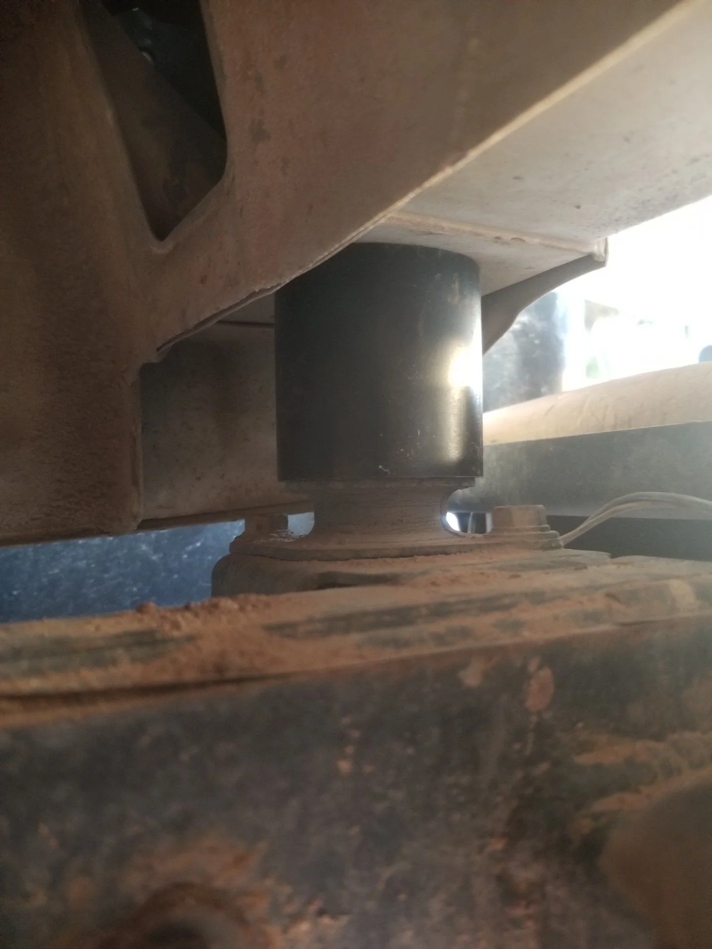

I also wanted to do the second set of blocks from the rear tonight, after looking at a schematic I could see that this set appears to be the only body mount that is not through bolted, rather I assume that these mounts bolt into a captured nut because I could not find a way to access the top side of the bolt. Well of course not only was the previous owner stupid enough to use aluminium blocks with a 1.9 inch diameter in direct contact with the steel body, but he also decided to use SAE hardware for the body lift. I guess he was also stupid enough to put SAE bolts into the 2nd set of body mounts from the rear.
I tried to remove these bolts but to my dismay they are just spinning both directions without coming loose or tightening. I am assuming that the previous owner cross threaded the SAE bolts into the original Toyota captured nuts and when I tried to break them loose I only managed to spin the captured nuts. I have pulled the carpet up along with the interior trim and I cannot see a way to access the other side of the bolt. I am thinking at this point I will have to use a hole saw on the rear floor to get access to them.... What a nightmare, I can't believe the previous owner was stupid enough to use an SAE bolt in the OEM captured nut.

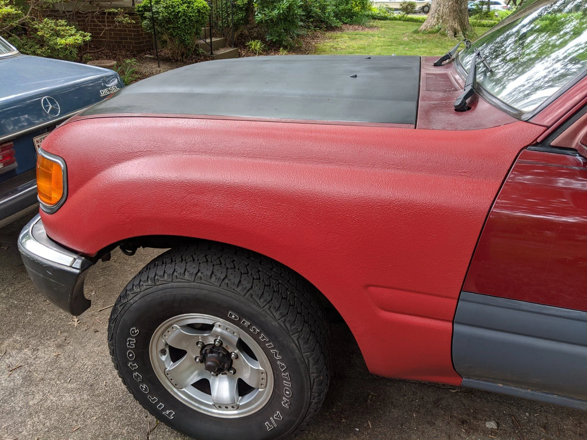

For those of you who have been following my other posts this is the end result of all the welding, grinding, sanding, priming and painting. Both of my inner fenders had rust through. My son and I had pulled the parts we needed from another 80 two years ago. We cleaned up and painted the inner fenders and were trying to decide what to do about the color miss-match front fender. We had been toying with the thought of using Monstaliner on the entire truck. So we took this opportunity to see how it is to work with, and what the end result would be.
I present to you, Matthew's Cruiser of many colors :)
Not perfect by any means but we both really like the end result. It is better than green, which is what this fender was.

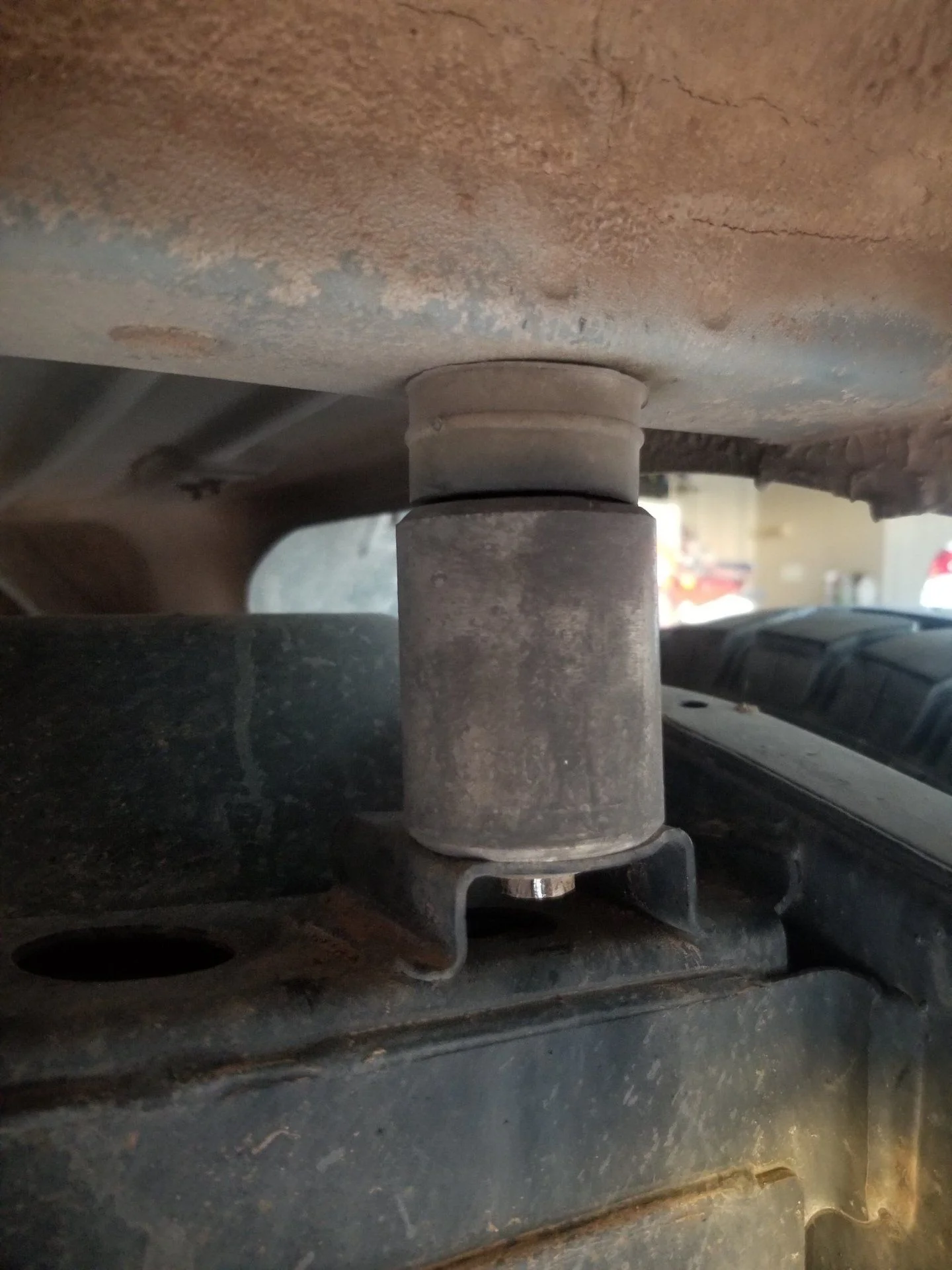

That mount is not bolted in a factory sense. The rubber on top is just a bumper, not a body mount like the other ten. I've been running a 3" BL for a few years and never bothered with that bumper.
So your saying the bolt for that mount screws into the rubber bumper and doesn't go through the rubber bumper into the sheet metal?
No, the rubber bumper is screwed to the body. I doubt that block is attached to the body, just the frame bracket. I'm not certain how one would get a bolt long enough in that location to go through the spacer and into the body.
Here are a couple pictures of my rig with a 3" lift. The "mount" in question:
ACtC-3eSjIa9QNvzsx3Up6k-zWGvvve4MU8n4pAgQlGcfhSYZMXe1XIlX9BwOQ6H_0WYz1Zgev4BnqJA9K_emyqwO9HuOn2g5ZEiPFIgy7FTvDR-mPtGI6rzPSLpDxuO5QcILih-gx54tJHP2K9Z9Icous8PUg=w1258-h943-no
Looking up into the bumper:
ACtC-3ePuG7exo-lLQeAzkSfS00ODqx-0wt1Cm4k1XDDPUpoVBdrzf_Z9ETwPo3wOu9AOow-ff5Do2mPVjLInjV2O1n3XepkcH4Lxpt_Y7snk3wwG8NMpAAqXQraQ_m13wxOJdifSrqnr0M1DJvyGttUNQrmMg=w1258-h943-no
Hope it helps.
