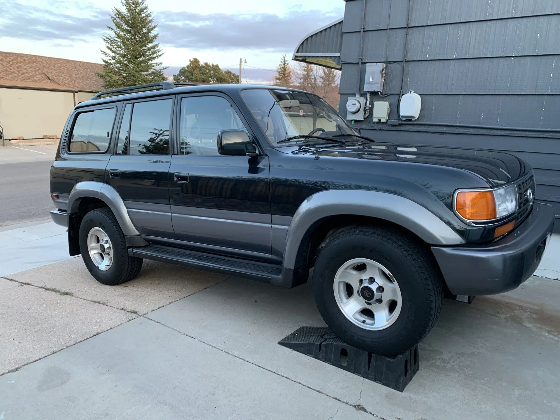

Flew out of state this weekend to grab an 80 with 115k miles and gray interior. It handled the 15 hour drive home like a champ. She's in excellent shape and the TLC needed is surprisingly minor, best I could find. I'll be going all out on this build - figured it may help someone!

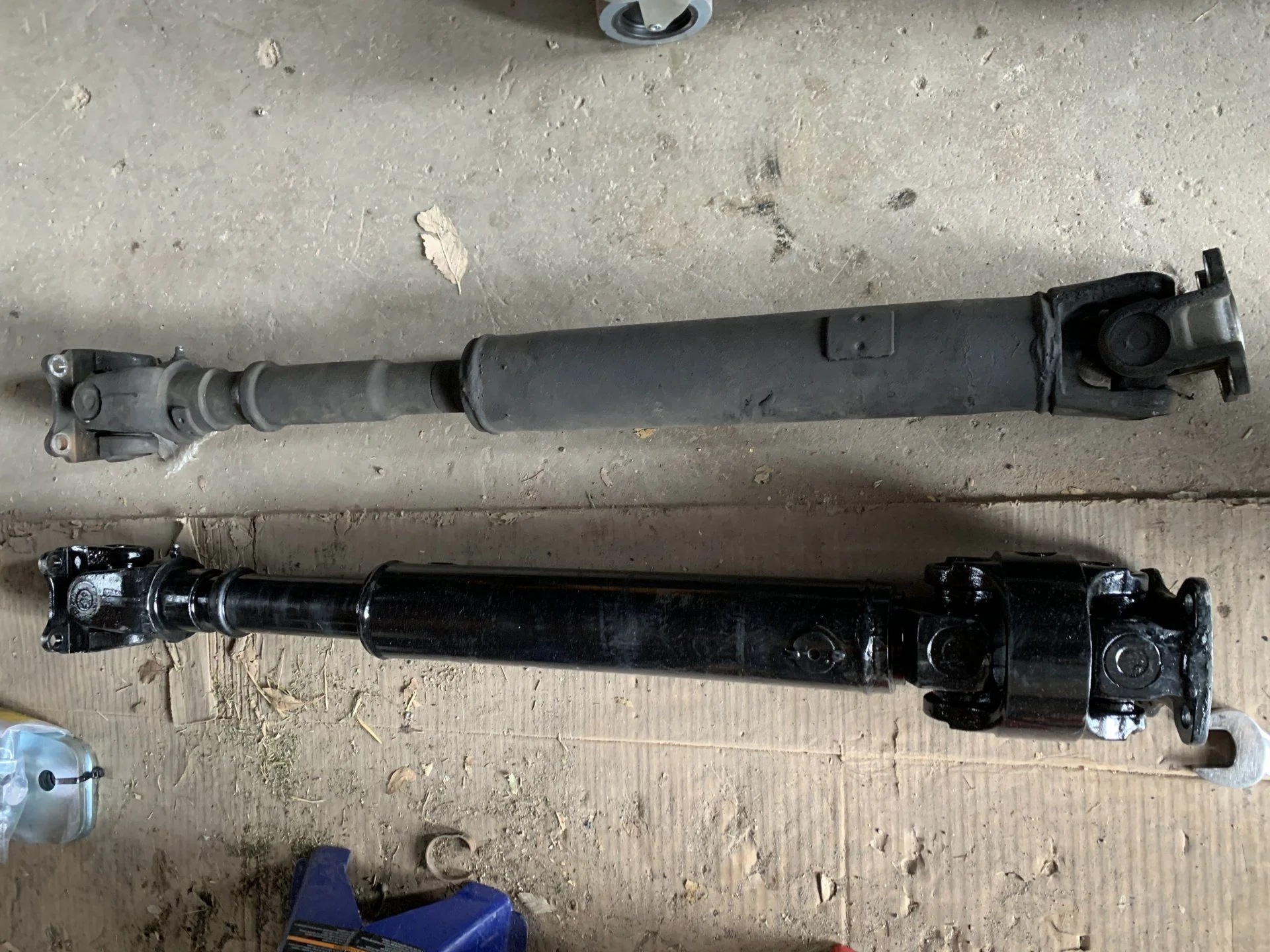

  • Slee 4" Lift w/remote res shocks, adjustable panhards, control arms, front double cardan drive shaft, medium springs, damper, extended brackets and brake lines

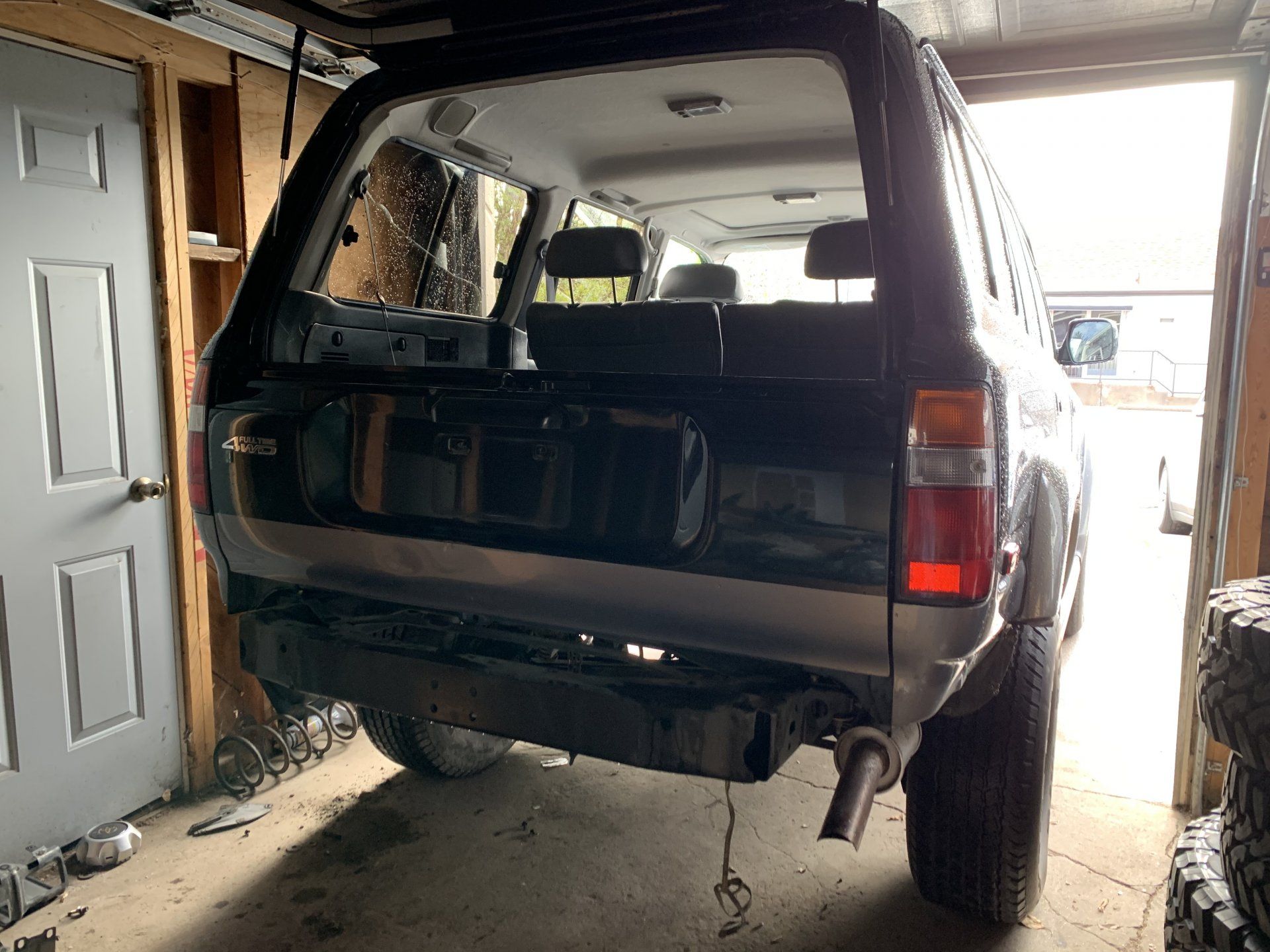

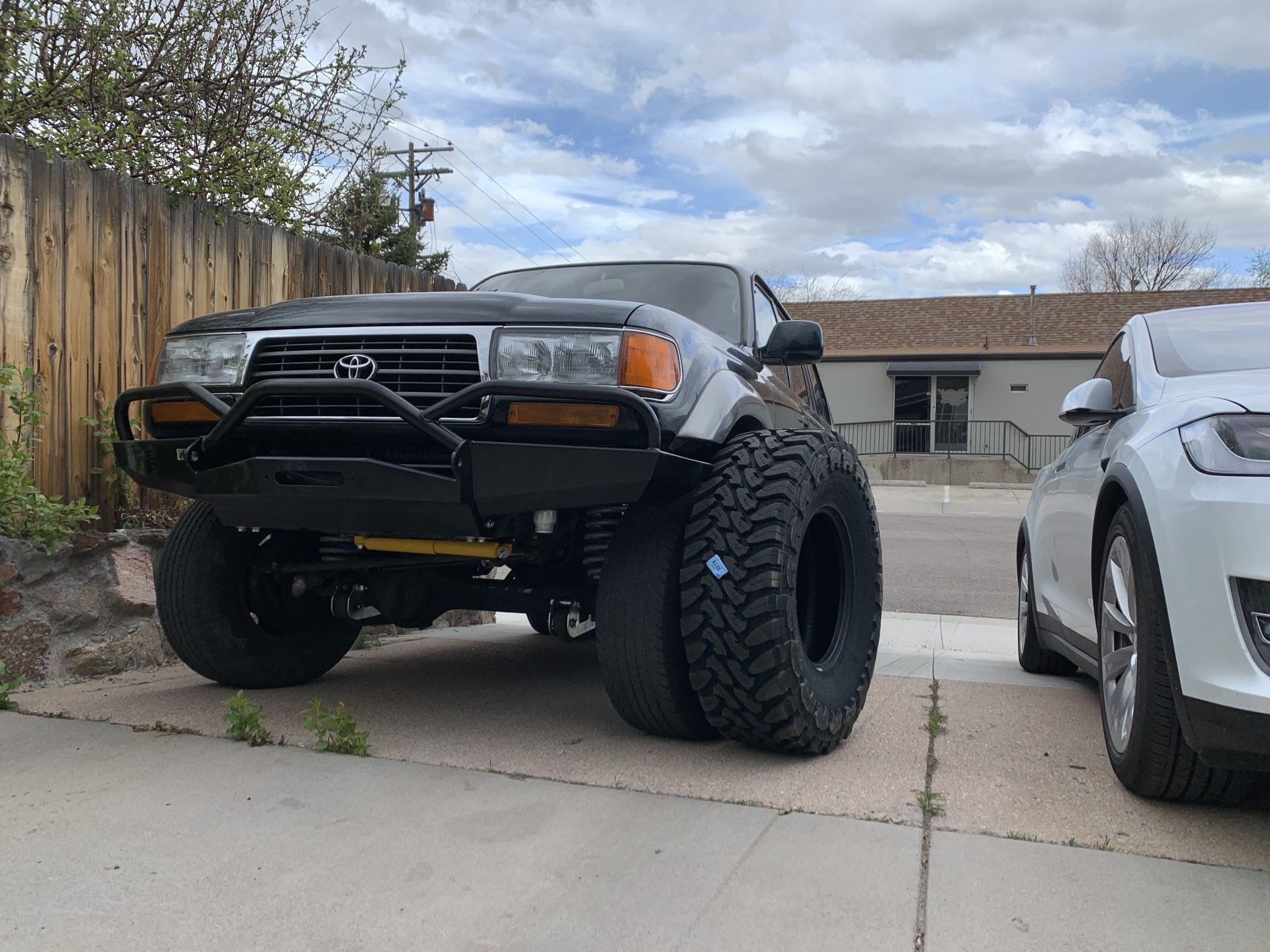

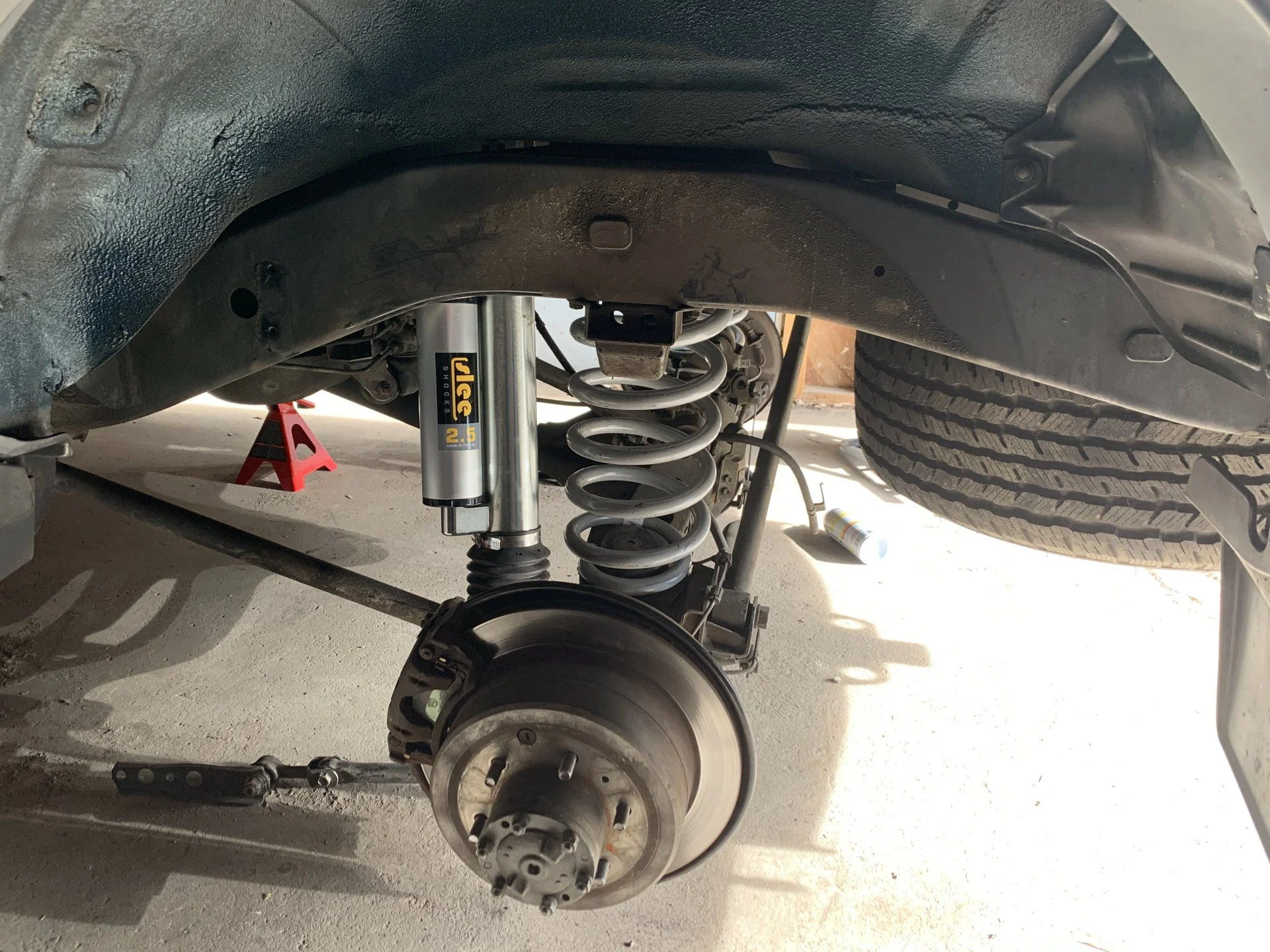

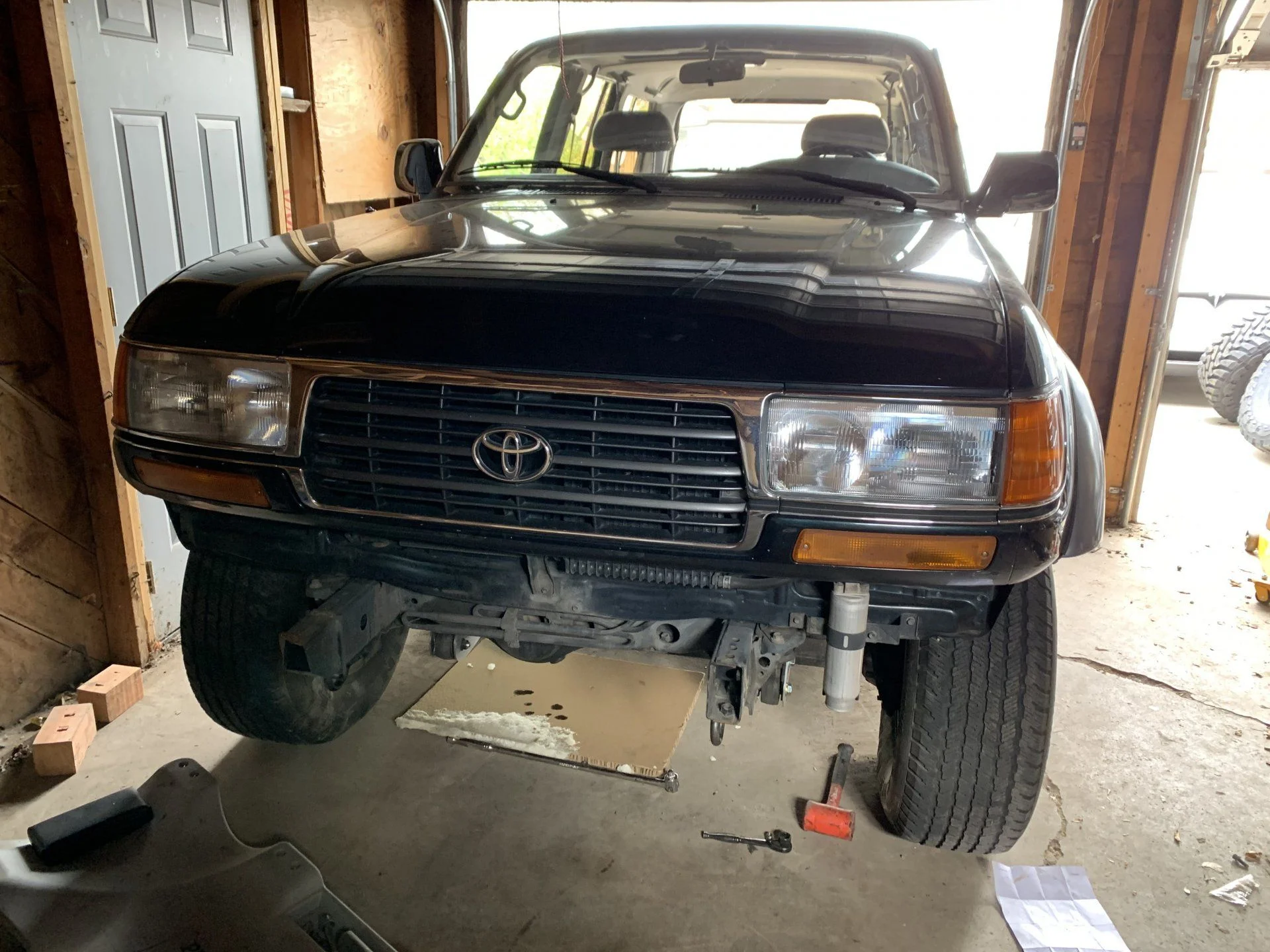

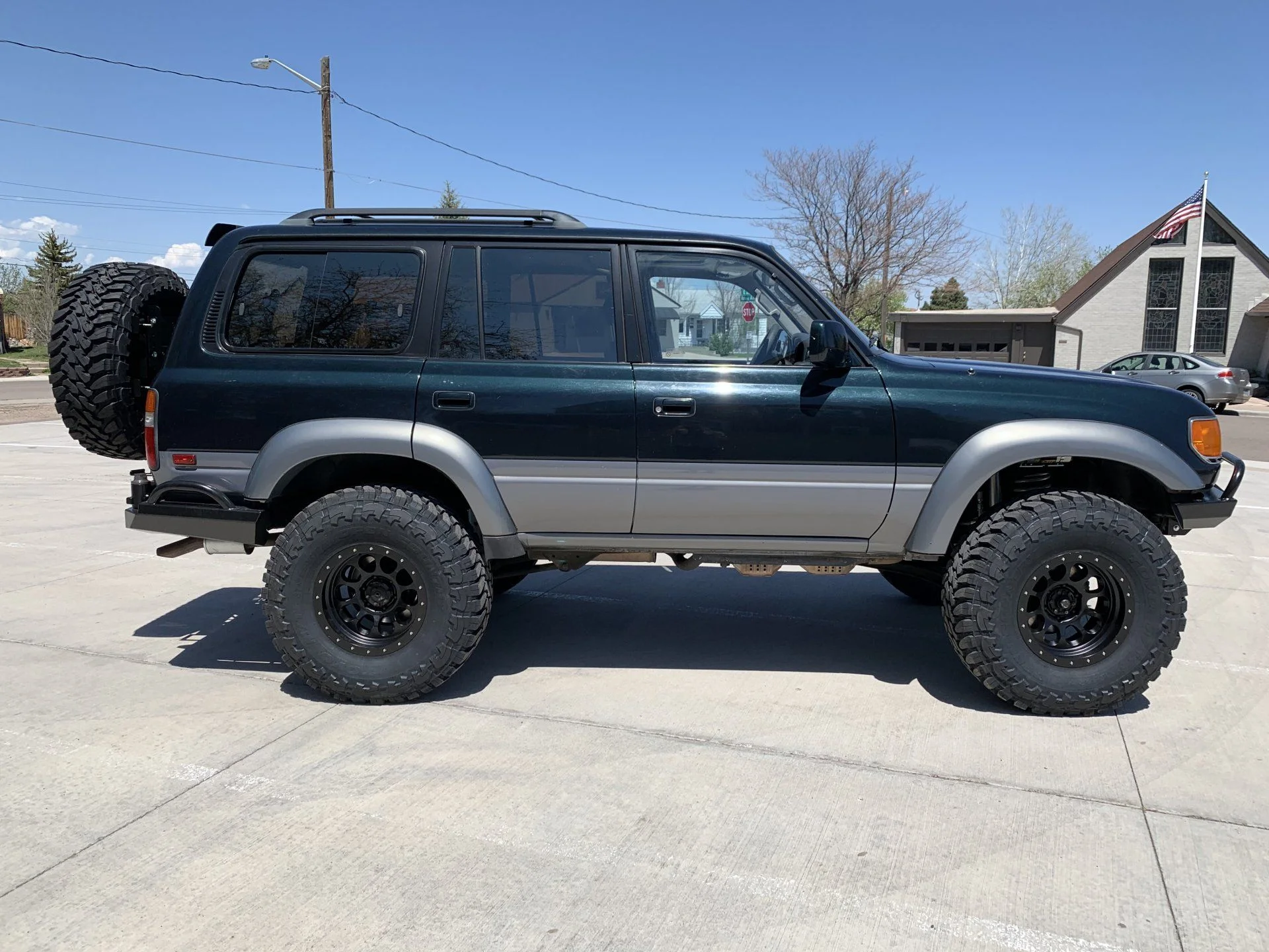

Slee 4" Suspension install wasn't too bad, just very time consuming - I really need a lift, rolling on the ground is so old. Fairly straight forward until the end, damn steering stabilizer needed a pitman. Oh, the panhards and rear upper arms were super annoying! Quickly installed the front bumper as well, looks weird without a winch mounted.

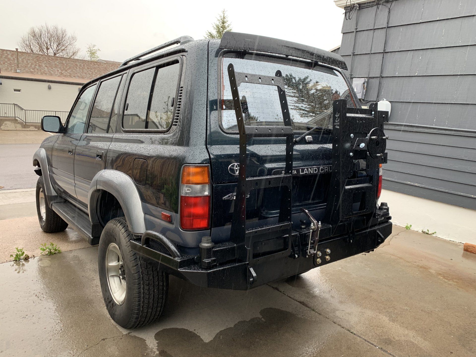

Finished the rear bumper install today. Kinda fun to put together save one thing - Allen screws! I broke 3 Allen keys and bits trying to get the damn things in, slee needs to rethink a couple steps involving those IMO. Also, separating the 100 odd bolts/washers per step would have been nice.
Otherwise, cool bumper so far and can't wait to get some gear and the 37 on there!

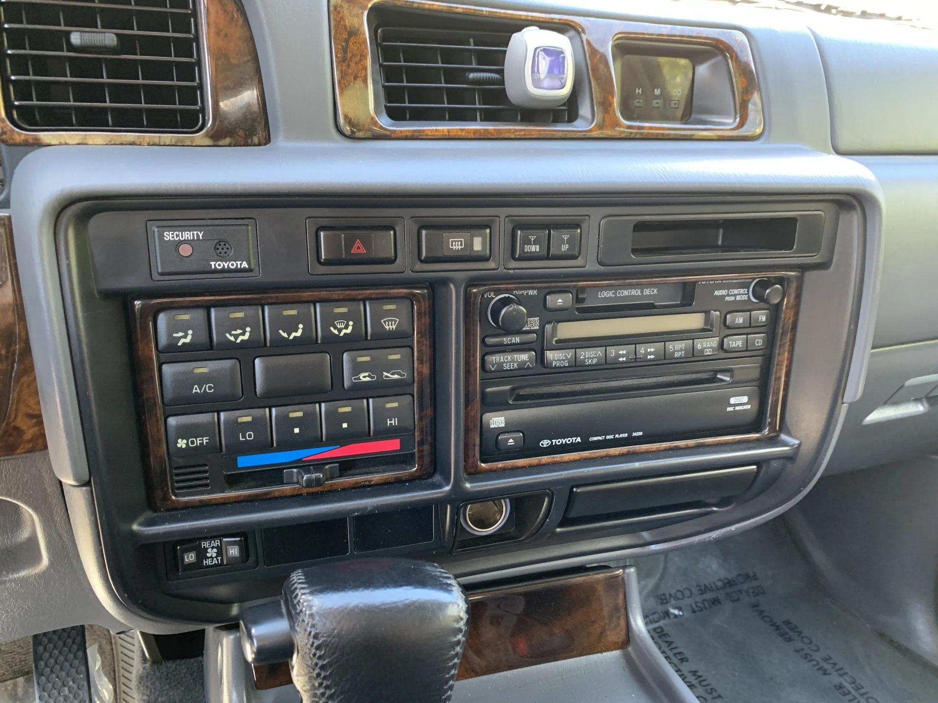

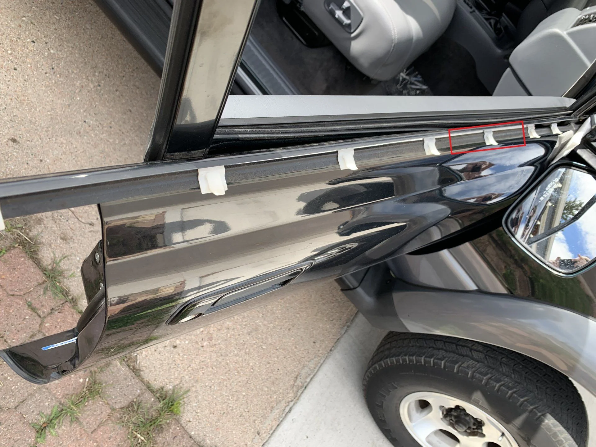

Removed the PITA wood trim, installed LED parking lights, changed oil and front diff oil today - I have a front diff leak because my torque wrench was broken and I sheered a stud off the cover like an idiot. Just keeping it topped off for a couple weeks until Slee does all my diff work.

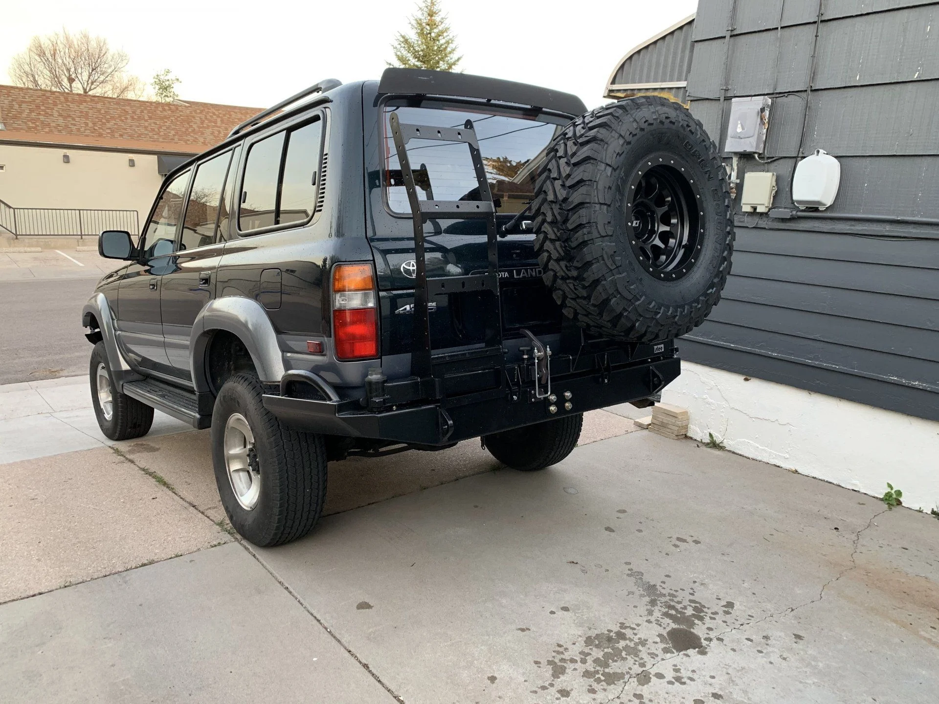

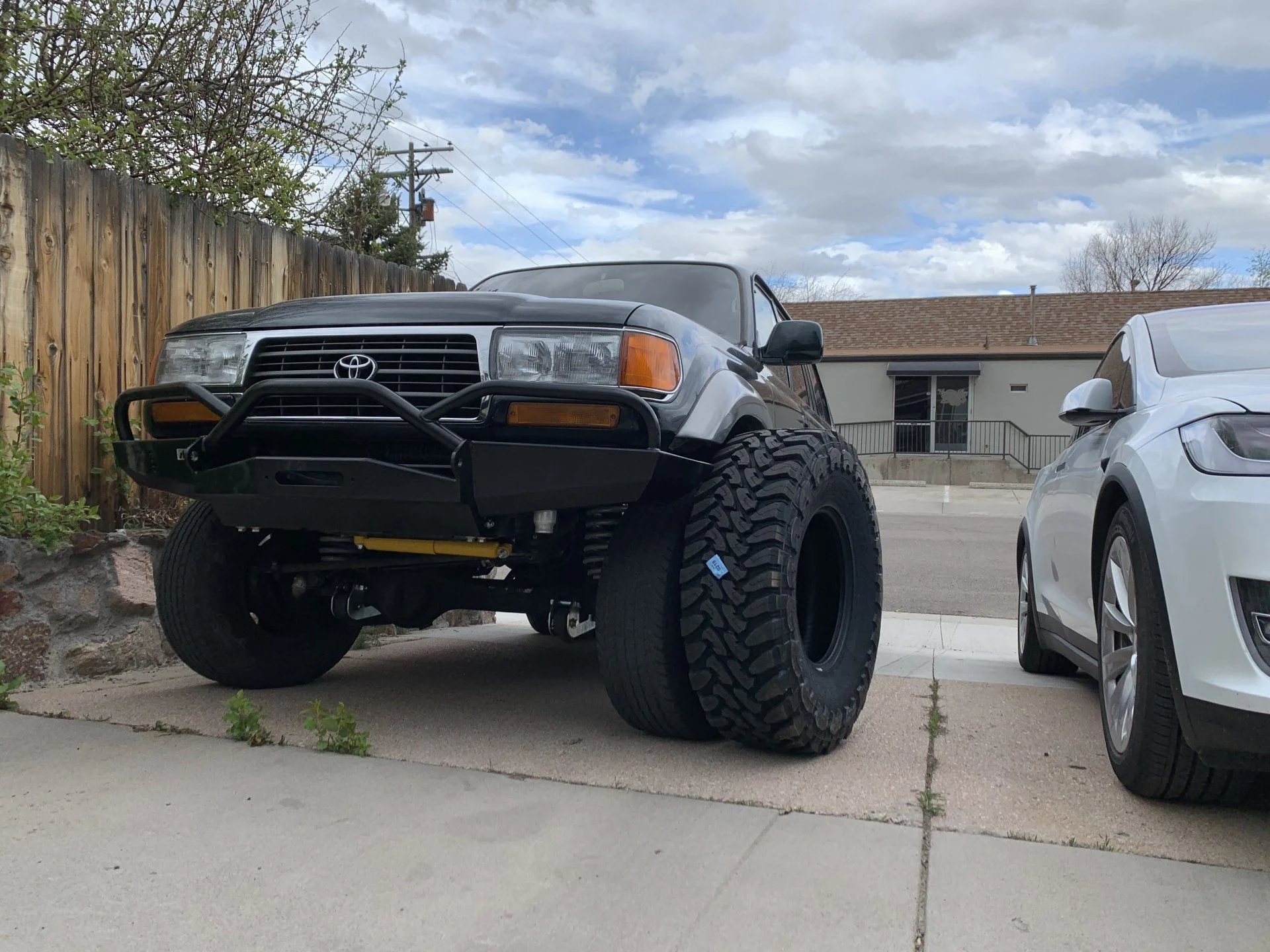

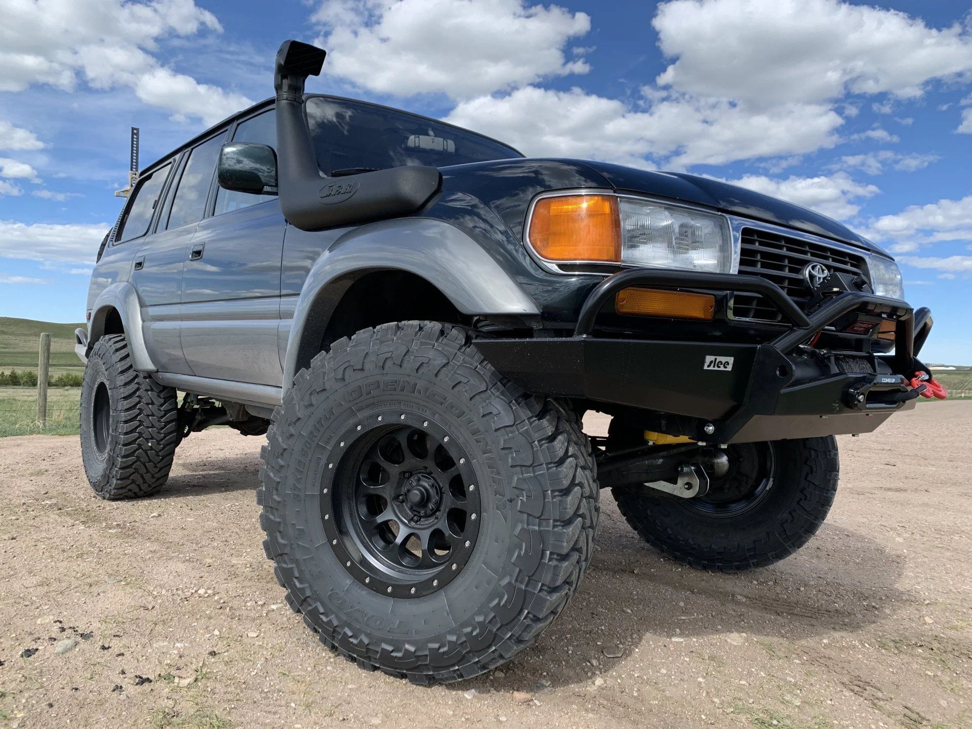

Today was a nightmare of a brainfart day! Got my rims which was a good start until some kid at Discount scuffed up two of them on the balancer :bang::bang:. Discount promised to buy two new rims because of it - however SCS is always out of damn stock. After that I tried to bore out the hubs myself (SCS wheels have a flange to hold the caps which need bored for our hubs) which was nothing but a struggle. Started with a 105mm arbored hole saw and moved to a die grinder after breaking more tools. It took all day to finish one wheel - the rest are going to a machine shop to hit the lathe! This means I need to unmount and mount...again!
Anyways, here's a goofy pic of stock donuts and the one wheel I finished while the others get lathed tomorrow morning. Pretty fun lifting that on to the arm!
