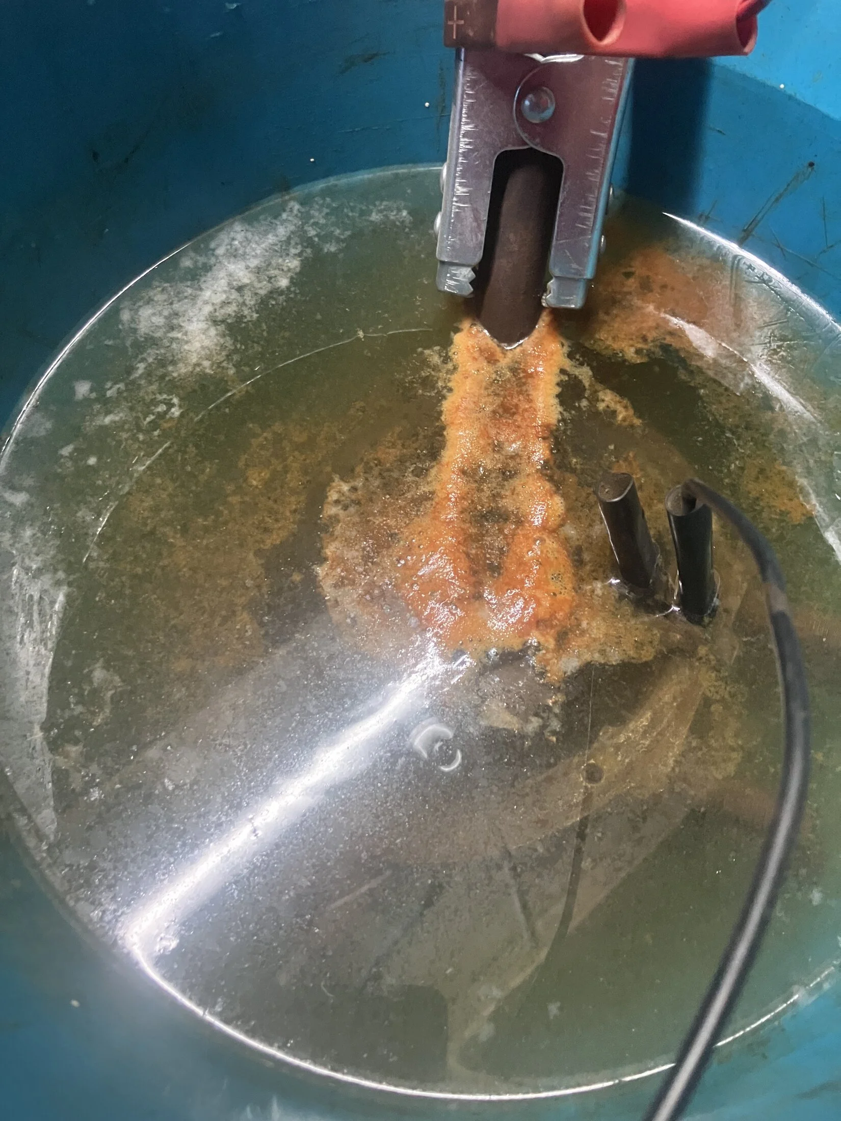

So it wasn’t that spectacular tbh….not sure what I was expecting, but certainly a great deal of rust got “ transferred to the sac cath.
I use this kind of setup all the time.
Very satisfying to see the rust go away.
I use washing powder as electrolyte and an old desktop power supply, controlling the current by the amount of powder added, but only allow about 4 to 6 amps as I usually leave it over night and it makes me sleep better...
Degreasing before the process, works better.
Good luck

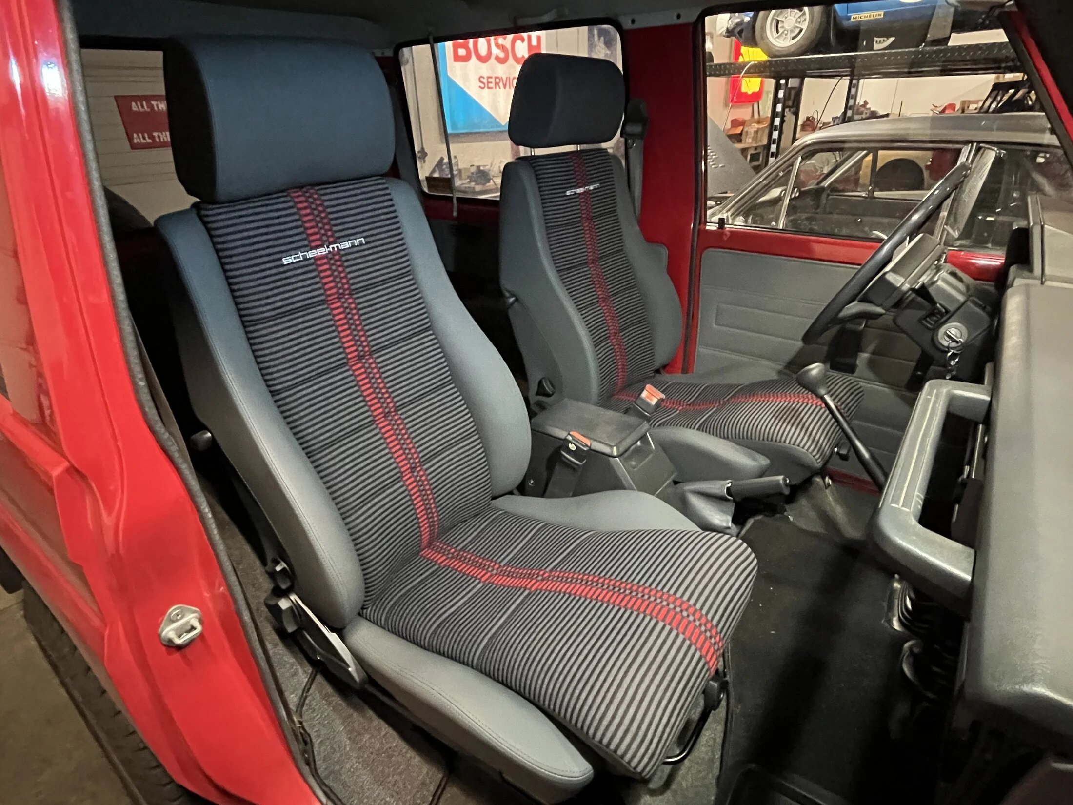

Today I did the preliminary seat fitment with my custom scheel-mann seats. These are the Vario F XXL Klima. I’m really happy with how the upholstery came out! I installed them using the Planted bracket, and gained a little headroom and a nice bit of extra legroom as well.
I didn’t fit the armrests yet, or hook up the wiring for the active ventilation and seat heat. They will be coming be coming back out one more time so that I can run wiring from my new 24V->12V converter under the carpet to the seats. I also think if I modify the Planted bracket slightly, I’ll be able to fit dual armrests! 😎
Is that an A110 1600 up on the shelf? One of my all time favorites.
oooo integrated headlight covers

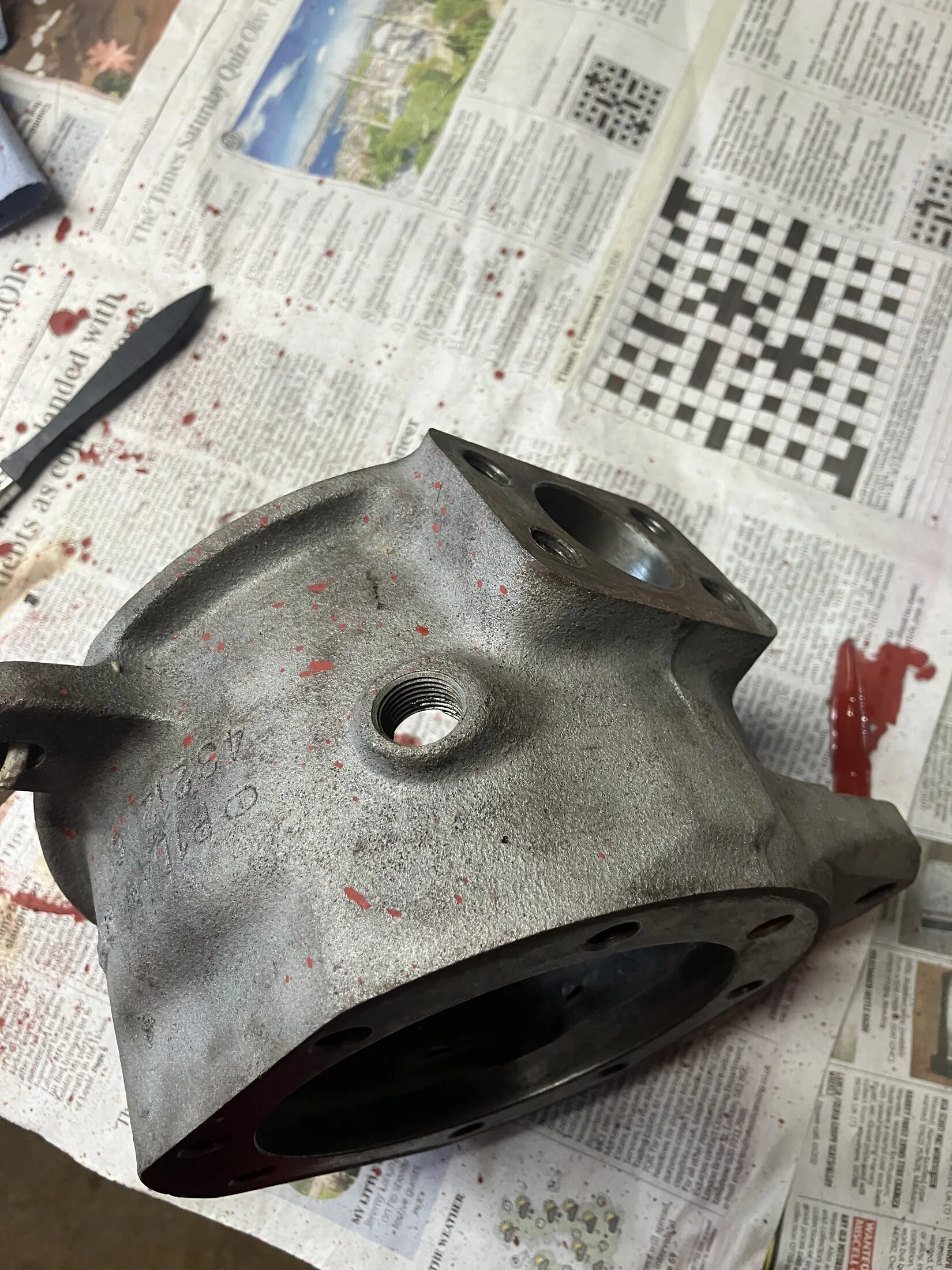

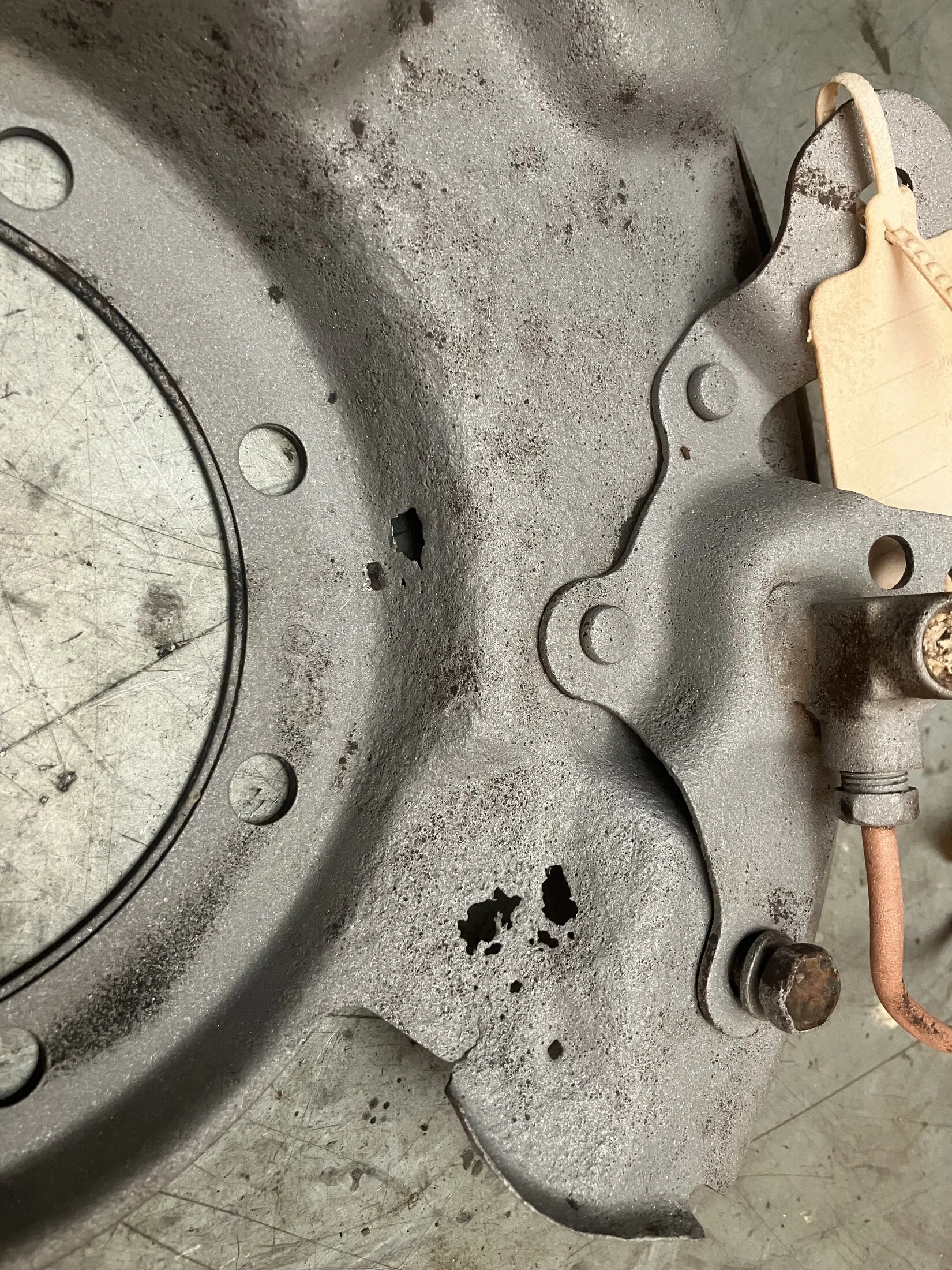

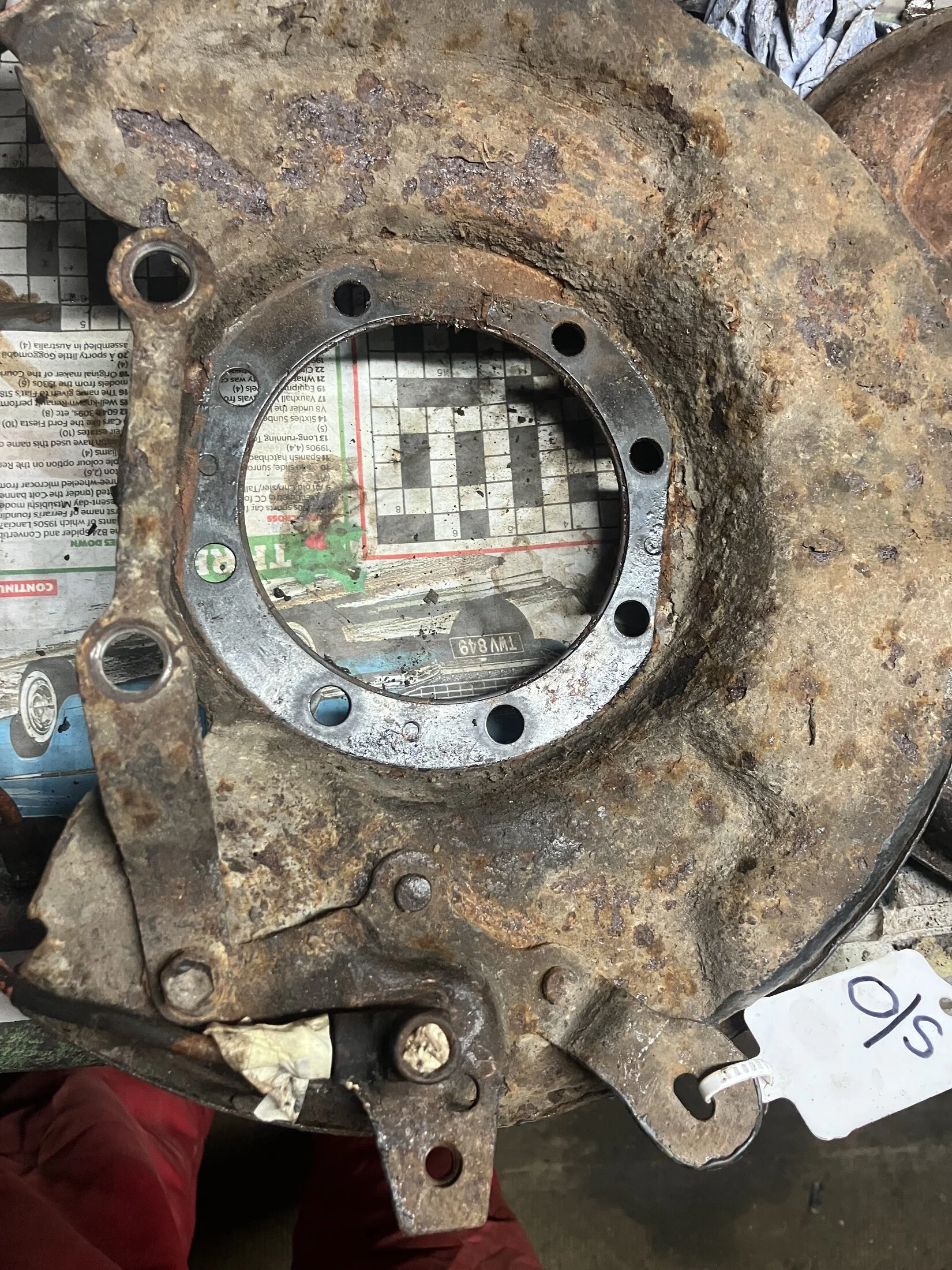

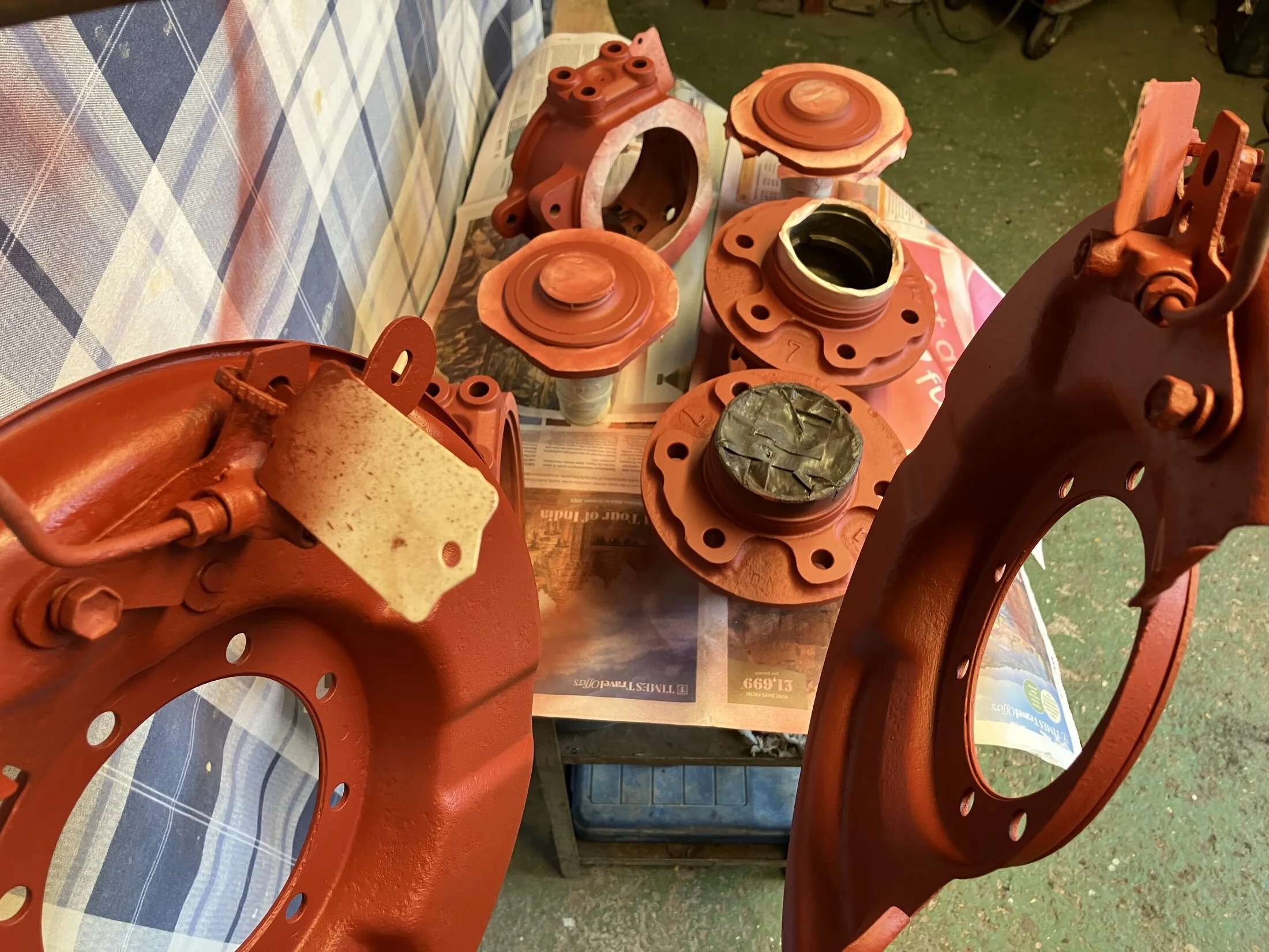

Sandblast,repair/ primer on front swivels and brake dust guards which I understand are not available.

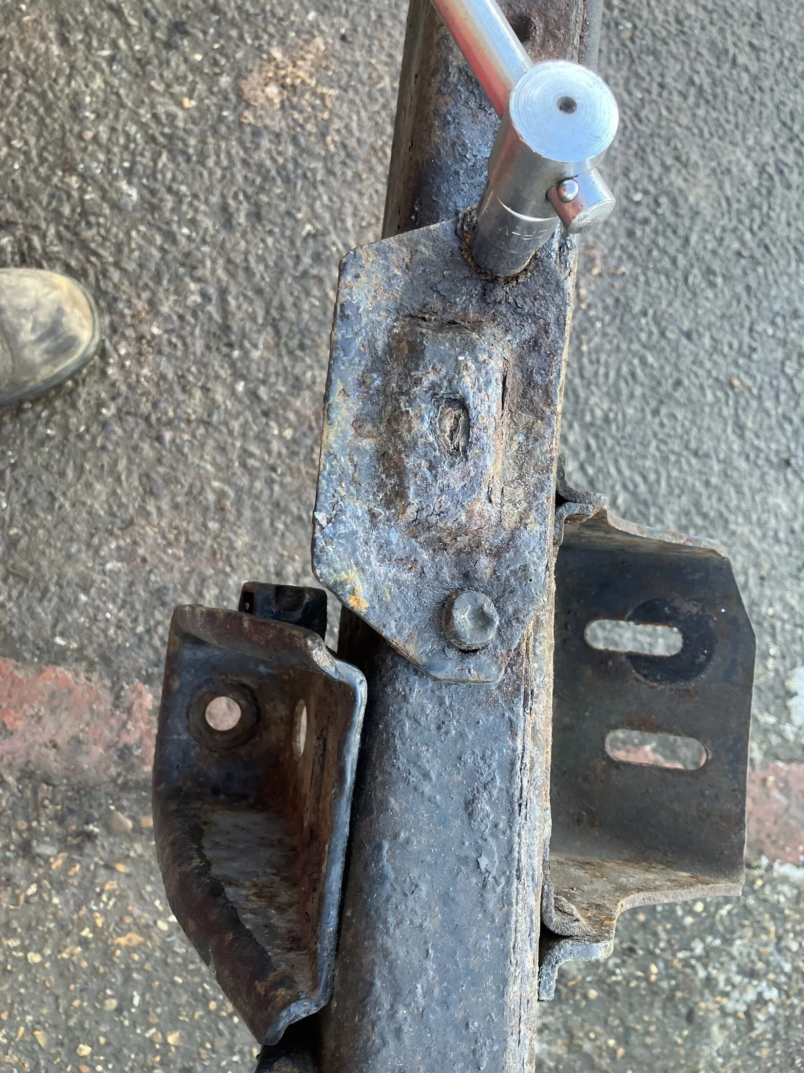

Front bump stop plate removal, rubber parts must be still in W.Australia!

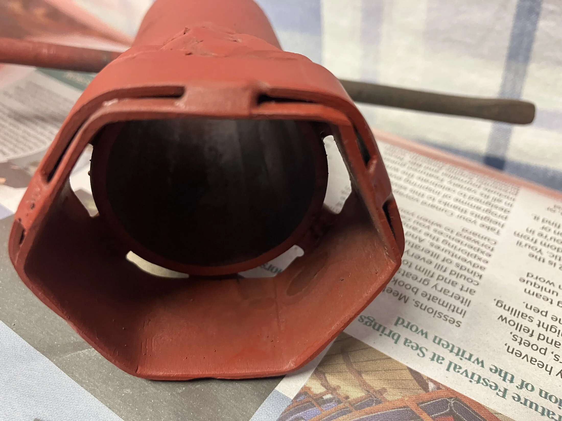

And I made a box spanner, as I was so horrified on how the nuts had been adjusted by previous hammer and cold chisel😳🙄.
Nice save. I have actually had good luck using epoxy repair putty (JB Weld) on holes that reveal themselves after blasting. At least on parts like the dust shield that really don't see abuse other than weather. A piece of tape for a backer and patch away. As long as they are painted up well afterwards it will be a long term fix.
