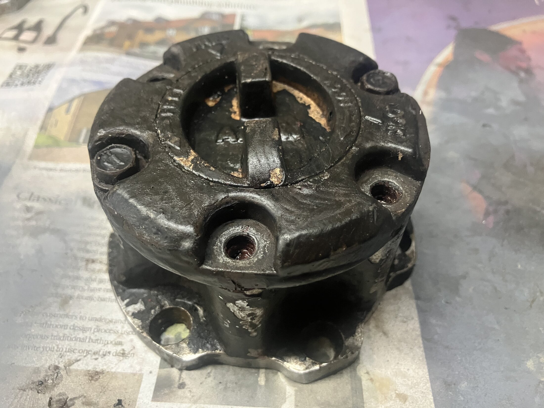

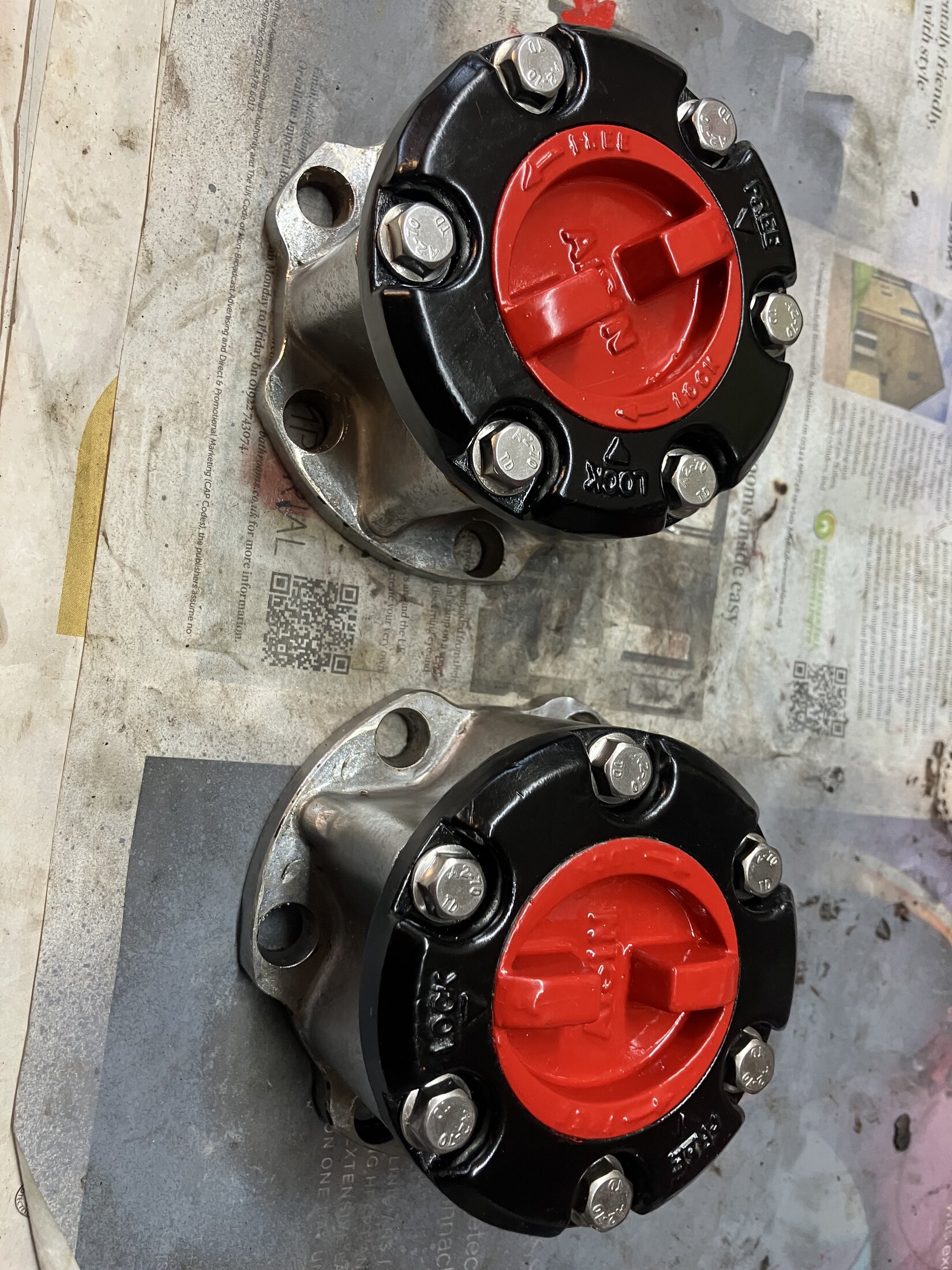

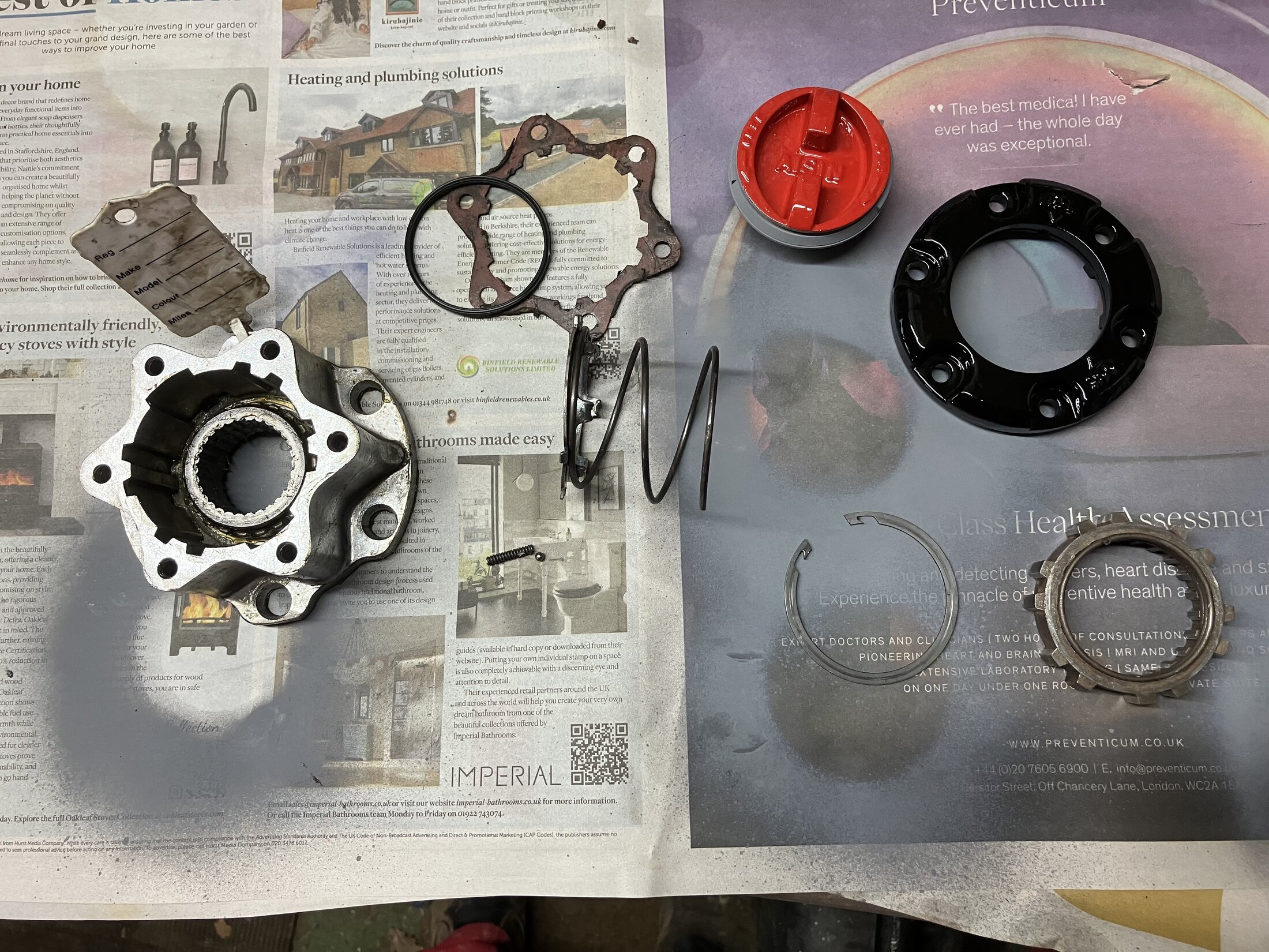

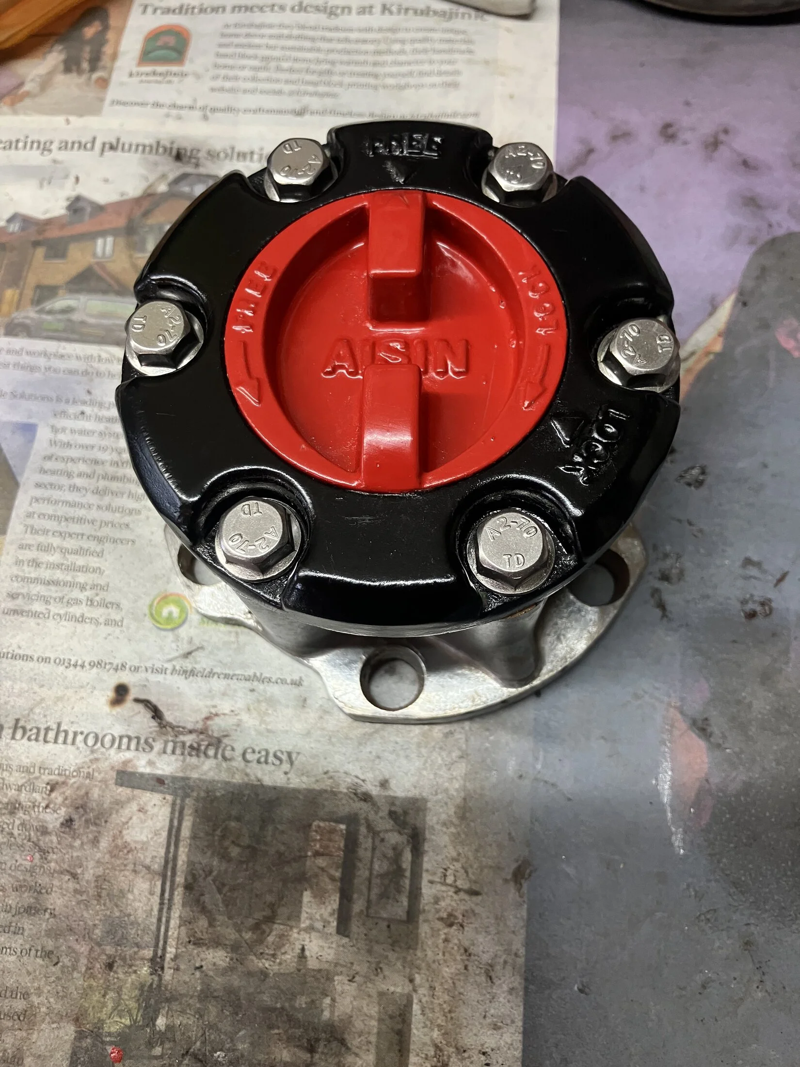

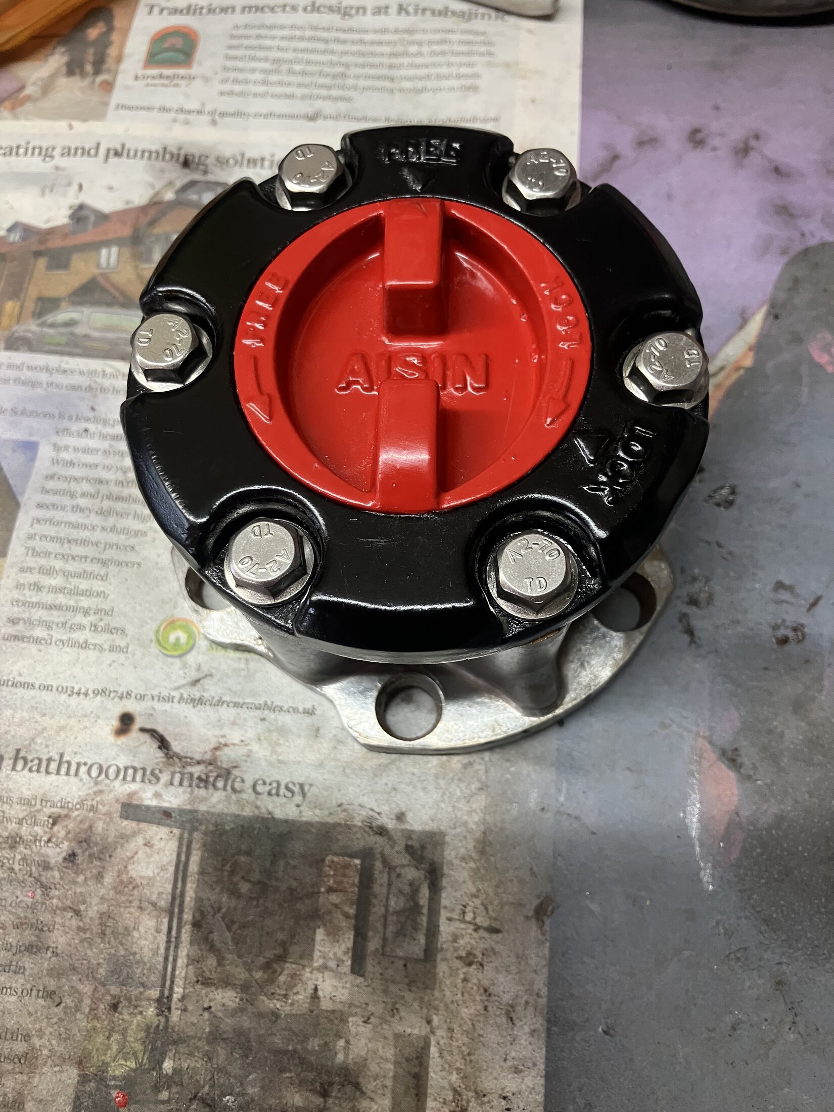

Was going to buy new ones, but after a full strip down, sand blast and repaint. (prefer red to the bronze turn buckle). Ready for fitting as and when.
Looks great! What paint did you use?Was going to buy new ones, but after a full strip down, sand blast and repaint. (prefer red to the bronze turn buckle). Ready for fitting as and when.
They look great! Nice job!Was going to buy new ones, but after a full strip down, sand blast and repaint. (prefer red to the bronze turn buckle). Ready for fitting as and when.
I had drive hubs on my 89 bj73 and swapped generic aisin style hubs off eBay($50 a pair new) they have worked fine with heavy use.Sorry if this is a dumb question, I have fixed hubs on my 75, can I swap in the aisin locking hubs directly or do I need different axle shafts?
I did this on mine. Same axle shafts. Check my build threadSorry if this is a dumb question, I have fixed hubs on my 75, can I swap in the aisin locking hubs directly or do I need different axle shafts?
2K paint for the red, and some ordinary black gloss spray. I did however use some etch primer as a base.Looks great! What paint did you use?
When looking for alternate part #s sources, get the factory and alternate part #s from searching diagrams on partsouq.com then go to Google and you will likely see the part from different sources and for different vehicles.I did this on mine. Same axle shafts. Check my build thread

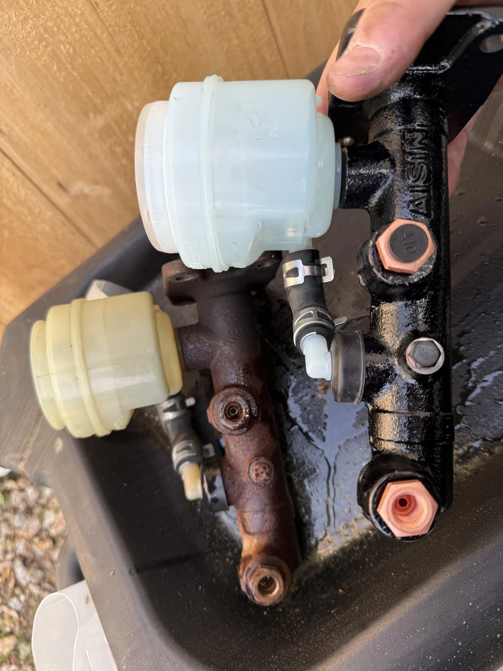

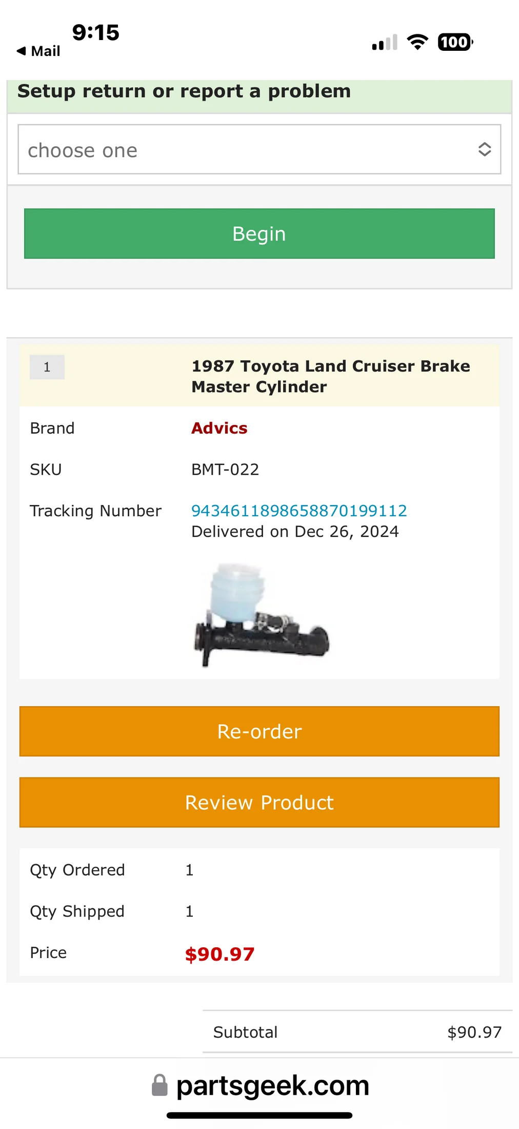

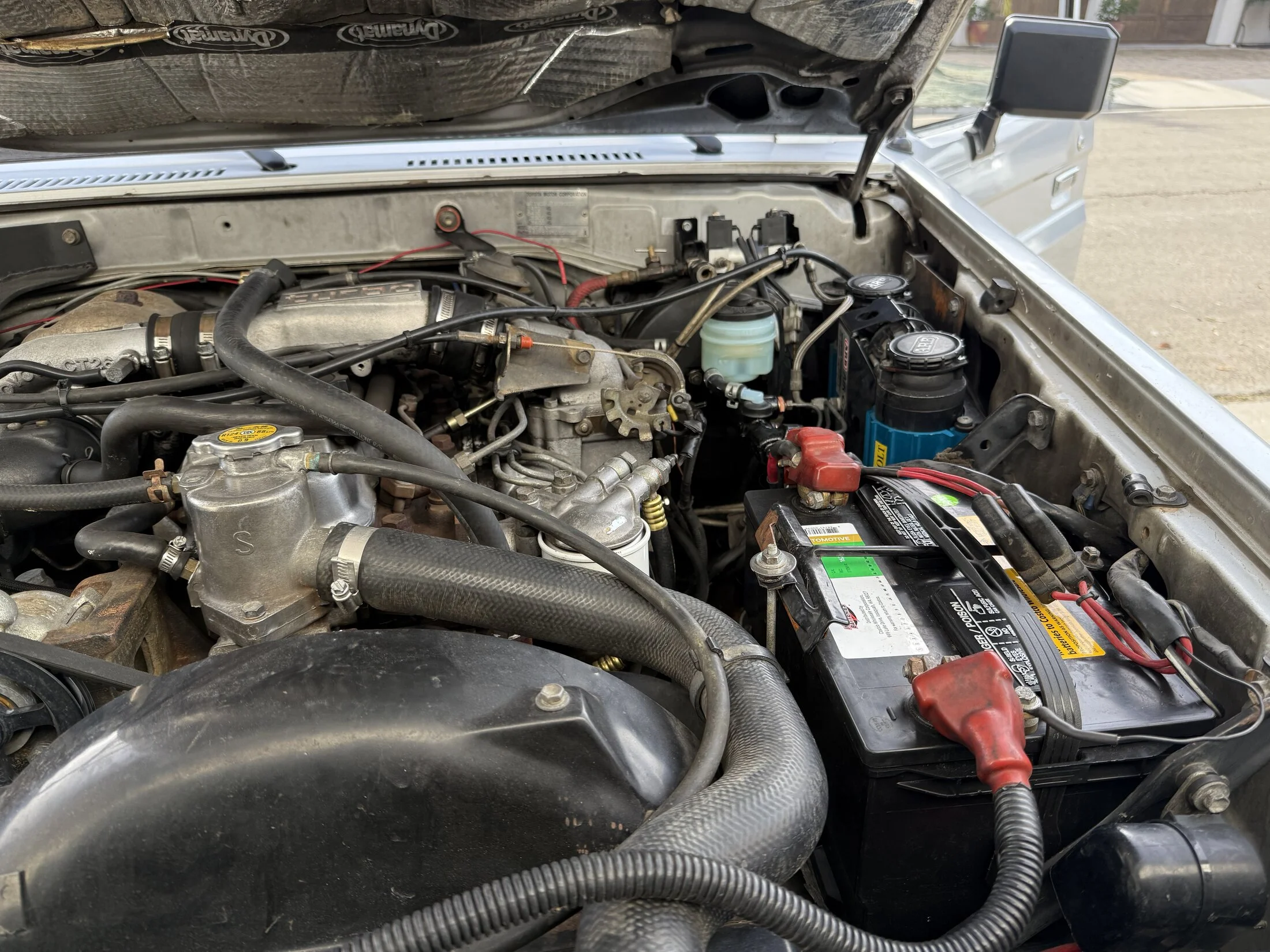

PartsGeek part number?New brake Master Cylinder. Parts geek had this one for the 70 series and it was $92! Has Aisan cast into it… Brakes are sooo much better now. Old master was sticking and fluid was old and contaminated.
