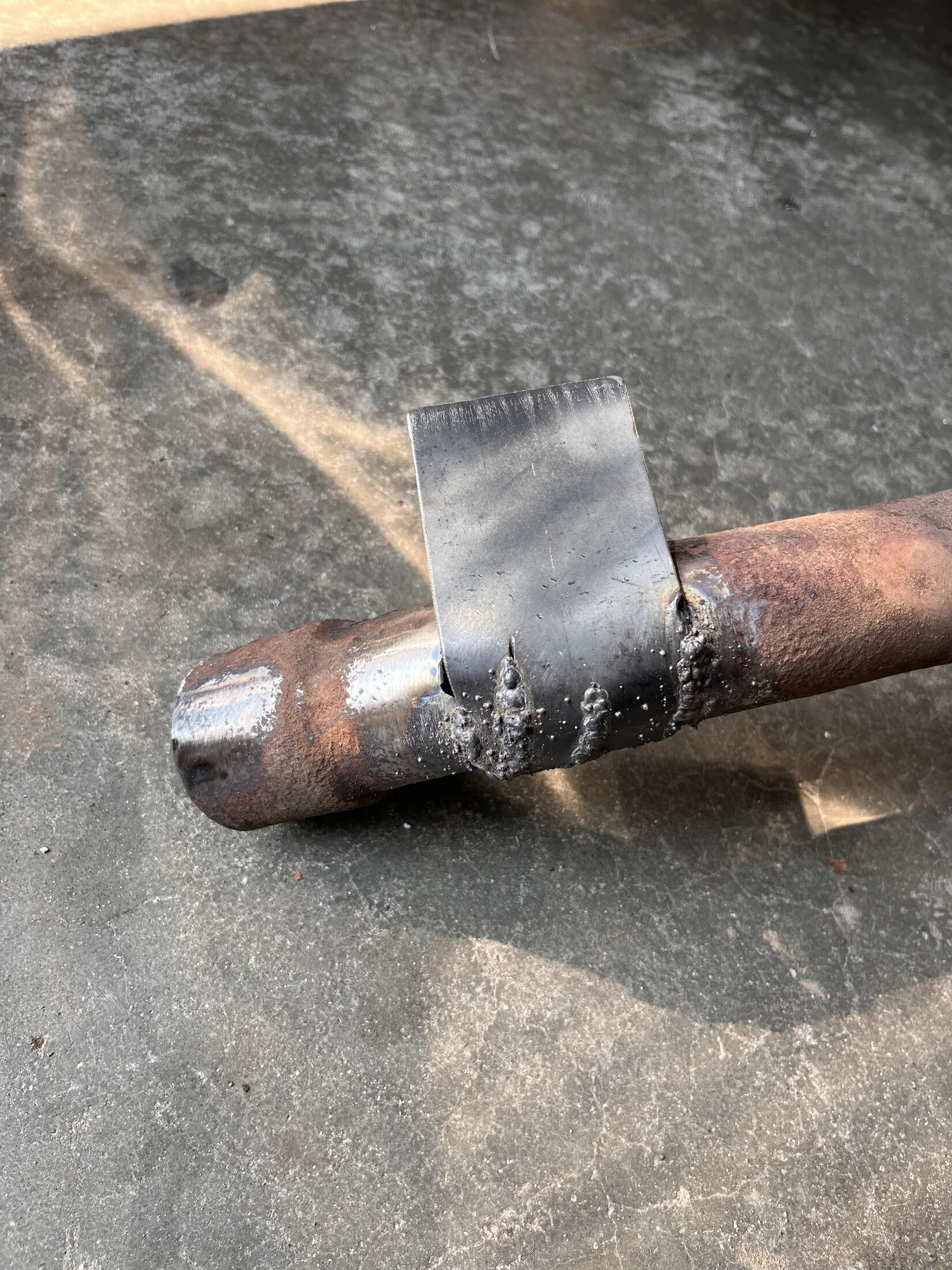

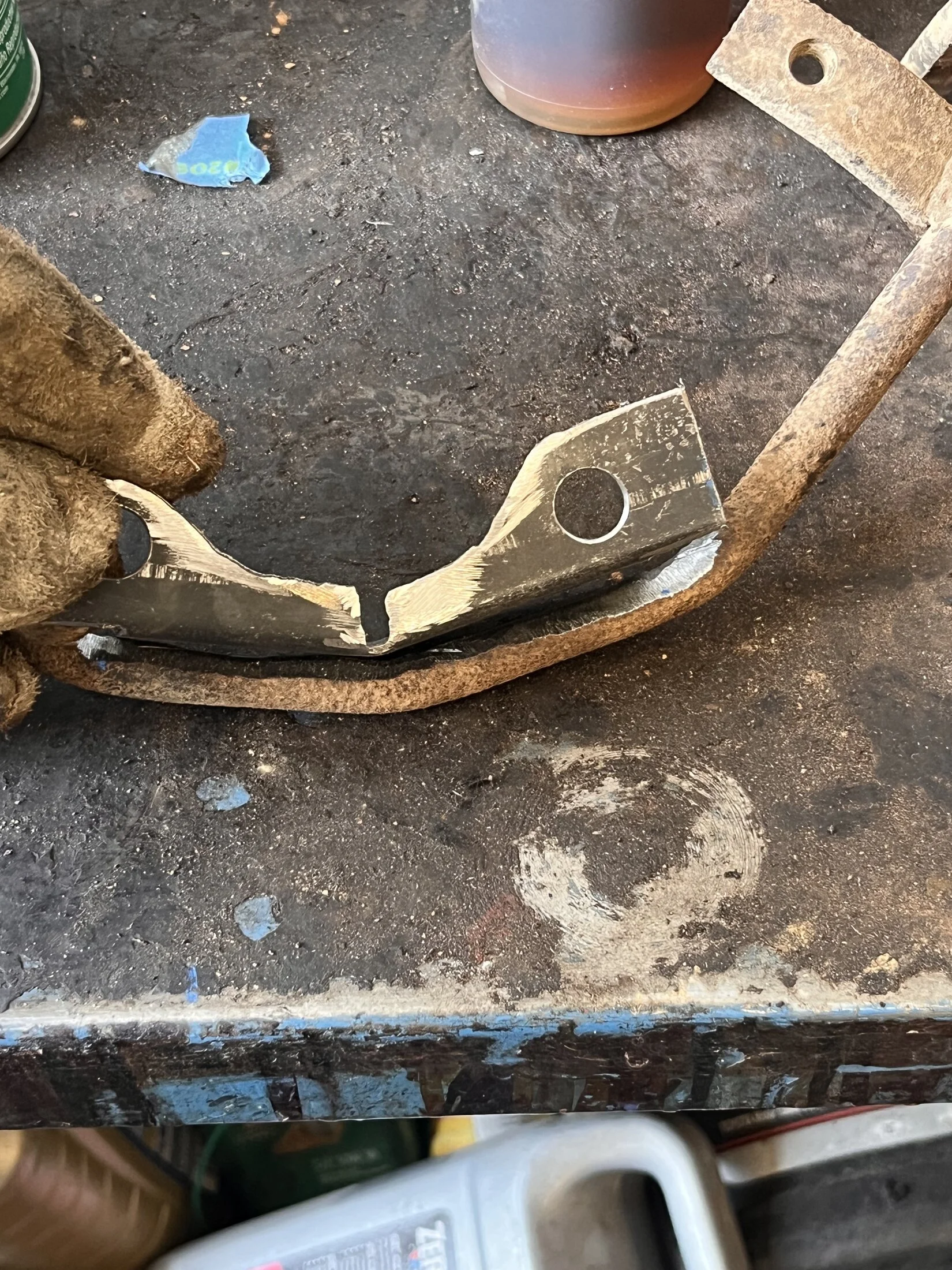

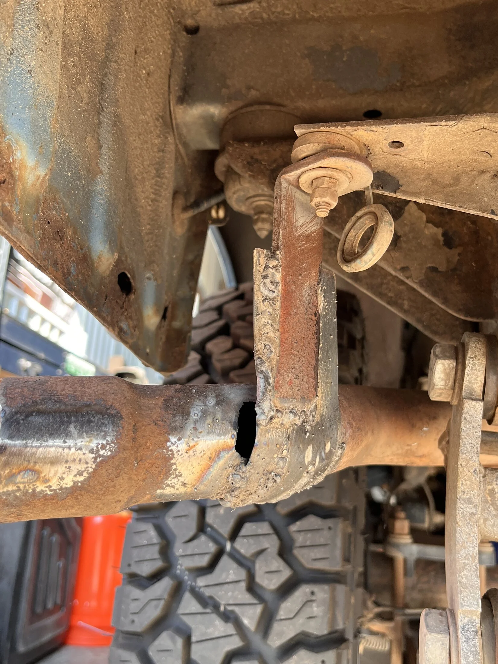

Well, I took a closer look at my exhaust situation today, then spent the rest of the day fabbing & welding. The whole thing was about ready to fall off. Not perfect - I’m still missing two exhaust mounting points - but it works. My welds are definitely farmer quality.
This piece had cracked. Made some junk and welded it together.

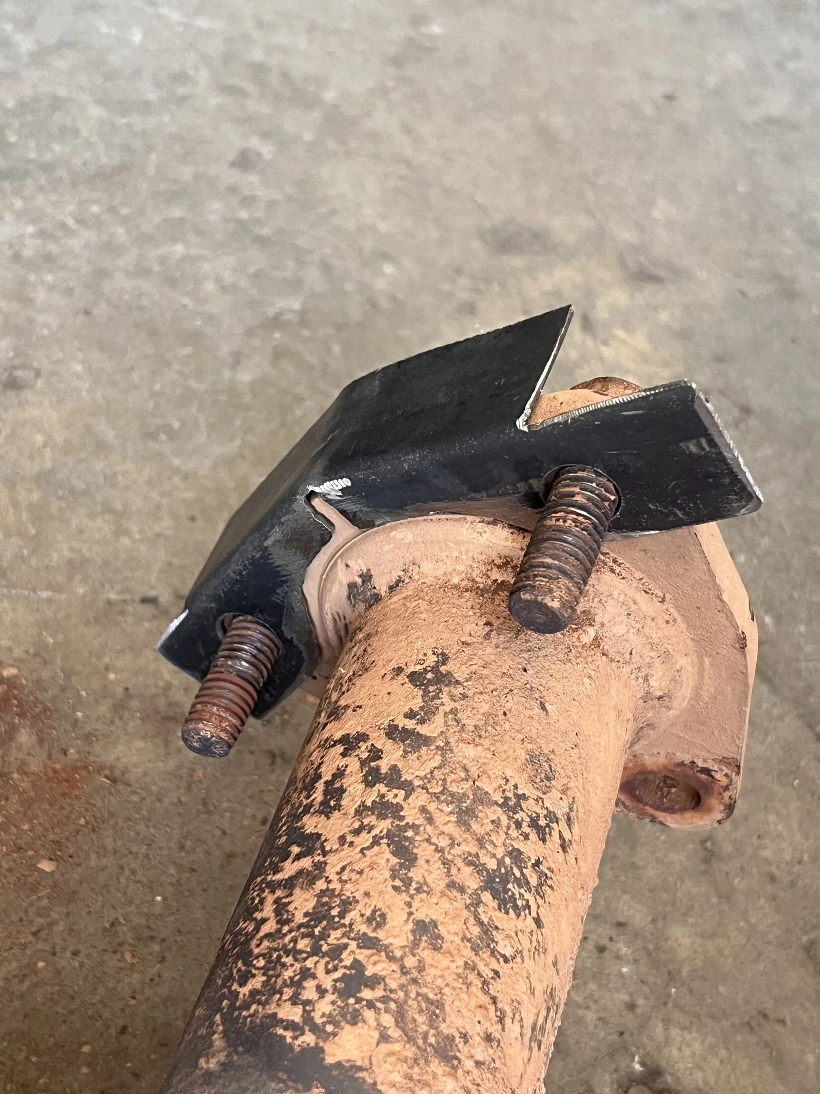

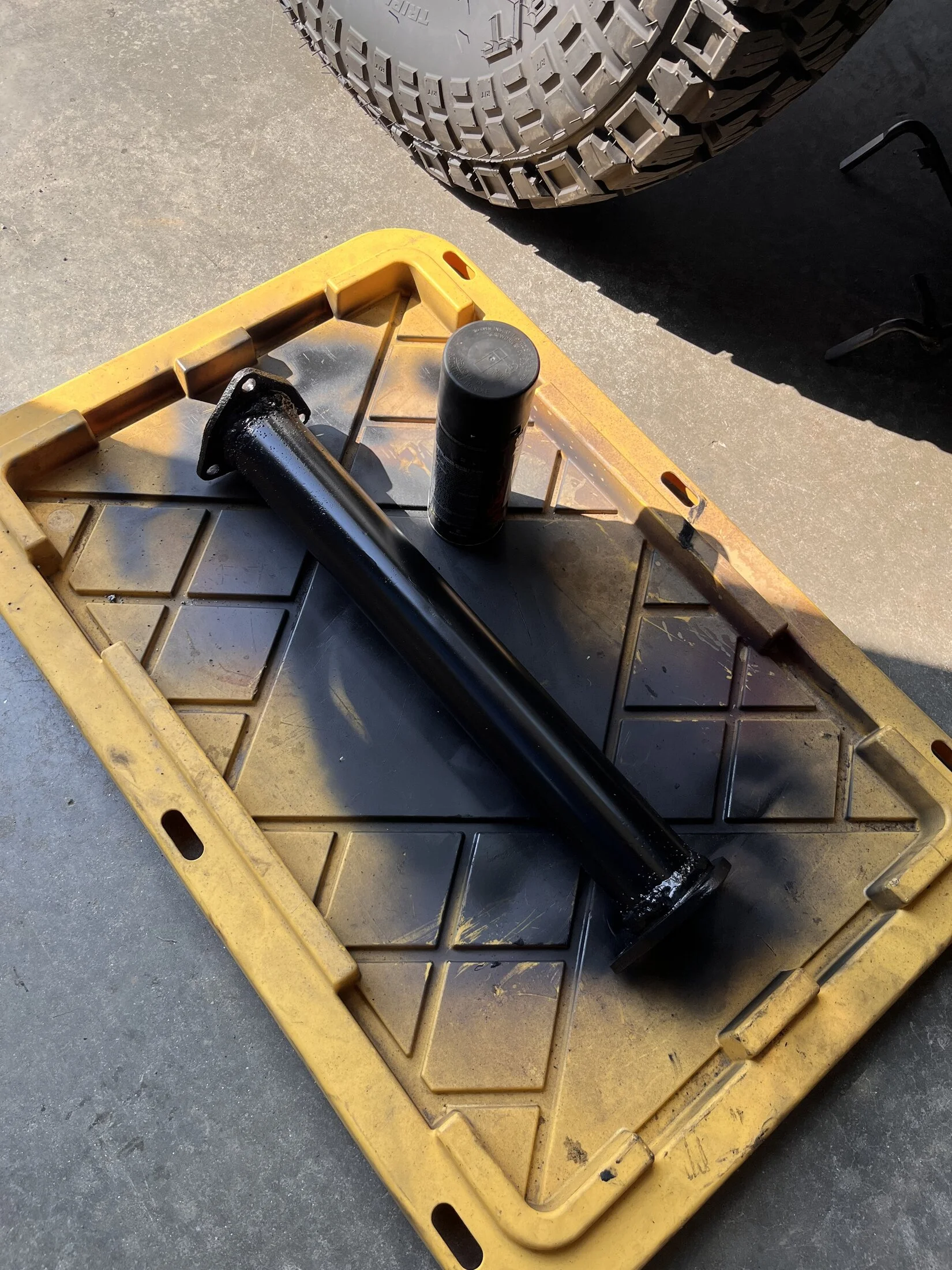

Closed up some holes in the test pipe I made last year using tube and some spare flanges from a bad catalytic converter. I’m still unsure about things, so the cat remains on the shelf while I keep testing haha.
Went from this
To this
By doing this

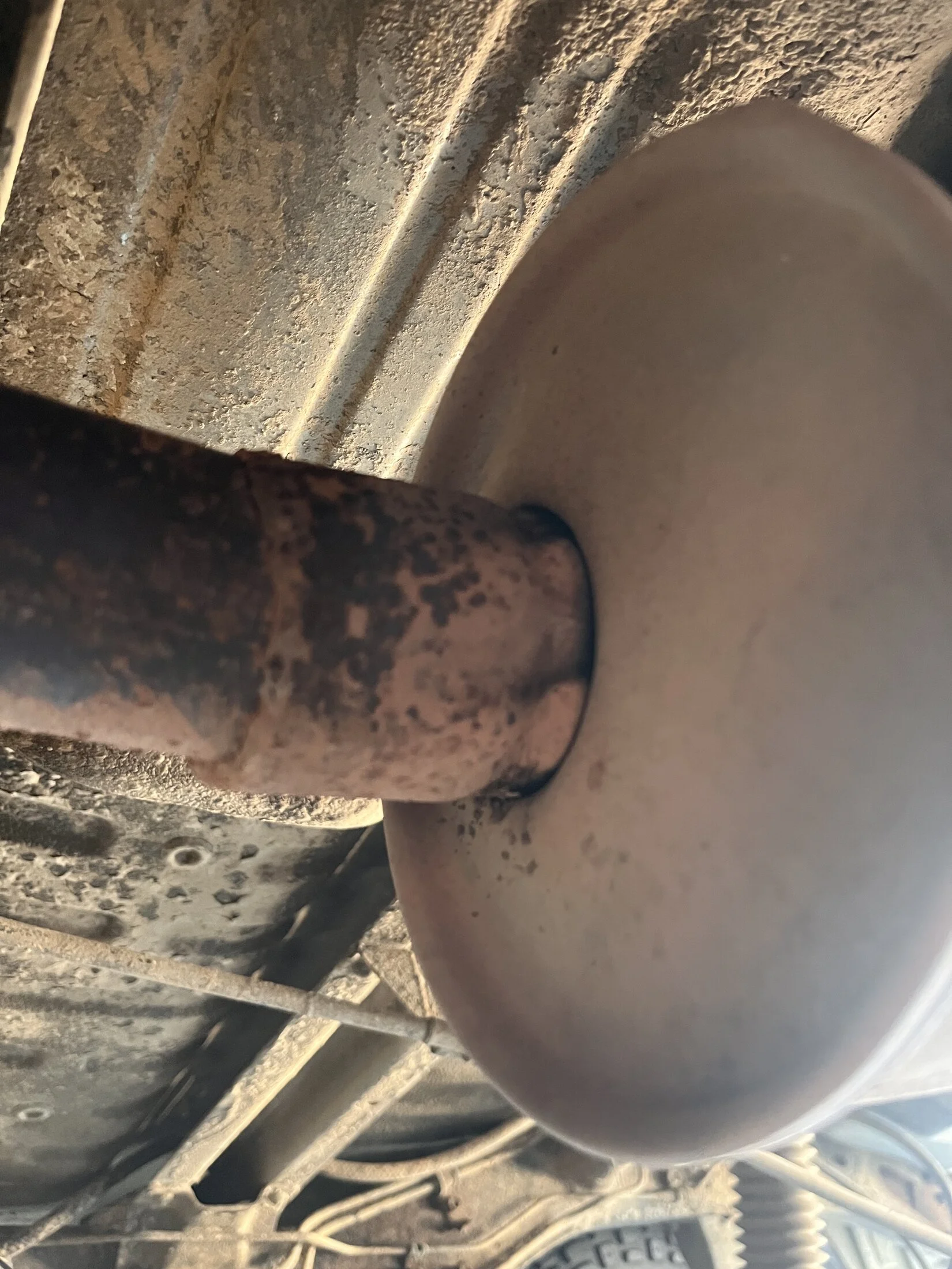

I also noticed leakage where the pipe enters the muffler so I sealed that up.
My welds are such garbage. I need to get some gas so I can stop running flux core … and then practice. Hey, it’s exhaust, it’s gonna work. The truck is quieter than it’s ever been so that’s great.
I still need to get the bellhousing hanger, the hanger before the cat area, and a new bushing where the muffler hangs. The latter is separated, but working by gravity. Good enough to get down the road for now, but one day I should rebuild the whole exhaust.

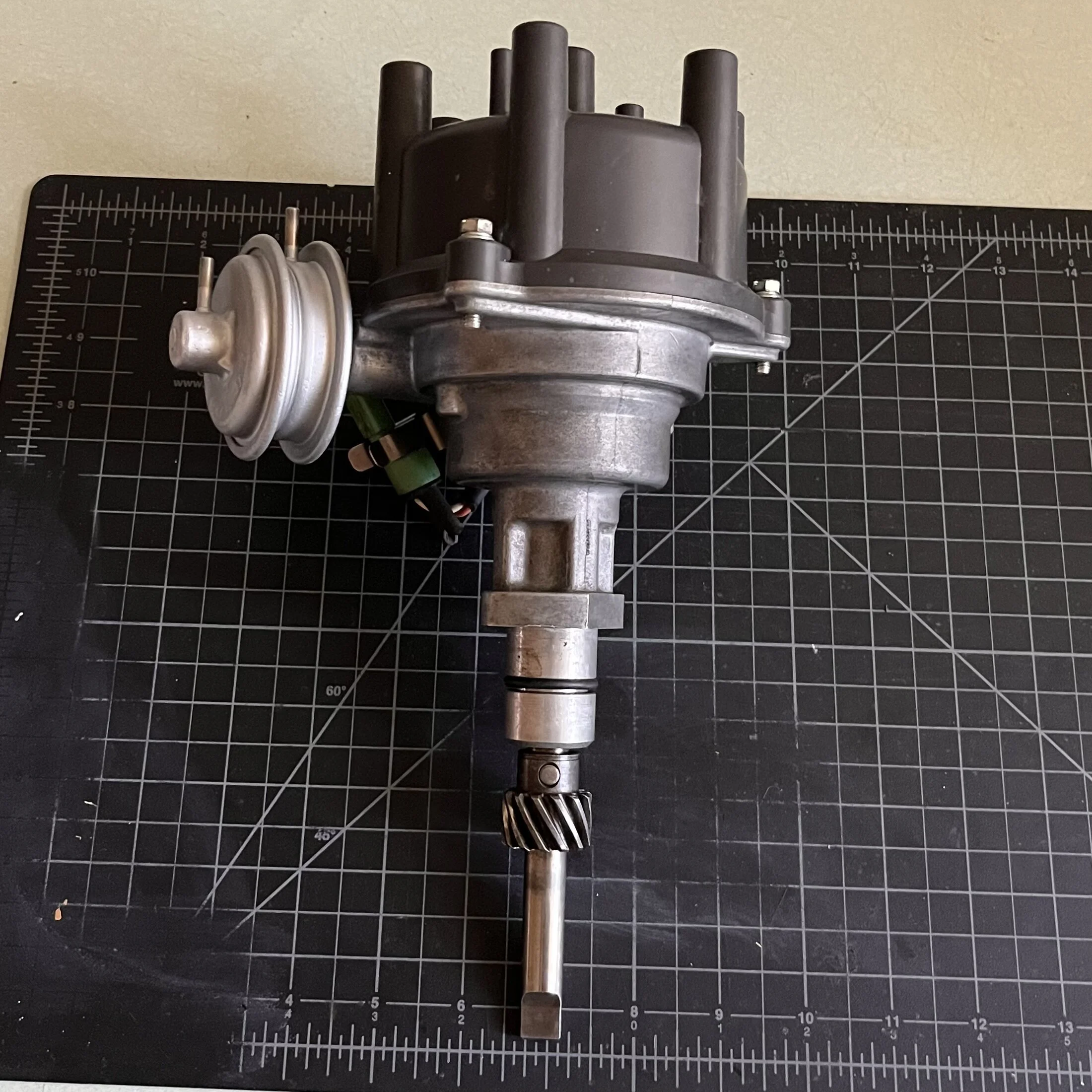

In other news, I got a box in the mail today:

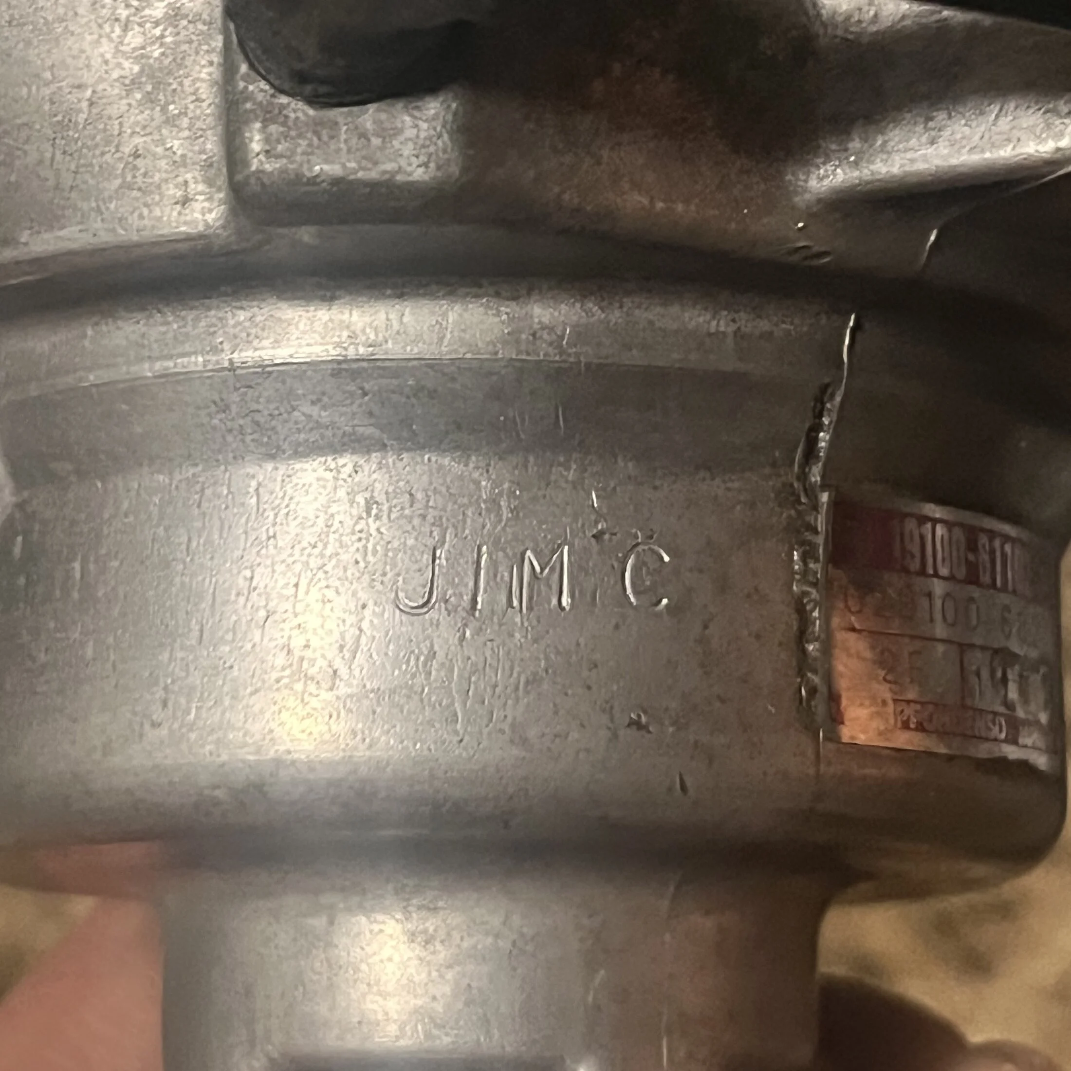

Cleaned, serviced, and non-EGR curved dizzy from Mr. Chenoweth. To say the process took a while is an understatement … but it’s here. I’ll probably drop it in tomorrow after the diff is done.
I marked it so it doesn’t get mixed up with some of the other dizzies I have laying around.

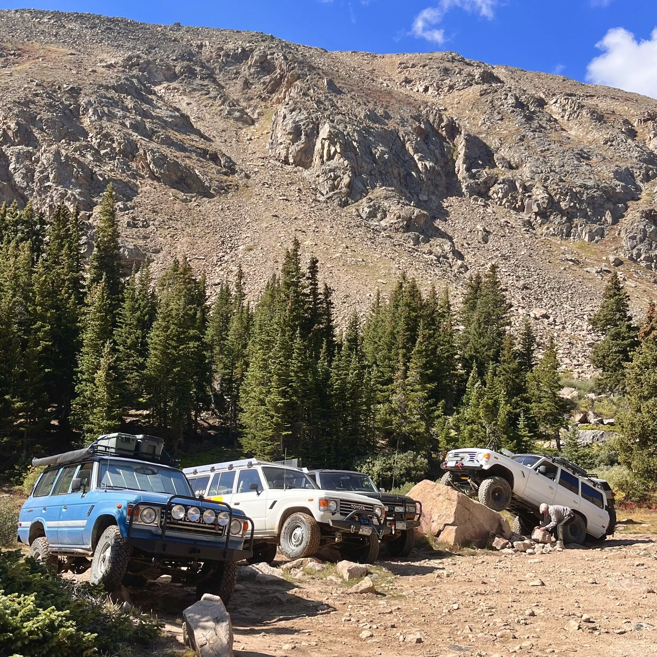

Yesterday I led the inaugural 60s Only Run with my local TLCA chapter, Rising Sun. Three 60s, a 62, and an 80 driven by the club’s Event Coordinator who was no doubt there to keep an eye on us hooligans.
The trail was easy-medium out-and-back and only took about 90 minutes each way. We had a nice lunch at the top by an alpine lake and bullshitted for a couple hours. On the way down two of us peeled off to camp and left the other ones to drive home - all of them had done this trail many times so they were good heading down themselves.
The new Kenda tires did fantastic Aires down to 18 front/22 rear. This trail is a lot of loose rock, so there was some sliding around, but the guy following me said I didn’t spin tires once. When the situation called for it, the 9.5 width fit between rocks nicely.

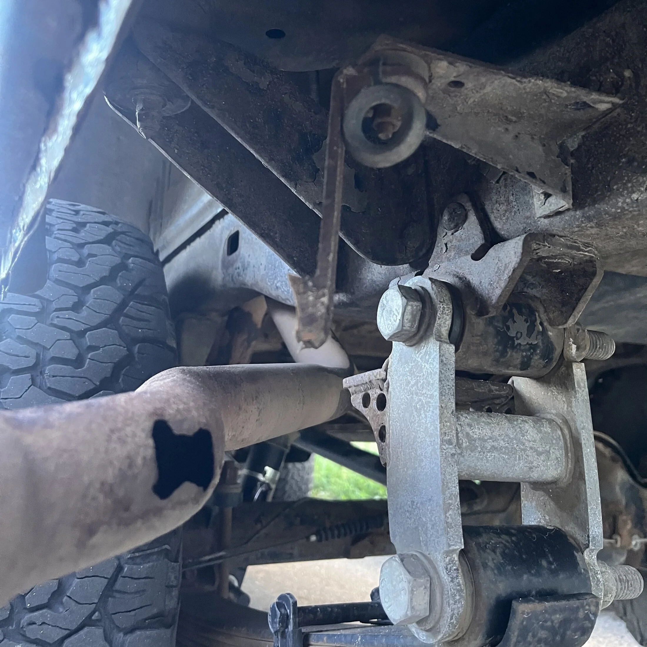

This week I also found my exhaust was hanging on by the manifold and a rubber hanger that was split in half - the latter only holding the exhaust by gravity and not a single bolt. Spent some time putting booger welds on things. I also boogered over the top of previous boogers to seal up some leaks. I need to eventually redo the entire exhaust and use all of the hangers. It held up on the trail so that’s a win.

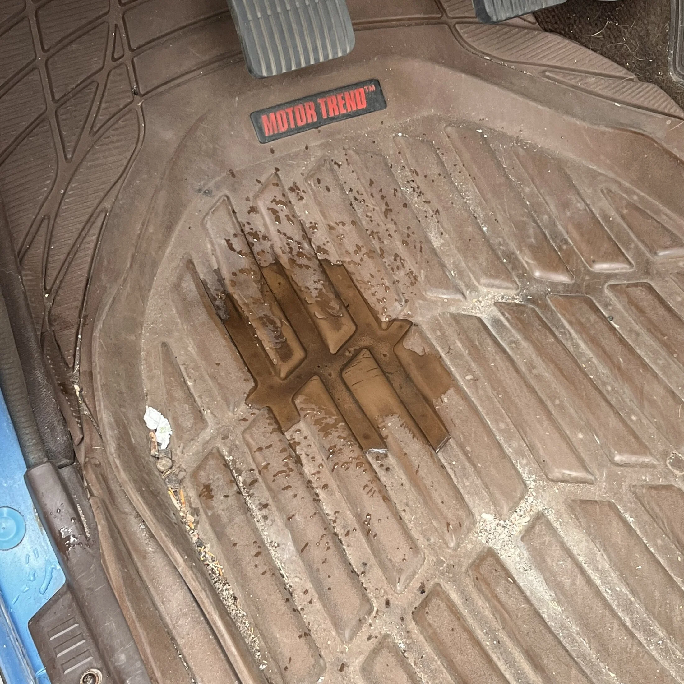

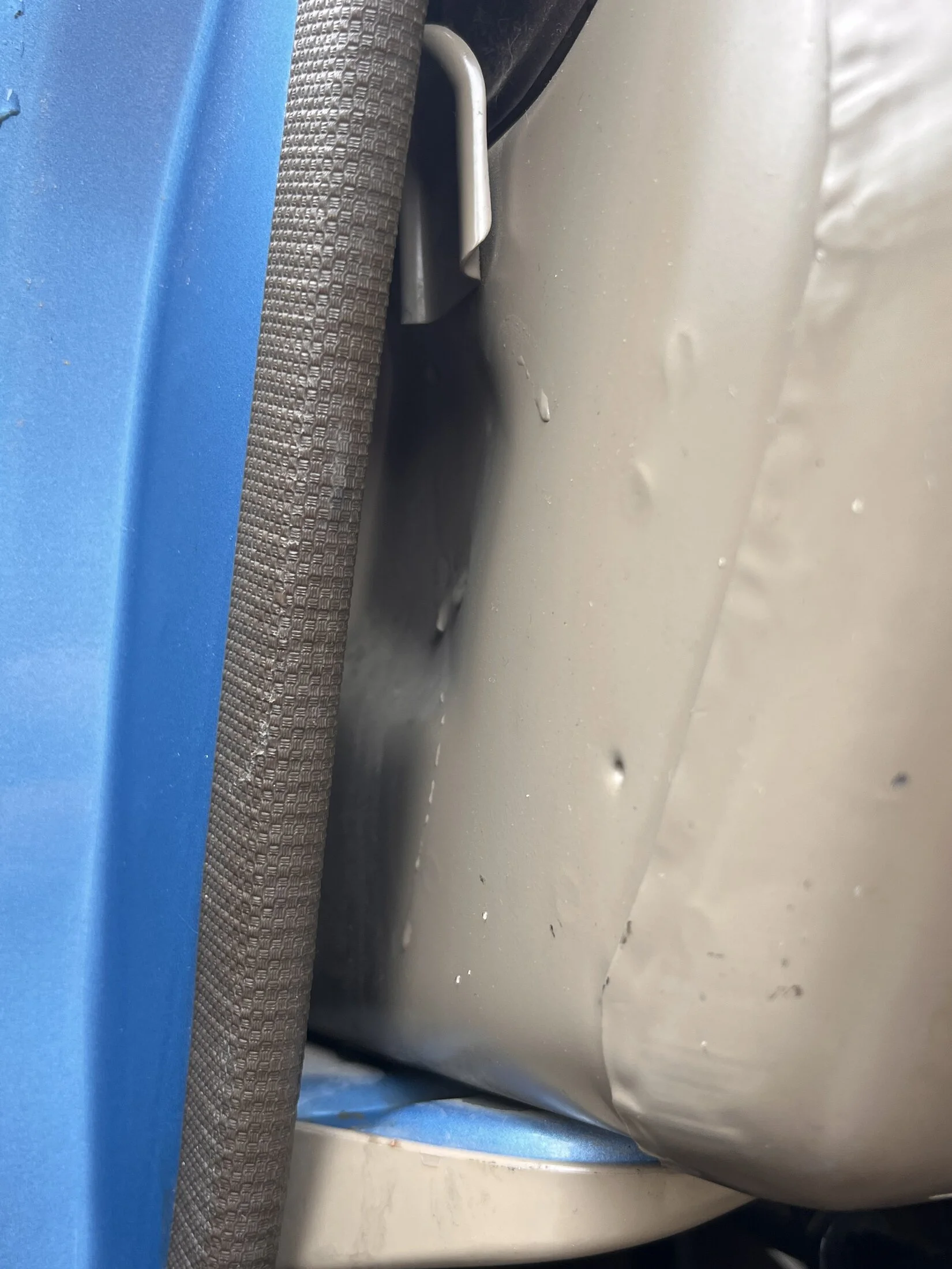

Got some rain for the first time in weeks last night. Came out to the truck and found a nice puddle on the driver side floor. It’s coming from the area behind the fuse panel door.

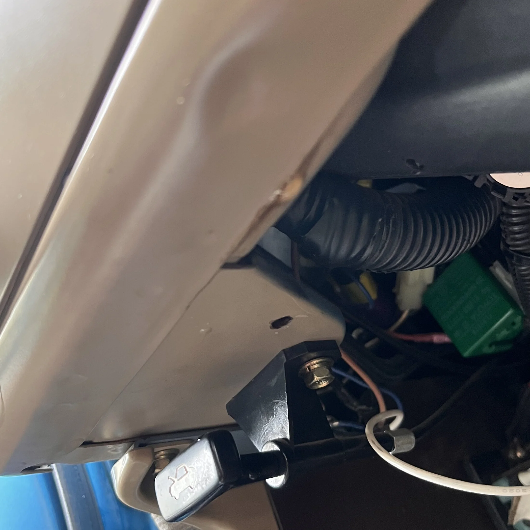

In the last photo you can see a water drop making it’s way down the side of the dash frame. I can’t for the life of me see where it’s getting in above that. Lower corner of the windshield maybe?
I’m not up up to speed on the 60 series, but the 70 is notorious for leaking at the windows seal around the bottle corners.
That’s what I’m thinking. It comes in at the bottom corner, along the inside of the body work, and then hits that attachment bracket for the dash that you see above and to the left of the water drop in my last photo.
It’s a replacement windshield and gasket that we’re on the truck when I bought it. Hasn’t leaked like this before. Bummer.
I wonder if the small crack in the windshield provides a place for water to intrude. I used the auto parts store rock chip filler all along the entire crack, but obviously I couldn’t get to the very edge of it against the weatherstripping or anything underneath. I did check the top of the windshield and weather strip and that all looks good.
