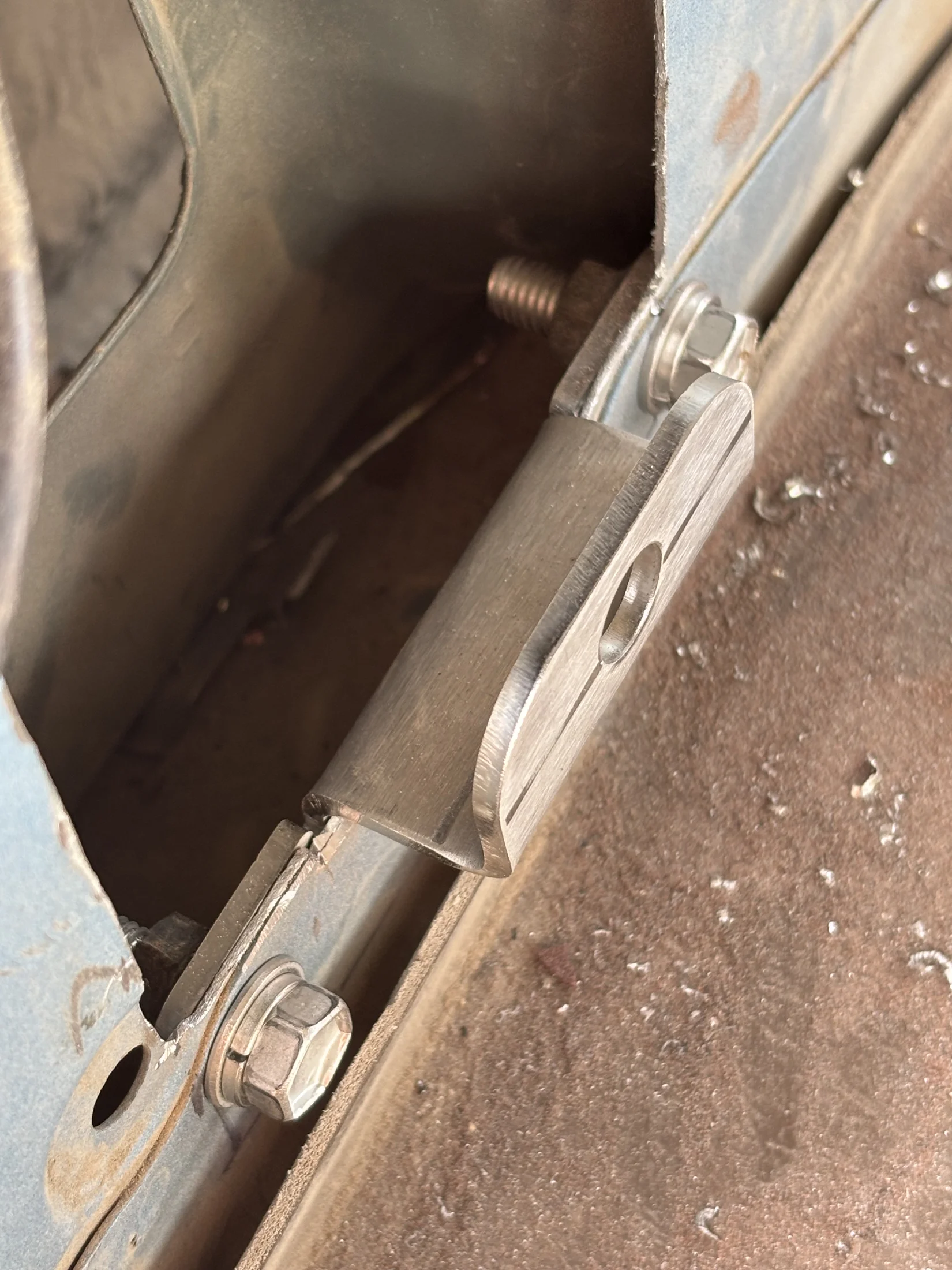

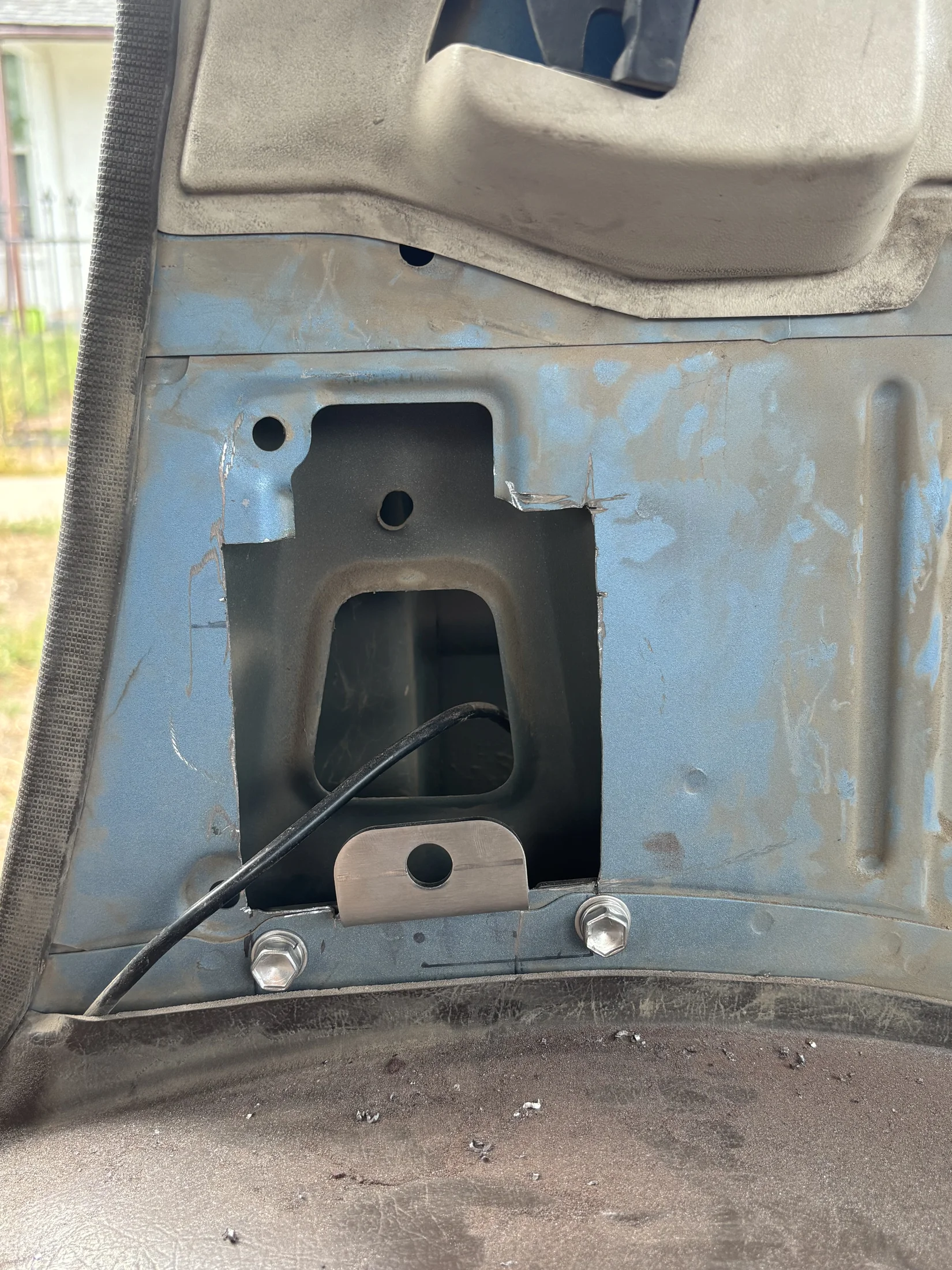

Brackets below, one for each side. I think I did 1/4” (6mm). Plenty beefy for the task.
Clearancing and bracket install. JIS hardware always. The cable is a coax feed from my dash mounted GMRS and goes up through the back hatch and onto the roof rack for an antenna. It stays out of the way after everything else as done here. Also note that there is more sheet metal further back, so access from the rear isn’t viable - more on that later. Early 60s like mine only have a wiring harness on the driver side. Later FJ60s (1985+) have part of the wiring harness passing through here on the passenger side as well, it’s split and runs on both sides. So other folks doing this might run into that.
I think I goofed up the offset measurement. I wanted the bracket to mount on the front side of the pinch weld, but it wasn’t giving me enough clearance to keep the retractor sticking out less than 30mm. I installed it this way and it wasn’t a big deal.
Retractor installed. Note that it’s “backwards”. From the way the buckle was put on it seems like SPB wants you to install the fat part of the thing towards the inside of the vehicle. Notice the webbing comes out off center - by flipping the retractor around, the body sits inside the cavity I cut open but the webbing comes out almost flush with the sheet metal. That way it’s aligned nicely as it goes up to the C-pillar thing. All of this sits 28mm out from the sheet metal (including the bolt head), just enough clearance for the cover. Installing the lock washer and nut on the back of the bolt was a chore since you can’t get to it from the back … but it’s doable.

Might be worth hitting that outside bolt with some undercoating.
That's the plan. I need to knock a little rust loose and spray a bunch of undercarriage stuff before the winter hits and I was going to roll that bolt into the process.
