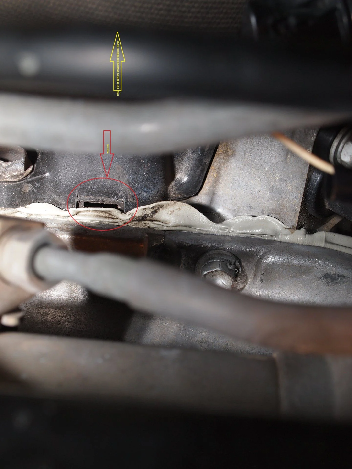

Its Toyotas recommended interval. Ive read of several here running twice the interval or more but I wouldnt go that far. 90-100-110k prob fine. It also depends on years (7??) . You can pull a cam gear cover and inspect the belt for cracks, and look underneath the HB weep hole and see if youve got any wet or dried coolant there. Make your decision from there.

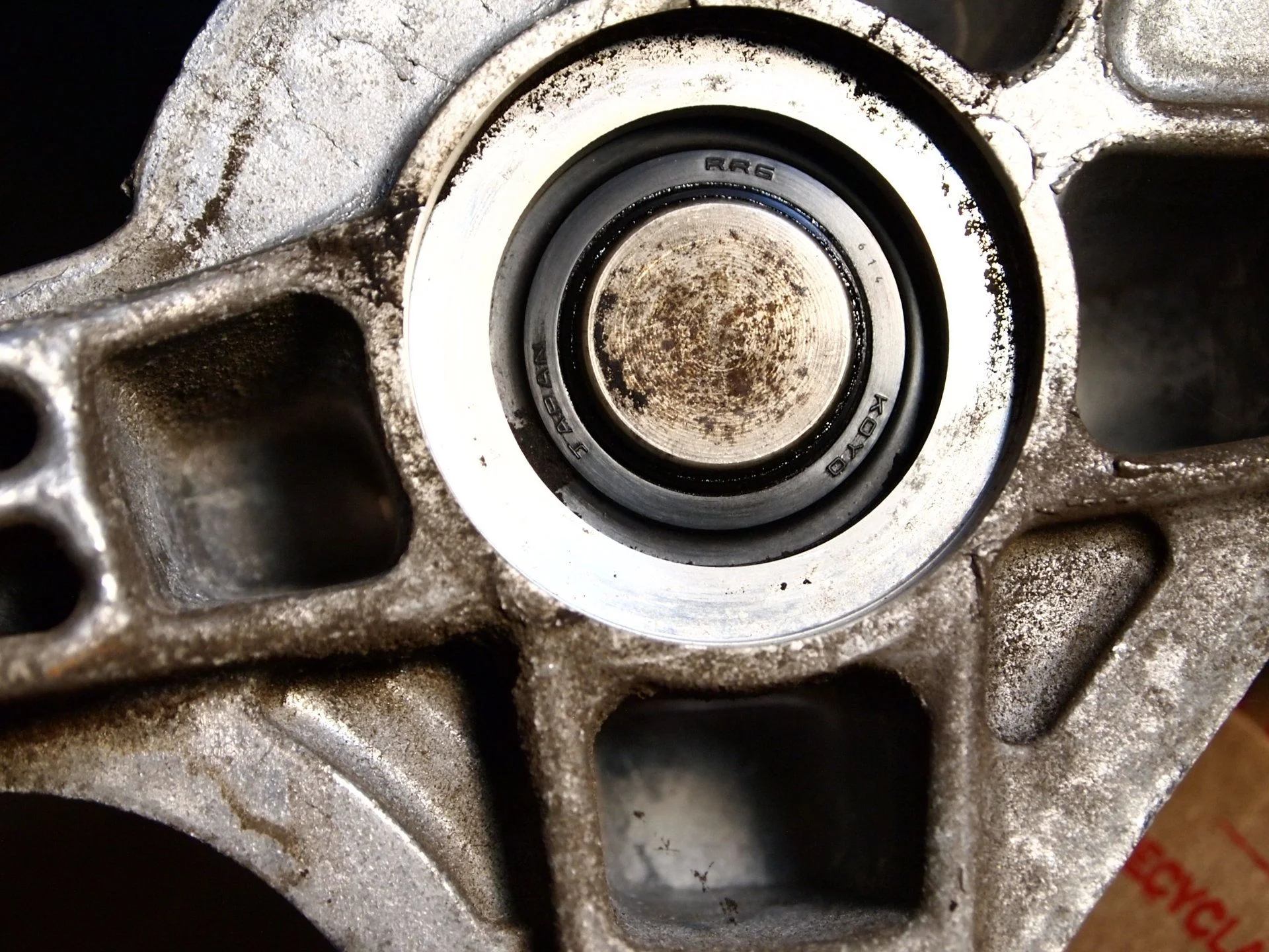

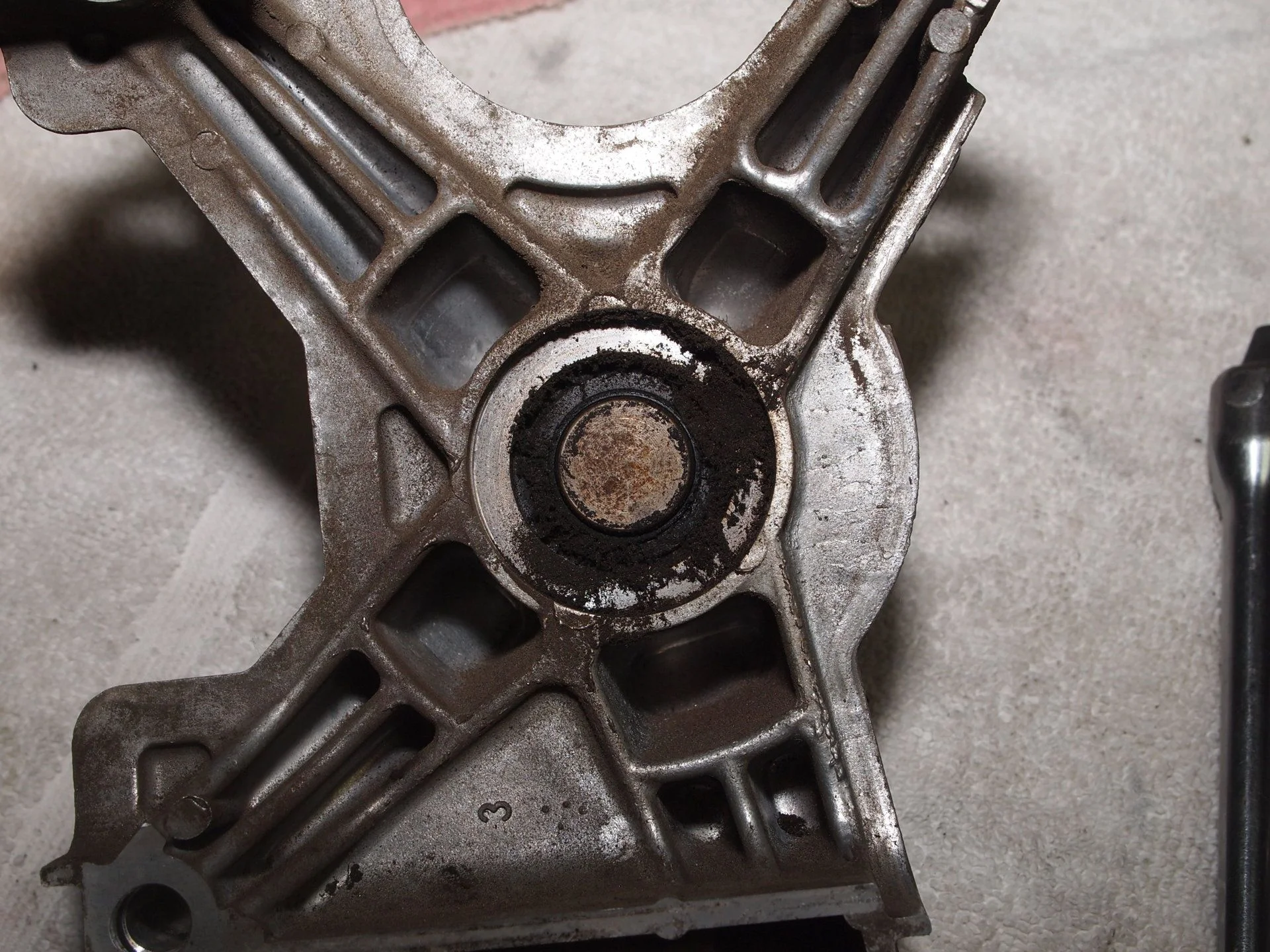

It's a good time to inspect the fan bracket. Any play, noise or oil seepage and replace for sure, if not just replacing as PM.

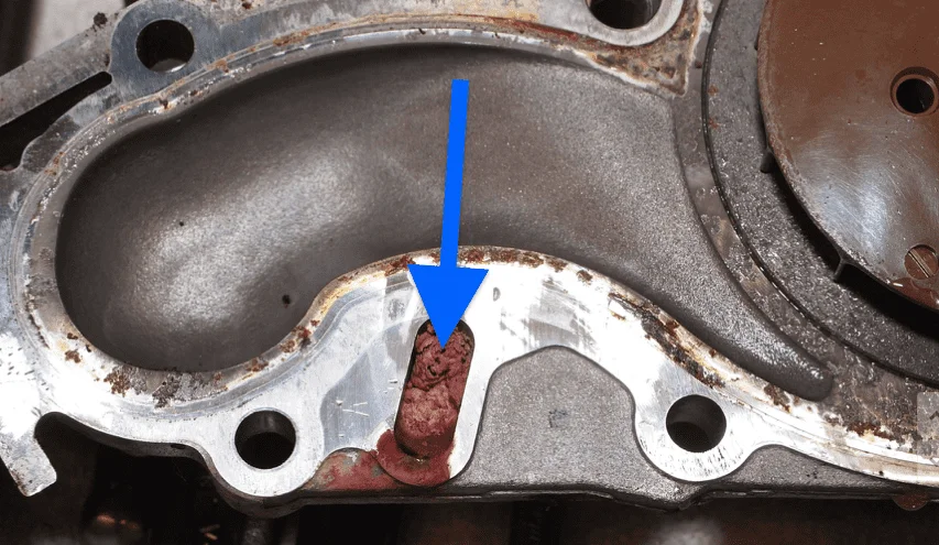

That is a weep hole, coming from the main failure point (bushing) of any water point. What your seeing is coolant dried, harden and built up over time. Some sign of coolant on block near this point, but weep hole at bottom timing belt cover was clear. So leak was not yet externally detectable.

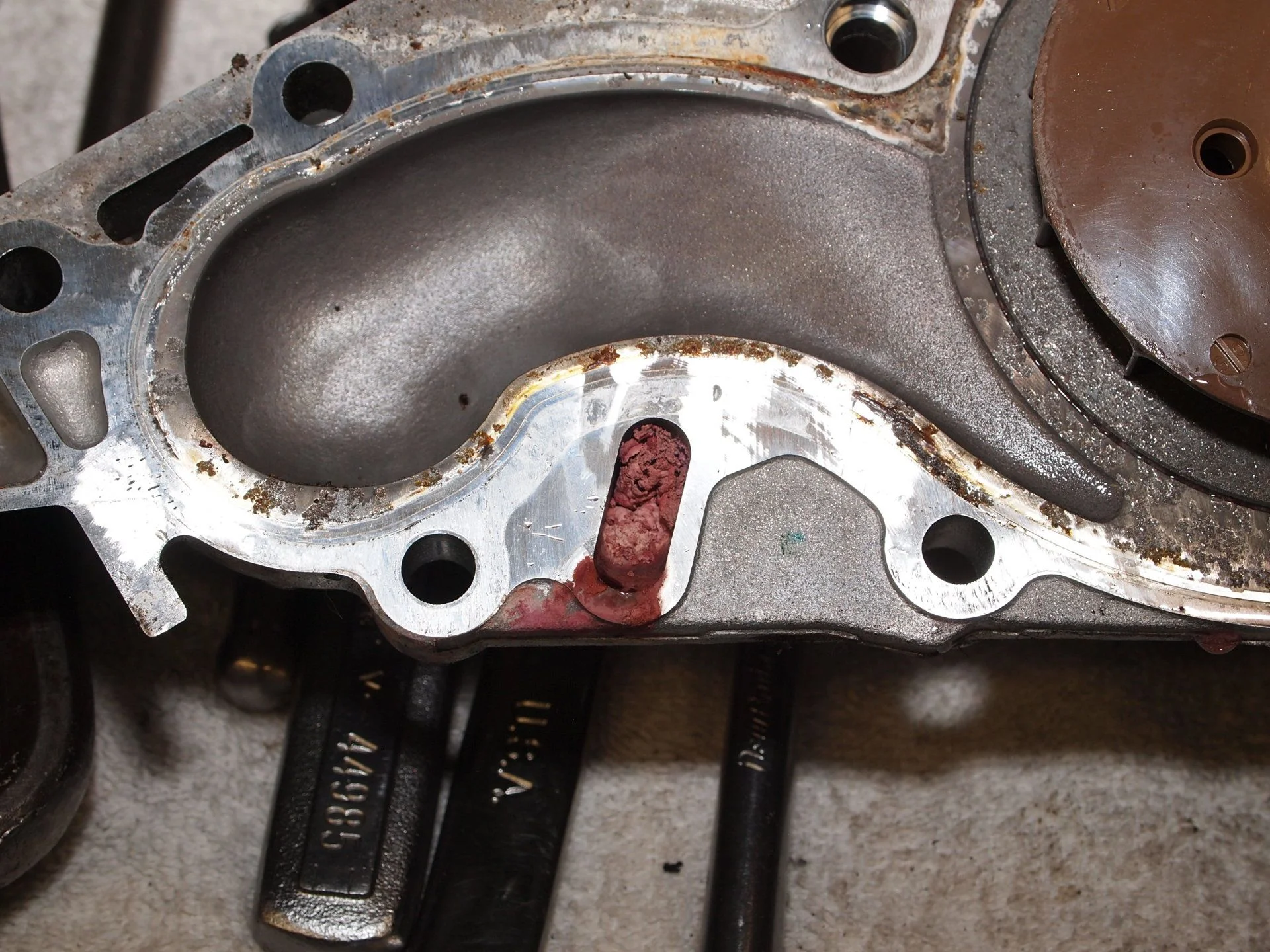

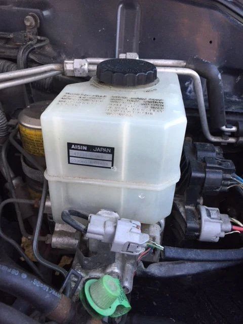

Amazing pics - Thanks for information. I was going to have the TB & WP done tomorrow (about 10,000 miles early) but my luck the ABS Alarm sounded, and the dashboard lit up with the BRAKE/VSC/VSC OFF/ABS lights... I went out this morning and have no brakes whatsoever and just popped the hood and the brake fluid reservoir is bone dry... Any ideas (Praying its a brake line and not something much pricier).
Thanks - Matt
Check around the brake booster and fenderwell for signs of leaks, then crawl under and inspect all four corners for brake fluid and wet spots around each caliper. Then start back tracking from each caliper to the hard lines. Its definitely leaking from somewhere.
Ughh dude
Sorry
Agree to check all the lines. It has to be a leak as the fluid went somewhere.
