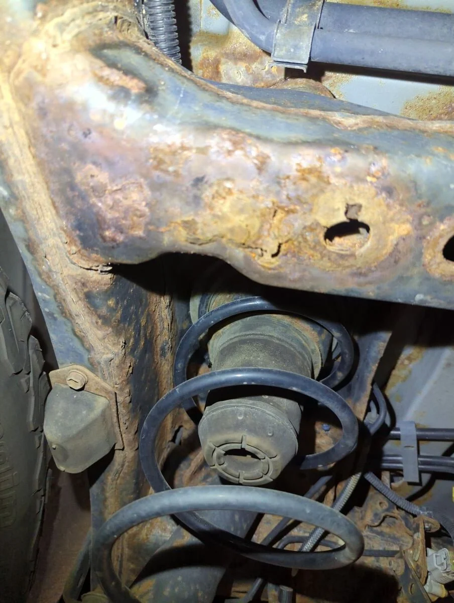

Is that a hole in the frame/cross member? Or maybe just gap where two pieces are coming together?

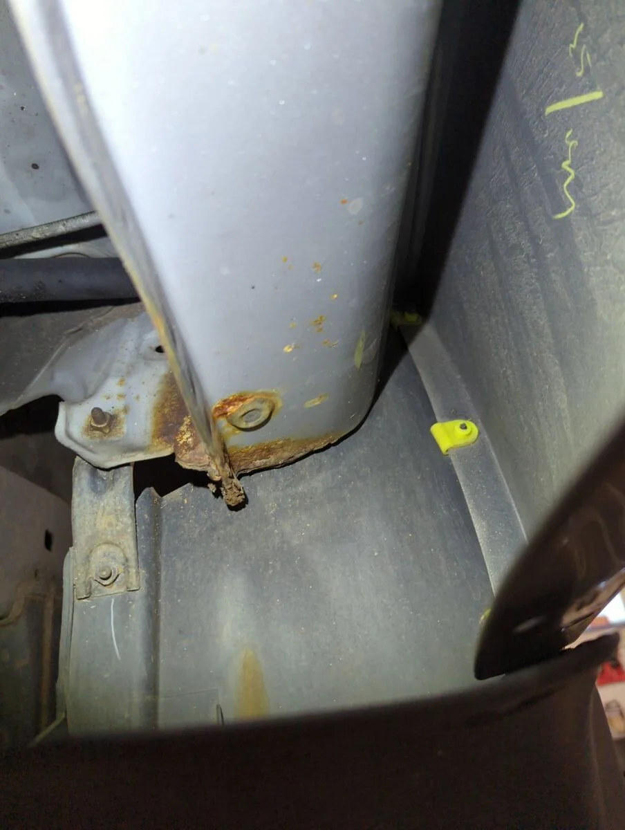

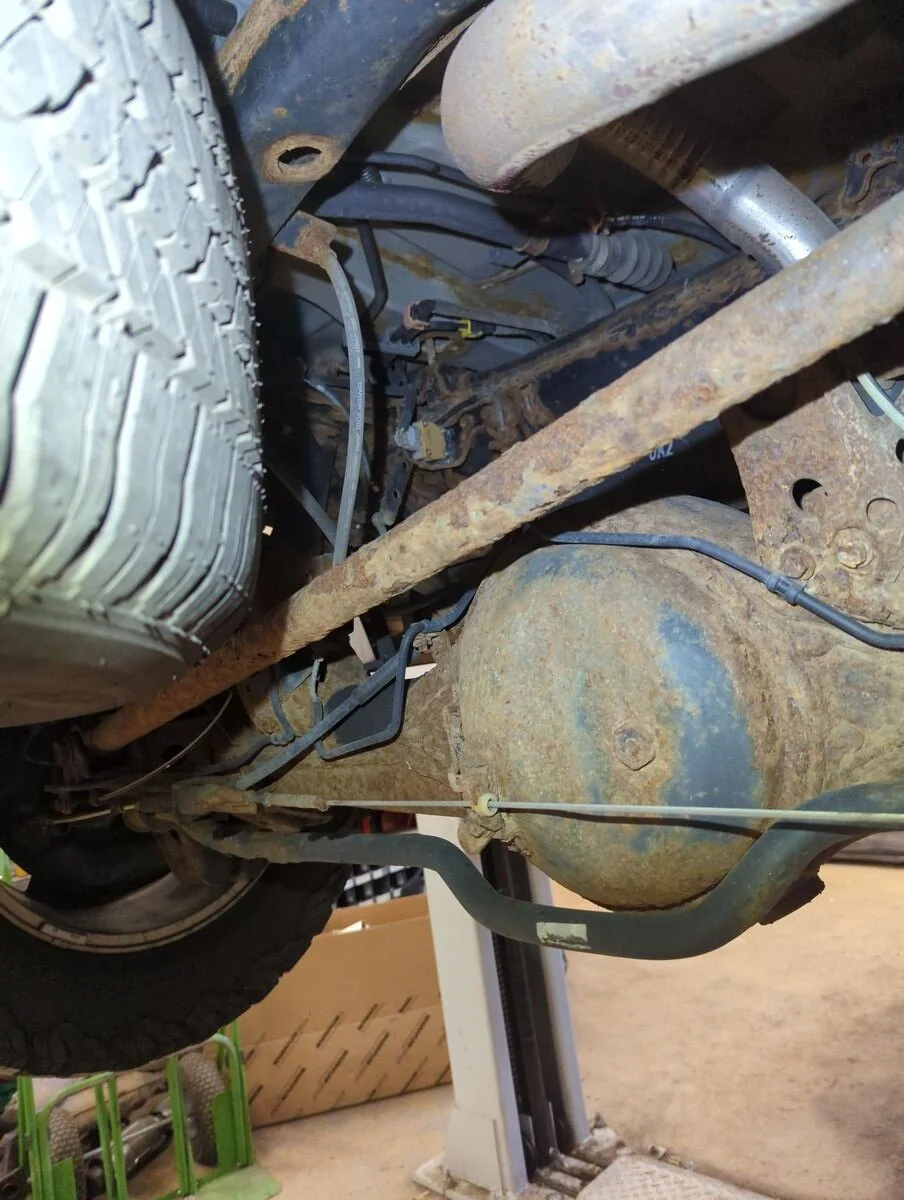

Thanks for all the input so far. I just got some photos of the rust, mainly on the rear suspension links and frame
Is this worth investing in? I've had the car since 2006/7, and it has served us very well. But now it has been my son driving it at college for the last 2 years.
I'd not put money in it. That rust runs deep into all body parts, frame and components. Including piping, wiring and grounds. It will be a "time and materials" money pit, with very little resell value.

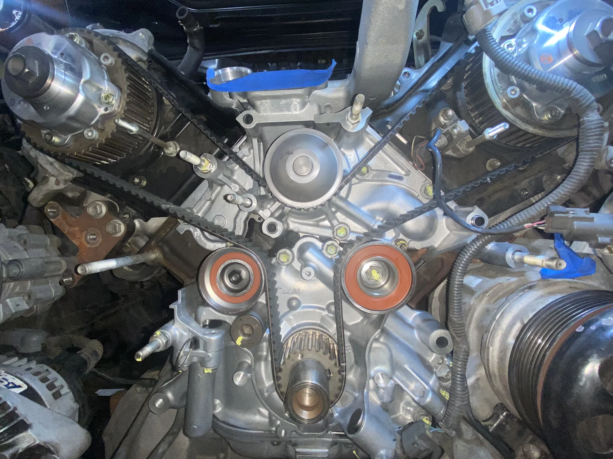

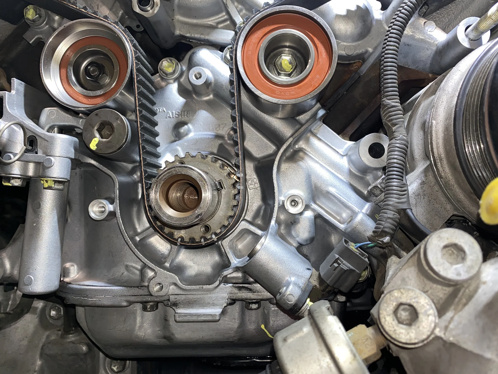

Just an FYI… Labor charge for recent timing belt service. Aisin kit TKT-021 and oil pump gasket. Excellent mechanic with OCD work ethic. This as a result of my first ever leaking water pump.
INDY shops, that works on all makes and models.
Hope your Aisin TKT-021, didn't come from Amazon or Ebay. Some junk bootleg parts, in their kits.
Oil pump, doesn't have a gasket. Nore is oil pump removed in a typical T-belt service.
Precision Multi-purpose seal. What's that, some cheap FIPG.
Labor $552. What's his hourly rate $92.00.
No FIPG 1282B
No Fan bracket! Humm.
No coolant! Hum
I just finished a timing belt service. Which and INDY did last Time belt.

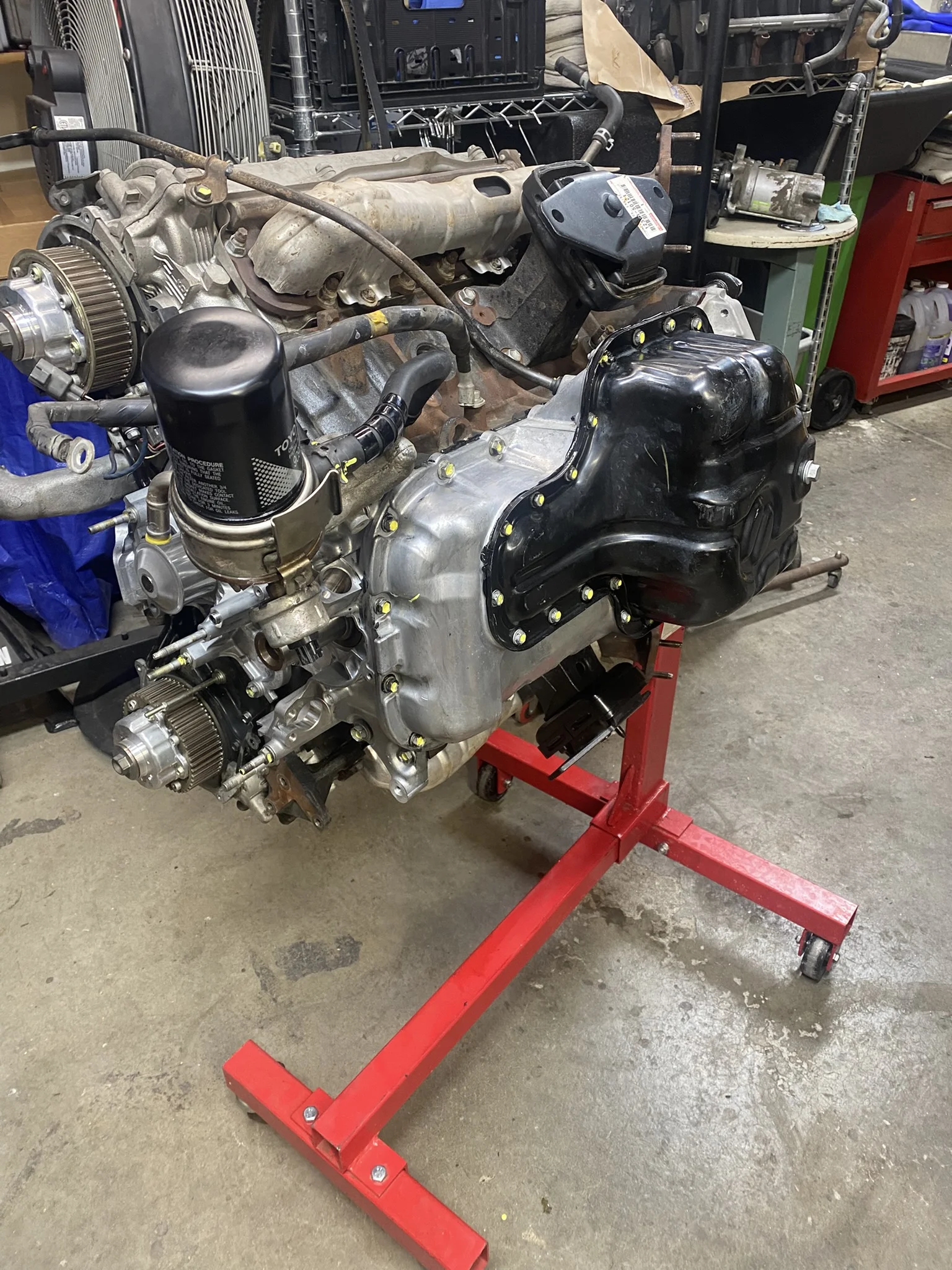

In it. I did replace an oil pump. PITA labor intensive job. Due previous T-belt service, done at INDY shop, cross threading in tensioner pulley bolt into oil pump. Pulling engine, both oil pans, to get to oil pump. Also found other cross threaded bolts, lose bolts, over torqued. Water inlet and front water by pass coolant leak and damaged. Due use of FIPG on large O-ring. Crank/oil sending unit wires routed wrong.Busted cam sensor wire housing bracket. Some starge black floaters in coolant system. The list goes on.
So much of what I do, is correcting what other hands have messed up.

Am I correct that you would recommend your $2800 timing belt service every 90k miles as well,
I do recommend, same as Toyota/lexus FSM & OEM & scheduled maintenance guide: 90k or 9 yr (2007 sch, which is now used 98-07).
VVTi for sure, get it done.
In 98-05. If you want to take the chance on a T-belt break. You'll likely just need a tow, if happens.
Book time runs, 5hr to 6hr.

Nice job pulling the motor to do the oil pump and pans. Do you typically remove the intake manifold before pulling the motor?
