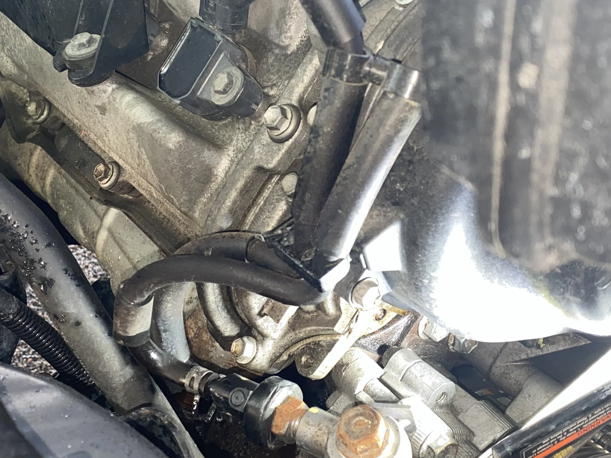

I'll add. The cam seals, typically shows leak, just under the upper time belt covers on block. It will travel along block under exhaust manifold finding its way to plastic #2 undershield in time.
A head (valve) covers leaking badly and had been for a good amount of time. Its oil leak, may get to same area on front of block. Head cover leaks are seen mostly along bottom of head covers above exhaust manifold, flow back and down block around exhaust manifold. Bad HC leaks, also get between HC and intake manifold.
If this area on front of block is wet. Clean after re-torquing head cover bolts to 54 INCH-LBF. Then watch for reoccurrence. A second cleaning, a few months and few thousand miles later, will help confirm.
This is bank 2 under time belt/cam cover above vane pump, after cleaning oil.
This is month or so later. Cam seal leak confirmed.
