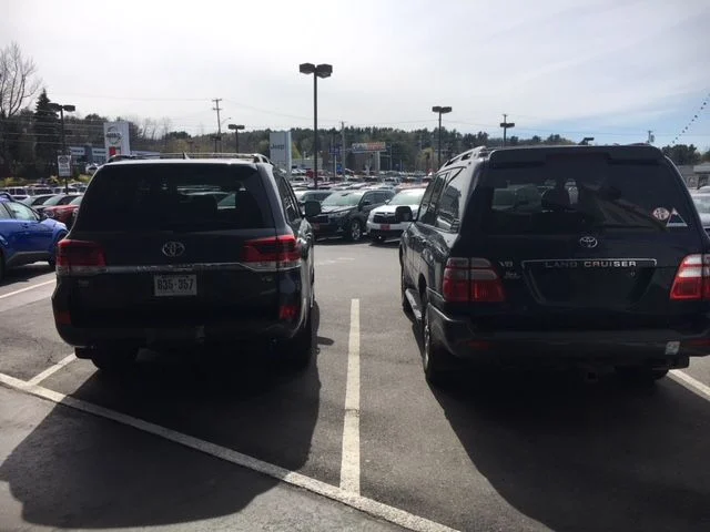

HMMM your truck looks very familiar.
Any idea where it came out of Maine? I traded one in just like that one. Same tires, same mileage, same color, etc.
I have my vin if you are curious. The service history was up until 51454 at Berlin City Toyota. Once I purchased I did all my own or had a place that I trust do some work. If it is mine everything was done with OEM parts. Everything you touch was replaced at the 90K service.
I thought I had entered it on the Toyota site myself but am wondering if they don't show it.
Let me know if you want my old VIN to see if it was my truck.
If it is my wife misses it even though she now drives a lx470 or the 2017

Hi JOFS, This rig must be yours... Berlin City in Portland had the records up until the 50k range. I would love to see if the vins match. I love the rig and its my first LC.
Thanks
Sending you a PM.
JOFS, I just noticed your second post with the pics. Thats 100% my LC... I can tell by the front bumper! Thats awesome. Any info you can share on what not to replace would be great!
Very cool you traded it in for a new LC. My wife drives a GMC Yukon and is always after my keys to drive it.
