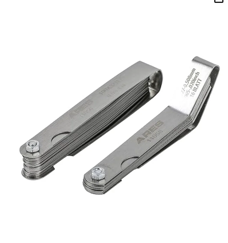

@Beehanger get the engine up to operating temperatures and then stop the engine and check the valve lash. It’s better to be a little loose than too tight. Having valves that don’t open all the way cause restriction in the flow of air and the combustion process can get disrupted. It’ll cause loss of power which may explain the low vaccum.
Also, go get yourself a set of go-no go feeler gauges. Look them up and how to use them. They are a game changer when setting valve lash. Totally worth the ten bucks.

are these any different than standard feeler gauges? i've got some old school ones here they look like this

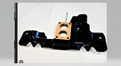

There's no gasket currently underneath my carb... bought a new carberator insulator from @ToyotaMatt and figured it goes directly on that soft surface.
Maybe this is my issue,...?
@ToyotaMatt does this carb insulator require a gasket to mate to the carb?
as you can see , there are TAN color OEM gaskets molded into the insulator plate on both sides
, your good on the gaskets topic
are these reusable if I pull the carb off? and if fuel is spilt or some other gunk how can one replace these?

- the gaskets on the insulator plate are designed to withstand gasoline , unless physical damage in someway here dan , you just treat it like a new gasket again .....
- if you have been told or are told to apply any form of liquid sealer or a 2nd set of gaskets the 2nd use time rodeo here , ?
- your being lied to , so don't listen to that non sence , te tan OEM gasket material there in that space-age insulator resistes Memory , hence it will bounce back ikn a YOUNG time era like yours is ....
- if you have already applied a liquid gasket or some Bull S#it permitted product to either side , now os the time to come clean , so i can advise you correctly how to remove it , and NOT hurt the TAN factory applied Moon Lander gaskets at the same time
- THIS IS THE WAY ...........

Might be an unpopular opinion but I run gaskets even with the ones on the insulator. If nothing else it makes me feel better about not having leaks. There are two, one that goes between the carb and the insulator with 2 holes for the primary/secondary and a second that goes between the insulator and the intake manifold with one oval hole. I think City Racer may have them and I know Spector has them.
If I recall correctly I had to lightly sand the top off my insulator because the tan molded on gasket was looking pretty bad. I then added a gasket that I made from a sheet of fuel resistant gasket material.
