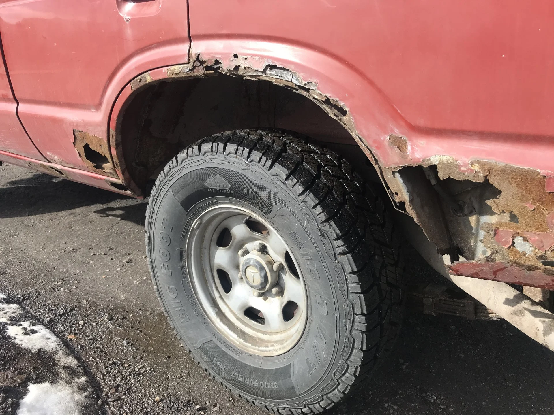

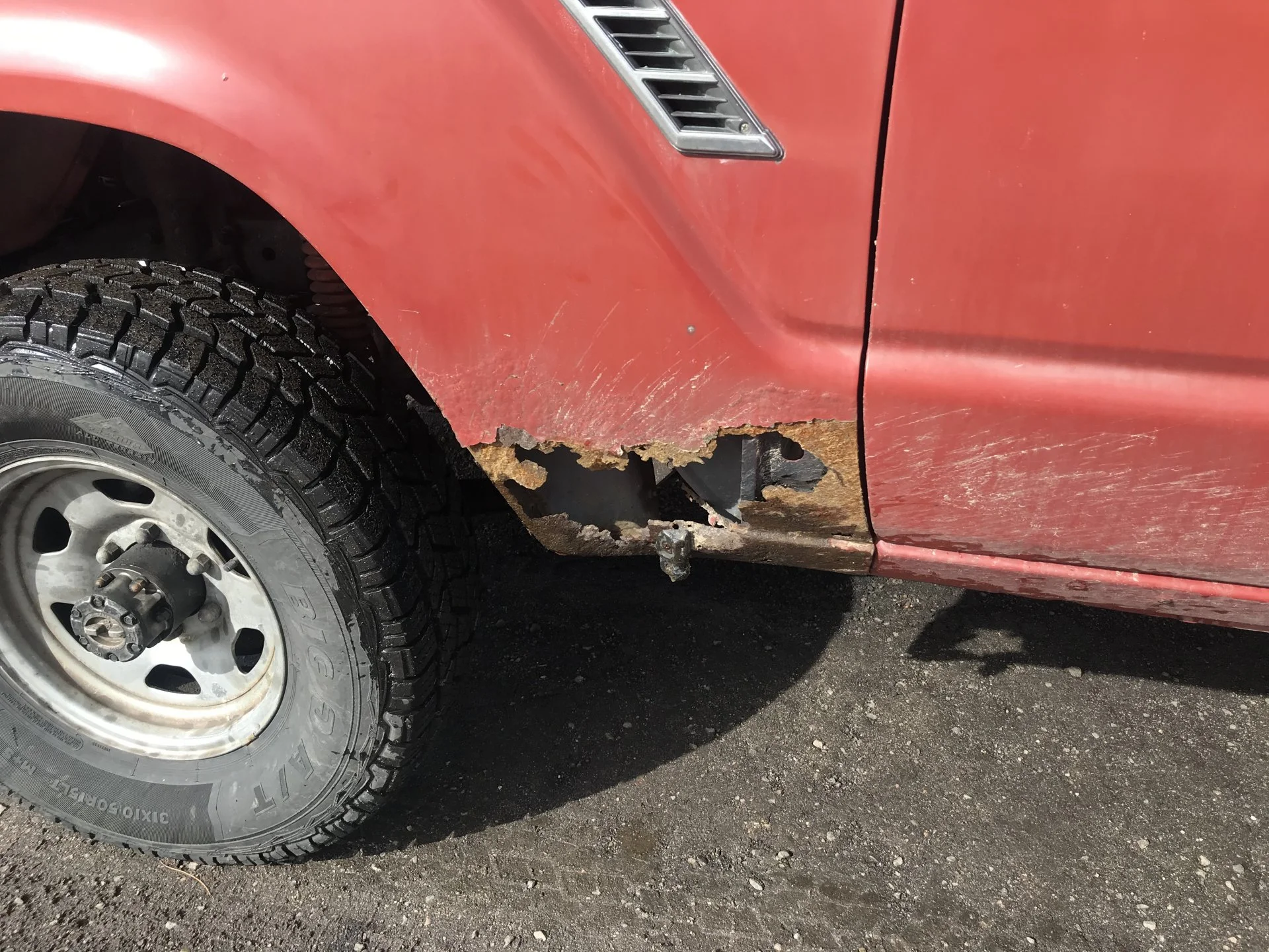

I told myself the rust was fixable, but I didn't know the first thing about rust repair. I didn't look at the frame before I bought it. Power choked out around 1800rpm on the test drive. I didn't care. The bad single stage repaint looked "fine" to me. 3rd gear was notchy, but I figured it would "sort itself out". It was loud and smelly. I didn't know how to turn a wrench beyond basic tune ups and suspension work. The price was right though ... or was it? I'm still not sure.

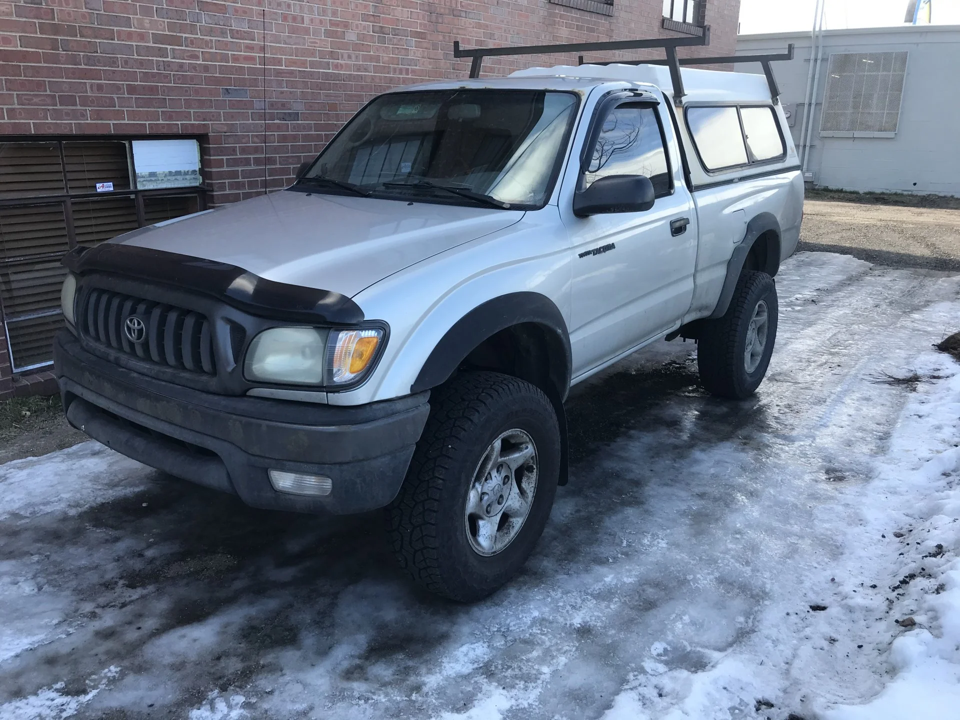

Here is the very sensible Tacoma I sold. I drove it from 40,000 miles to 275,000 miles. That truck saw a lot - some beautiful camp mornings in the mountains and by beaches, and some really ugly times in my life. A nice man from Mexico bought it and was going to trailer it to his ranch in Chihuahua where it would become a ranch truck. It literally got put out to pasture.
This has gotten worse over the past 21 months. How could I have looked at this and STILL paid the guy money for it??

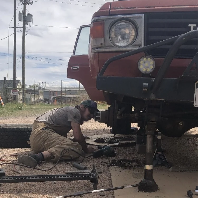

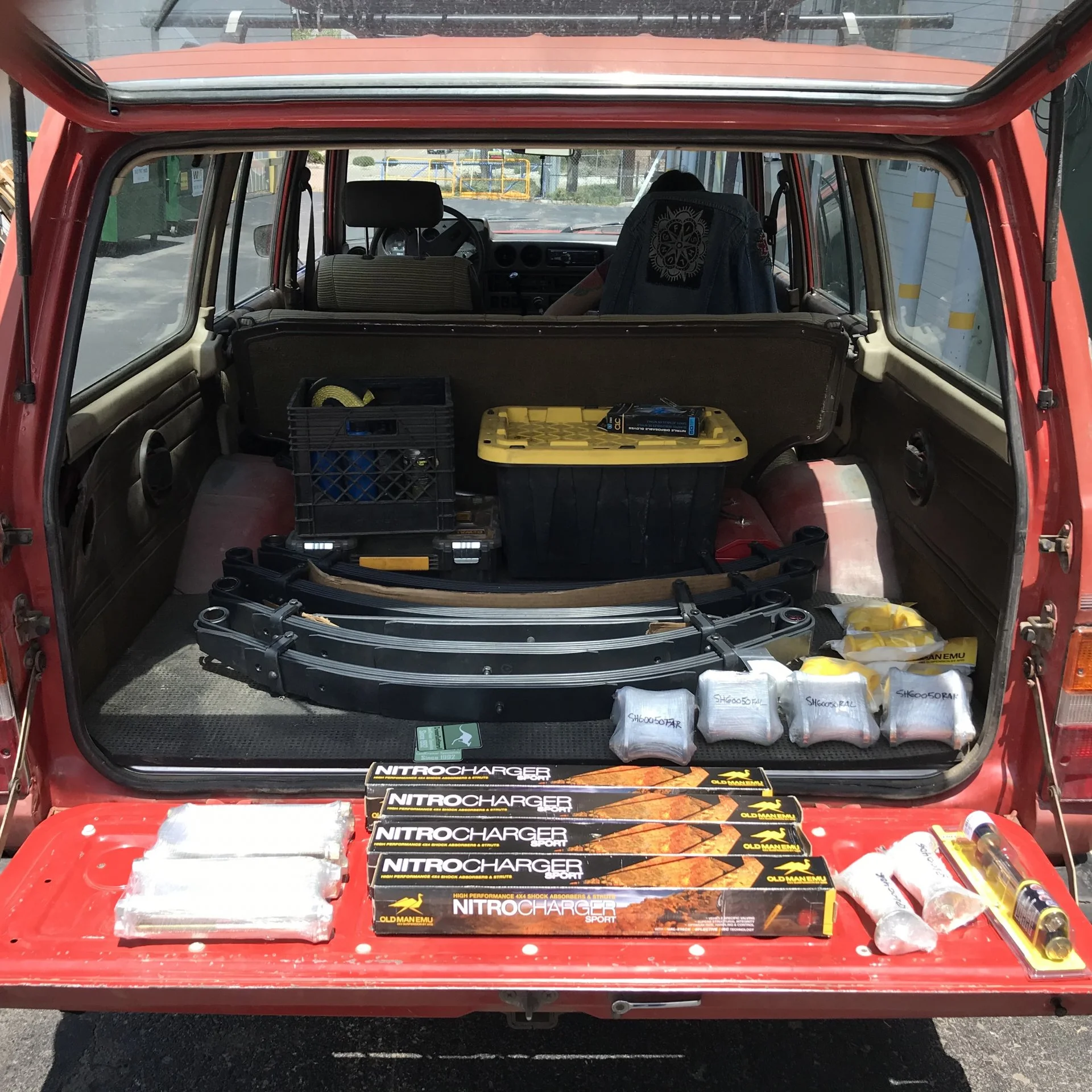

My #1 rule has always been to spend money responsibly first. Of course the first money I spent on the truck was a vanity project. Leaf springs? Oh yeah, no problem I've installed them before.
It took me 7 days, with the first 5 days being 12-16 hours each, all of it on the ground and in 90-100 degree weather with no shade. The original suspension fought me the whole way.
I park my truck in front of our small house in the city because it won't fit in the little garage. So that's where I work on it - right there on the street. My neighbors don't mind too much, but suspension work was too big of a job for that. Through a friend of a friend I secured a disused gravel parking lot.
I came pretty close to selling the truck that week. I had a Craigslist ad typed up and everything....
