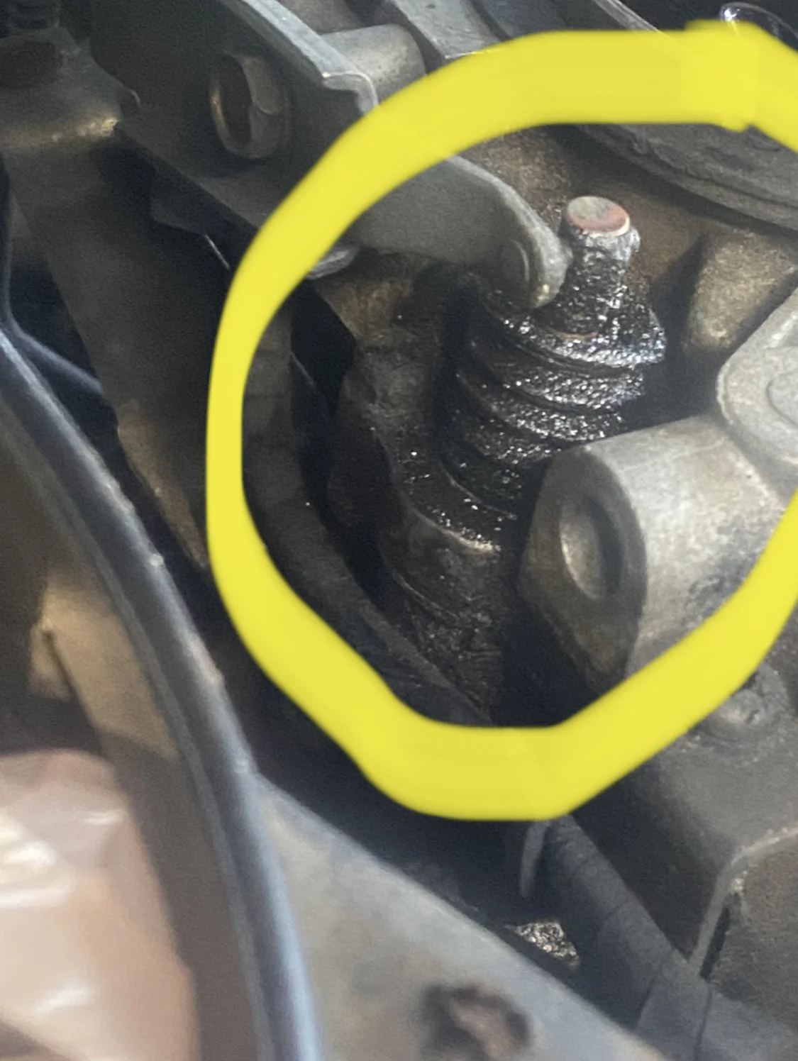

I had a stream of smoke coming out of this area. Is there a way to replace whatever seal that’s there or is it time for a rebuilt unit?
That little boot will come in a carb rebuild kit but that will not affect your vacuum.
Replace the accelerator pump. Usually included in a rebuild kit.
If there’s smoke blowing out near the intake manifold- likely the gasket is blown. They definitely don’t last forever
It's very unlikely that's actually the source of the leak and where smoke is escaping; it would require a very circuitous route to escape - but if it really is leaking from that area, a rebuild is definitely in order.
Don't get a generic rebuild if you end up going that route. Contact one of the MUD carb gurus
Carbs do not have smoke inside them. Nor do they have pressure.

I had some time to tinker more today so I did a smoke test, again, and used a mirror to better see where it was leaking from. Hard to capture clearly with my iPhone, but with my own two eyes I can see that it is coming out of that plunger.

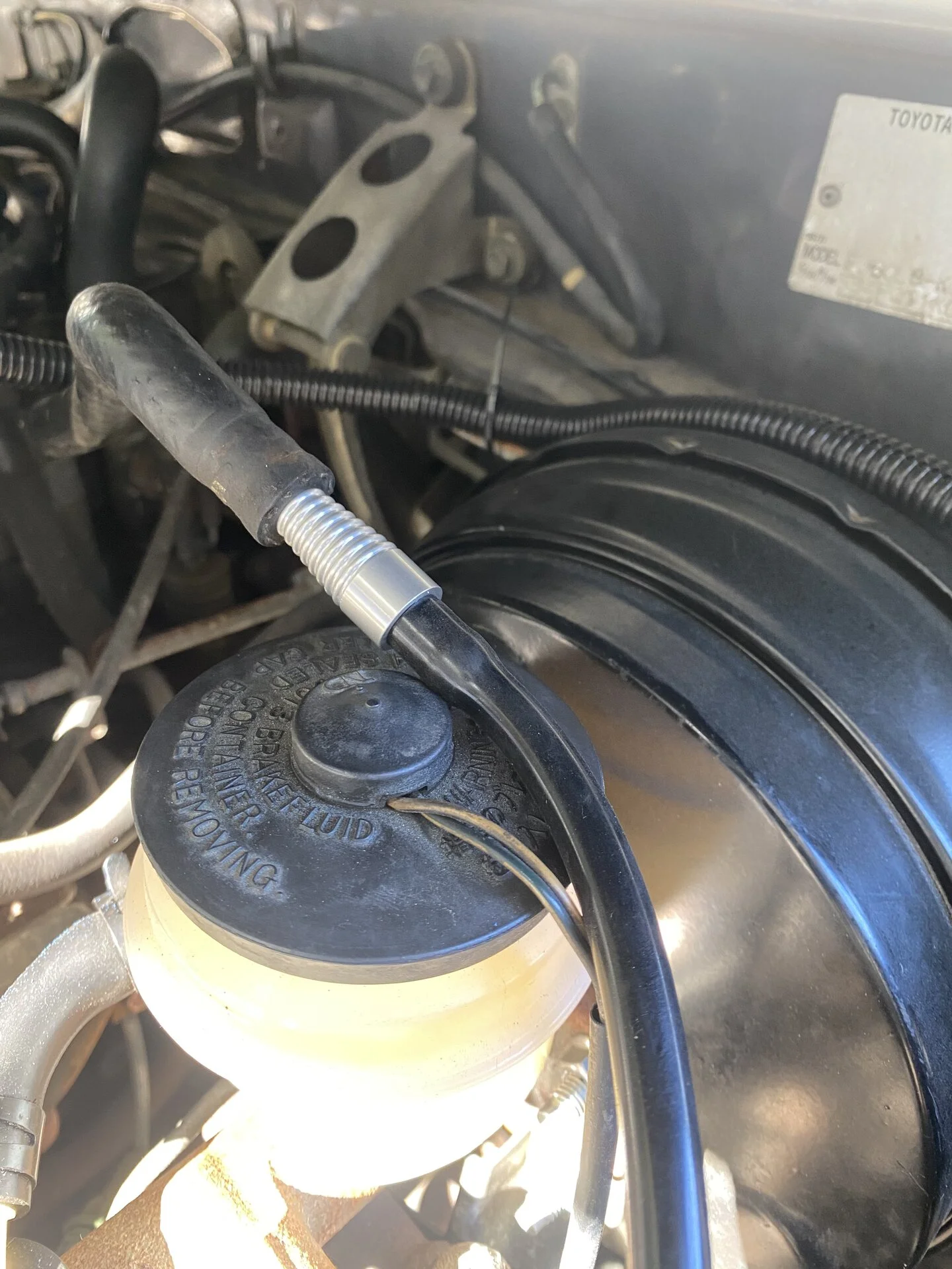

Hooked up the smoke machine to the brake booster vac line, sealed off the air cleaner at the intake tube……
Now I know. No other leaks anywhere else, even with what looks like all original vacuum lines! All those will be replaced nonetheless while this carburetor is pulled.

The plan was to go through everything anyway. And although it’s been awhile since I’ve tinkered with an carb, I assume that accelerator plunger weeping fuel and not passing my smoke test - is still one of many that should be dealt with nonetheless, correct?? Or is that not considered a potential vacuum leak?

I am thinking "No". It's up too high on the carb and I think that the plunger has to communicate with atmosphere for the plunger to be able to move up and down freely. I think that in order to check with smoke you would want to remove the carb from manifold, seal up the big hole left over and then pump the smoke in. You're looking mostly for leaks below the carb.

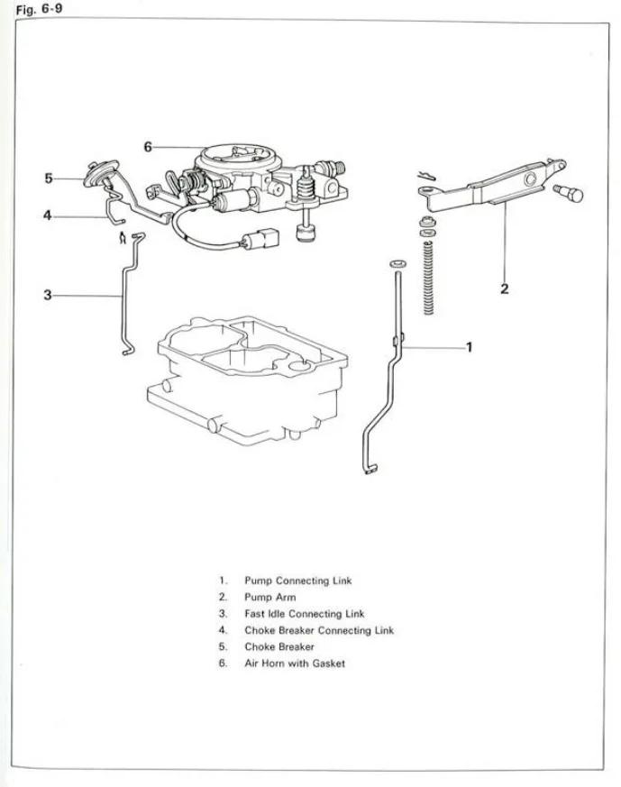

The rubber boot on the accelerator pump is installed from the top side. I suppose you can tease it out and install a new boot without removing much more than the accelerator pump lever. To replace the pump itself the air horn (top part of the carb) needs to be removed. It is held on by 8 screws I think. However, it's not that much more trouble to remove the entire carburetor assembly so you can work on the bench.

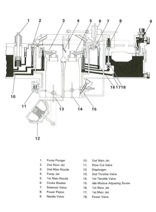

I just rebuilt two carburetors and neither of the accelerator pumps have a gas tight fit in the bore, at least when new. I suppose the pump seal may swell when wetted with gasoline. Looking at the carburetor schematic (lower picture), I think most of the smoke would enter the carb through the throttle bores. I'm not really sure how the smoke gets over to the plunger anyway, unless the carb is empty (no fuel in the float bowl. Anyway, good luck!
