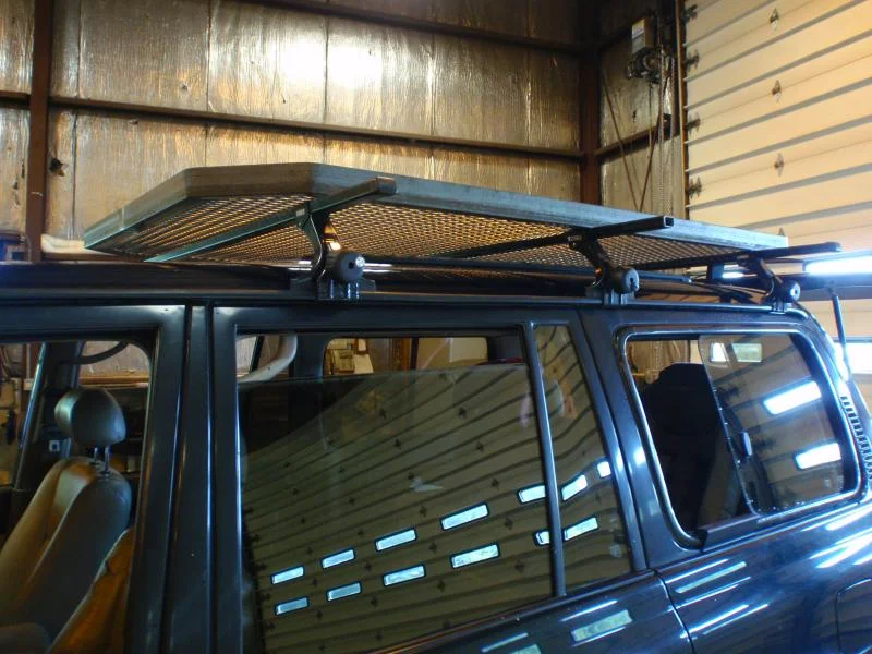

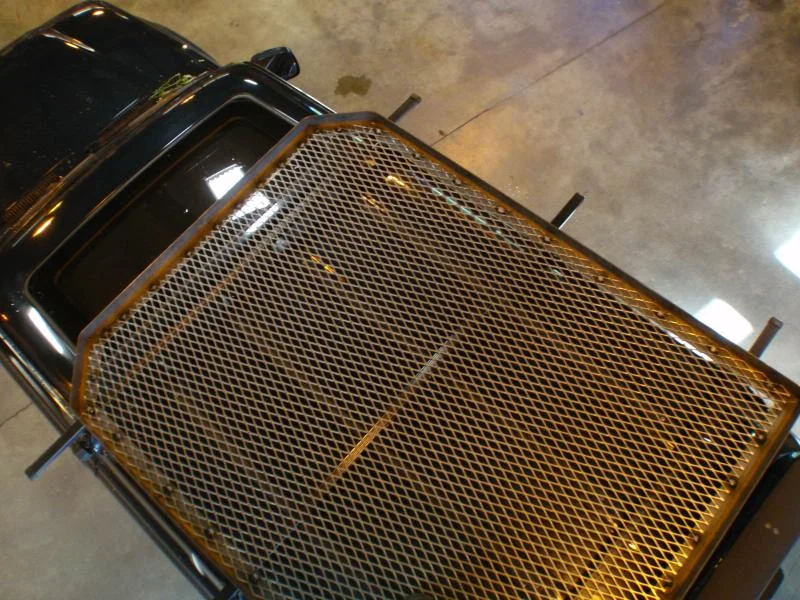

I purchased some Thule gutter mount feet and load bars. Then I made a simple but effective platform for it. It works great and my daughters (both under 5) love sitting up there. Thule products off of craigslist = $150 for 8 feet and 4 load bars. Platform = $95 in steel and my own time to cut and weld. It isn't a show stopper but for the price, I can't beat it.
nice looking setup there jlm43, I have a couple of those cross bars sitting in the garage
Cool setup jlm43 , ever consider trimming those crossbars ? - end hi-jack
To OP , bajaracks seem to be pretty good for the price point. ARB isn't that far off, if you care about name brand ... But if you have someone local, or the ability, you could easily fab one yourself as jlm43 has displayed.
