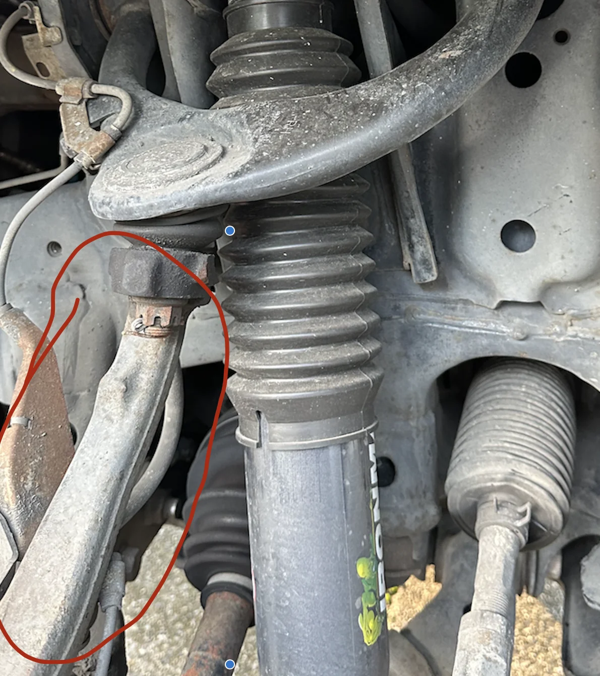

Also, for my knowledge, what is the red circled part called, I want to call it an "arm" but I know that we already call the upper control arm the arm.
The circled part is the knuckle.
My suggestion: Remove the cotter pin and move the castle nut to the end of the ball joint threads. Disconnect the speed sensor wiring from the upper control arm and move it away from the ball joint. Use a MAPP gas torch (easily found at a hardware store) to heat the very top of the knuckle. Once the top of the knuckle is good and hot, smack that flat surface at the top of the knuckle with a heavy hammer. The ball joint will separate from the knuckle.

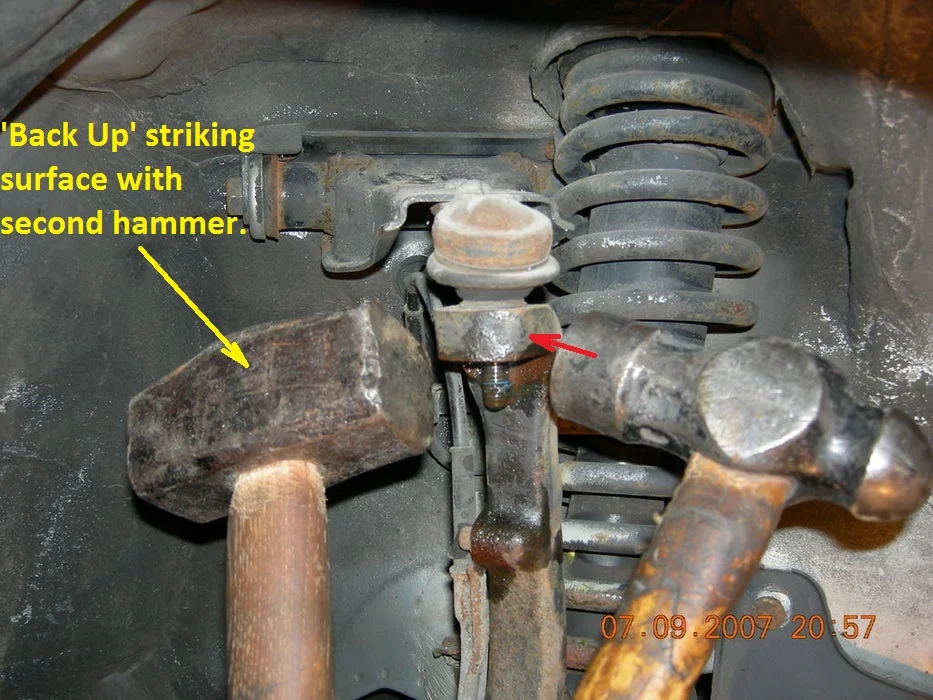

Don't hit the 'Ball Joint', strike the steering knuckle boss.
Do yourself a favor and 'Back Up' the spot you are hitting with another (preferably heavier hammer) so that the energy is fully transferred.
See example below:
See example below:View attachment 3477347
This is the way. I've done it probably 5 times, it works. Those knuckles are tough af and that extra material is there for a good wacking. I usually start with a brass hammer though and see if that does the trick.
