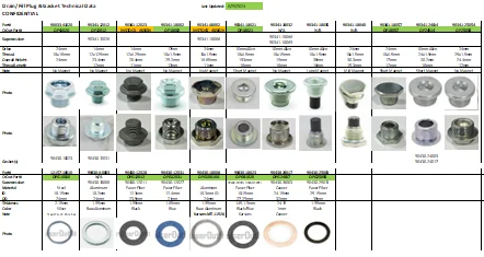

Definitely something I'll share at some point. At current it's full of our internal part numbers, QOH demands, sources, pricing and kit contents where we sell as part of a kit or sub-assembly. As such, not something I'm going to copy/past carte blanch as you can hopefully understand. There is more "we stock that too" happening in the Cruiser parts industry then ever before, copying parts offerings, application data, pricing, hell even our website spelling/grammatical errors :D. So, while I'm always happy to share, some will need some time pruning them of internal information first.
We have dozens and dozens of similar application guides, one day when ICE engines are illegal and Cruisers and parts are all getting yard-sale'd, I'll post them all before I start my job as a Walmart door greeter. :D
Here is an example of app guides we build. This is all (most) LC drain plugs and gaskets. Dimensions, material, color, source, etc.

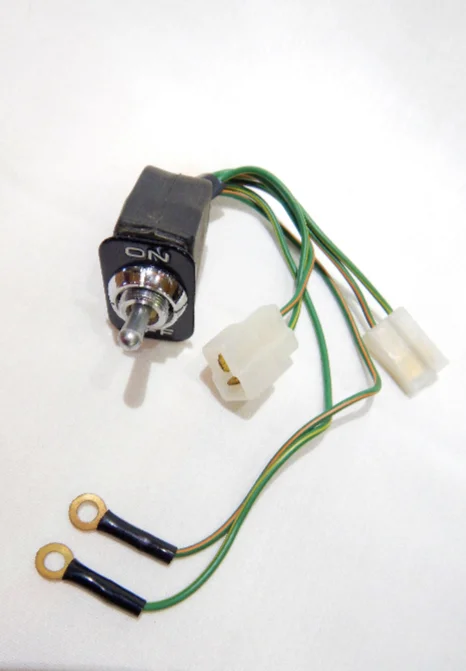

Mystery toggle switch. Marketed as for a 40 series. When I bought it, it just looked unique and while I had no plans for it, I grabbed it.
Bought it 10-15 years ago. It doesn’t seem to be in my eBay history anymore, which seems odd but maybe I bought it elsewhere. I don’t remember much about it. I do recall it shipped from Tehran.
6 wires. I believe it was marketed as DPST. Seems too small to be illuminated, but then the wire count seems odd, especially as two of them appear to be grounds.
Any gurus know what this is? Is it even Toyota?

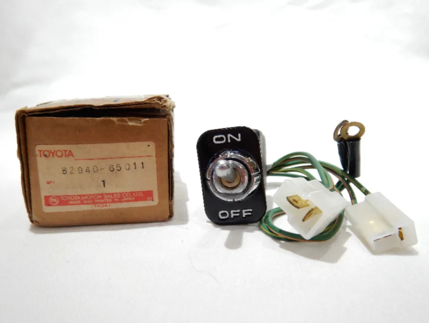

i have only ever seen one of these before , well ......... now this makes x2 :idea:
don't ever part with that switch , it is the main Sub-Part of a bigger and much much kool'r factory build sheet build option package ...
i had mine since high school , then it was chosen to be one of day-1 listings in the store . i regret that now after seeing another NOS pure TEq-Bliss example in your hand above .....
nice ...! :wrench::wrench::wrench:

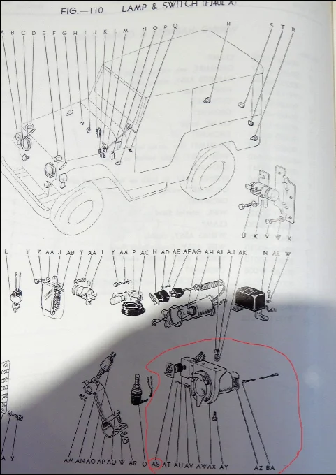

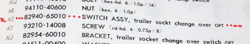

Switch Assy. , Changeover Rear Towing Convoy Trailer Harness
82940-65010 / 82940-65011
